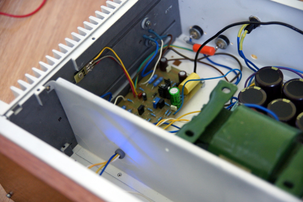

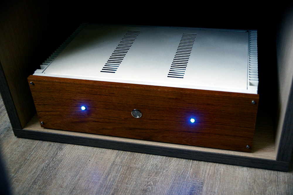

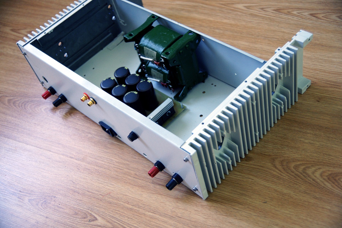

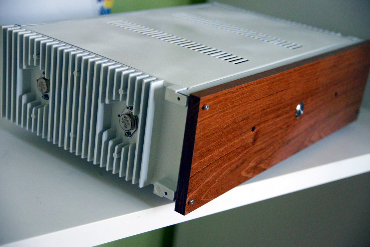

my second AB 100 - or better to call it the AB60 ( 60 W @ 8R and 95 @ 4R).

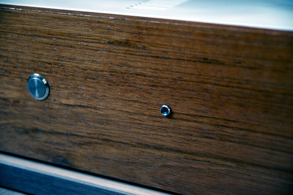

I've been listening to it for a month now, the right panel mount blue LEDs still haven't arrived - so the wires are not yet properly arranged and temporary Leds installed.
thank you, ordering this leds has been going on for me for a long time - initially i ordered a 6mm 24V led from china but did not like the machining - rough metal traces visible..so i ordered 8mm ans 12mm flash mount type Led - they are still on the way ... but probably had to take APEM LEDs (I've used them before) , expensive - but nice.
Search for the perfection but all ready Your amplifier looks fantastic Congratulations

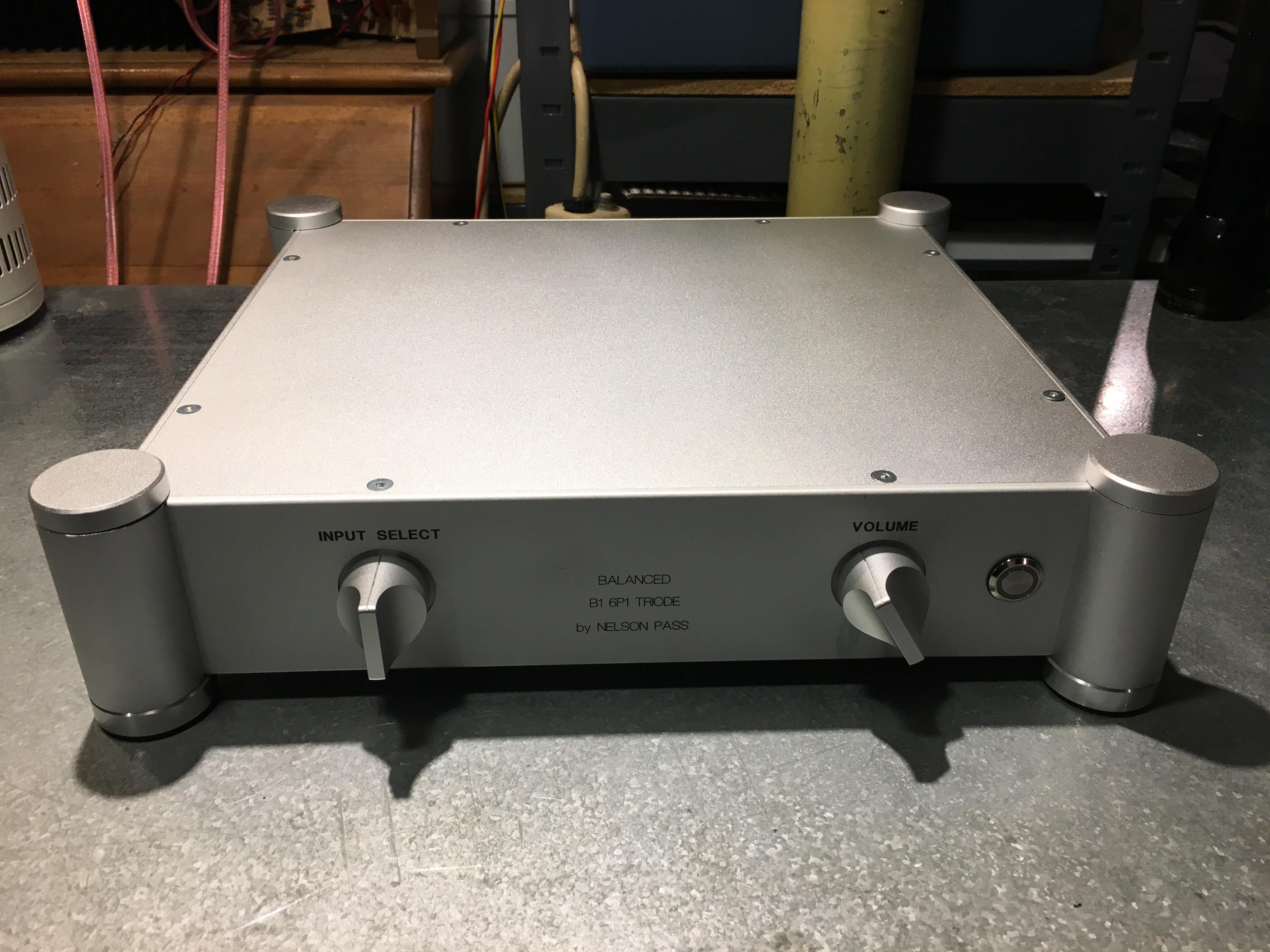

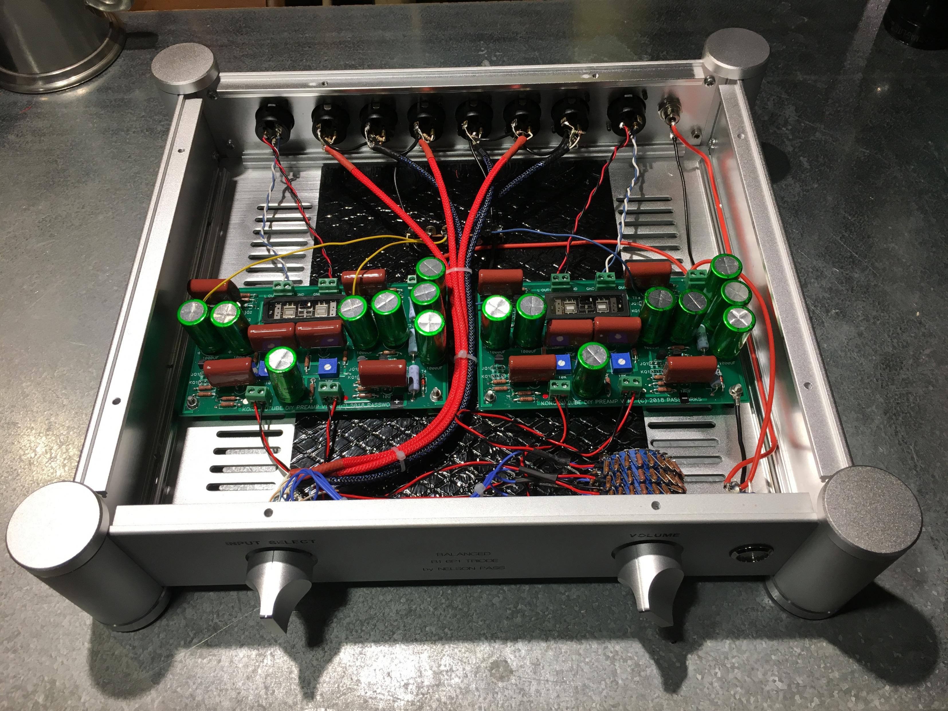

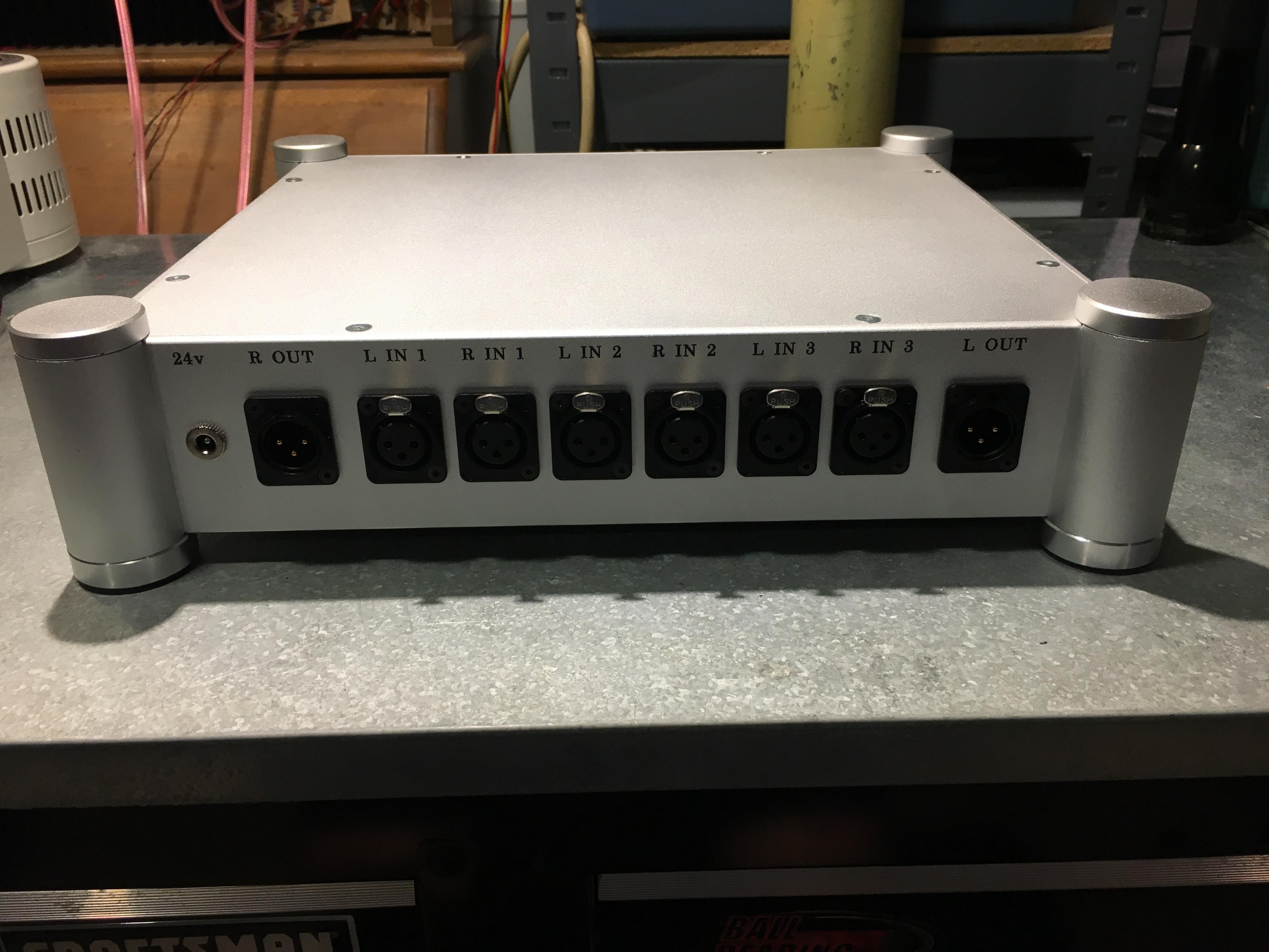

My Balanced B1 Korg Nutube triode preamp.
Very nice! How does it sound with your ACA monoblocks.
Ok, now that's just flipping cool!!!!
It doesn't sound as good as the Balanced Zen line stage, Nelson spoke of "to much of a good thing". The ACA's already has the 2H sound, I adjusted the B1 Korg for more 2H to change the F5T v3 I'm building. I'm learning that matching preamps to amps is well worth the effort.
