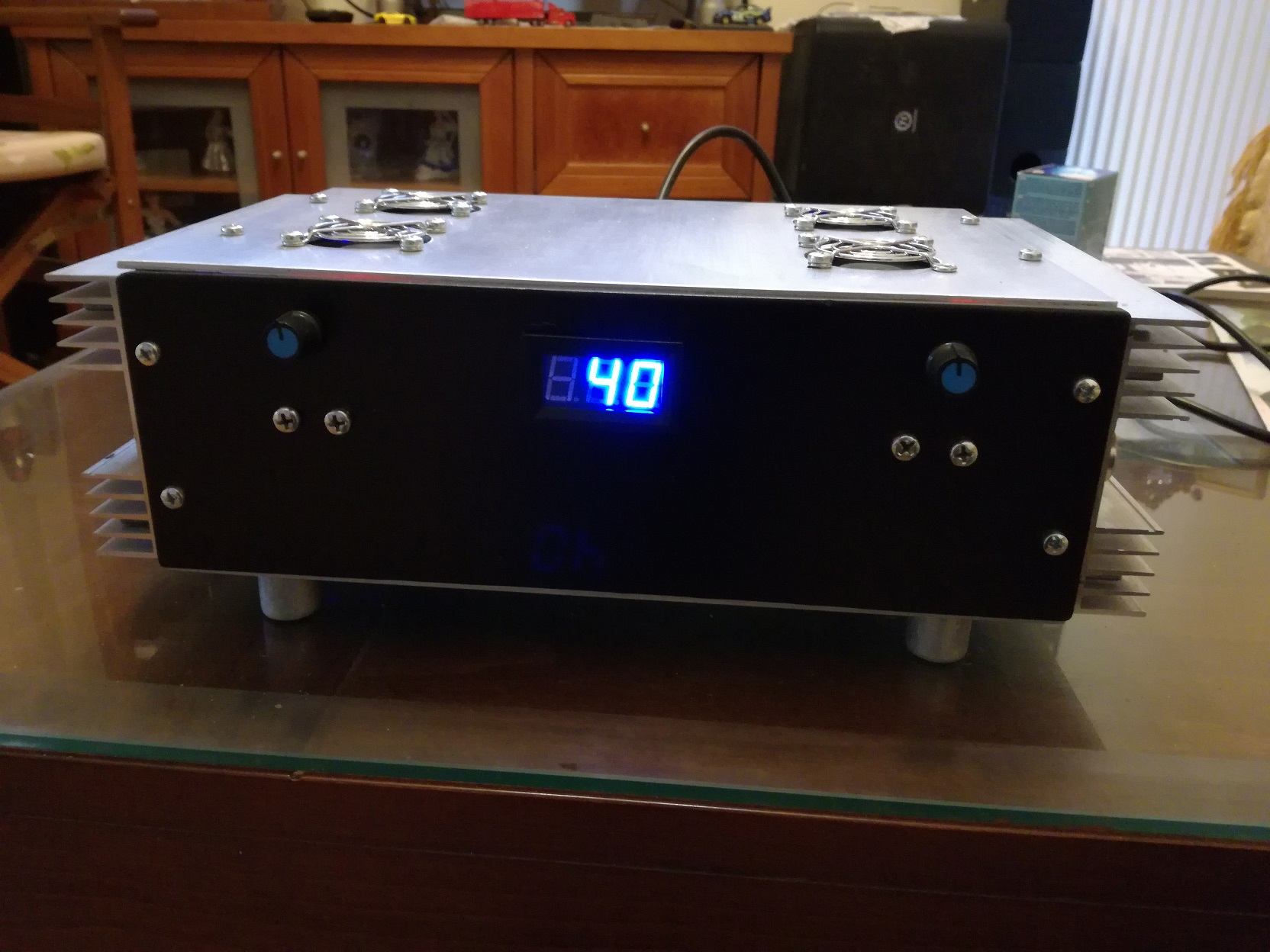

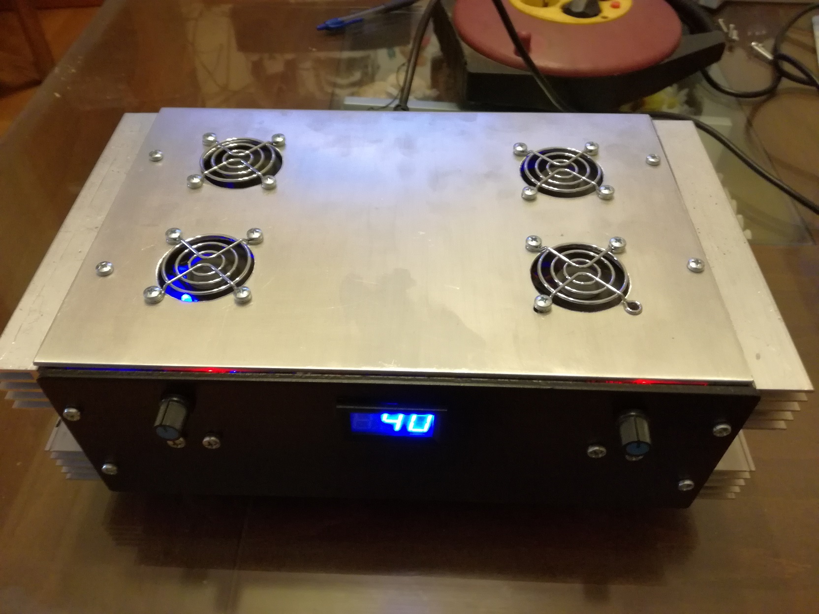

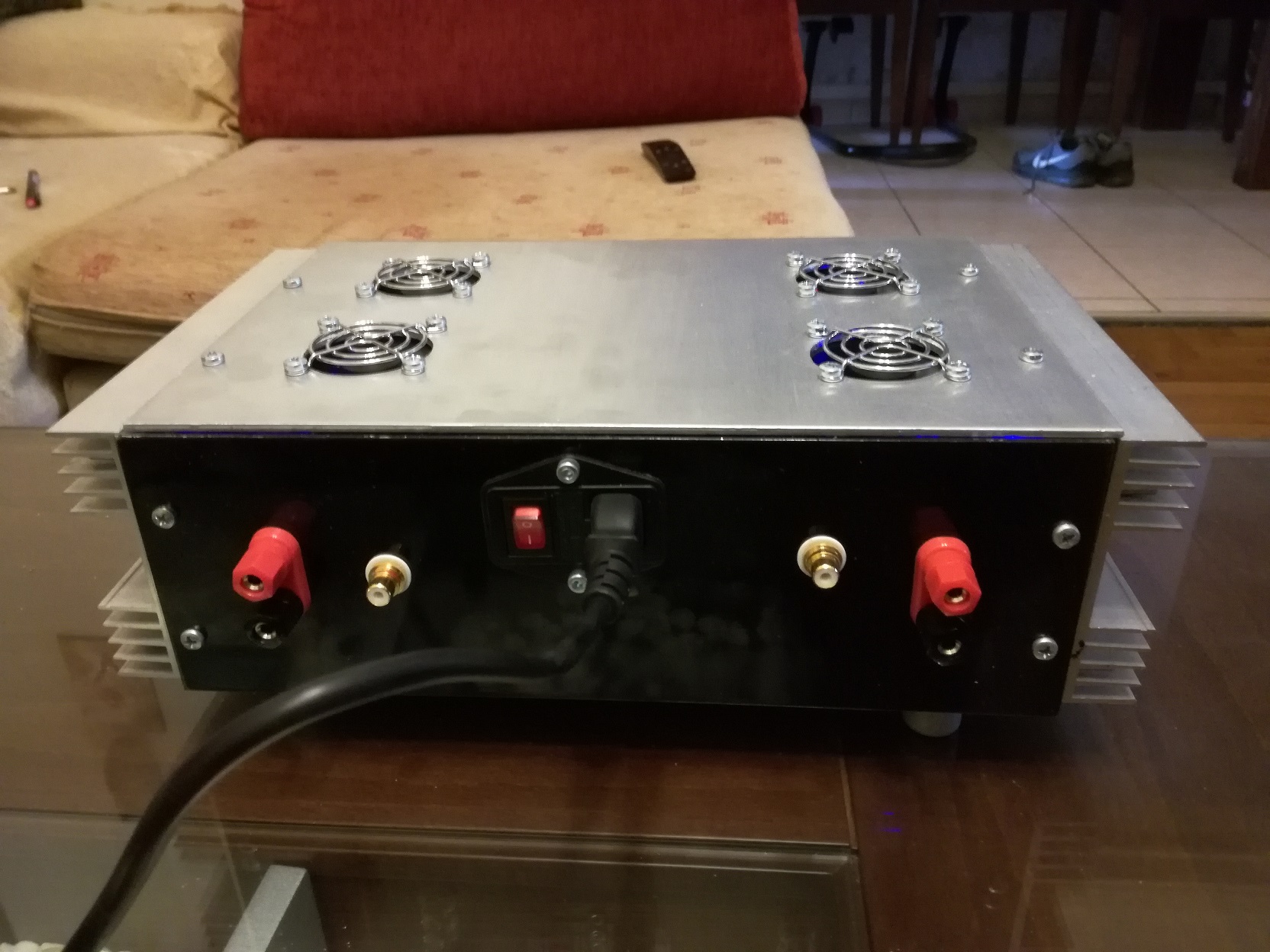

Hi guys . Just finished my diy camp amp
Congratulations!! It's a great amplifier, you'll enjoy it! 🙂 🙂 🙂
Wonderful photos, the amplifier looks beautiful.

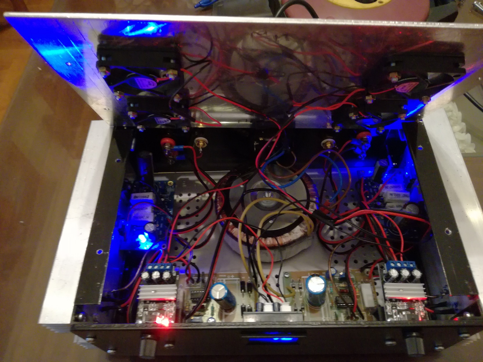

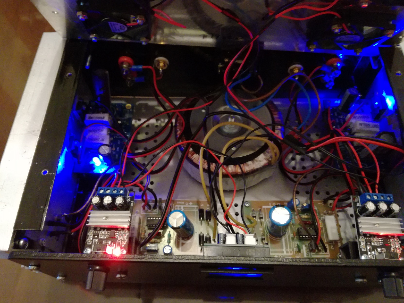

And what're the other bits and bobs I can see in there?
PS, looks great. I'm digging the ally and blue combo.

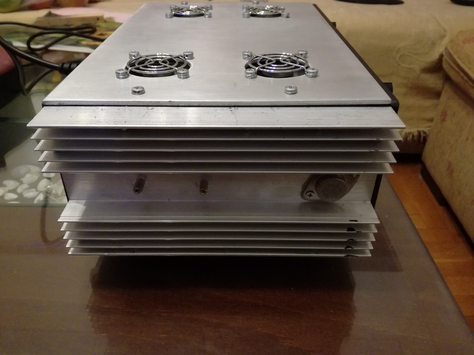

Awesome - does it fly with that many fans? 😀 😀 I'm imaging something like the world's first quad-copter-ClassA amp.
In all seriousness, it looks like you have an amp that will stay nice and cool - a major accomplishment in this arena! These amps are addicting: I have one in my office that runs all day long every day and my kids also have one for a small bedroom stereo.
Love the industrial/lab type look of it
looks bad ***. Great job

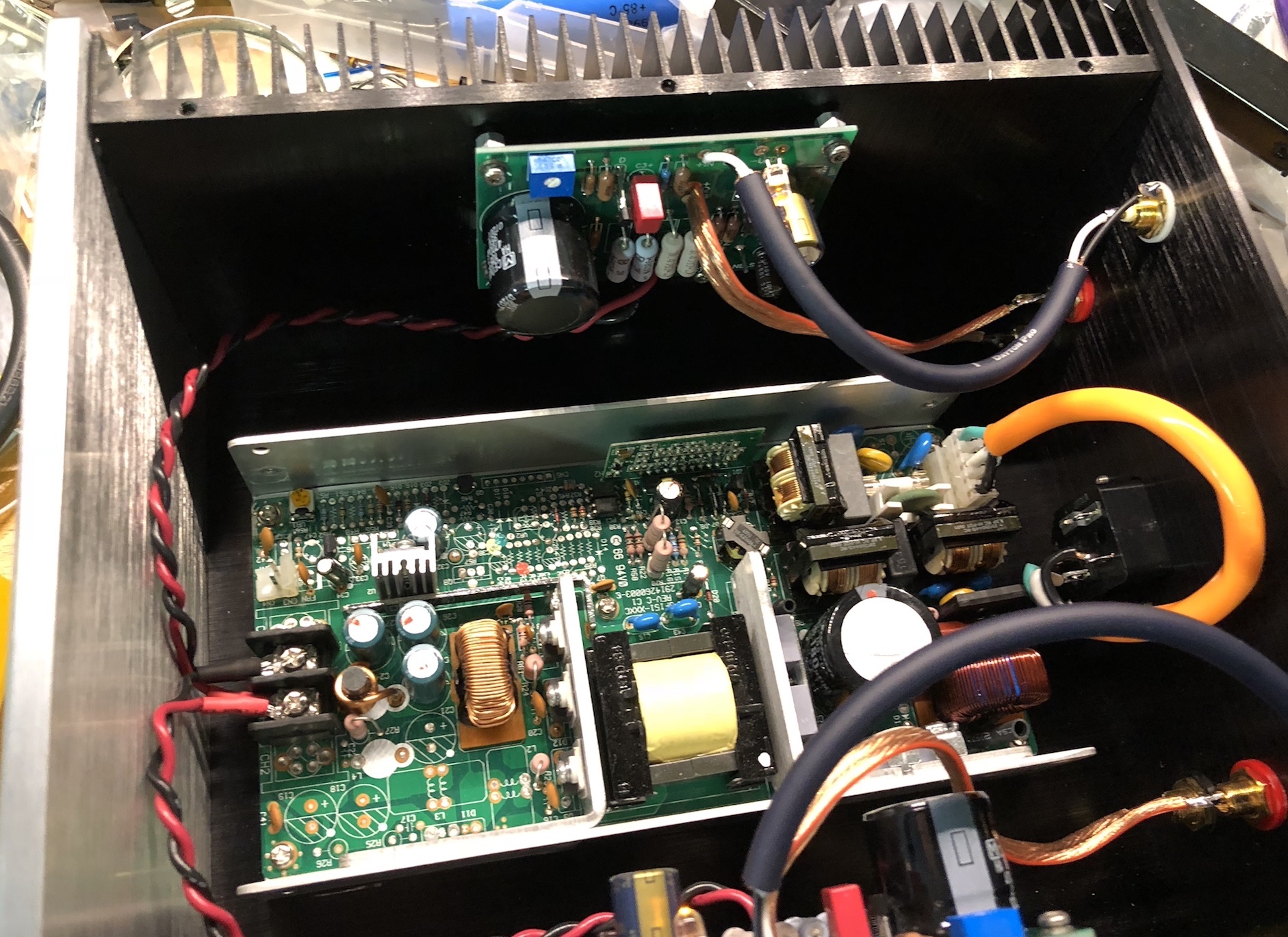

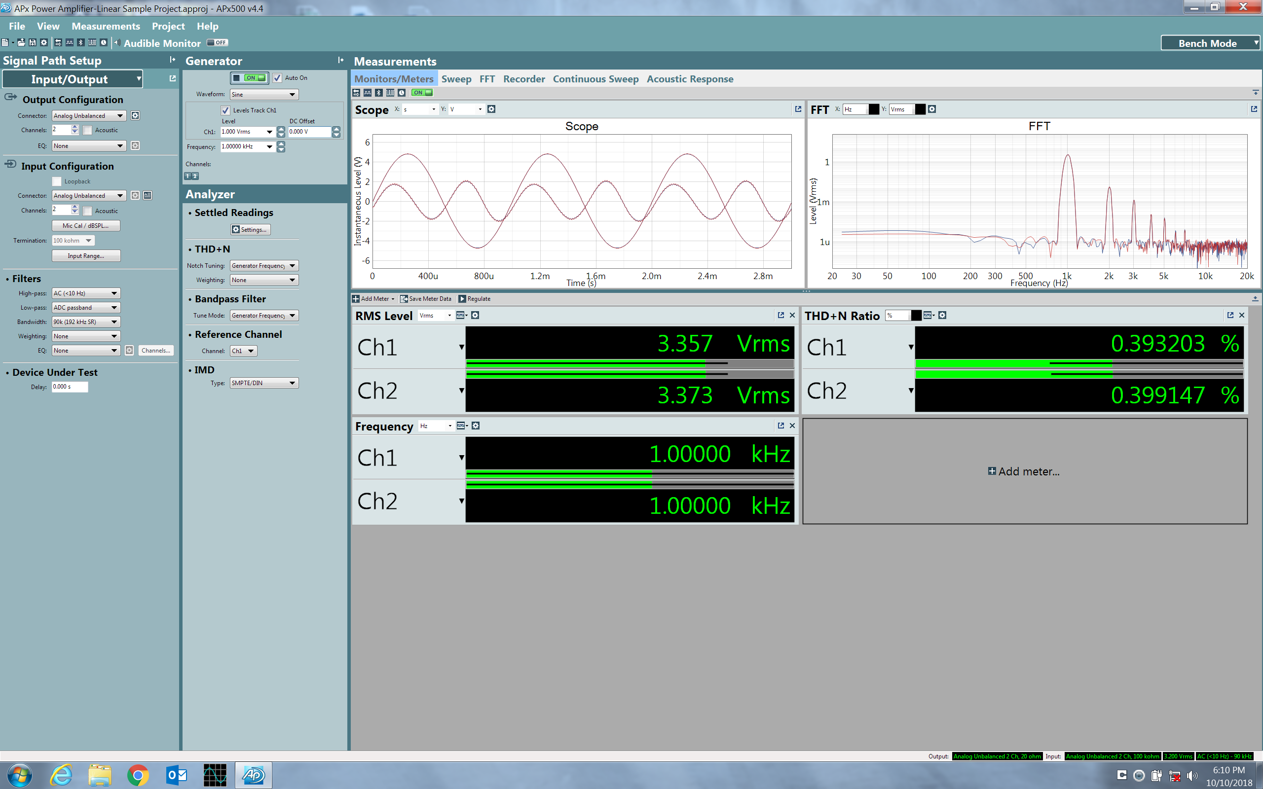

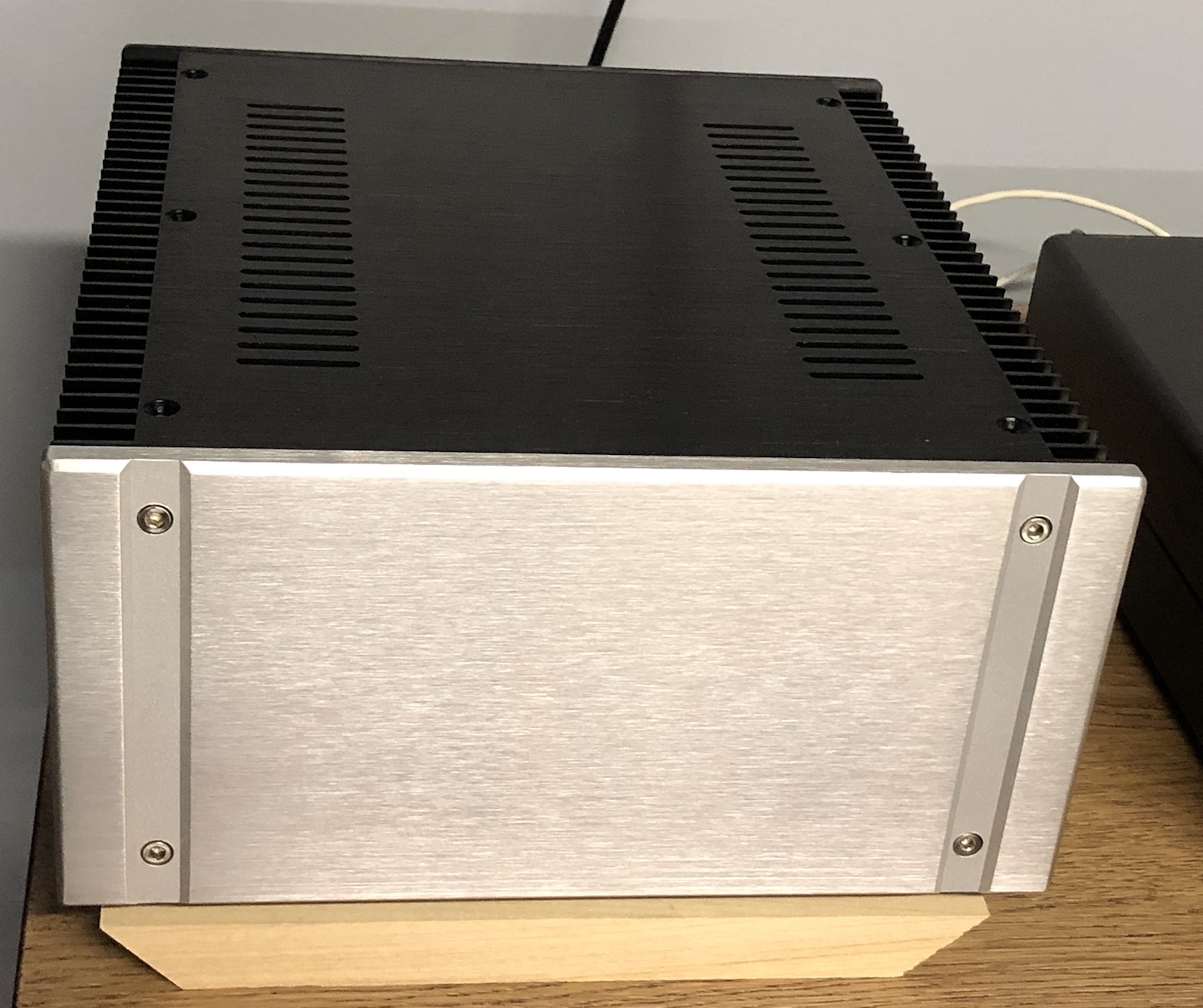

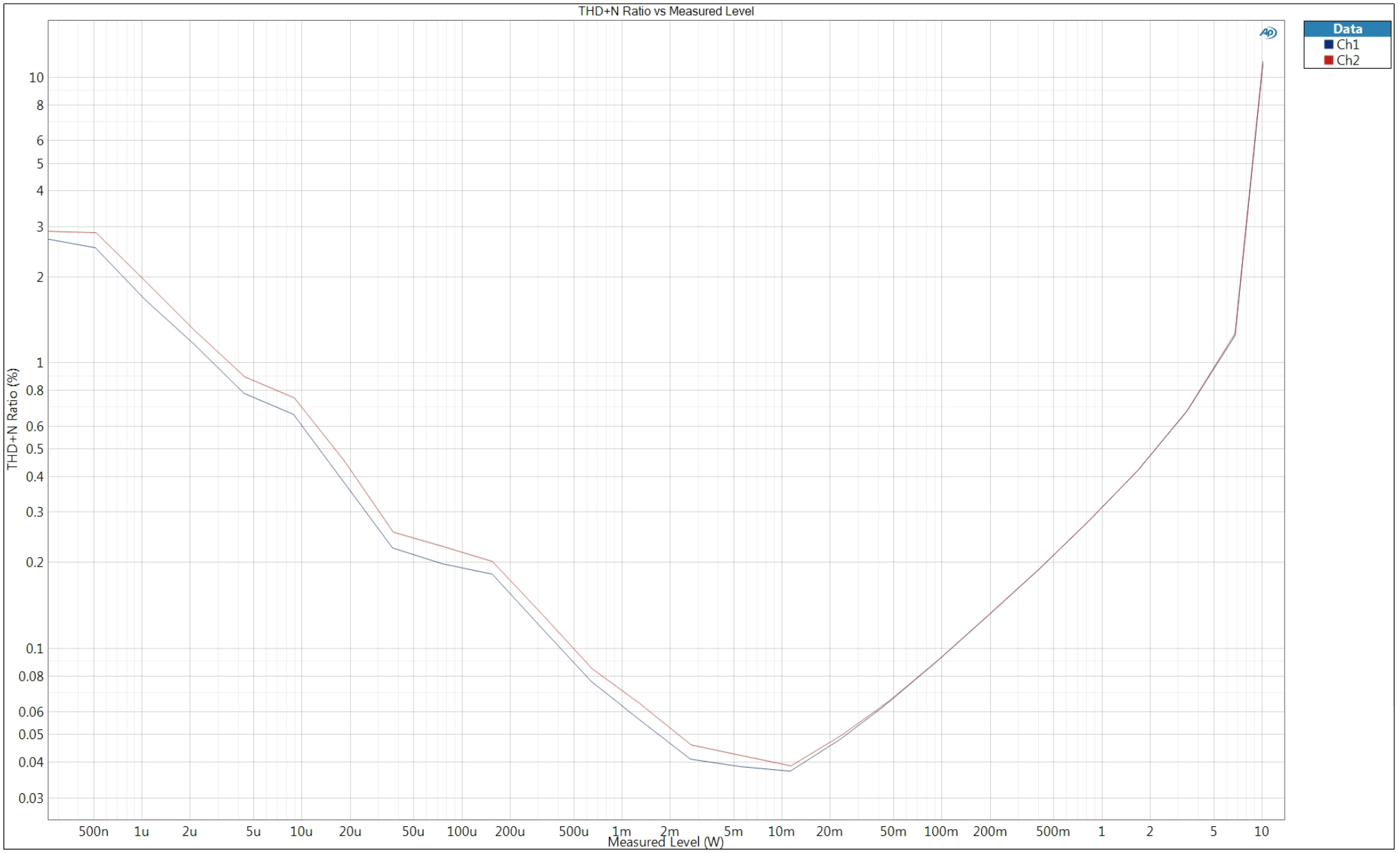

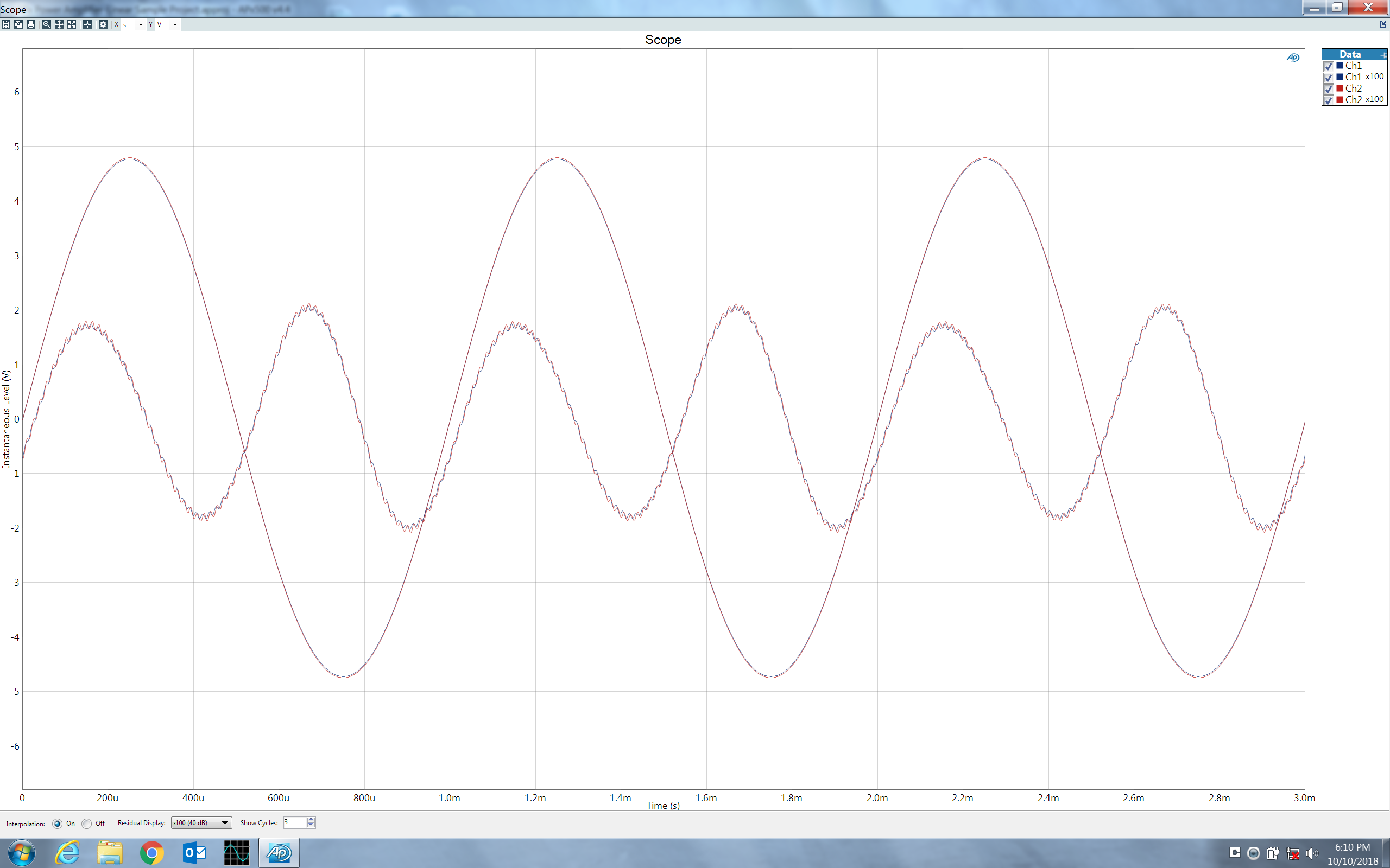

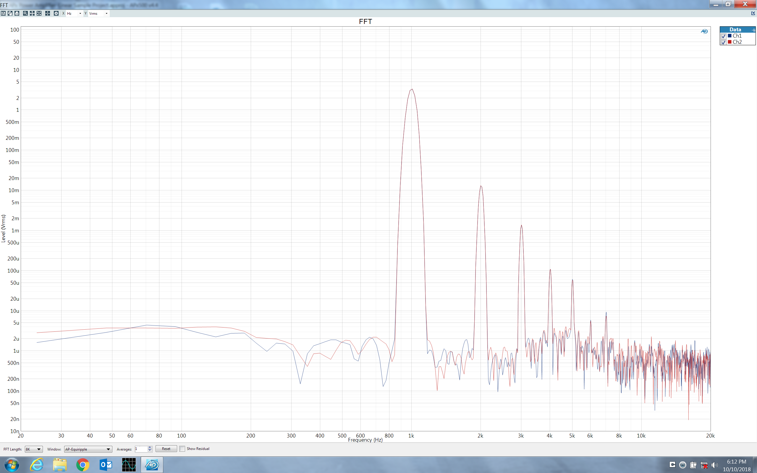

Here's the ACA I built from the boards I got from Burning Amp 2017, then I brought the finished amplifier back for Burning Amp 2018. I assembled it from a lot of surplus parts I had on hand, and I put the surplus 24V SMPS inside the chassis. I was worried about noise (SNR >90dB) and crosstalk (less than -70dB) but they both measured better than expected (see attached). I used an eBay chassis which is runs at about 60ºC when its 25ºC (I don't recommend this chassis). I used Dale RN55s for the most part and matched the resistors between channels, which helped achieve ~0.1dB channel matching. The unmatched IRFP240s were my leftovers from matching sets for an Aleph J, meaning they were far from being matched. I substituted the 10uF electrolytic coupling cap for a 1uF WIMA and it didn't seem to effect the LF. I used a 4700uF output cap because it was the only kind I had on hand that would fit the board.
I ran a few measurements on an AP with a 1Vrms input, and using 8Ω loads. The amp is biased to 12V.

Congratulations and I like the fan idea. It's a good deviation away from having to use the same standard heat sinks.
Nice work.
