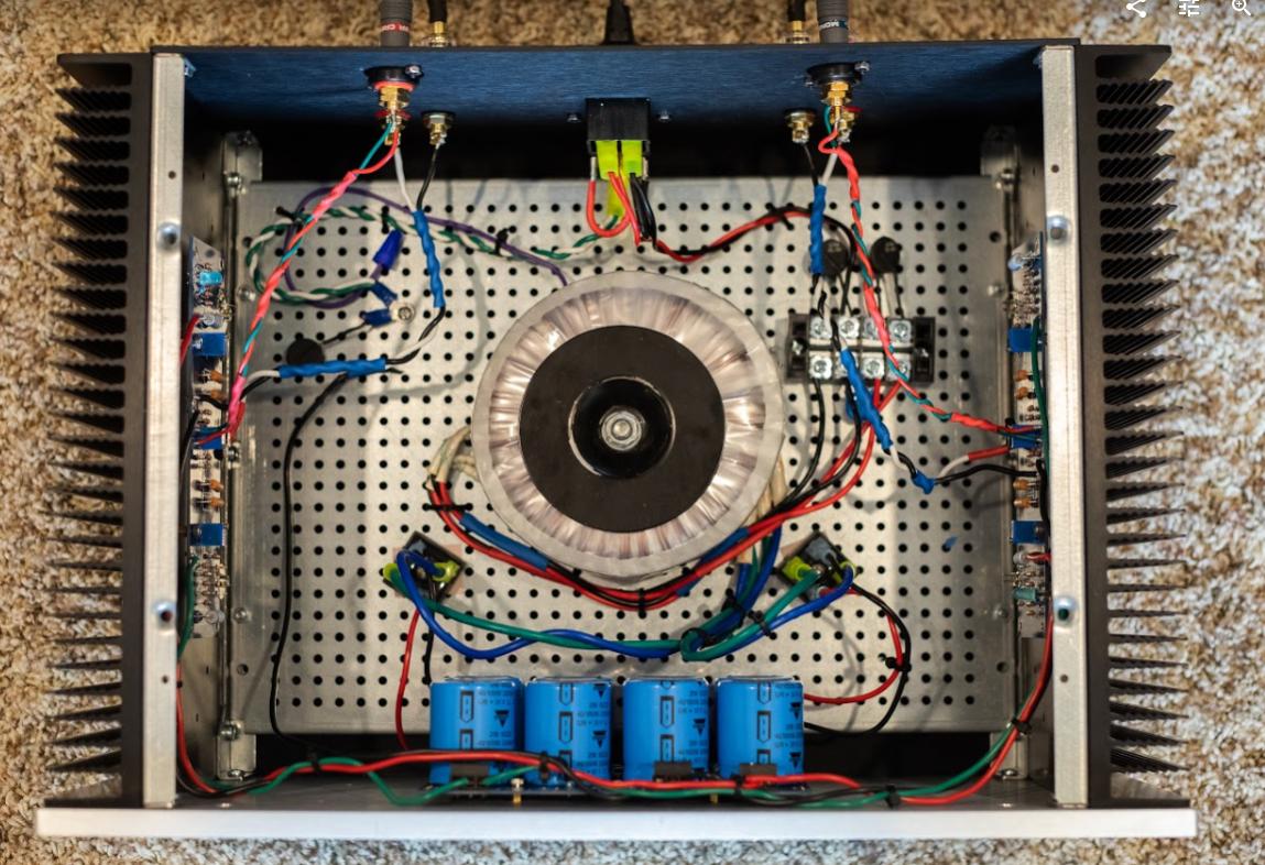

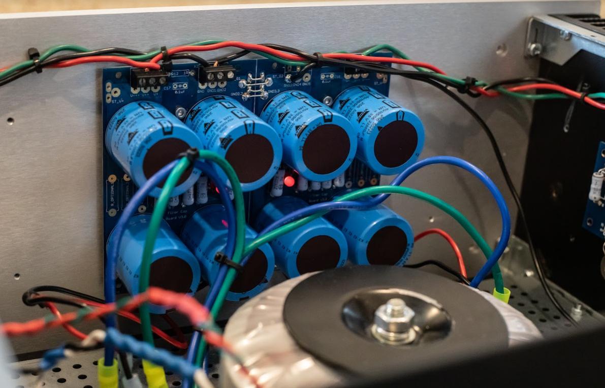

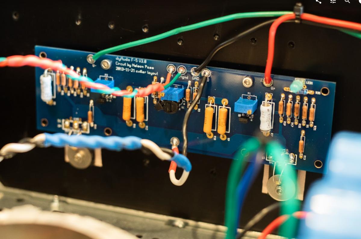

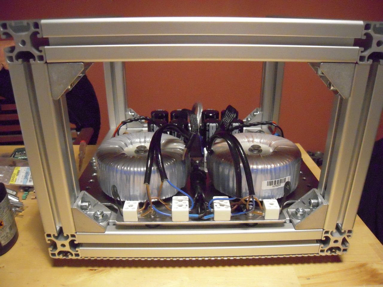

These pics are totally normal since I used all the standard stuff from the DIY store. While it's not too impressive compared to the fine projects in this thread, it felt like an accomplishment for me. I built the ACA which was fun but this project was a challenge for me and took lots of time putting together all the pieces, building it, problem solving, etc.
Next time I'll spend some time getting a custom front panel or something to make it look unique, put the LED holes on the front or something to make it more unique.

It is quite impressive, don't you worry about that. And it is unique cause you made it yourself. The most important question: how does it sound yo you? I see you use Schiit pre, is it a good match?

Very nice build. What’s the cost of all the parts?
The amp sounds incredible! I’ve never heard anything so crisp and clear. Good recordings sound amazing. It’s like I can hear if the guy playing the stand up bass clipped his finger nails that day or not. A brush on a snare drum sounds like you can count the metal wires sliding across the surface. With electronic music it’s a bit more difficult because a bad sample or two in a loop is so obvious that it distracts me, but a good professionally mastered recording sounds awesome.
The Schiit pre works good with this amp vs the ACA. It has three modes; a passive stage, a JFET buffer and a tube gain stage. The JFET is gain +1 and the tube is gain +5. The ACA in balanced monoblocks sounded sweet with the buffer mode but I’m pretty sure it was clipping if I turned on the tubes because it sounded off. With the F5, I can turn on the tubes no problem. It seems to like it and it’s much louder. However I will say the only sonic difference is the loudness. The tubes don’t add a better sound to the amp.
At some point I added all the costs up and it was about $700. But I bought the pieces over 8 months so it wasn’t too bad. Well worth it, for the sound and for the experience. So much fun.

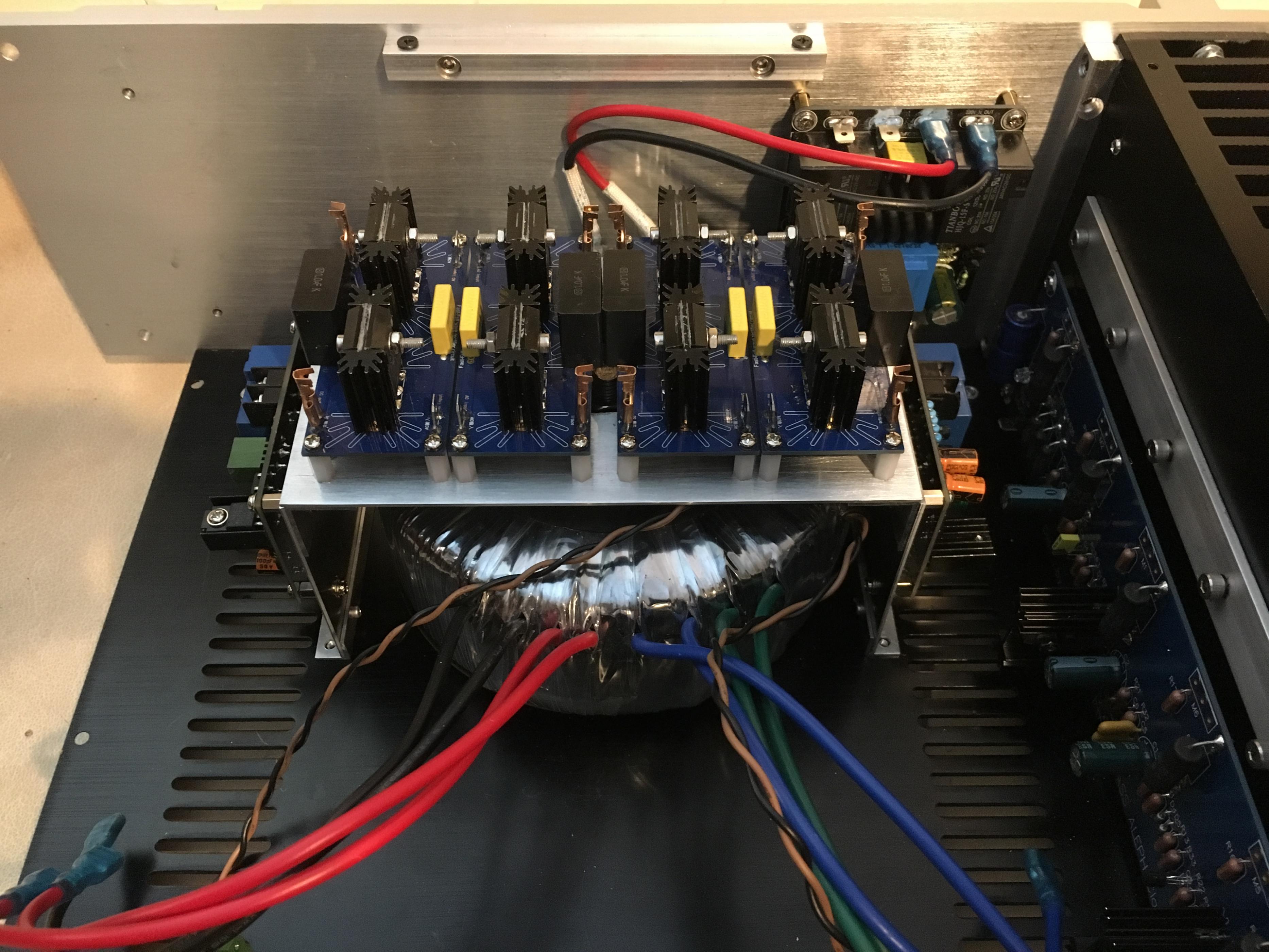

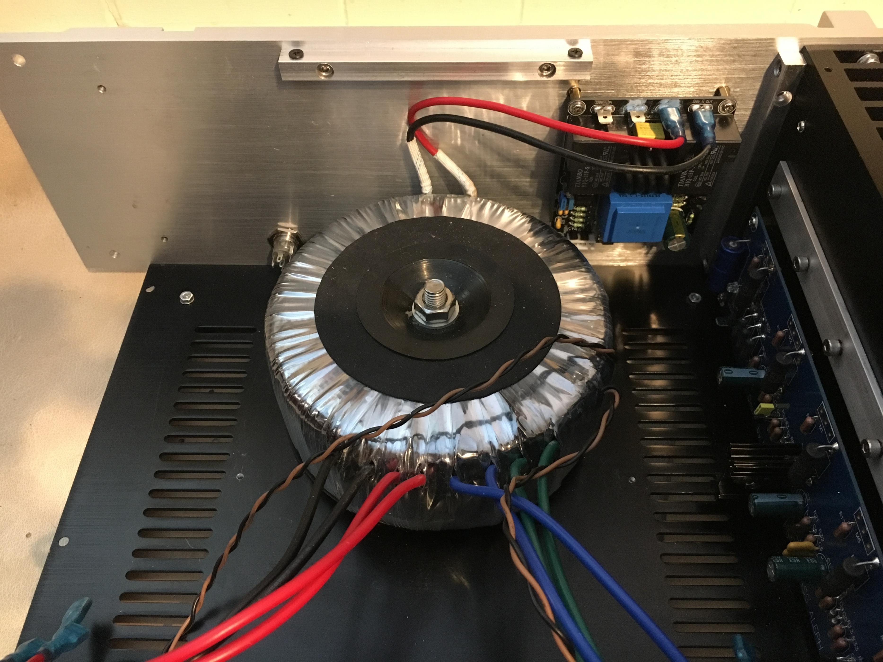

My third amp build, my second power amp, and my first PASS amp!
Unlike previous builds I leapt into buying kits/parts before doing much research. I wanted to go Class A and the Alephs were adjustment free. I'm now thinking I should have gone much bigger on the case/heatsinks!!! I will probably end up cranking down the bias 🙁 or putting a couple of 12v PC fans wired in series... As it is, I've had to think laterally on how to fit all in to the case... The trafo is huge!

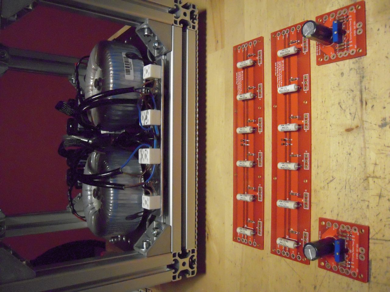

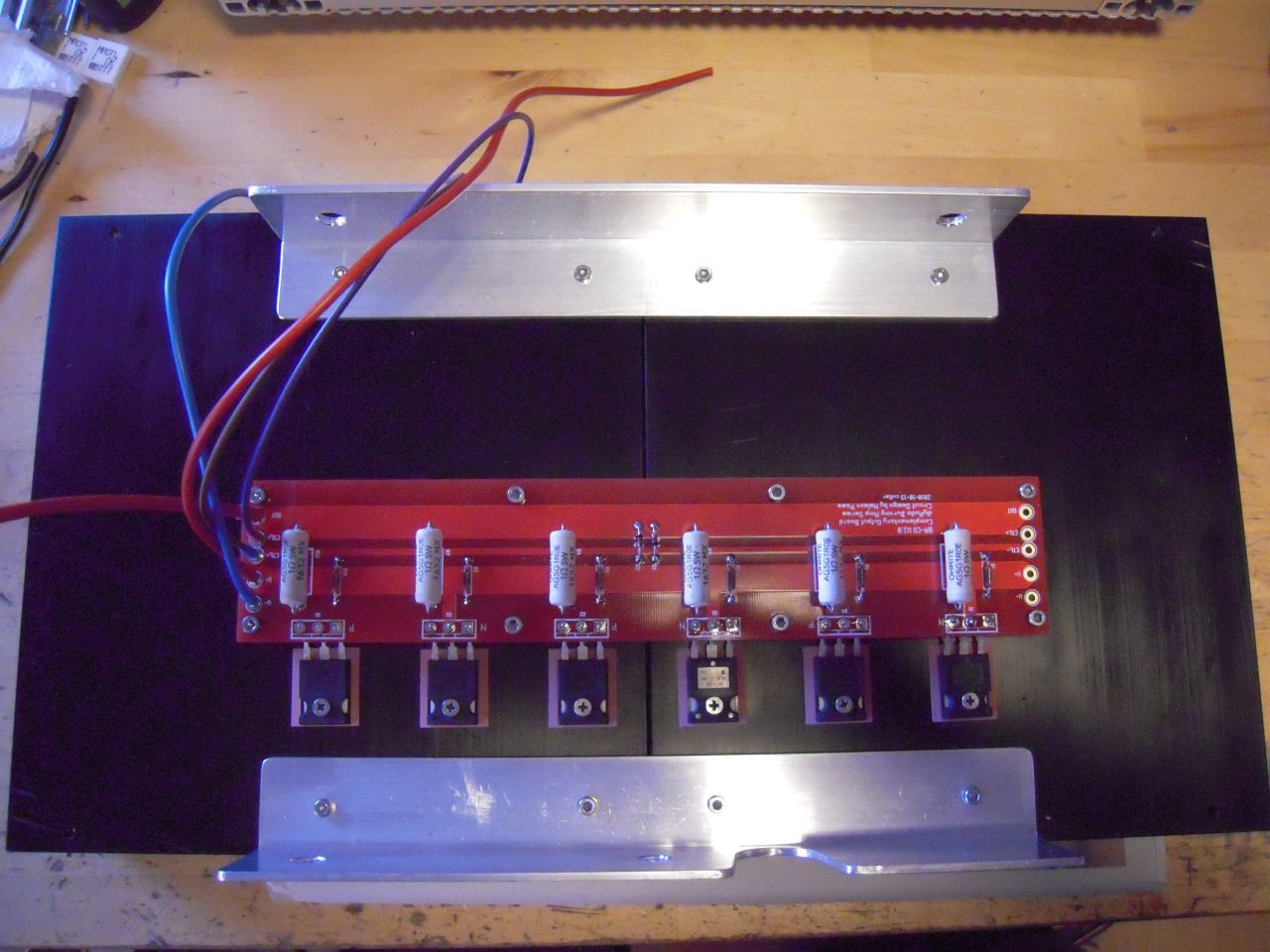

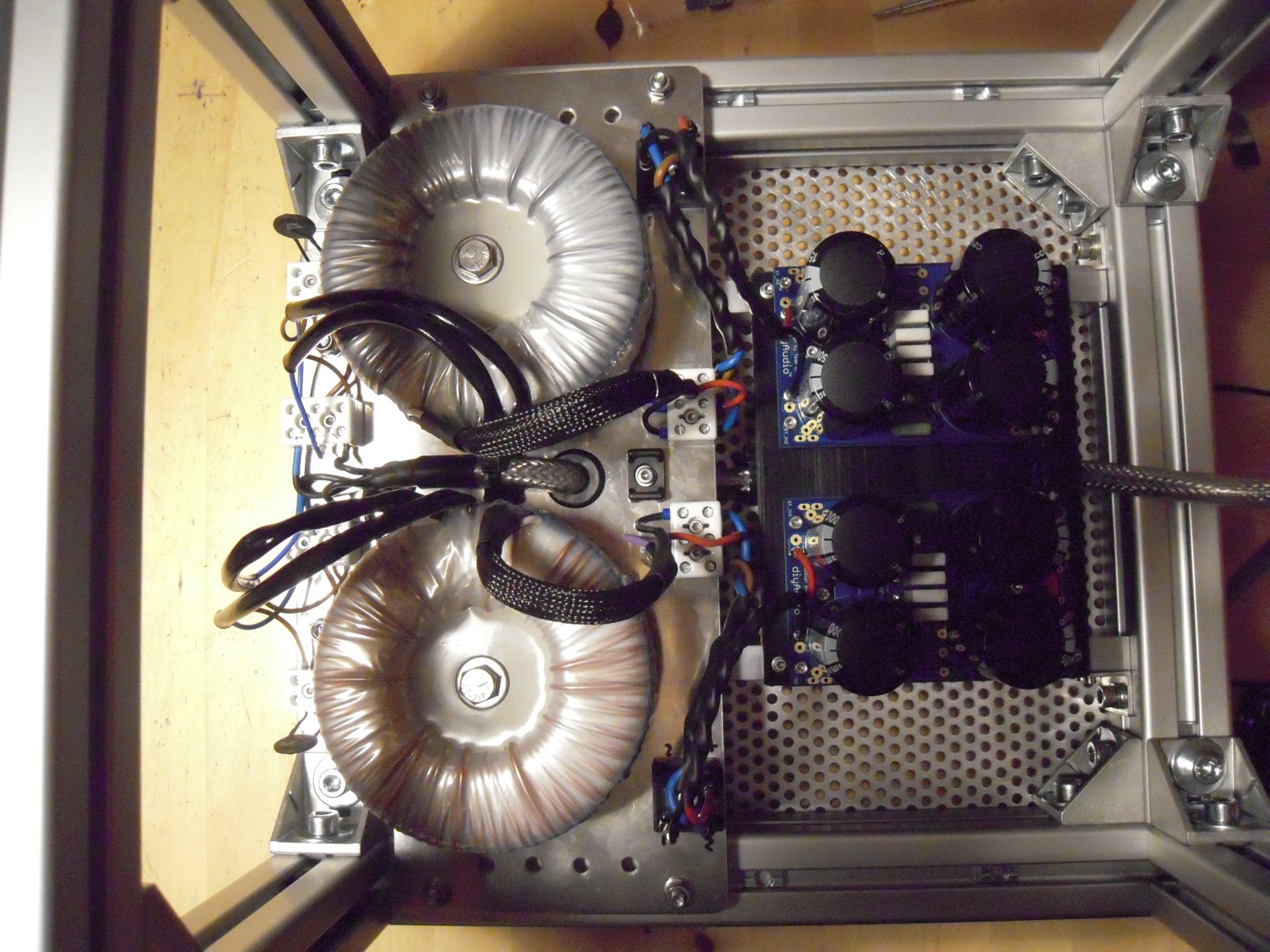

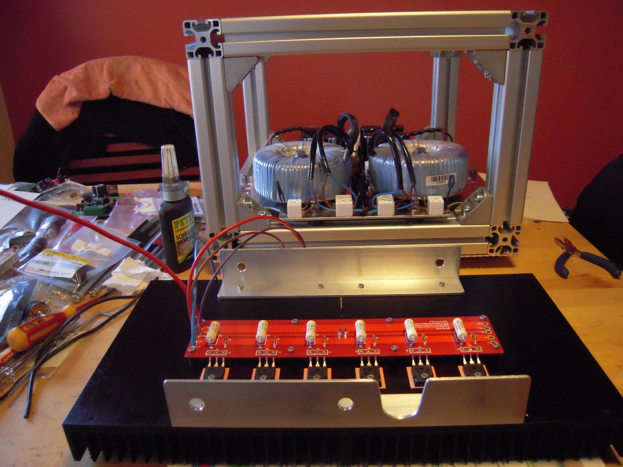

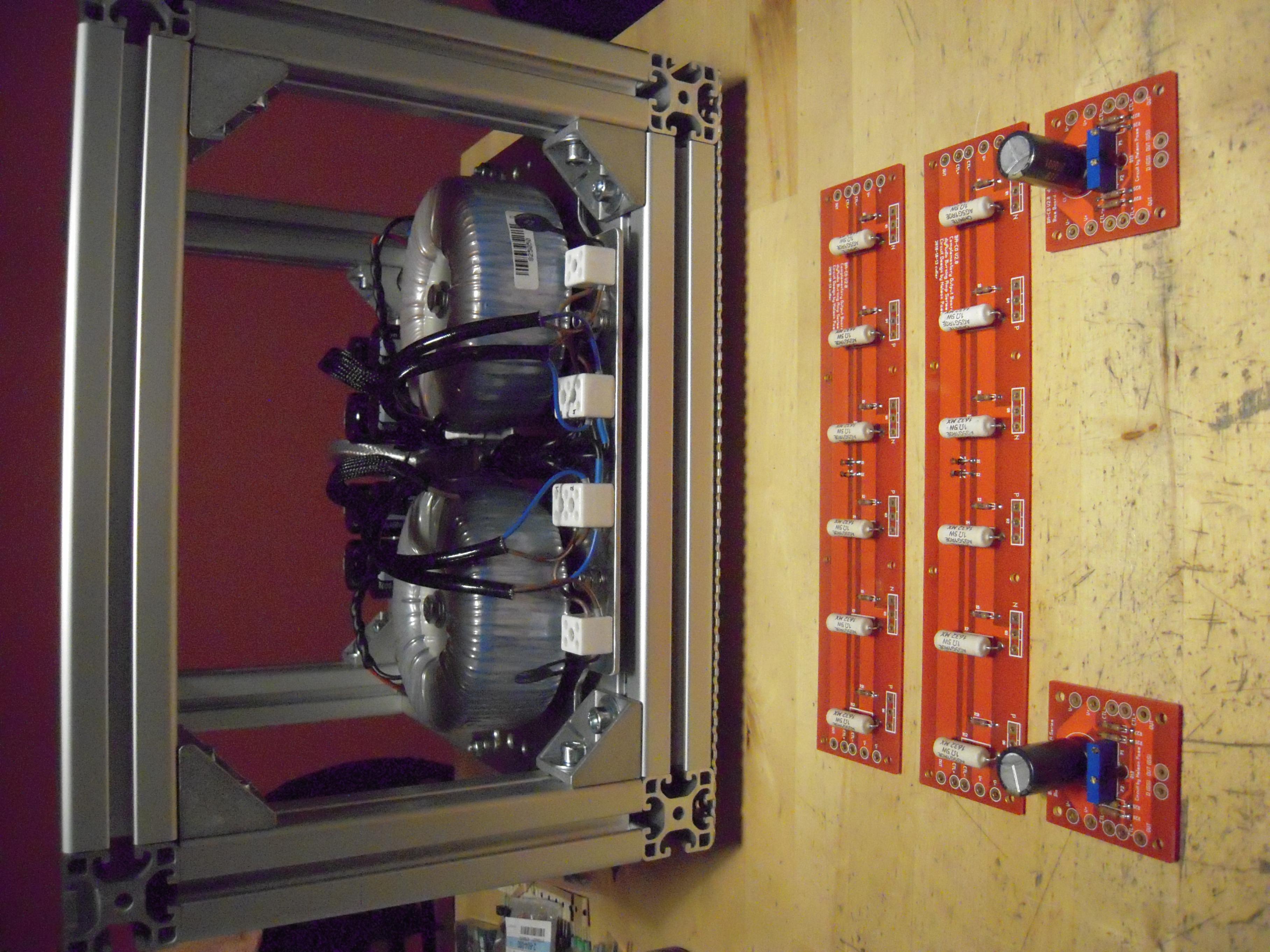

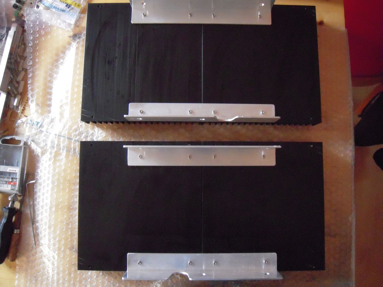

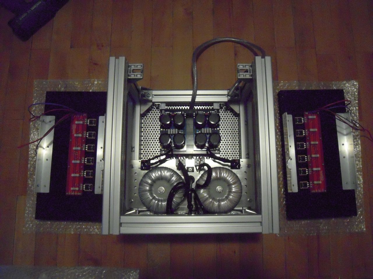

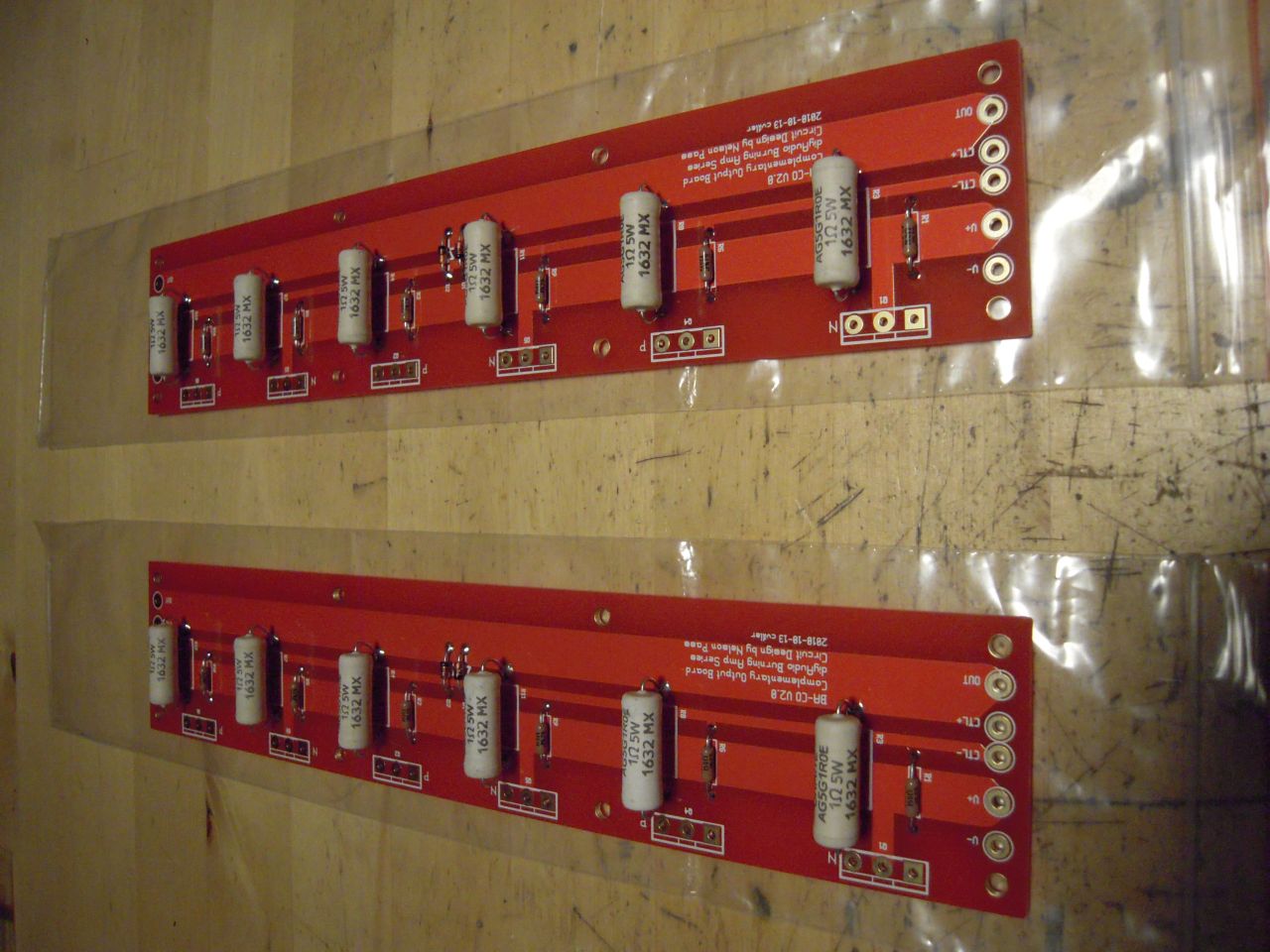

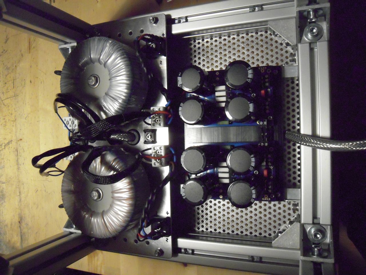

A new BA-3 continues
I was working a little bit on on my BA-3.
Trafos are from Sedlbauer (300W each, output is at 24,4V)
PSU is running and tested at +/- 34,6 V (I expected around 33V)
Stuffing the `heaters`with the matched FETs.
Greets from Dirk
Greets from Dirk

I feel like your PSU rectifier heat sinks will be too small. Just something to keep in mind as you bring your new amp into service.
