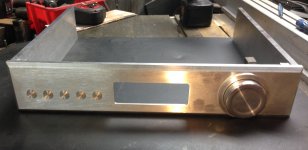

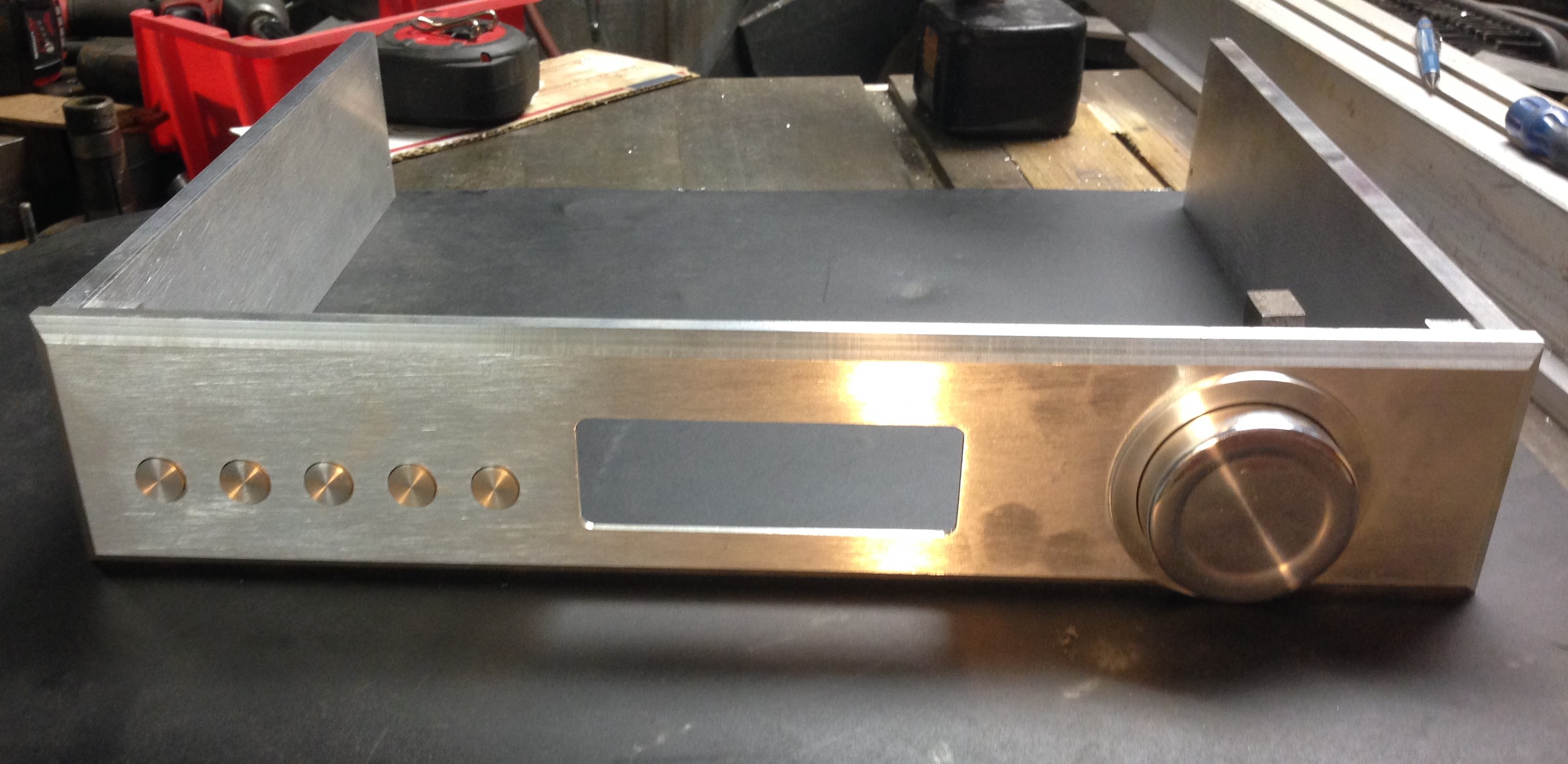

I'm probably one of the worst 'machinists' on the globe. Most everything I make ends up smaller than intended because I have to keep trying
Still, for me half the fun of DIYA is making the chassis, and using scrap doubles the challenge!

damn! I've cut trice and it's always short!![]()
Ha - come up with a way to cut something and have it be LONGER than what you started with and there a handsome reward (plus an early retirement) in it for you 😀
mpmarino: I presume you do your work on the table saw in your image. What type of blade are you using? I've got a compound mitre saw and a table saw, but have never tried cutting metal with either one.

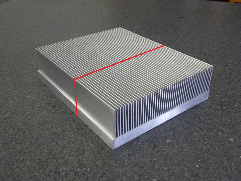

Understand we are getting a bit OT on the thread, but since a discussion is going on around cutting aluminum, can anybody advise a good way to cut a heat sink across the fins? Picture below - cut would be following the red line.

Get the highest tooth count you can find. I use an 80 tooth carbide on my table saw at full speed for alu.
And yes, the chips are hot and they sting. 😉
you might be correct- I'm probably using an 80 as well. Bad memory.
Table (circular saw) works fine too. I'd strongly recommend using some kind of cutting fluid (i've used sewing machine oil, but I believe the best practice for aluminium is wax, and you don;t need heaps, just get a thin layer on the job), and the highest tooth count you can.
I'd also say, go slowly! I've (unthinkingly) started pushing the job through at a hardwood sort of pace, and had the ally bend and not be cut. The noise was loud, and scared the absolute bejeebers out of me.
I'd also suggest you stand clear of where the job might go should something untoward occur; ie do not stand directly behind it in case it gets spat off the saw at a high speed...
And finally, make sure to cleanup afterwards asap. Oily little chips of ally get absolutely everywhere, and will mess up your clothes, carpets etc etc
