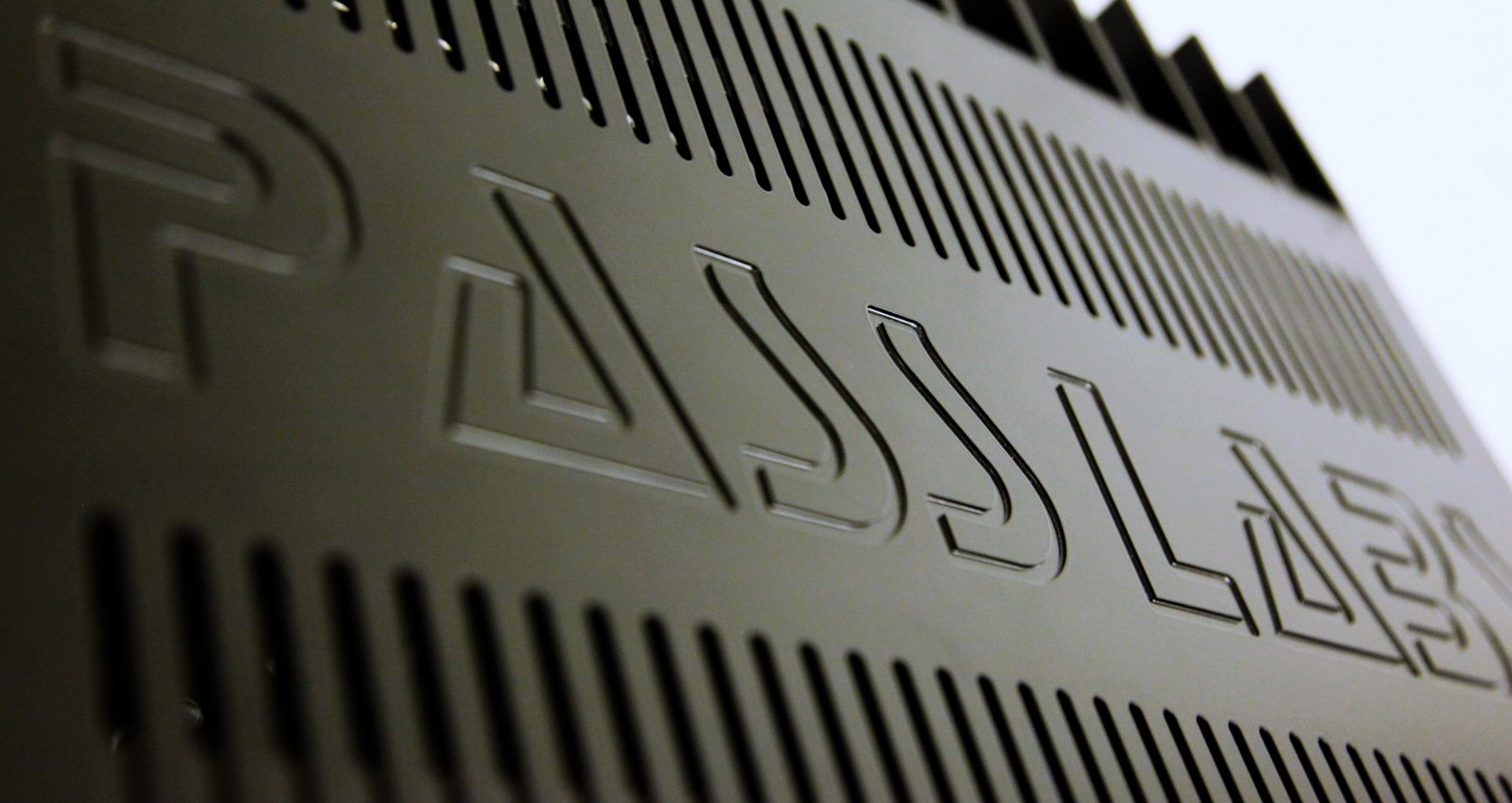

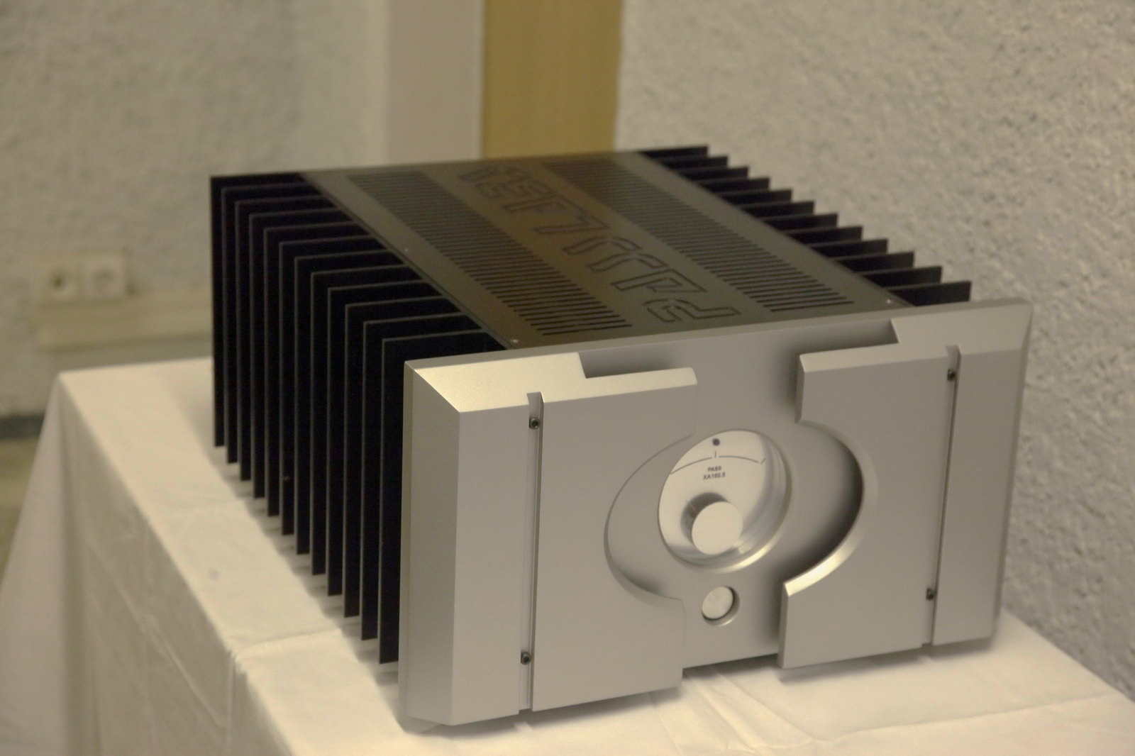

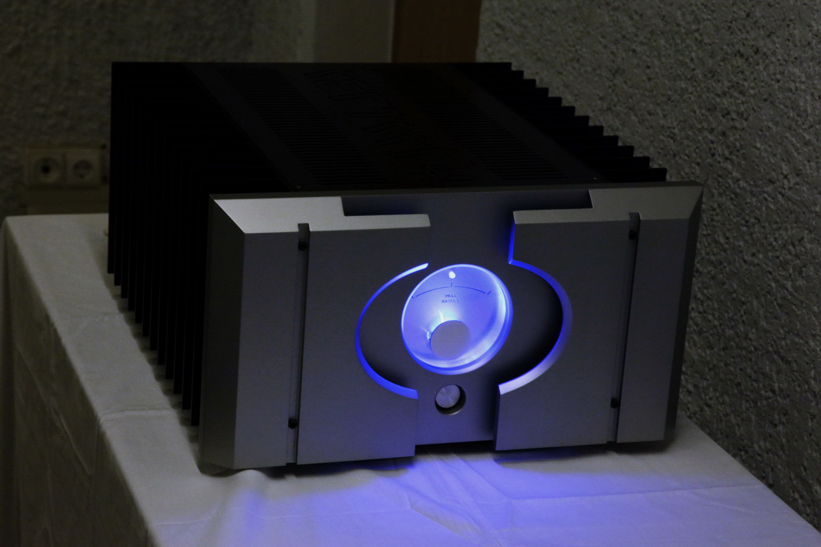

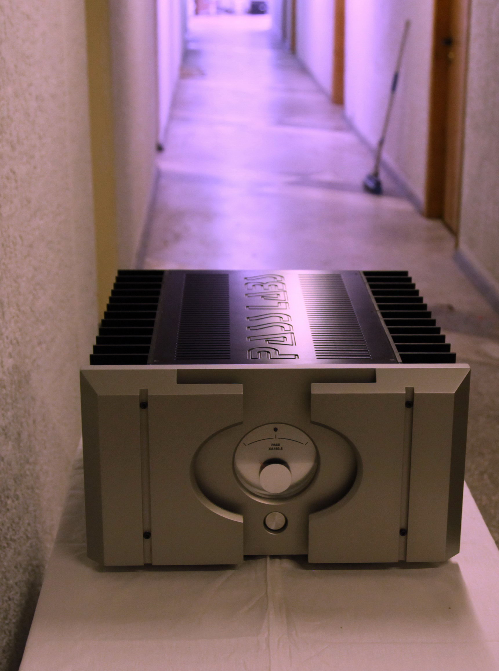

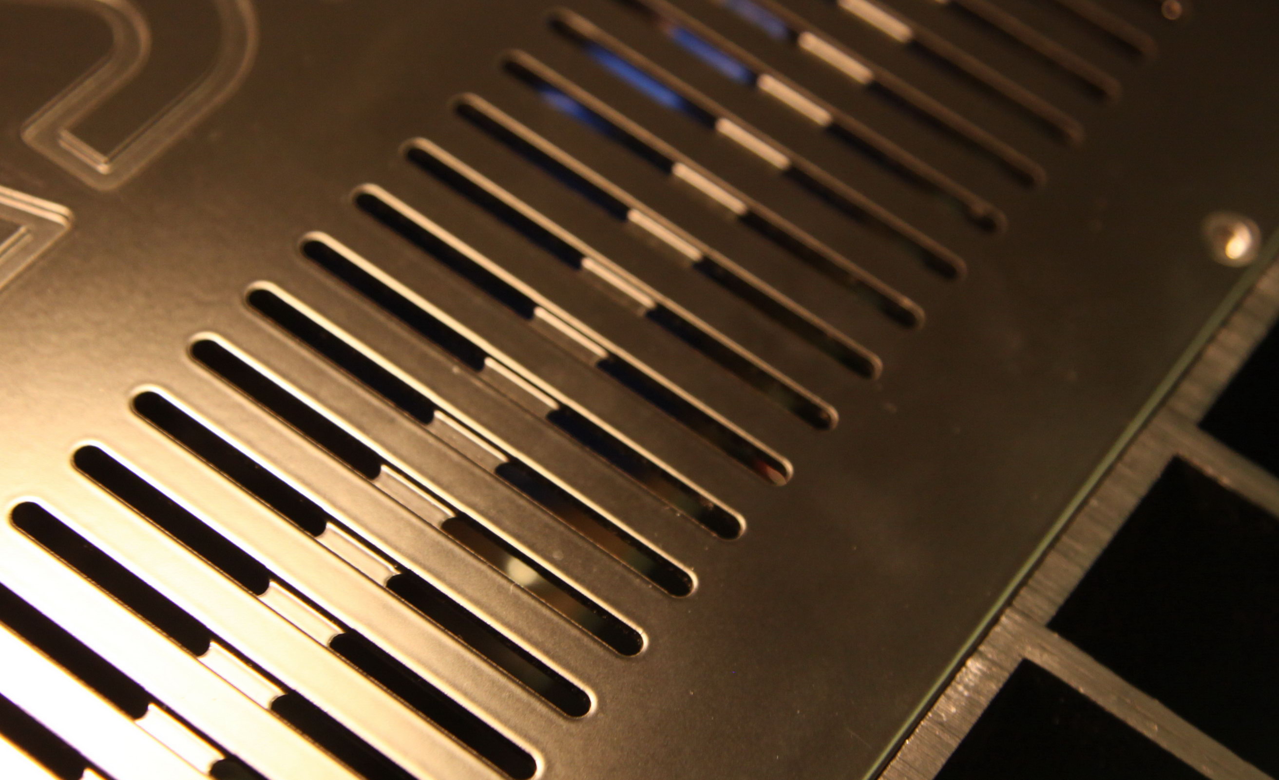

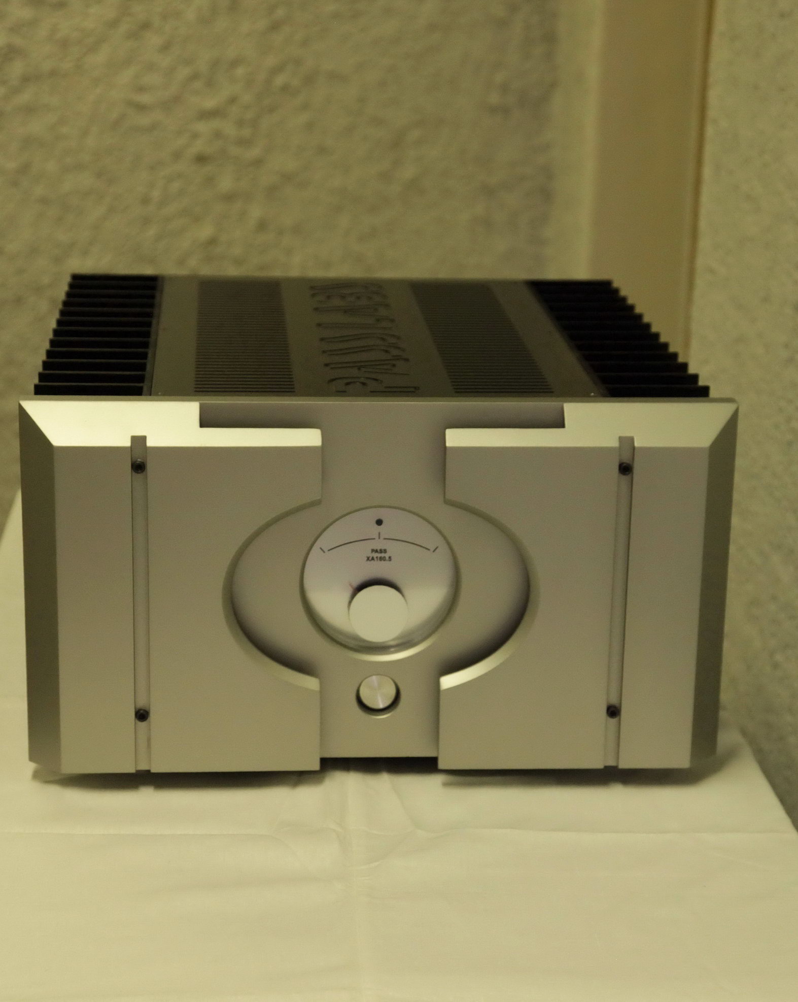

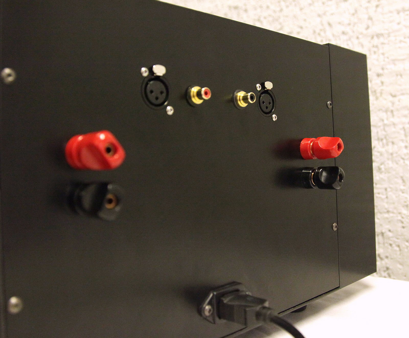

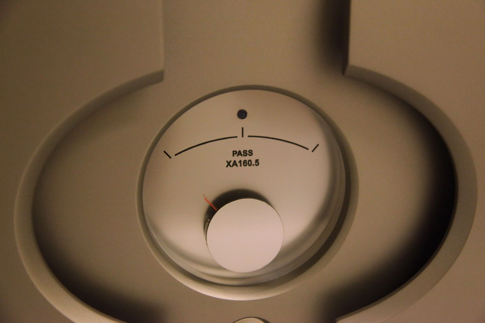

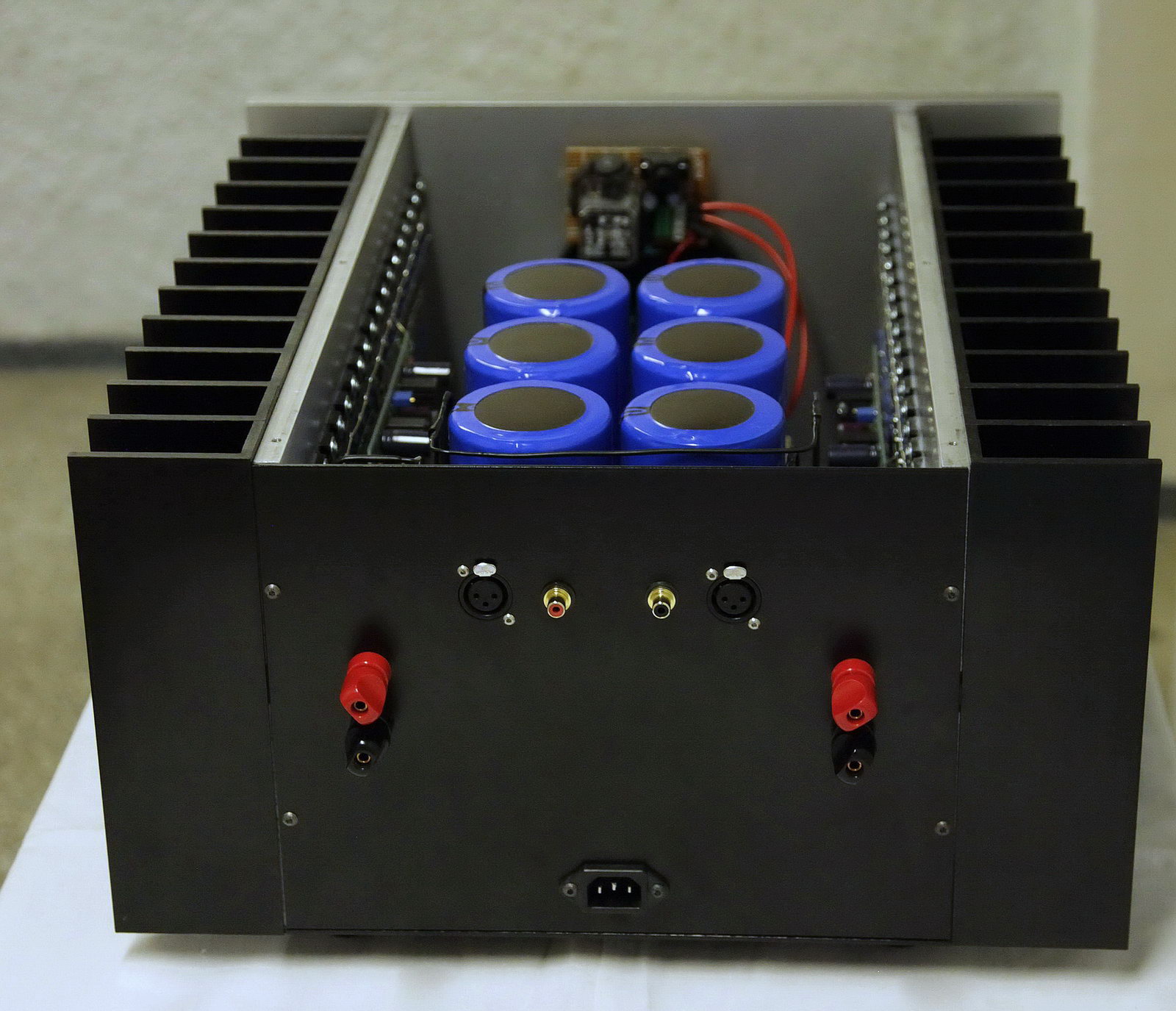

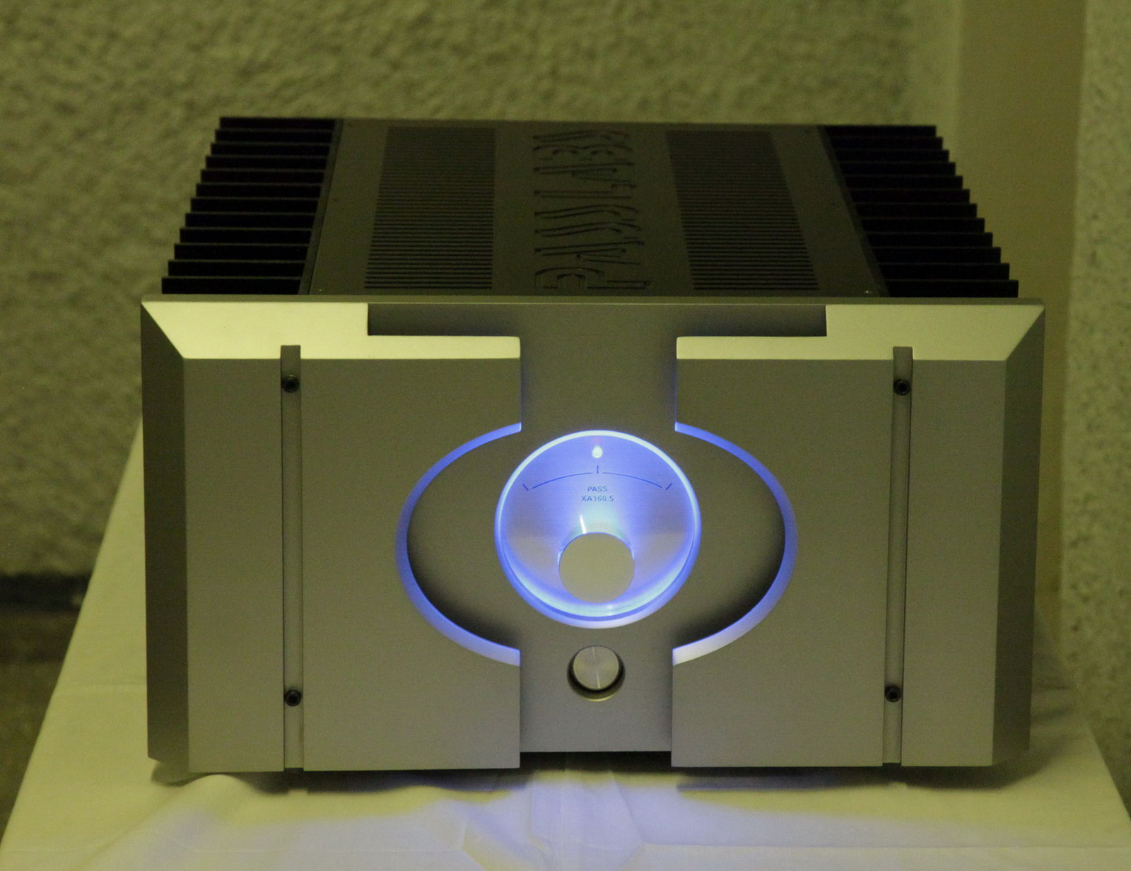

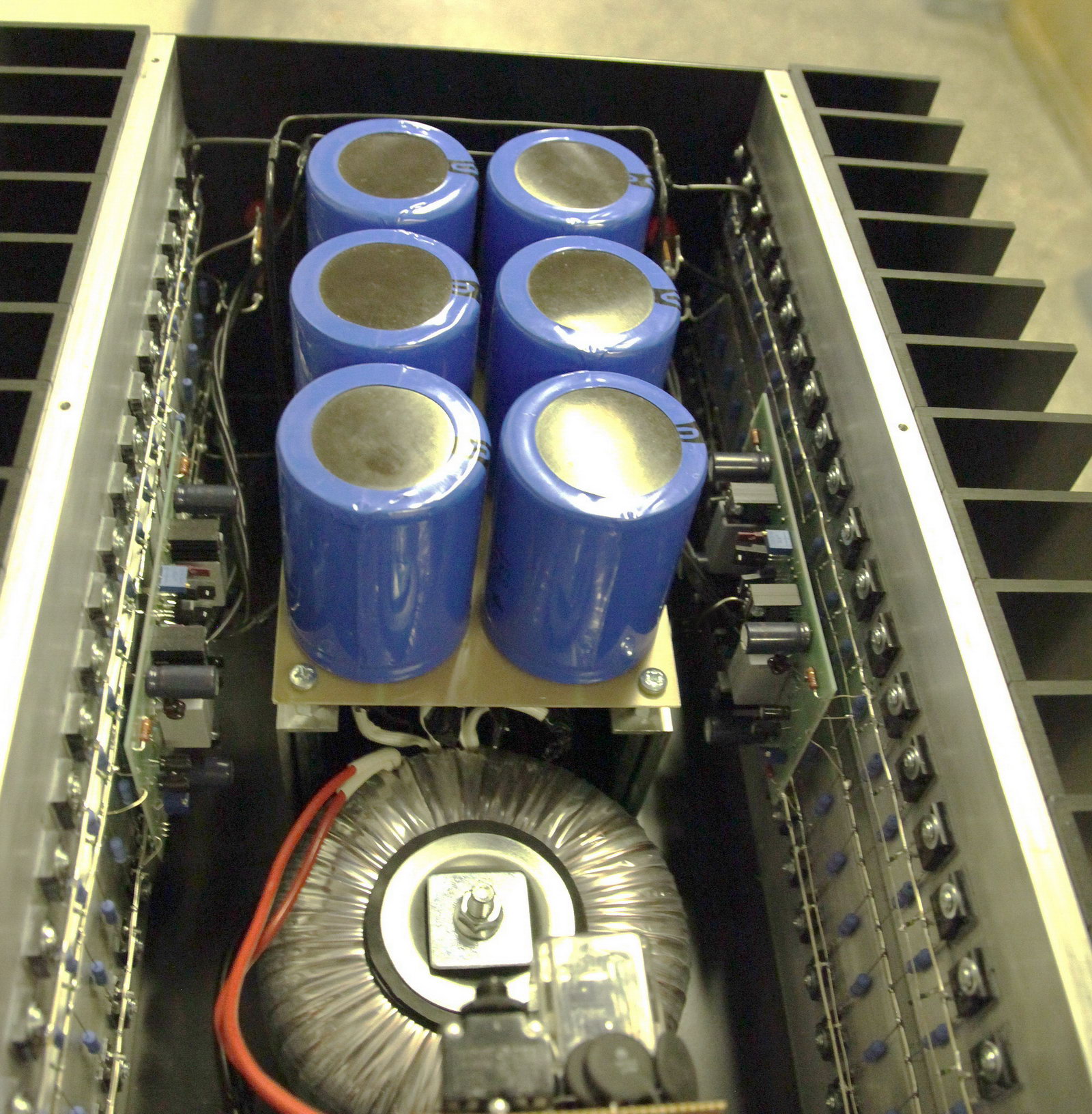

Here is my beasts stereo XA100.5 in XA160.5 enclosure. Wired in pure solid silver,Mundorf Cooper binding posts, cooper rhodium plated IEC sockets etc etc.
Differencies from stock xa.1005 - more beefy powersupply caps,added soft start circuit with 6000W relay, resetable fuse, standby circuit removed,as wel as gain jumper. Also added ability to use direct coupled input (ommiting input caps) when using internal jumpers, front dial circuit is also redesigned/simplified.
How those babies sounds? - one word- Awwwwesooooome!!!

top plate CNC
Looks very nice, did you use an old XA160.5 chassis to build a stereo amp in it? Heatsinks are not PassLabs...
Thanks !
