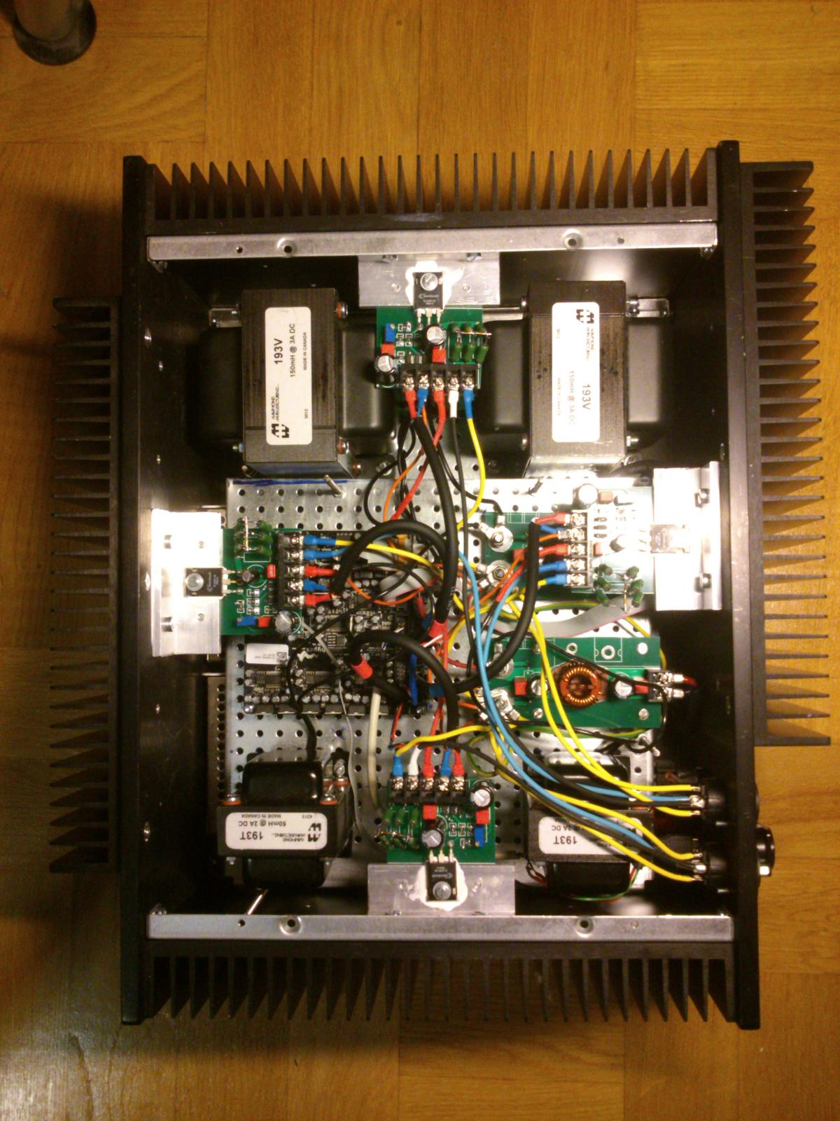

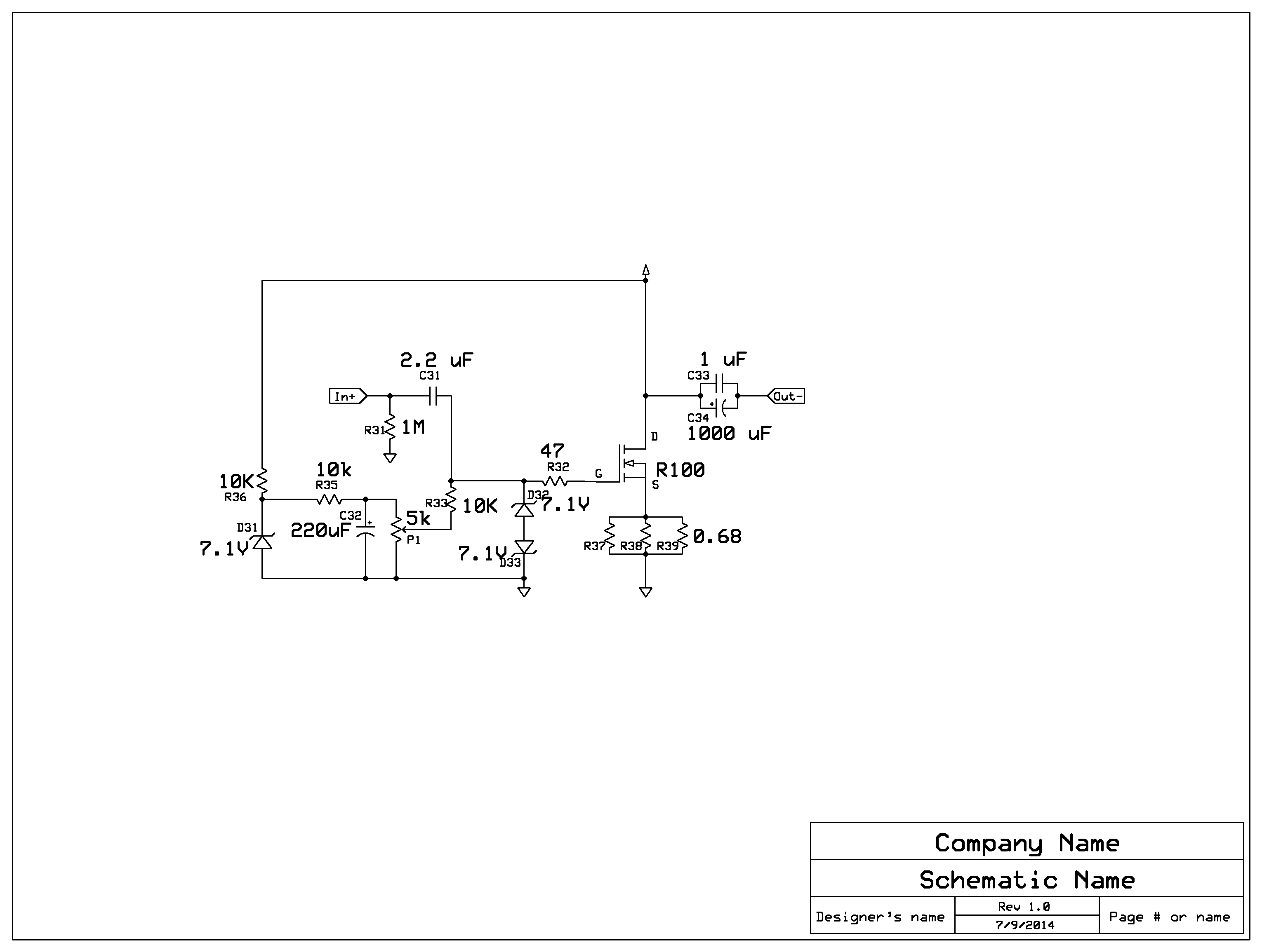

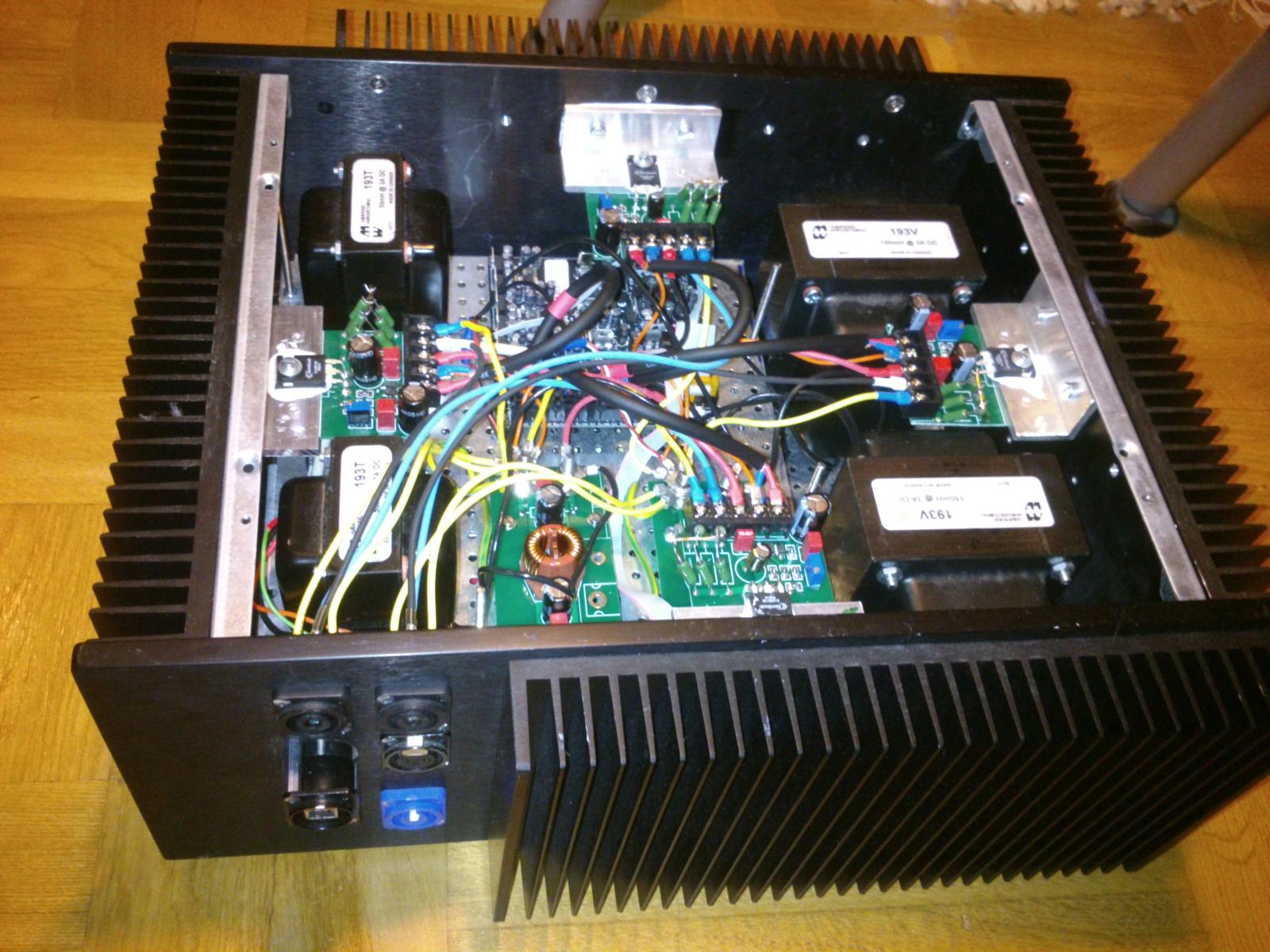

It has been a while but at last it is finished!
4 channels was once F2Js but now have become something else, I jokingly call them F2I =). So single ended inductor loaded R125s. 2 bigger amps with Hammond 193Vs and 2 smaller tweeter amps with 193Ts.
Below the metal platform there are 2x 150W SMPSes which output ~ 26.5V. There is also a Hypex DLCP SMPS hiding there too =)
The reason for such a high voltage is that my speakers (which are not yet finished 😉) are 16 ohm. The bigger amps run at 1.8A and the smaller ones at 1.4A. There are no parallel resistors either as I love current sources! The drivers the amps are meant to driver are my mids and my tweeters.
The input is AES/EBU and the source is a 6 channel Hypex DLCP DSP board.
And a word of advice, if anyone wants to try to cram this much stuff into such a small box... don't 😛
I hope I never have to service it, if I have to I might just buy a new bigger box instead because I can't really access the the SMPSes without taking everything apart.

witty
though , decent buffer in front of Semisouth wouldn't harm
I thought about doing buffers, but as the output impedance on the DLCP is 100 ohm it should be OK without considering I don't have any passive volume management in between. I have some PCBs lying around for a BF862 powered B1-esque amp but never got around to assemble them as it should be overkill =)
