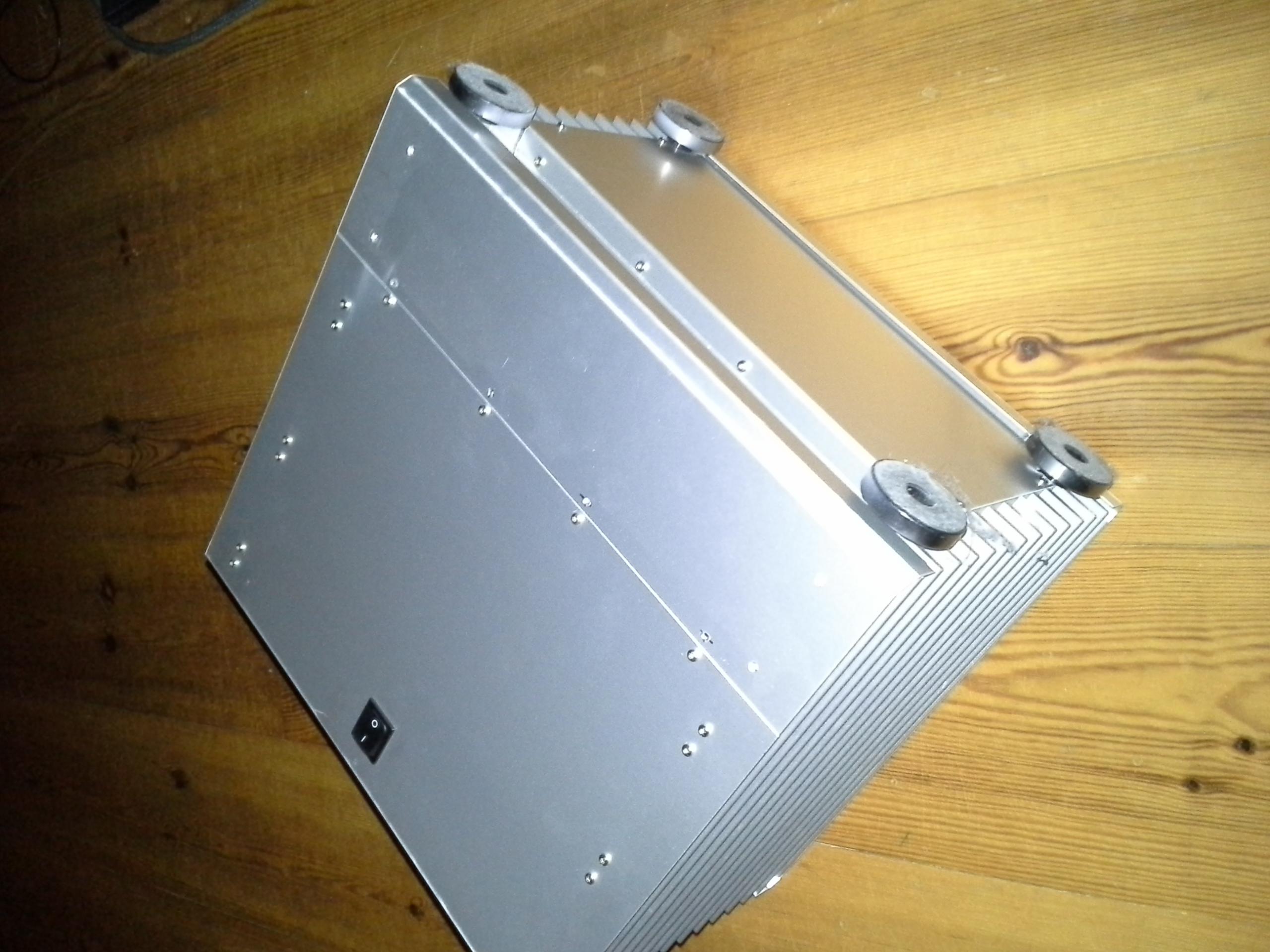

But I agree with Walter from Utrecht, is a good solution in use the 1mm aluminium, but is folded when that happen became stiffest than a similar of 4mm. The solution of the vertical connection to the 230v is a very handsome idea. And the rest of connections are not exposed and are protected by the hall space behind the amp. If you let me copy to you because I have a similar more tall than wide heatsinks making a cube. Beautiful DIY producto Señor.

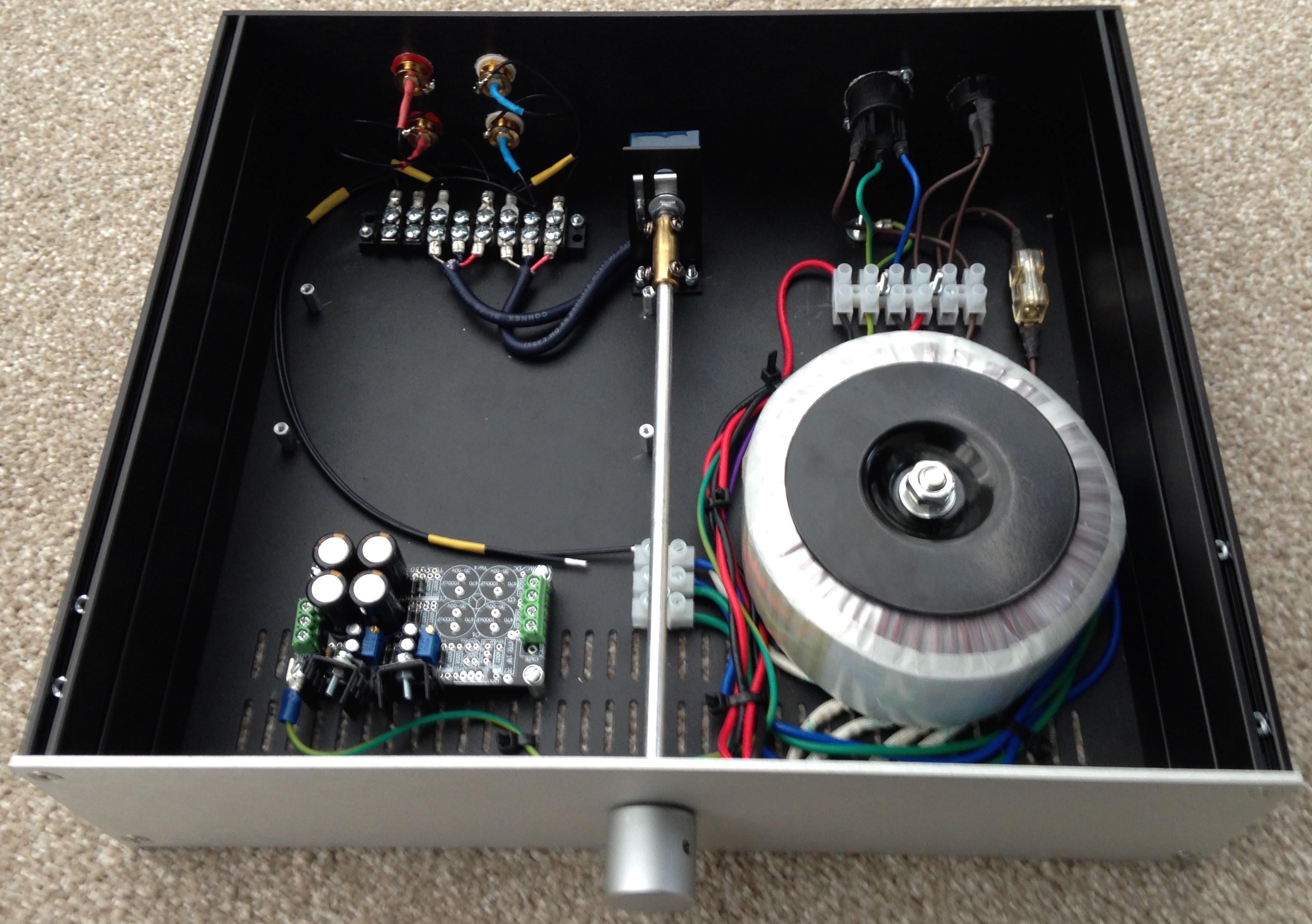

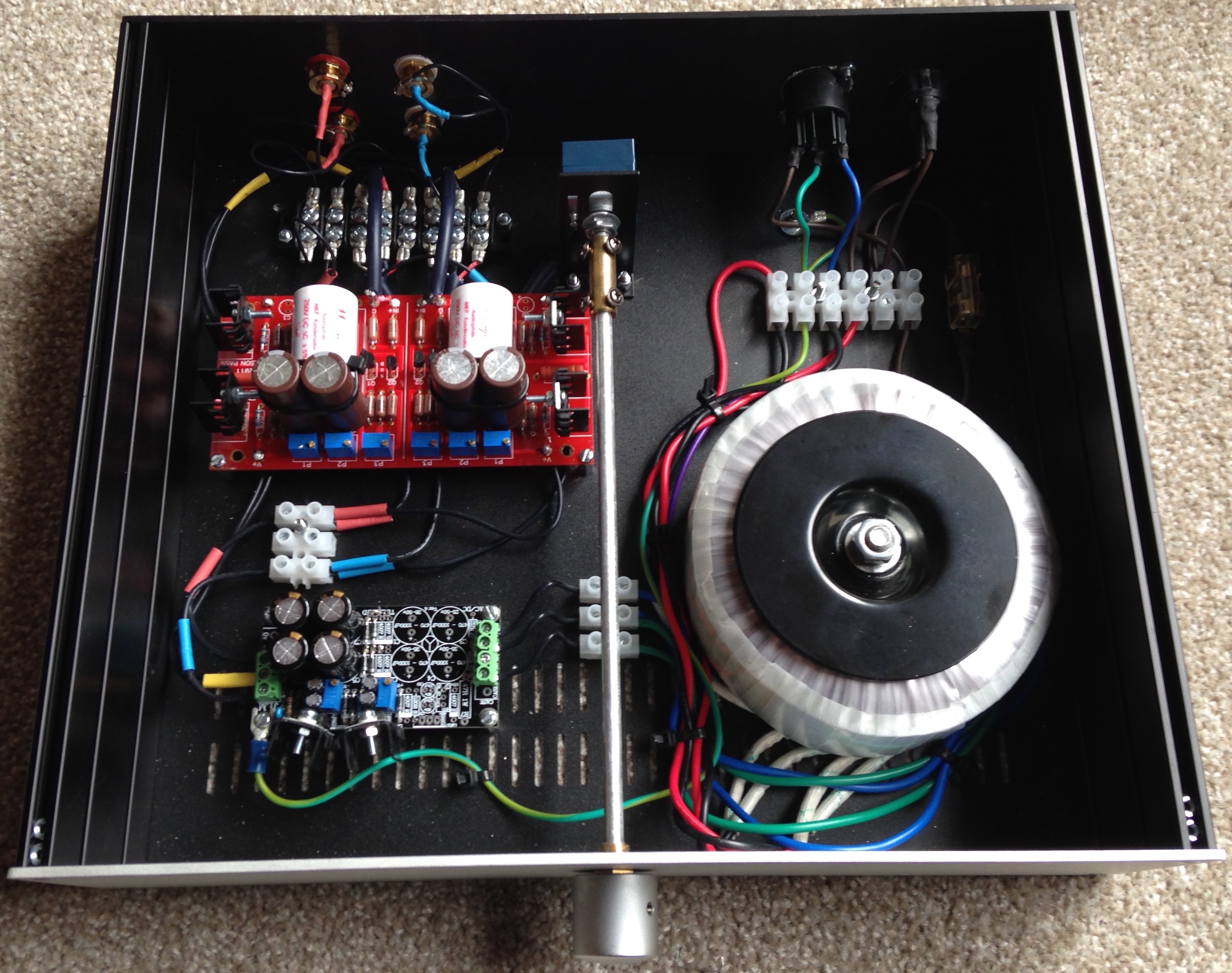

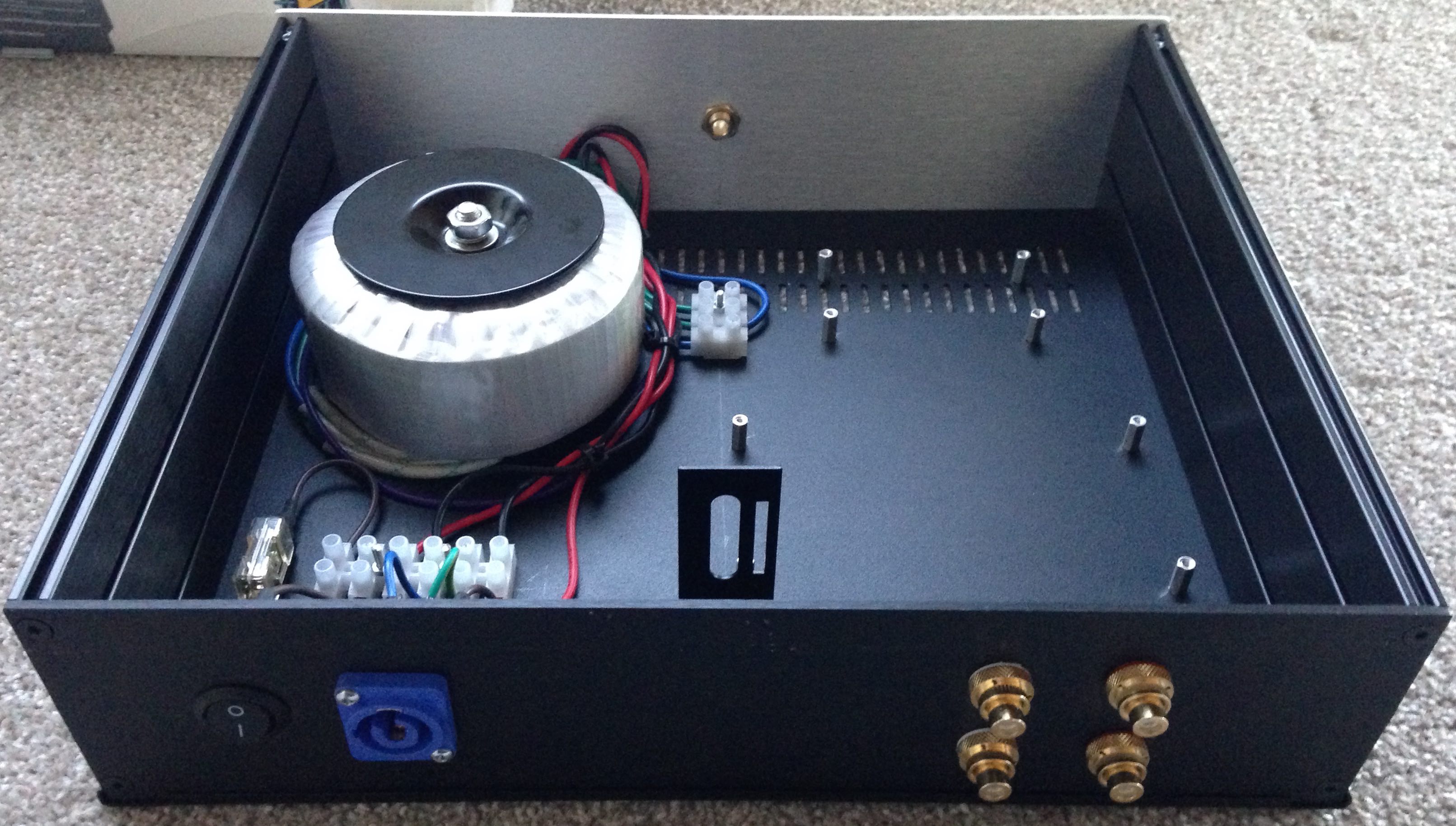

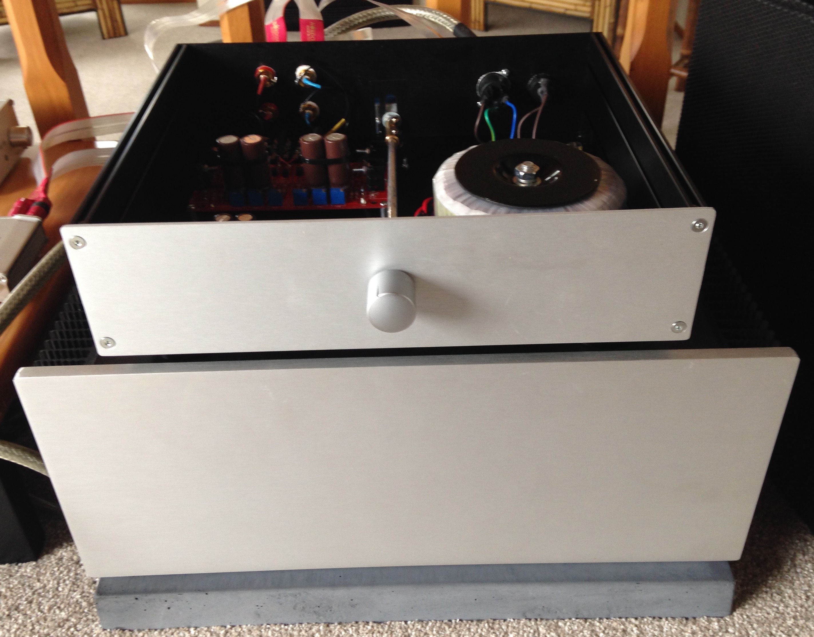

BA3 preamp
Recently finished BA3 front end, which is working nicely with a F5.
200VA, 22V trans from Antek. Regulated supply from JLM audio. K170 and J74 from Spencer. Alps 50K blue velvet pot and Mundorf Film Caps 10uf, 250V, MKP, both from partsconnexion. Case is HIFI2000.
You may not like the terminal block, but it was very handy.

Terminal blocks are just fine.
You can be assured of good contact and even clean them in the future if oxidation comes to call.
And...you can service your own gear more easily. I'm often surprised at how many times I revisit my projects for upgrades and adjustments!

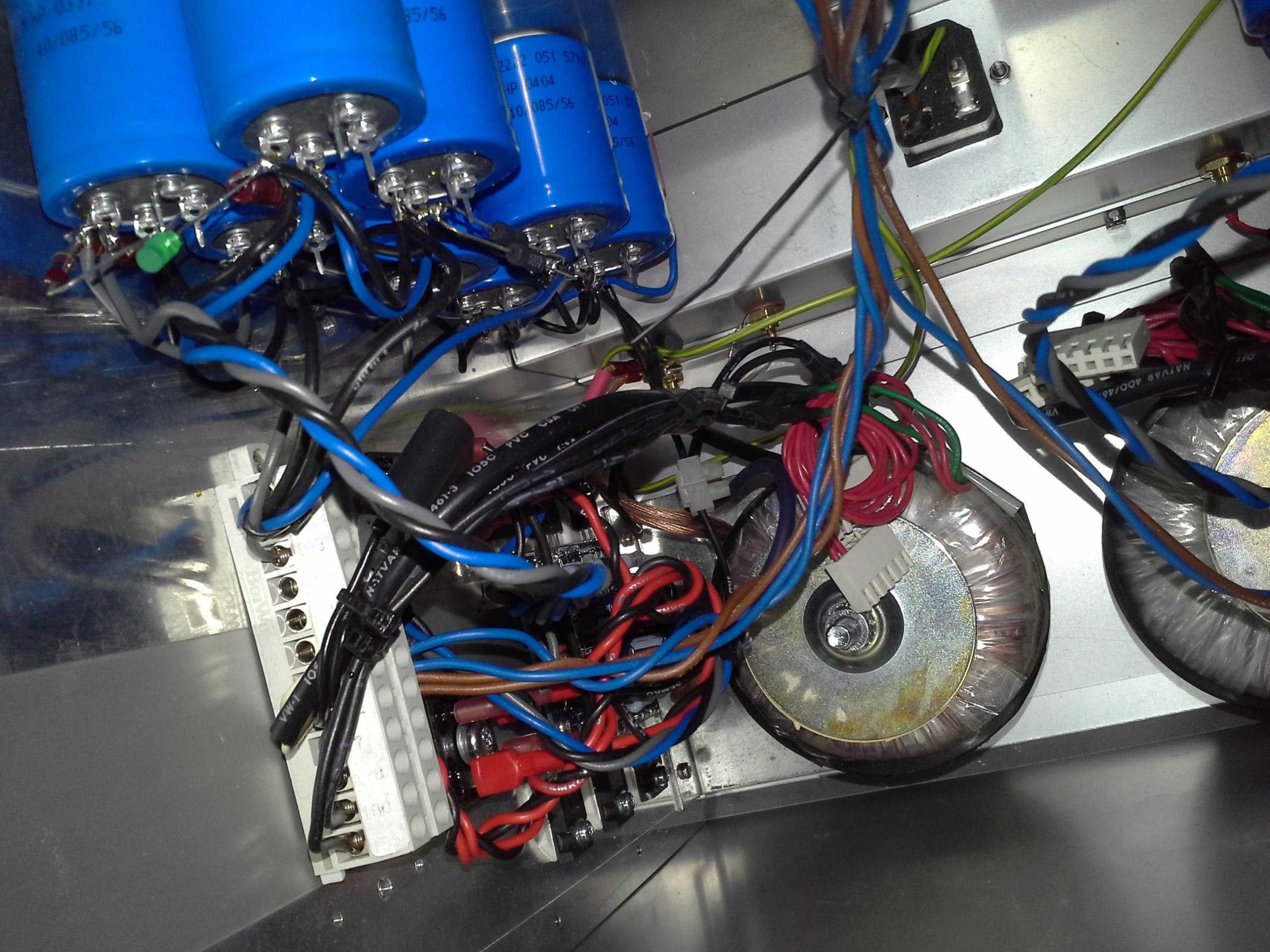

My F5
Hallo.
Excuse my bad english but I suppose everyone will understand me.
I finished my F5 clone built as a pair of mono amps.
The enclosure design is according to my DIY tube linestage.
I want to say thankyou to:
- First of all Nelson for sharing the circuit design. This is a great sounding amp!
- Mr. "stereoplay" for the NOS SJ74/K170 and the knobs.
- a_h for mosfets, tips and and pleasant contact.
A look inside the black building and more pics here.
F5 - My Photo Gallery
I know it´s a frequently asked question.
The heatsinks are a little bit to small. But I fished them for a couple of cents out of the bay hoping they doing their job well.
The Heatsink temperature rise up to 50 degrees C at a 20 degrees room temperature. Ventilating with the mini fans it´s 8 degrees less.
The fans are Sunon 12V Typs in serien connection driven by 13V(6,5V each).
They are whispering quiet and don´t disturb listening music even the sound is very quiet.
I greet all DIY guys´n ´girls.
