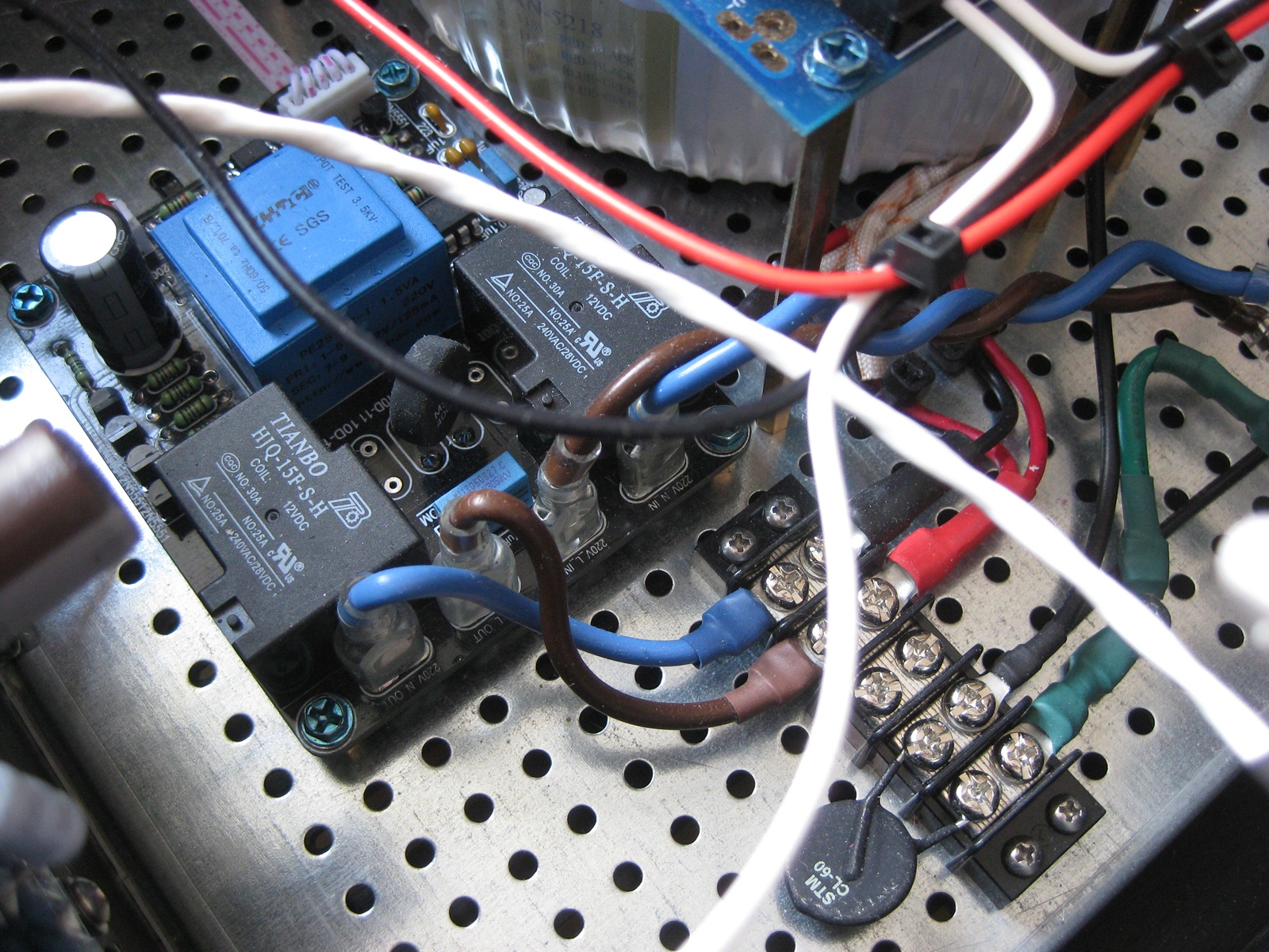

You use a softstart board, this looked familiar, and found some on ebay, what is your experience with this board?
did you buy on ebay?, or have you found the board at another source?, when other source are you willing to share the source?

Hi Bert,
Sorry for the late reaction, was enjoying a little holiday in the south of France
I bought them on Ebay from a Chinese seller, something like happyshop2008...
Similar board:
Group A Amplifier Power Delay Soft Start Temperature Protection Board | eBay
The one you show at the pictures is a new one where the LED is at a header, which is nice...
Boards are working great if you replace the thermistors with two in series.
Walter
This version has an adjustable delay time. Has anyone compared the two?

Walter did you replace with two CL60s?
Thanks. Nash
New 120V 220V Power Delay Soft Start Temperature Protection Board Class A DIY | eBay
I dont think this has the pushbutton start option if that is what you also need
Nash
Nash
So the turn on delay starts as soon as power is supplied? That wouldn't be bad as I've always liked a heavy duty power switch.
Yes, turn on and off from the power switch.
I installed the same one as Walter has on my F5TV3 build but I find that I always turnoff at the power switch end anyway. If I had found these at the time I would have installed them instead. I dont care for the pushbutton. I suspect it would be useful only if one did not have easy access to the power switch.

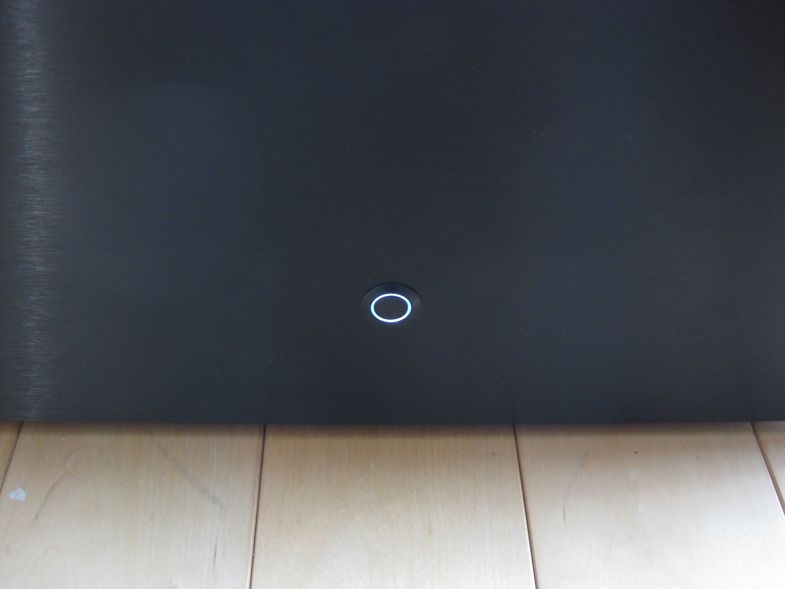

Thanks. Good to receive feedback since it seems there are several variations of everything on ebay. I like simplicity. Less to go wrong. Does the delay restart if it loses power momentarily? I do wish these had phoenix connectors instead of quick connect lugs for the power connections.
I used this version of the softstart in my F4 build, has been working great. I replaced the four NTC's with one big one suitable for 240v, then used a momentary contact button to trigger it with a built in LED. The board also comes with two 75c thermal switches which is a nice bit of insurance to have.

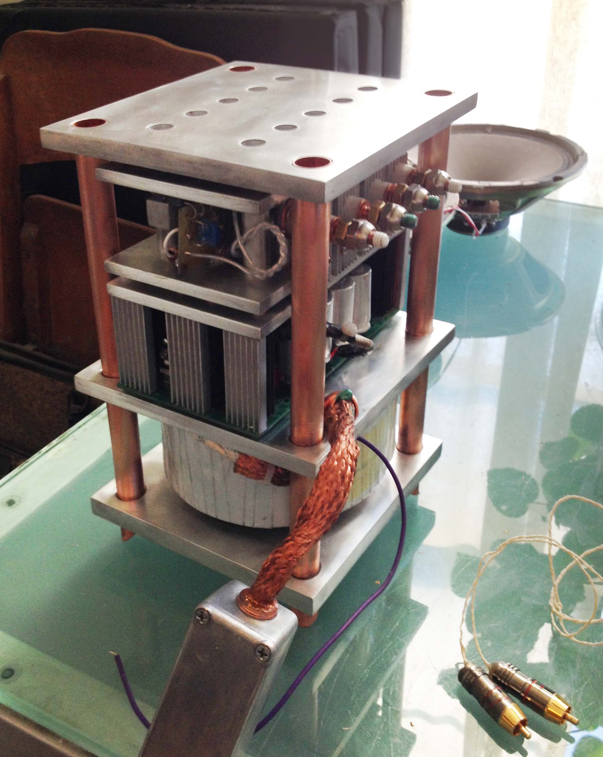

My version of juma's Cubie. Small and unconventional. 10 aluminum chimneys, 4 large copper chimneys that also serve as structure. Lots of designing, sawing, filing, sanding, fitting, redesigning, etc. Had lots of fun. Speaker posts solid copper 1/4-20 bolts, fine silver 18ga output wires (in teflon), fine silver 28ga input wire (in teflon), 6" x 6" x 10". More photos to come, (haven't taken them yet).
I like Your style: original design & industrial touch.
Congratulations Marsupialx excellent work
Best regards
Thanks!!! I'm glad the industrial aesthetic came through. I thought it would be fun to have a miniature lab coated figurine with a clip board standing on the middle platform, and a miniature helicopter sitting on top, to make it look huge. I need to photograph it with a cd leaning against it so you can get a feel for its diminutive size. Look at the rca plugs in the corner of the photo for scale.
I left out drilling and of course soldering. Never enough soldering. It's amazing to me how my inner self knows when something isn't going to work, but I have to try it anyway, just so I can move past it. Much of that.
