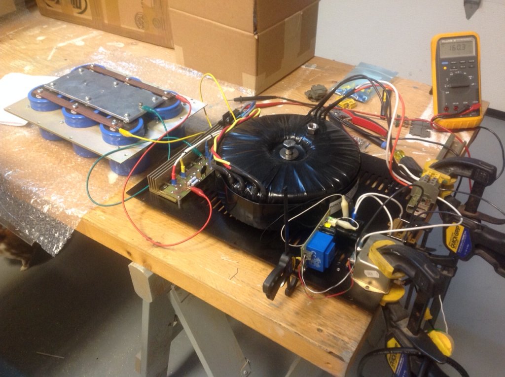

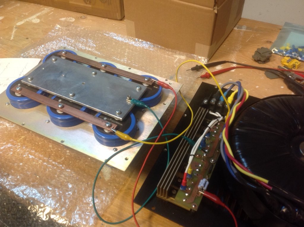

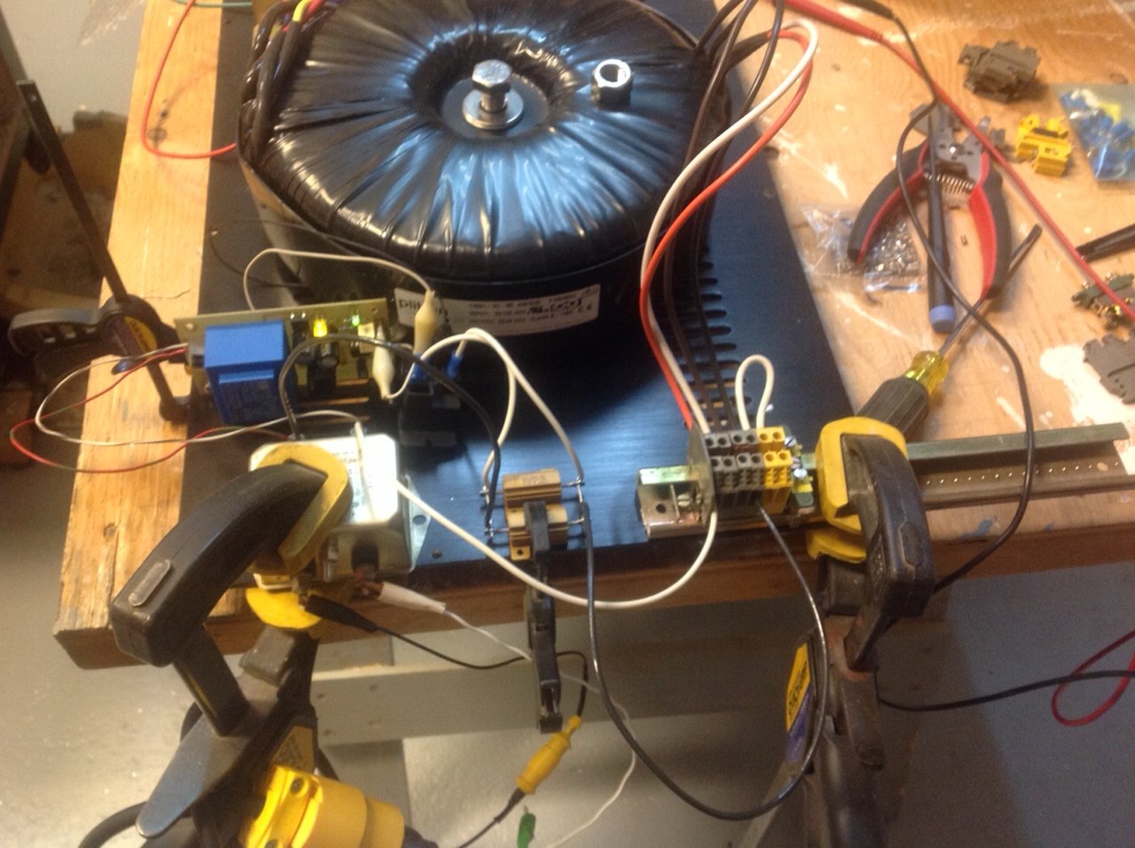

My upcoming Pass X amp monoblocks, a few pictures of the supply prototype. 1.5KVA Plitron LoNo power transformer, weight a ton (16Kg) but perfectly silent and as claimed by Plitron, the inrush current is really reduced.
Discrete dual bridge rectifiers (one per secondary) with chassis mounted heatsink, Softstart using a classic 555 timer to bypass a power resistor with a 30A relay, industrial power connectors. Classis style Pass caps bank with copper buss bar. It is a tough, powerful power horse of a power supply 😀 It won't crash on power demand while heavily biased in Class-A.

did you take the transformer out of the potted enclosure? I use LoNo by Plitron and they are simply the best to me...they come with that nice potted enclosure. Did you have it custom made for you or you bought it second hand?
Custon made, and no potted enclosure. With the caps bank mounted over the transfo, the potted case didn't fit in my chassis. Plitron used a core with lower height, but larger diameter (same VA) so it would fit.
They made it custom (qty: 2), with the dual primaries at 120V, not 115 or 117V, and the secondaries voltage that I wanted. Price was also lower without the enclosure, and not that bad all thing considered for such custom made. high power, high quality transfo. Also I was quite impressed that at startup, with no charge in the caps, that there is not a very large power surge.
Usually with a 1KVA transfo, we can hear the sound of the current surge, lights in the room may flick shortly, etc. But with this 1.5KVA LoNo, nothing, quite impressive.
I used 2x 14.7ohms 20W chassis mounted Dale/Vishay resistors in parallel bypassed with a 30A relay as softstart. The resistors stay cold to the touch. Very good...
what is the secondary voltage on that Plitron transfo. ? How many output-fets are you planning to use?
....................Usually with a 1KVA transfo, we can hear the sound of the current surge, lights in the room may flick shortly, etc. But with this 1.5KVA LoNo, nothing, quite impressive.
I'm not familiar with operating on 110/120Vac supplies but extrapolating from my 240Vac experience, you could use a T12A fuse.
That should not blow in starting, when passing a maximum current of 25Aac.
You would need 3 parallel 14r7 resistors to give an added starting resistance of 4r9.
What fuse did you use for your 1500VA 120Vac transformer?

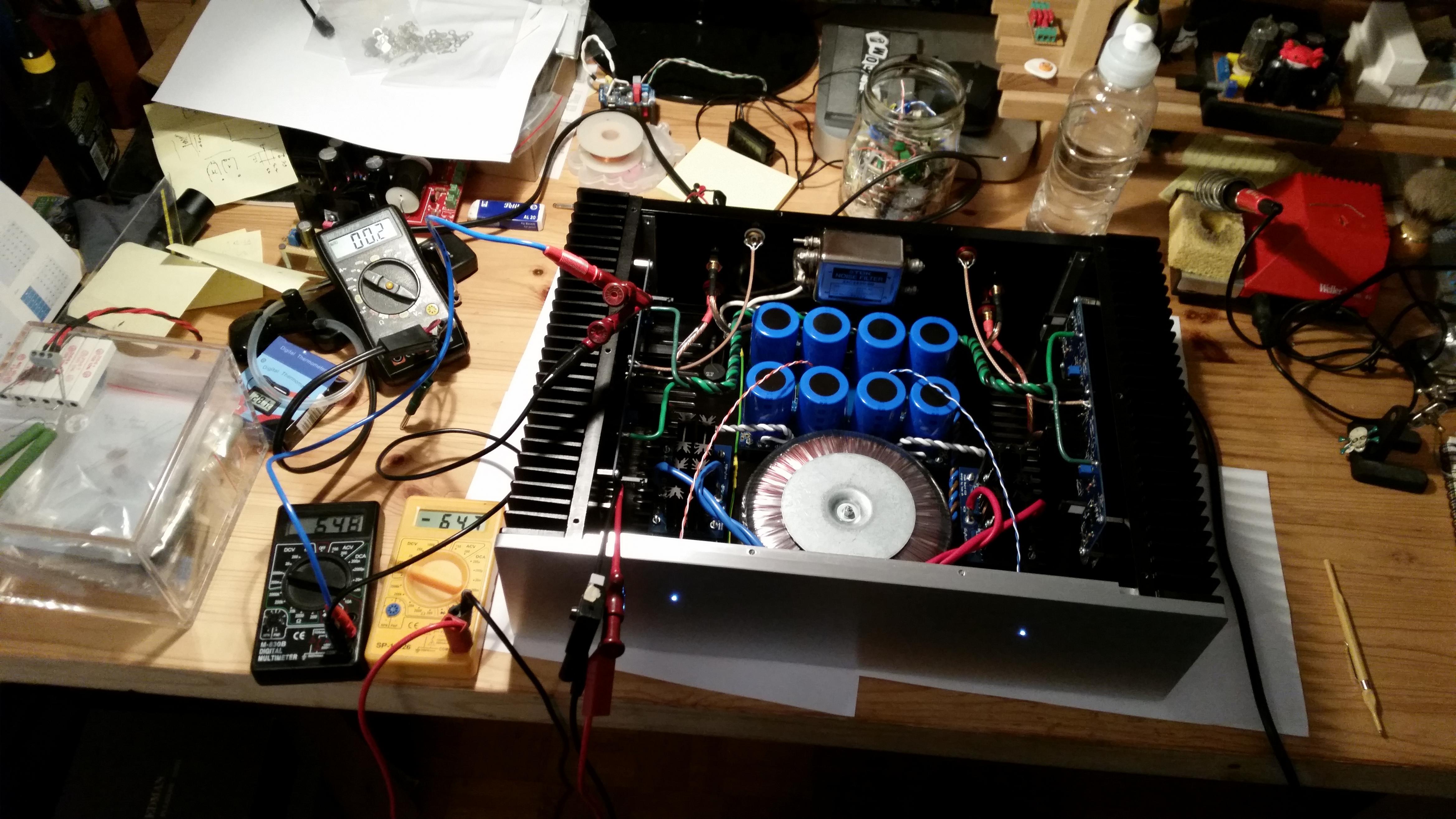

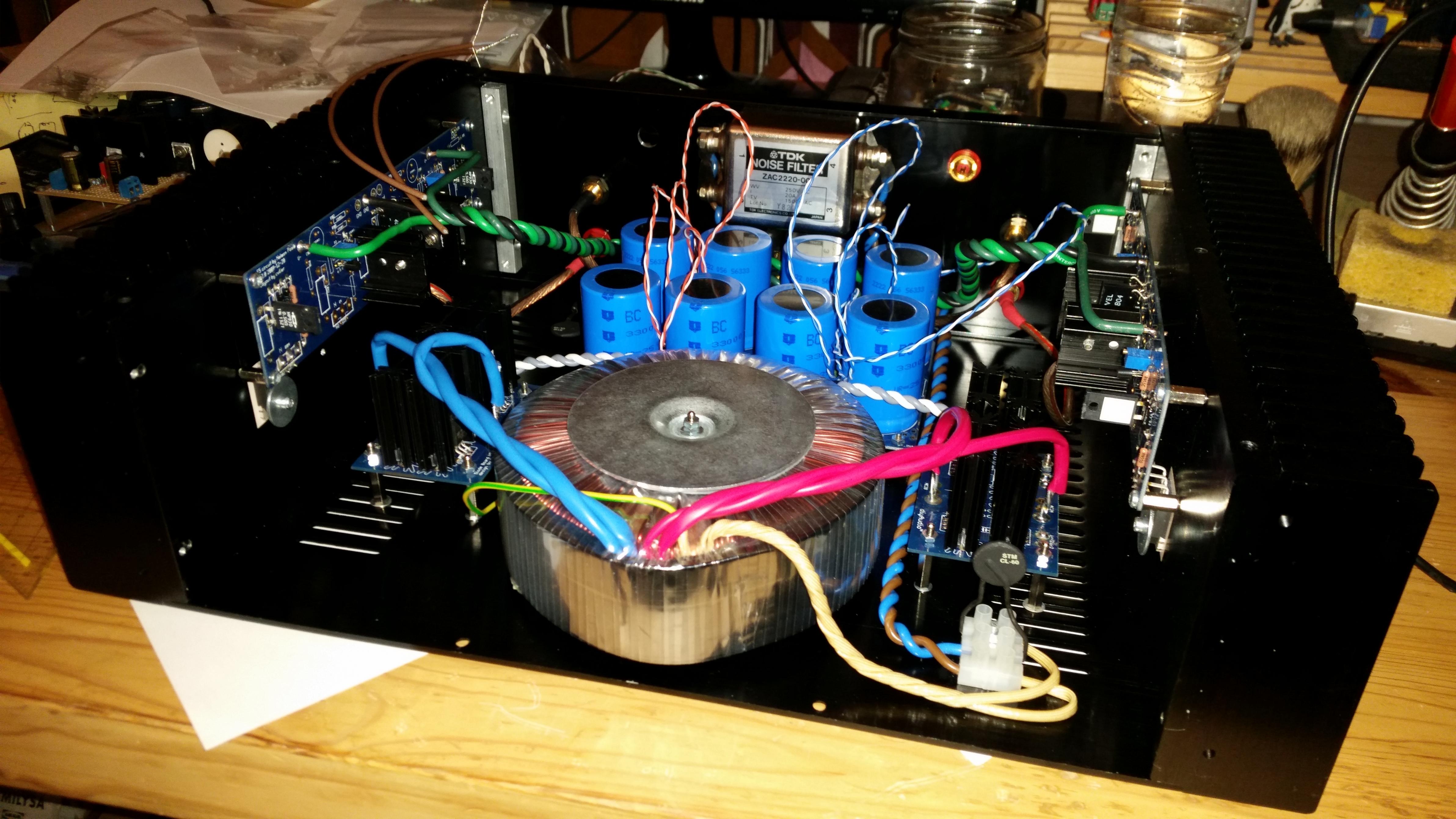

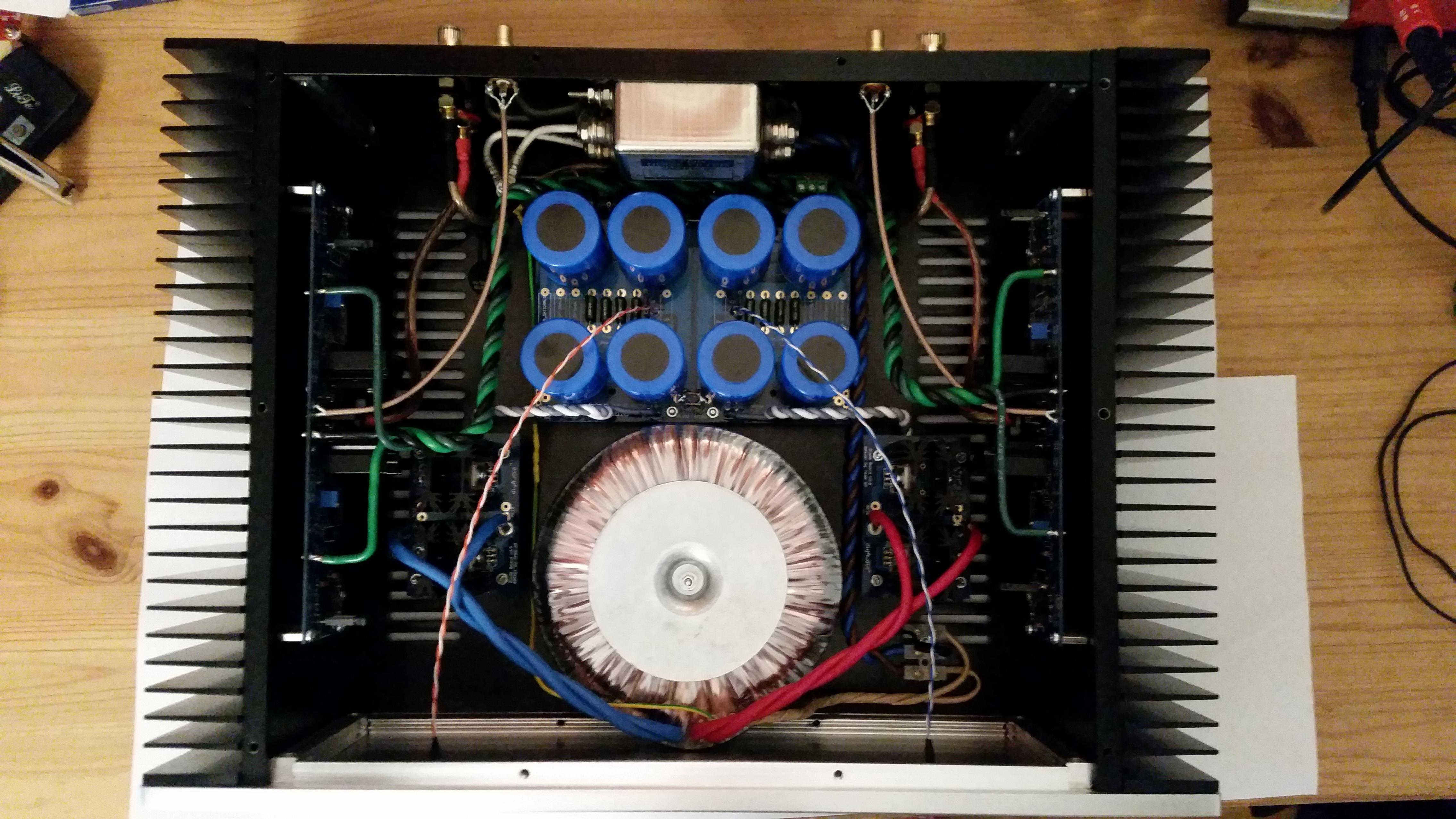

I finally got my F5 build finished today. It fired up nicely without blowing up. Biasing the output stage went well too, having it set at 650mV over the 0R50 resistors equals to 1.3A of current through each of the FETs. The output DC offset is within a few mV to zero. The heatsinks settled at 46°C after an hour of idling along, which is 21°C above ambient.
I looked a some waveforms through the scope, the output looks clean and free of hum or noise. Tomorrow I'll hook it up to some test speakers 🙂
I have to admire your patience to wait till another day to hear how they sound.
