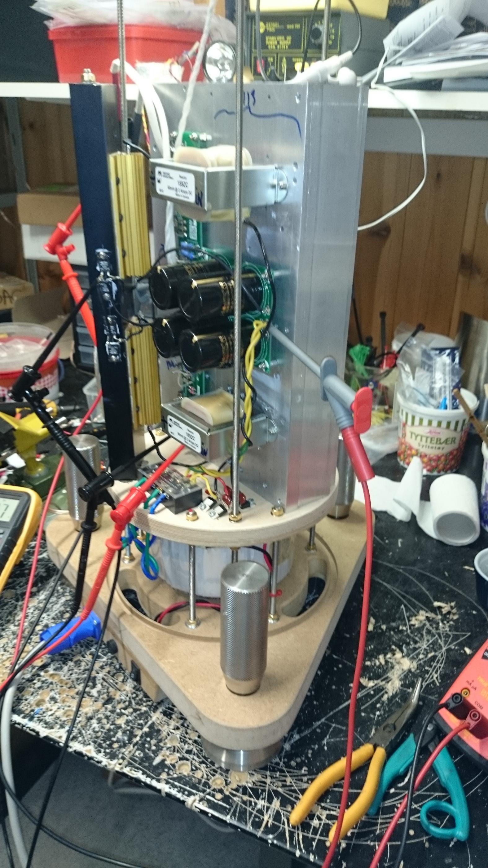

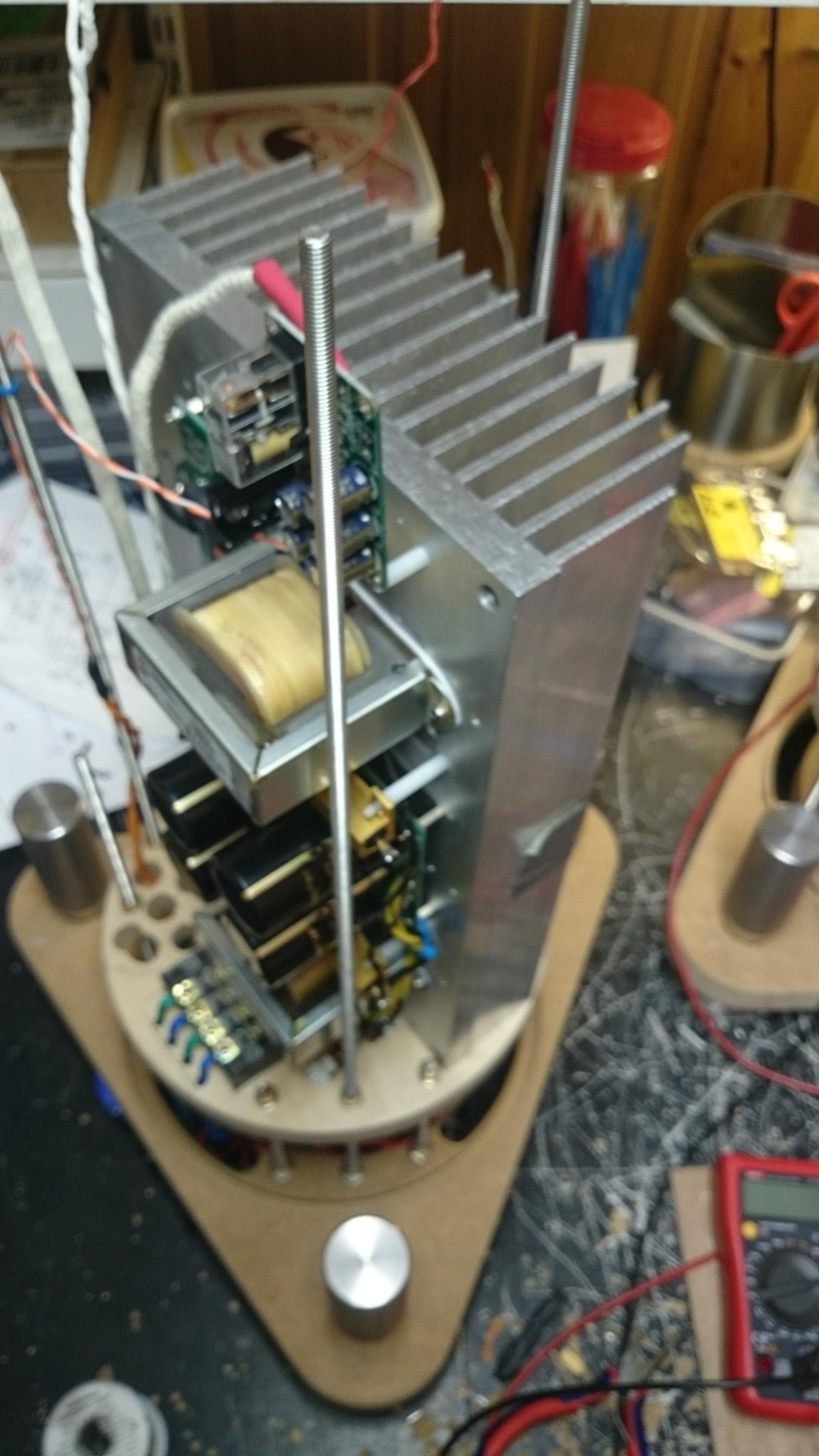

now I´ve gotten the pics from my Sony Xperia Z1 phone
early stage testing trying to get read of excessive heat due to what turned out to be caused by to high seconady voltages..started with 50 VAC but ended up with 40
thought it wasn´t possible to upload directly from ones pc
anyway

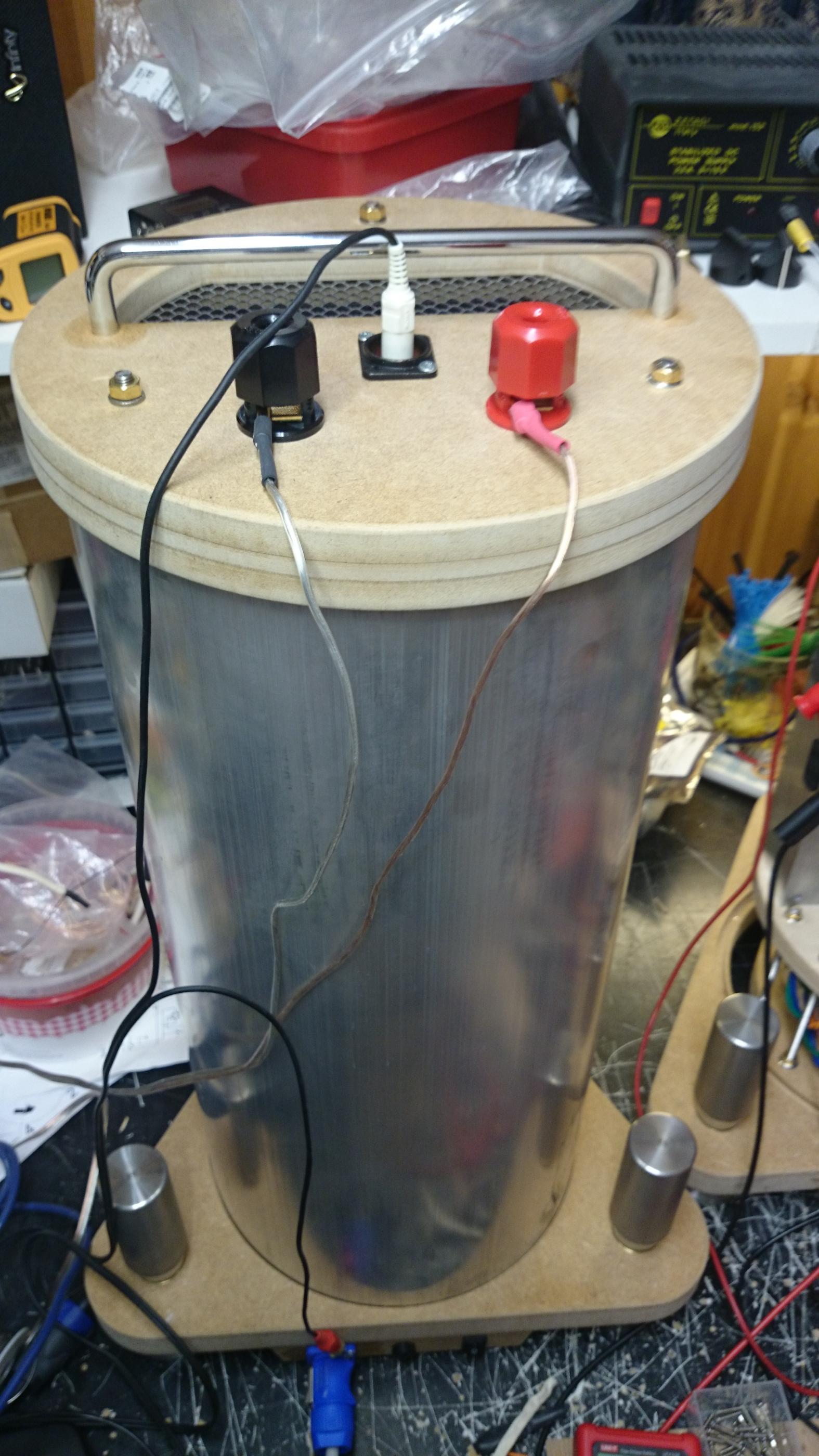

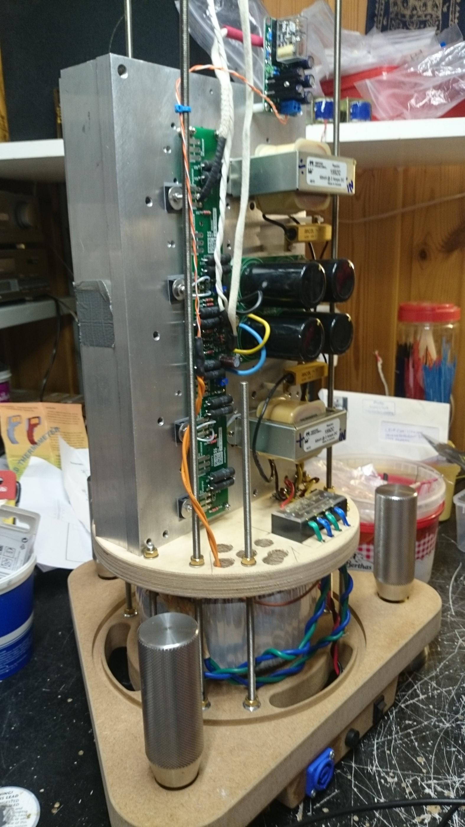

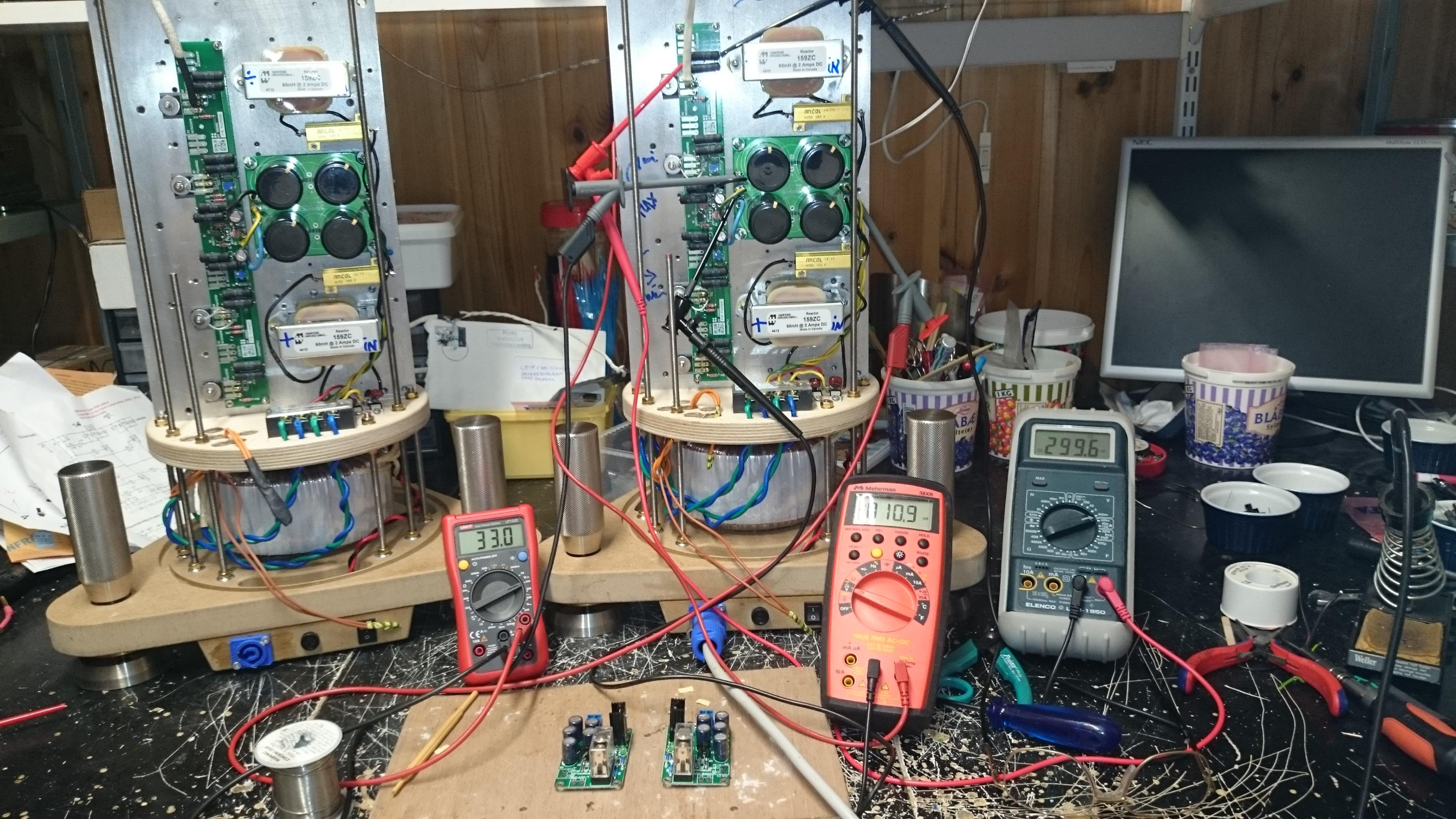

testing last monday evening after installing new 40vac 1KVA transformers and having decided to revert to V1 ex MUR3020
overshooting voltage was a major problem with 50vac secondaries and I´ve definitely been in the fire extinguisher league for several months! he-he

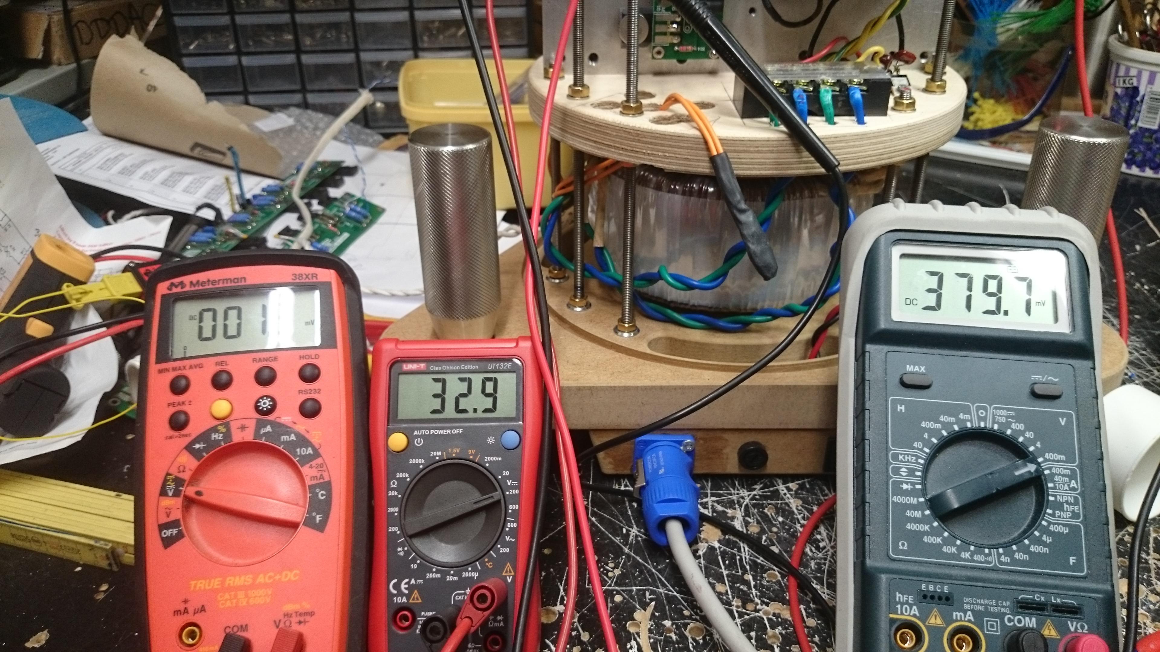

on their way up to target 350mV

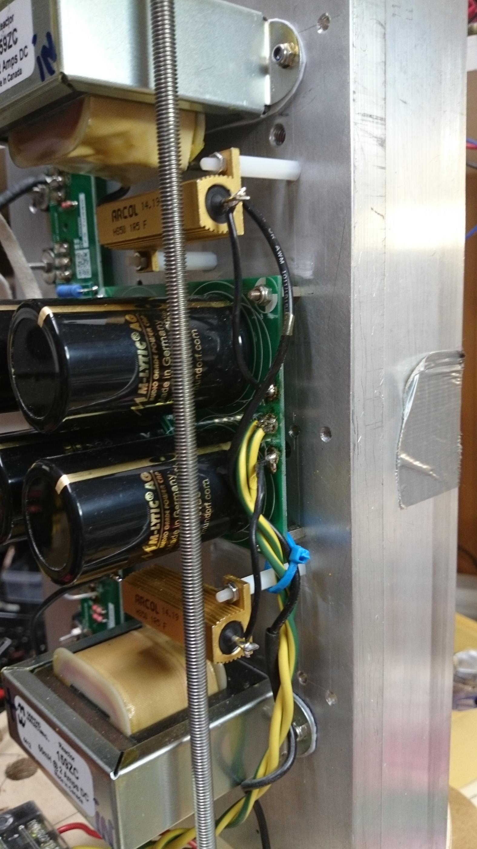

protection pcb´in front ready to install

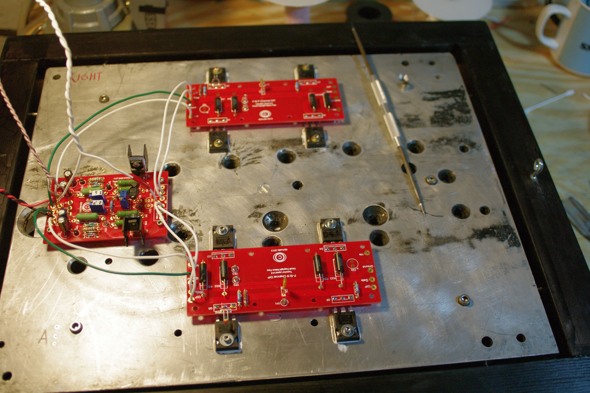

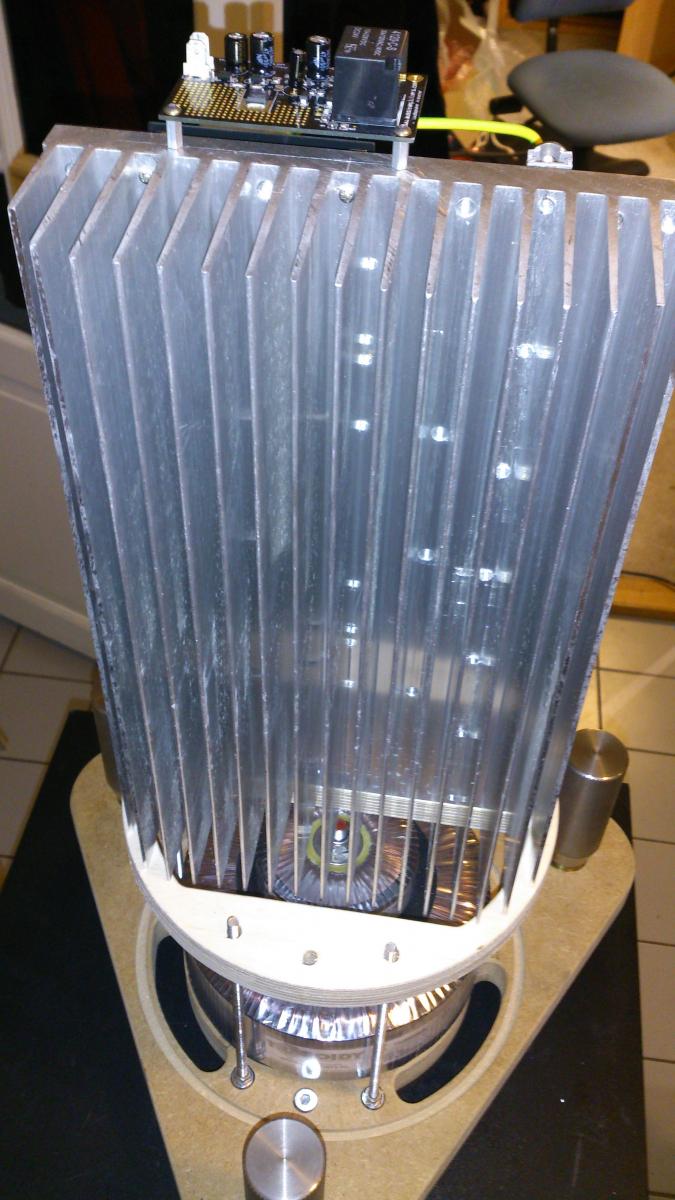

I have gone vertical with my attempts at a F5t v2. I had great results. These only get to 85F after an hour at 345mV across the source resistors. They are made from scrap I got at the recycler's. Obviously those are CPU coolers on the side, mounted to 12mm plate which itself is riddled with random holes. Hey, they work! The amp sounds great!
Thanks to all those who help! No one does this kind of thing alone ;-)

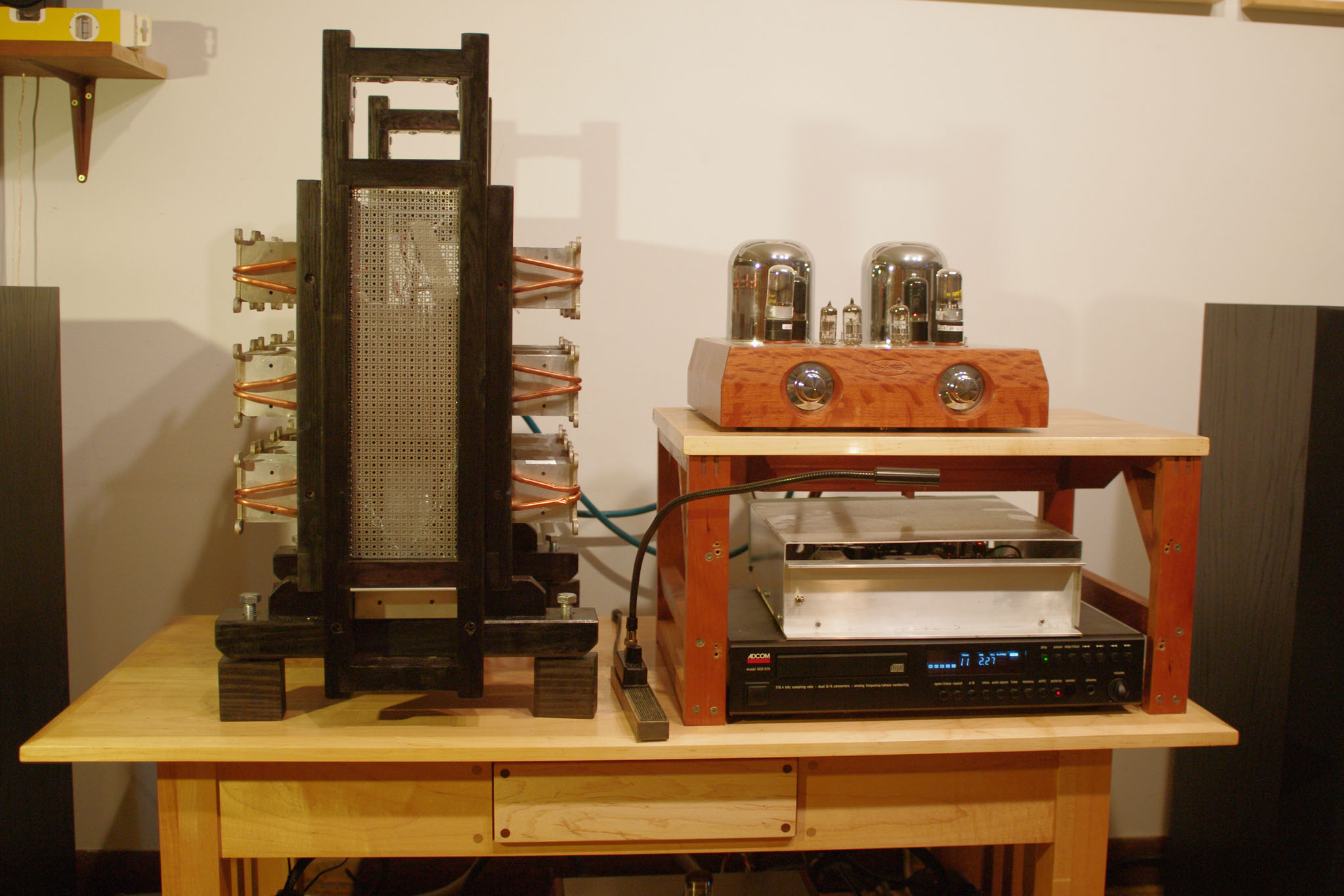

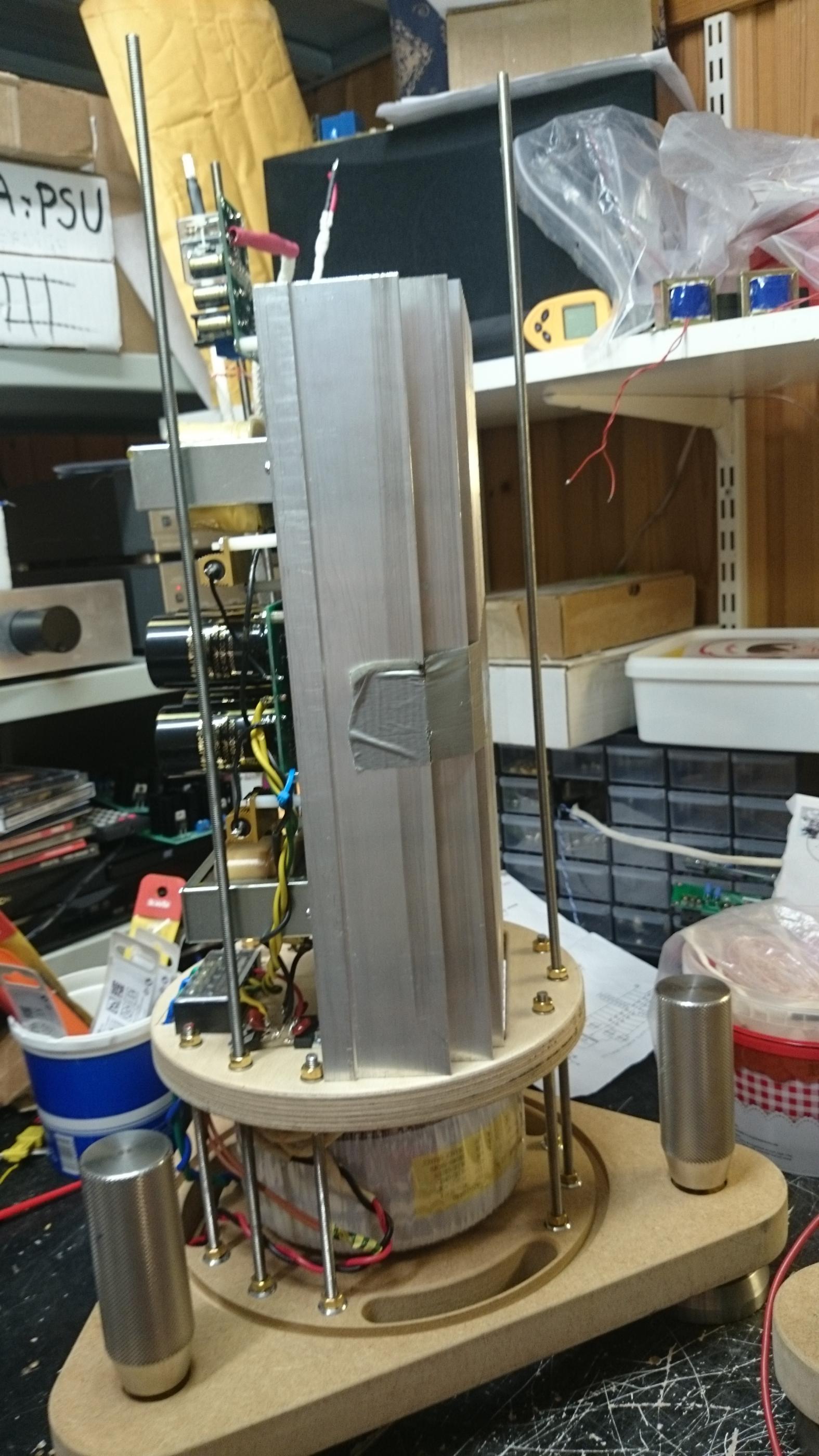

different angles last night before assembling alutube and top lid
Babel Tower, very original.
