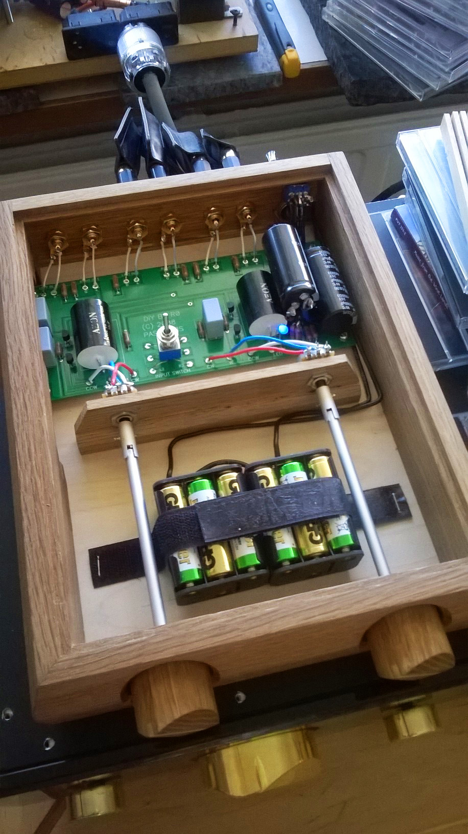

Didn't have the wiring done before with posting #2815, but here's an inside pic.

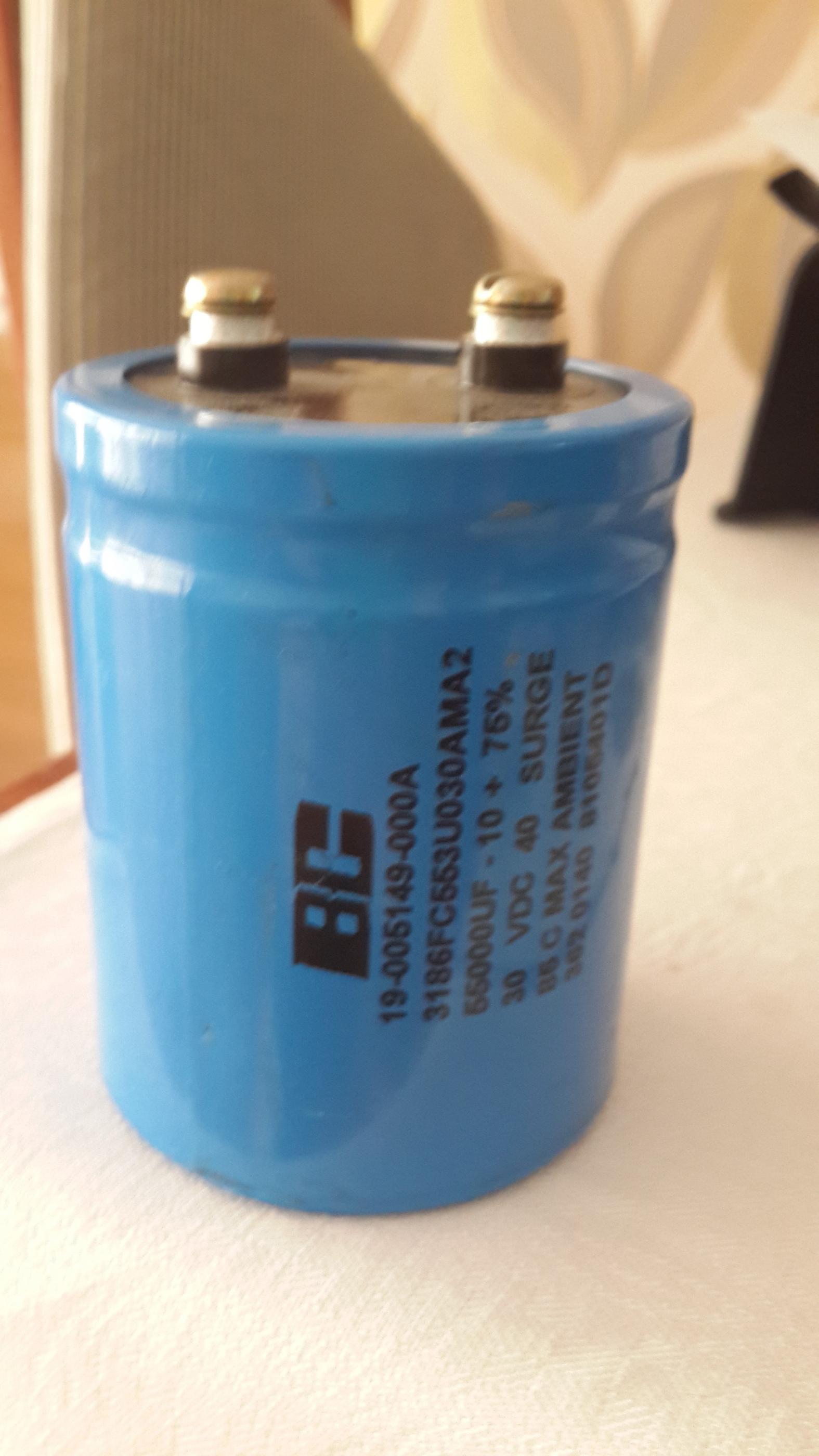

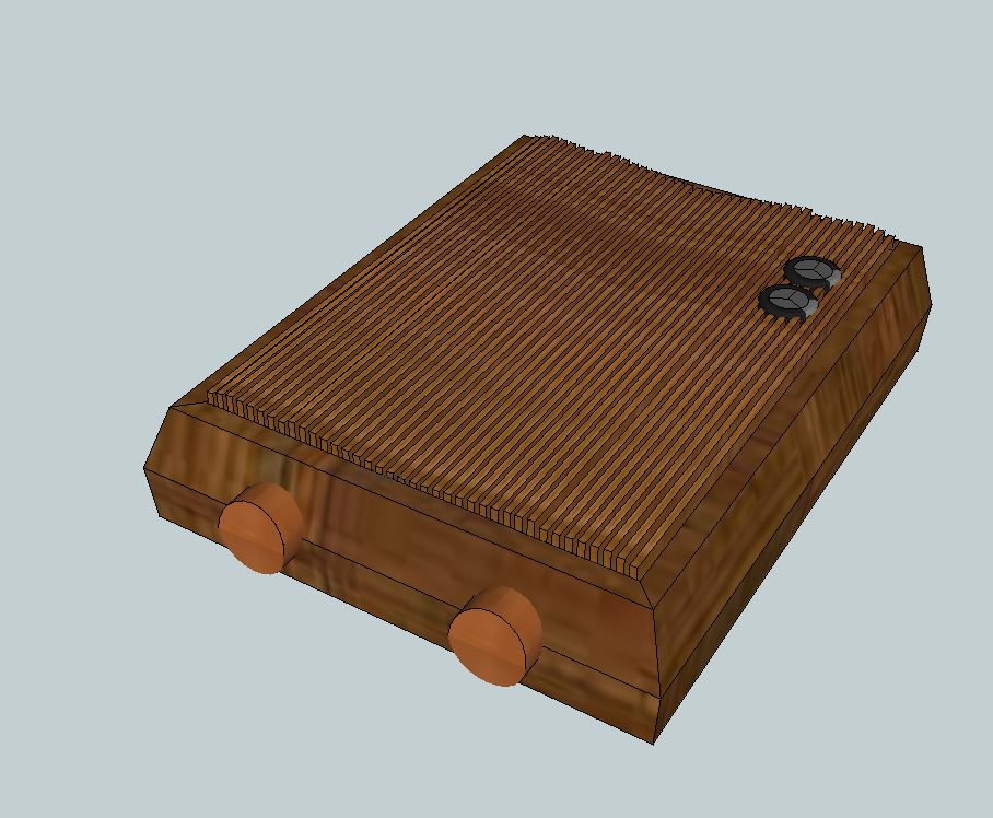

The design changed a bit. I was first thinking of putting the power caps through the top cover like in the Sketchup pic, but after seing it live, I decided against that. So I had to put the caps laying down.
Also, I'll probably put in a stereo pot and make the other knob function as a souce selector switch. :)

All your inputs have open loops.
Change them to twisted pairs.
Don't use the solder tag. Instead solder the Signal return to the end of the barrel right next to the signal pin.
If you are neat with pre-soldering the end of the barrel you can still screw the nut On and Off.

Hi there guys!
Yes, I've also aknowlaged that same picture and pretty much subscrib to buzzforb's saying. After all the signal wires are quite short and the power supply is external (excluding the batterries of course).
But also, as a mater of fact, I have been doing exactly what Andrew says with my other projects. :) Only this time I had only about 10 cm left of the signal wire I wanted to use, so I had to do it this way for now.
I'll probably do the wiring again (and ditch the solder tabs) once I get some more of that said wire. But even now I dont detect any noise, smear or such.

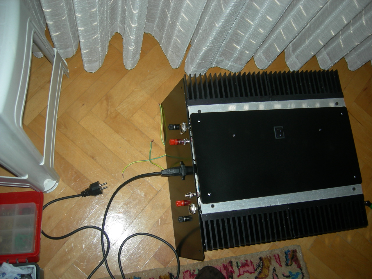

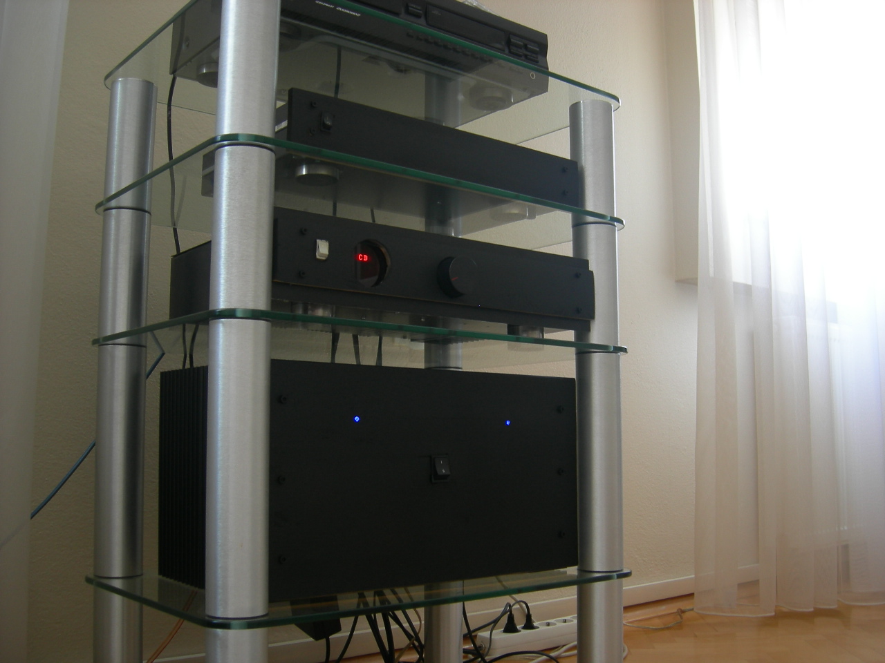

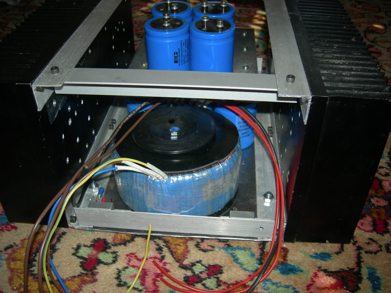

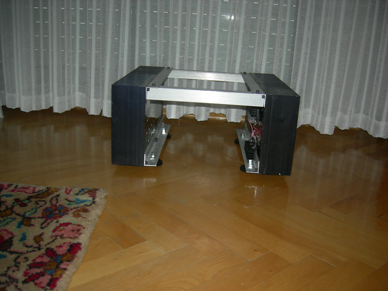

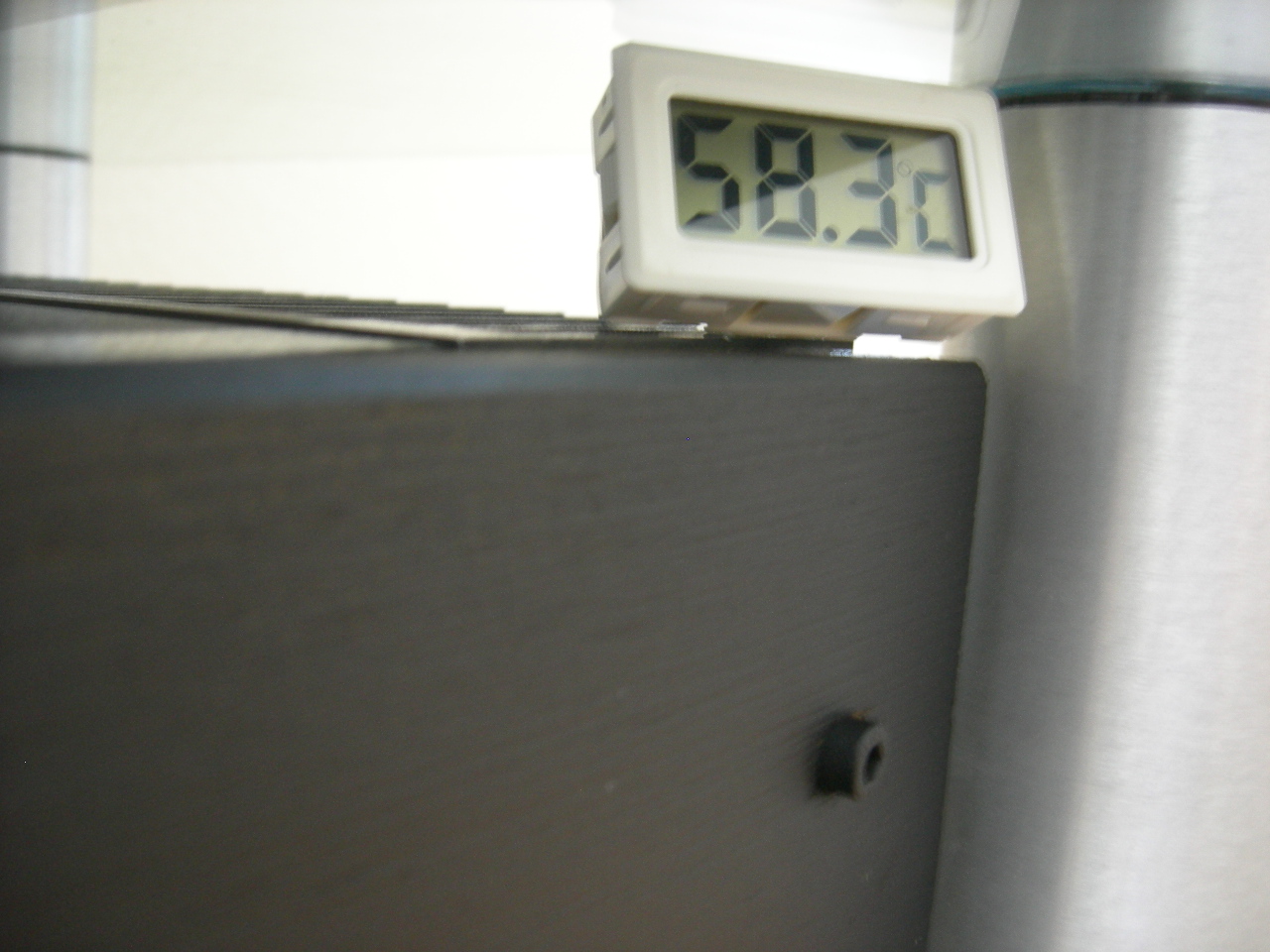

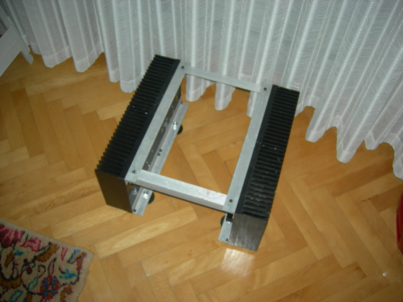

My Aleph X
its my aleph-X.
18 v rail. 8 x IRFP240 matched. (one channel)
5.4 A bias current/ch
Power Supply;
1000 VA 2 x 15 v + 2 x 15 v
2 x 35 A 1000v bridge
12 x 55.000 uF cap. CRCC filter. (3 x 55.000 uF one/ch - one/rail)
heatsink ~52 C. after 2 hours work.

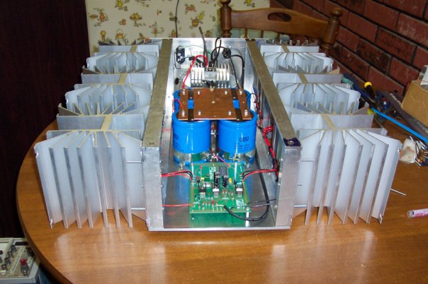

hello folks
after having struggled with my F5Turbo choke input edtion for some months I finally had a breakthrough thanx to 6L6 who helped me with a technical issue regarding the pots getting out of range.
now they´re finally stable after several months of fiddling
I very well understand why folks don´t combine choke input psus with class A amps...impossible to simulate...one rally has to do the experimenting the hard way
anyway here they are before theyre covered with their alu tubes and top covers
best
Leif
