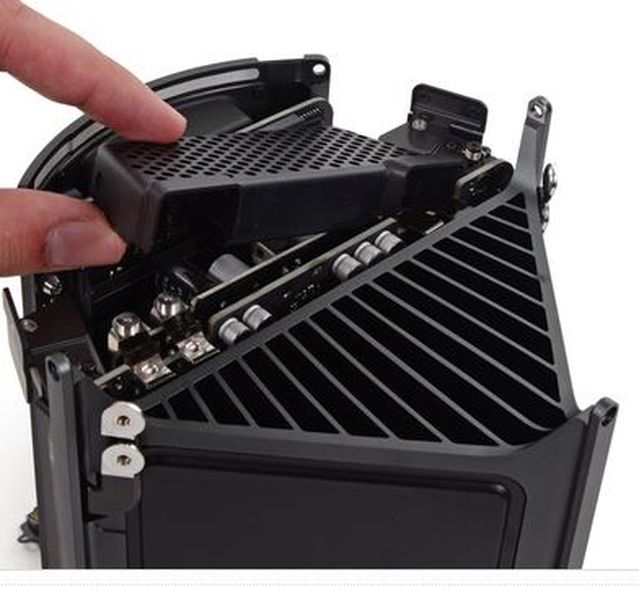

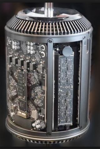

Too tempting and unique to resist :rolleyes:. Got saws and drills sharpened for a version of the heatsink concept - hopefully to house a BA-2/3 (prelim sketch indicates ~ 16" tall X 8" dia.). Don't really need/want the computer but kudos to Apple (New Mac Pro) for pushing the envelope again. Should be a fun winter project to apply to the amp chassis world :D.

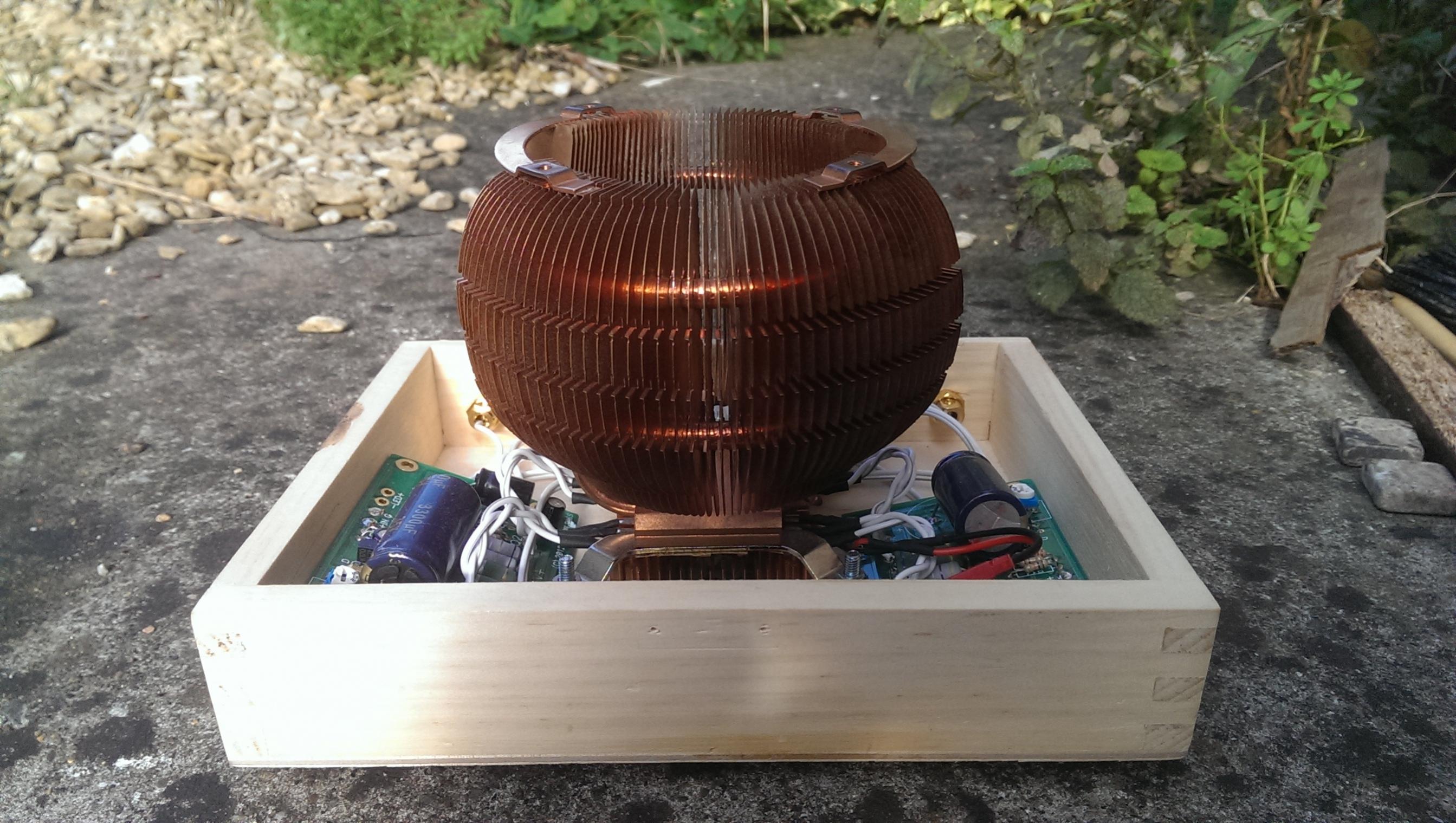

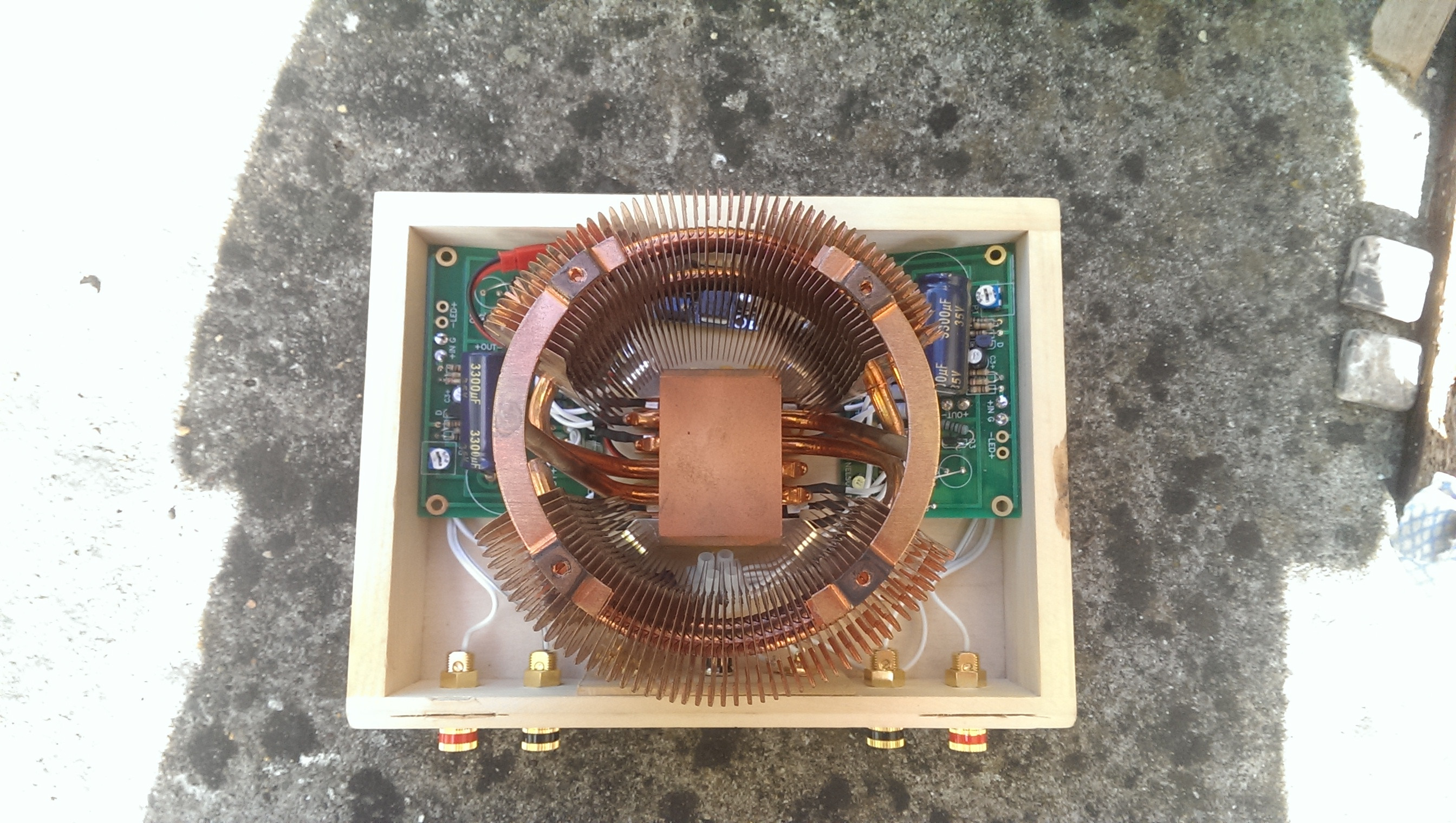

Here are some photos my little ACA build. It's still a bit rough around the edges, but if I wait to finish I'll never post photos. I have sandwiched the MOSFETs between a PC CPU heatsink and a small 40x40mm heatsink. The MOSFETs all sit nicely within the foot print of the heatsinks, with a few mm of space between them.
I used a Cooler Master PC CPU heatsink (this one), which I picked up dirt cheap on ebay (~£10GBP). It's quite nice because it has metal feet with holes, so I was able to screw it down through the box. I've tried some other CPU heatsinks, but this one has been the best so far.
I removed the big fan from the CPU heatsink, it happily radiates passively. The 40x40mm heatsink is using a small fan, as the black side of the MOSFETs does seem to get warm otherwise. The small fan is supplied through a small DCDC switch mode step down (ebay again, ~£3GBP), just visible as a blue PCB in one of the images. That small fan is running at 5v (rated for 12v), so it is not audible. As for signal noise... the amp runs from a switch mode supply anyway, but I'm not sure! I'm delighted with how the amp sounds in any case.
In use the PC CPU measures at 50*C max. Without the small fan active the that rises to 70*C. So it is possible to run it passively and hot :)
I'm driving a pair of Fostex 206EN in transmission line enclosures. I've been using this amp for 5 months now :)
