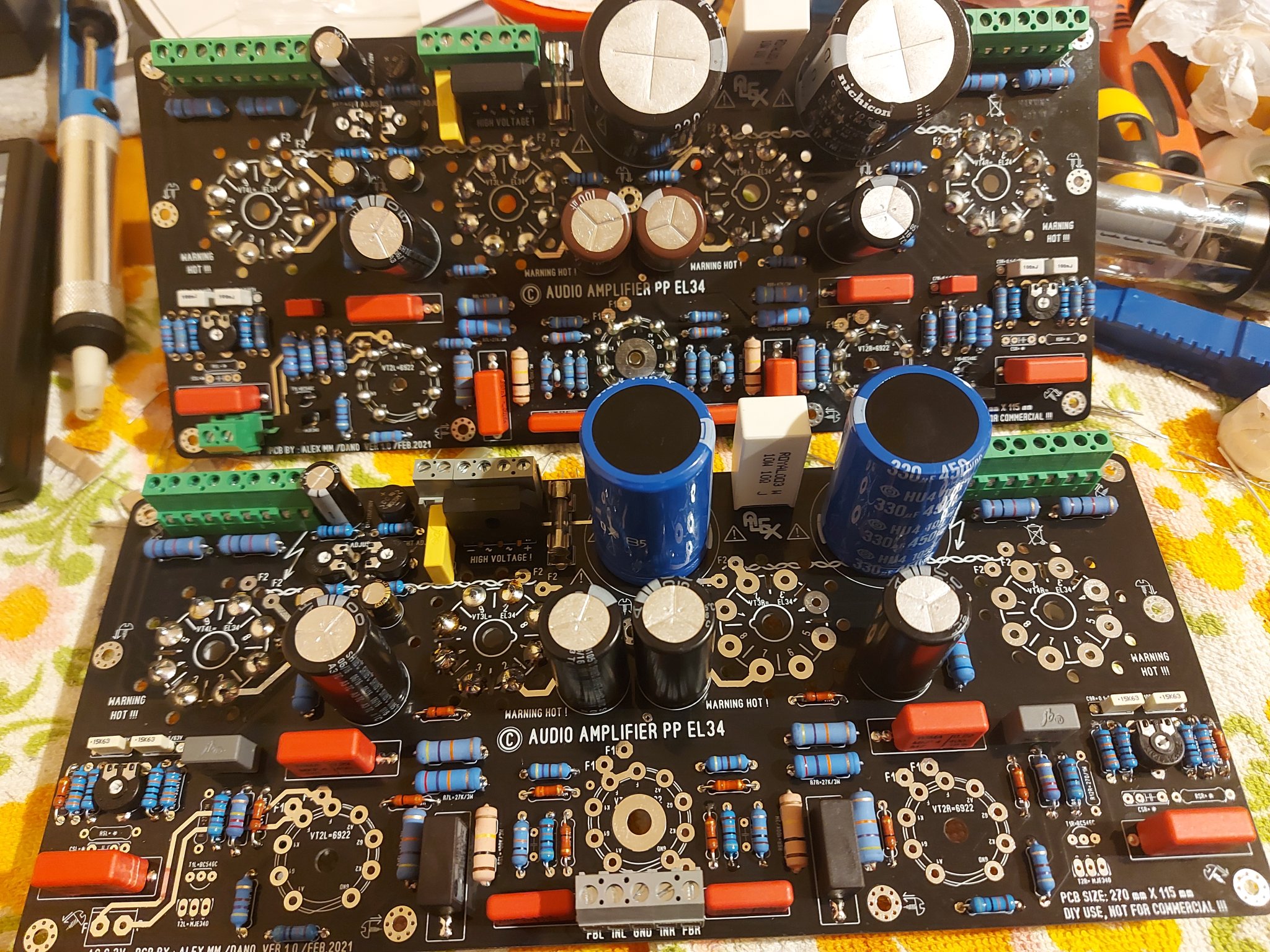

I believe alex mm is associated with a professional manufacturing facility-
The merits of this are quite pleasing to the eye. I am hoping his group will construct a PP quad, I would like to see the layout.
Jim
Jim
Thanks for your kind words , but forget other two amplifiers sold . 🙂

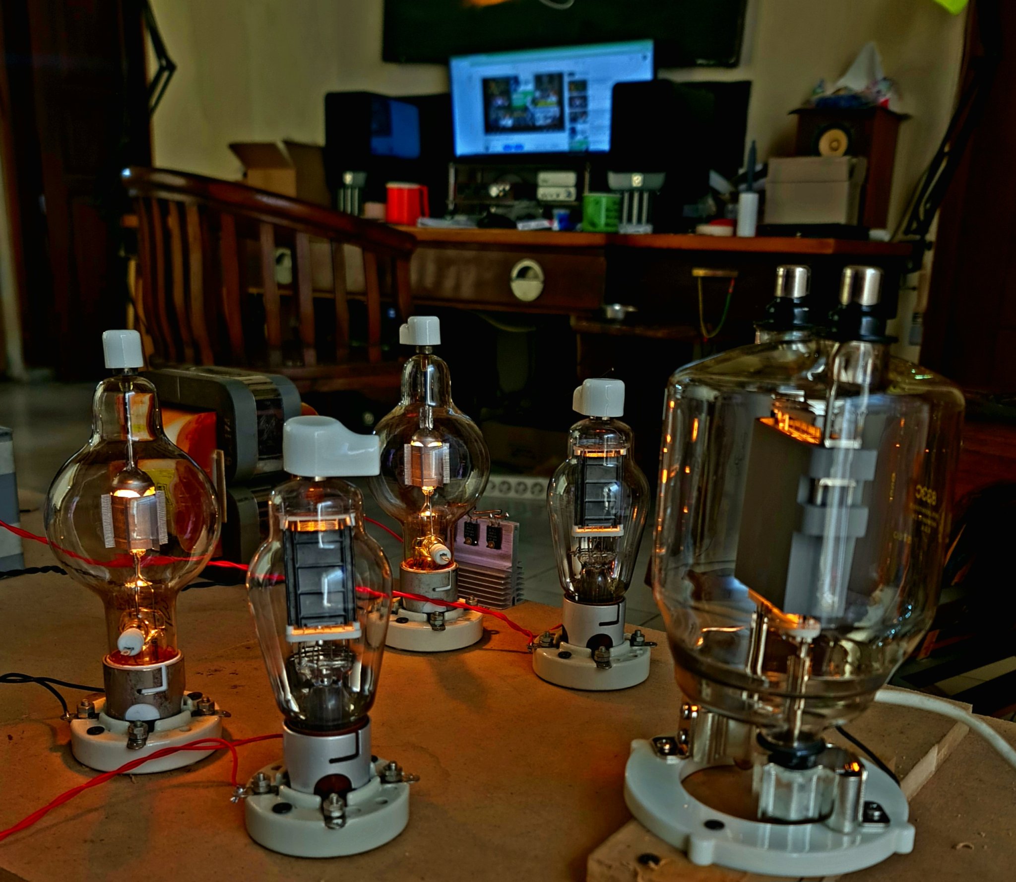

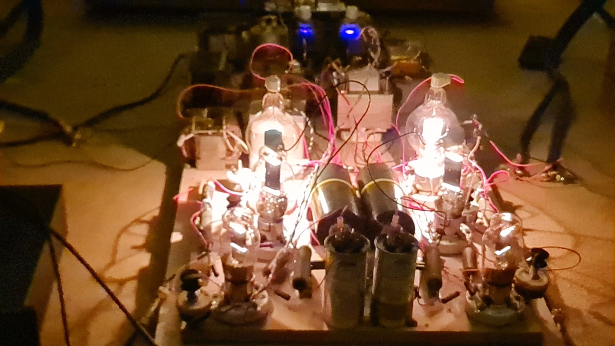

@suwaned-- I love this. Makes me feel like screaming-- IT'S ALIVE!!!
All meant in a good way and with respect. True spirit of DIY!
I still afraid to play itPhotons flying everywhere...!
David

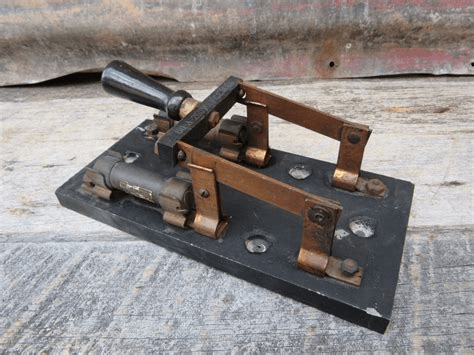

Awesome shapes and structures with those tubes! Still need a "hero" knife switch to complete the look...
Are those batteries showing in post 11,332, in the lower photo panel?
David

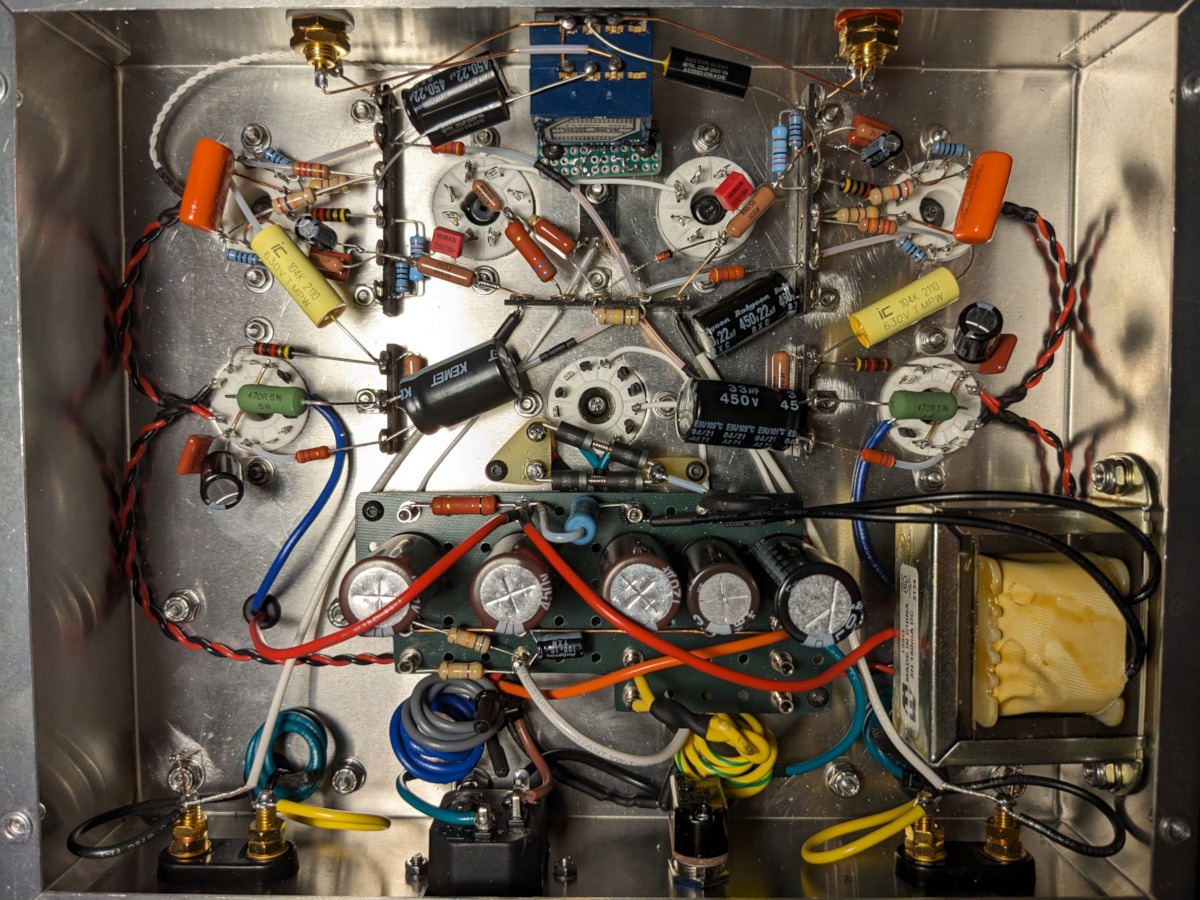

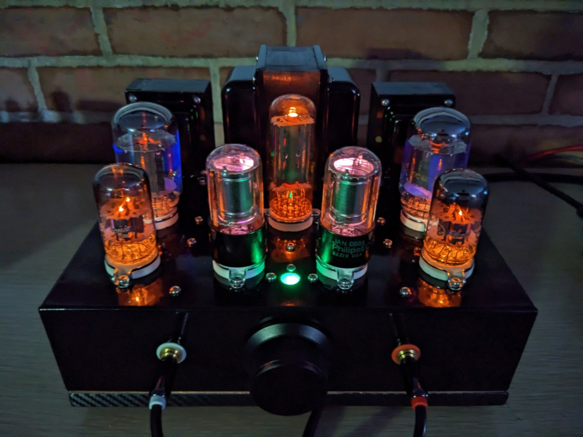

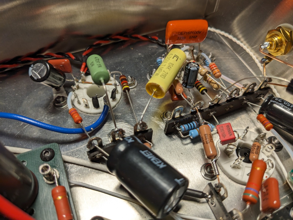

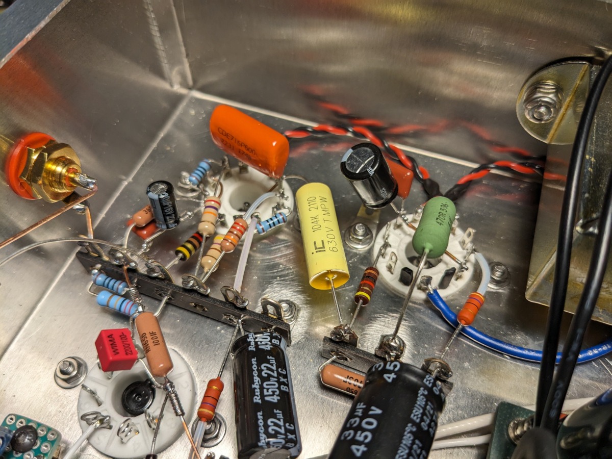

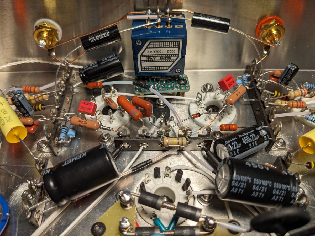

SE Compactron amp. 6BN11, triode strapped mu-follower driving 6JC5, pentode with regulated screen. GNFB. 1.25% THD at 2.83V RMS, 1kHz. 97% of the distortion is 2nd order.
Overall:
Left channel:
Right channel:

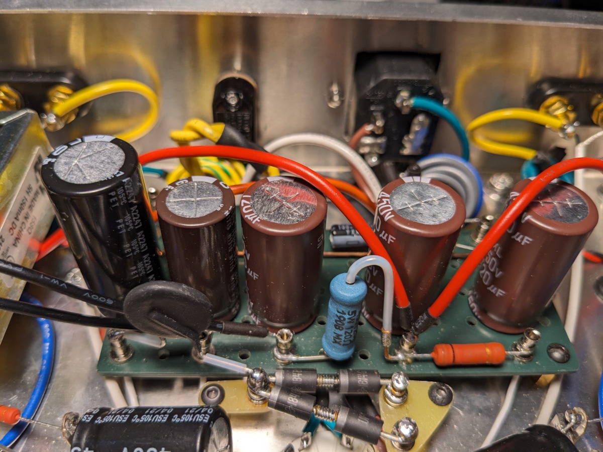

Input and voltage regulation:
Power supply:
Glow:
Overall:
Left channel:
Right channel:
Power supply:
Glow:

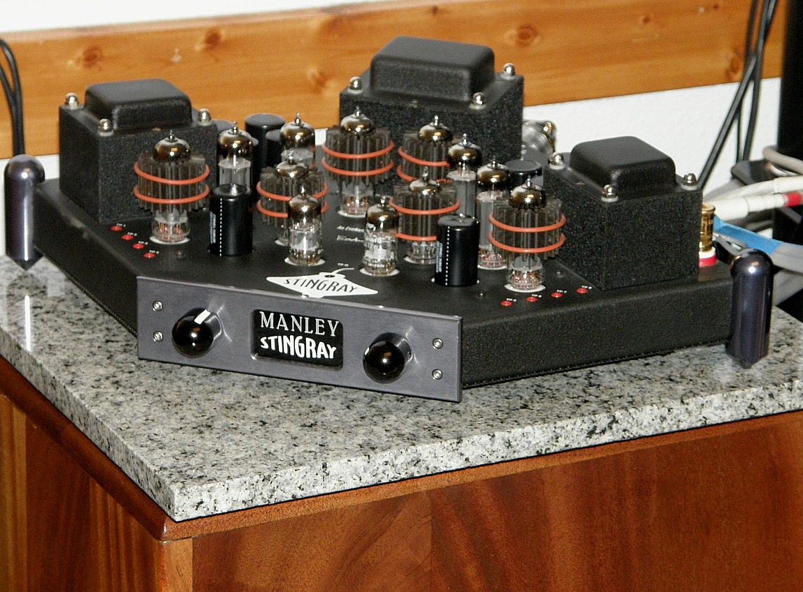

Was wanting to get back into tube amps, and decided to try out an EL84 based amp. Ended up with a Manley Stingray and even had it rebuilt to incorporate a few of the options that the Stingray II has. It just arrived back from Manley today, and I am enjoying the results. Really had no idea how much I had missed a good tube amp.

I can't believe that I didn't take better notice of your wiring here! This is exactly what I try to tell folks about making a 'decent connection' to begin with and not relying on the solder to do the job by itself. Making a good mechanical connection first is the best way to connect wires and leads. How many times have you seen a lead of a component laying across the intended connection and then a coat of solder applied to make it complete? Just not good. Winding a lead like what is shown here (although I don't wind several times, only 1 1/2 times) and then applying the solder is making the connection higher quality from the very start and not utilizing lead solder to pass a signal.
Couldn't pass up the opportunity to share this when it is so evident here. Good looking wiring paths to boot. Better than many manufacturers out there.
