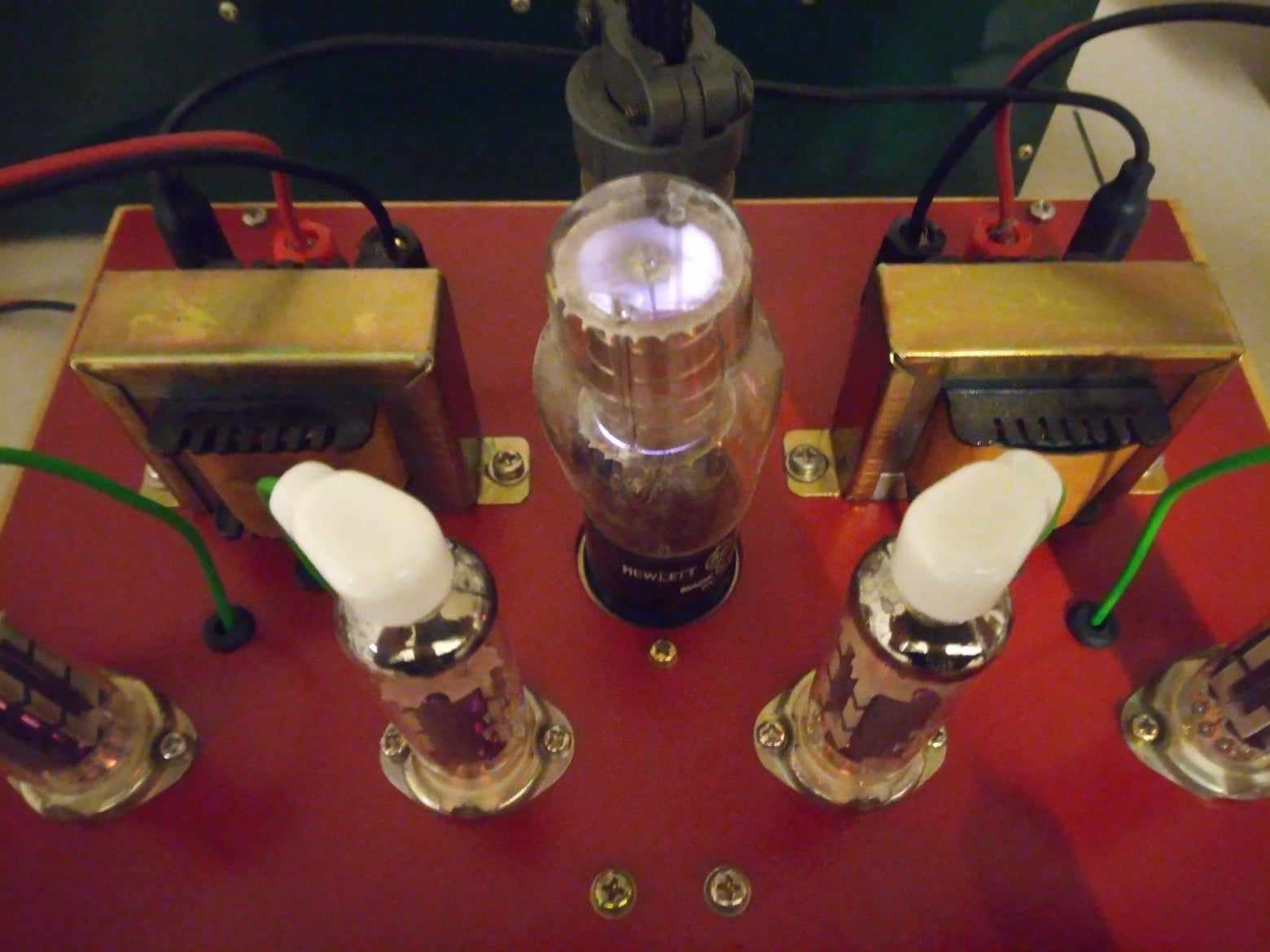

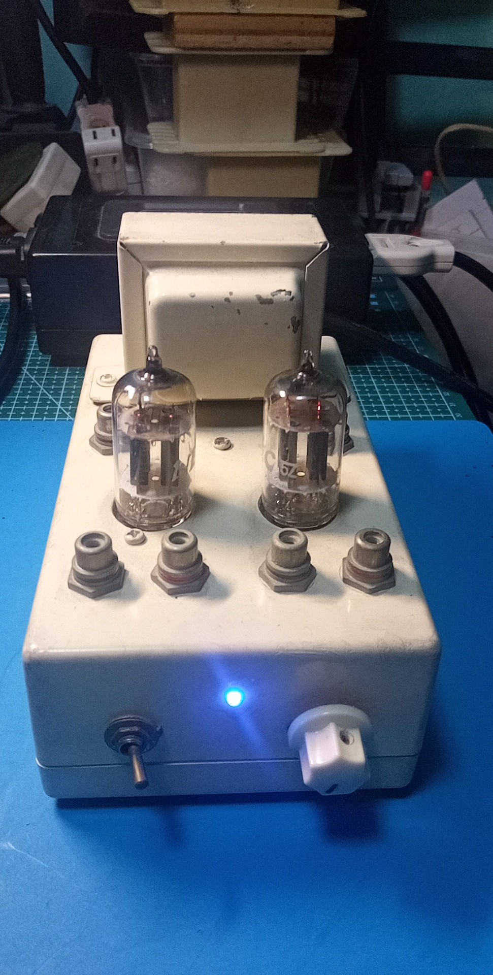

all pentode single ended power amp, 6bn11 dual pentode voltage amp driving 40kg6 pentodes...
line amp is a 7au7, here subbing for the 6rhh2...

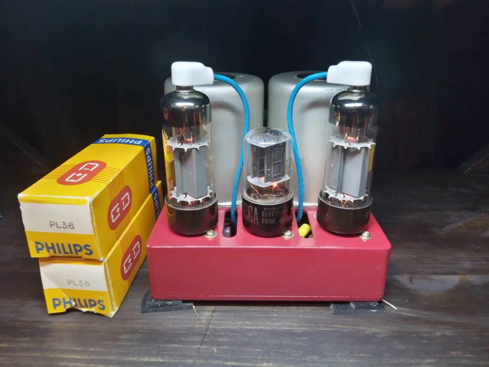

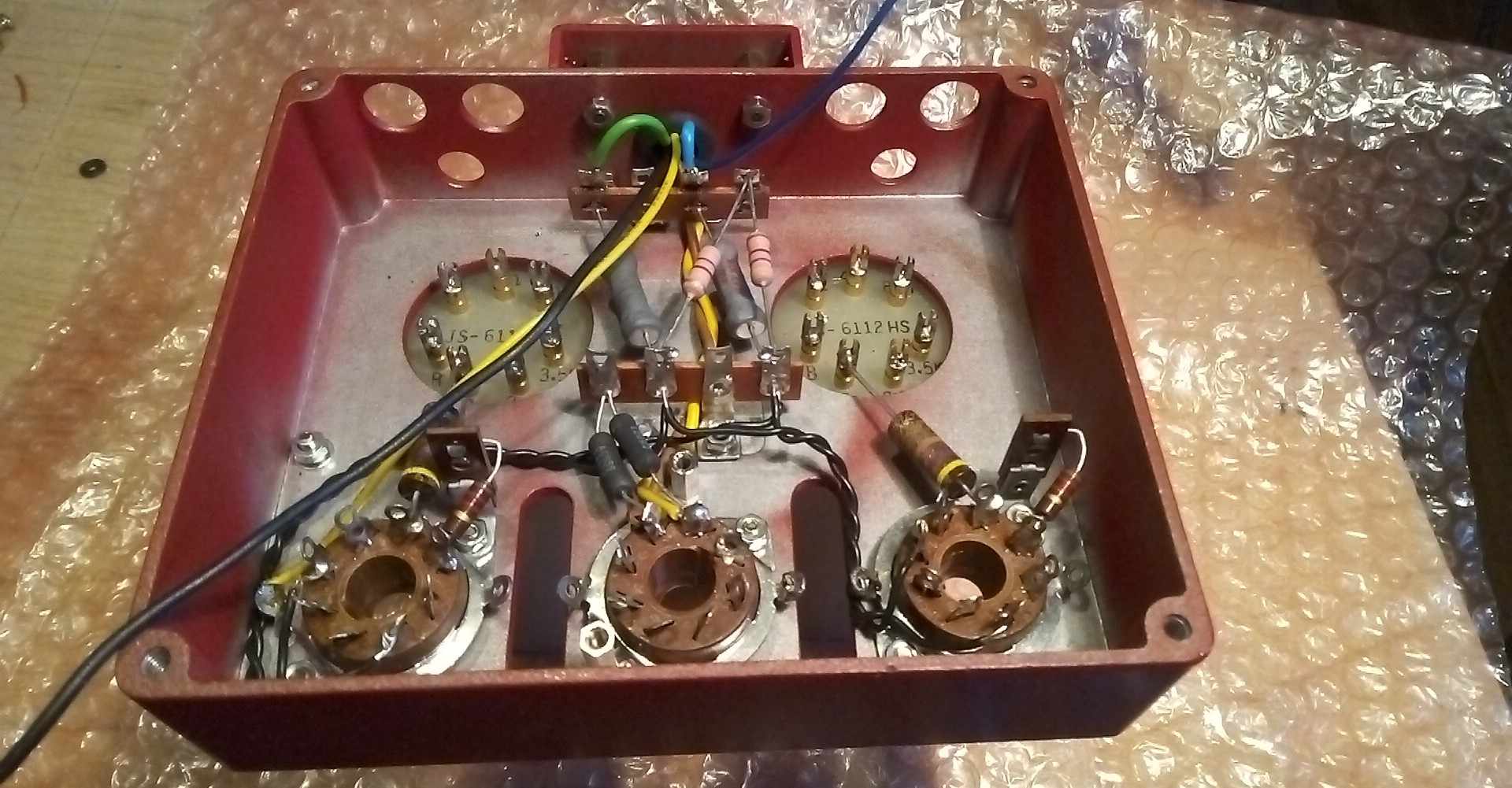

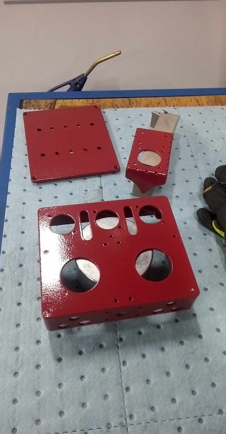

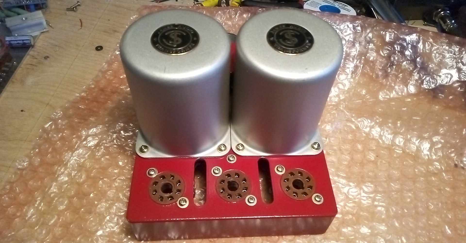

Early Friday morning I got this idea to use a diecast alu box that was left over from my stompbox building era as a tube amp chassis.
The largest one I had was just big enough to fit two old James OPTs and three octal sockets, so I went for a pair of PL36 (25V heater version of 6CM5) and a 6SN7 shared between the channels. As I already had an external PSU with suitable voltages built for my PL36 PP amp (and a spare chassis connector) the whole project went from idea to finished in less than three days.

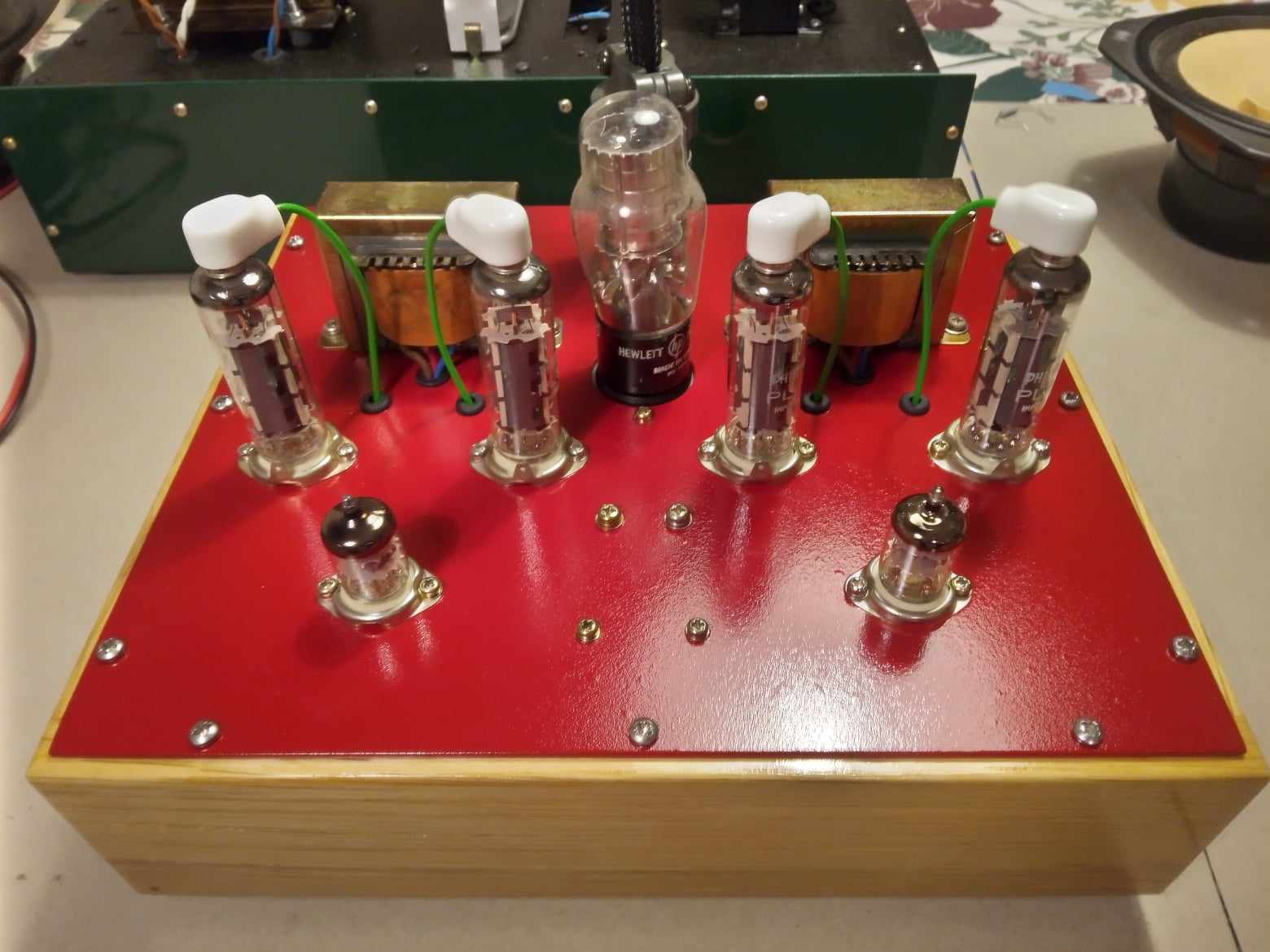

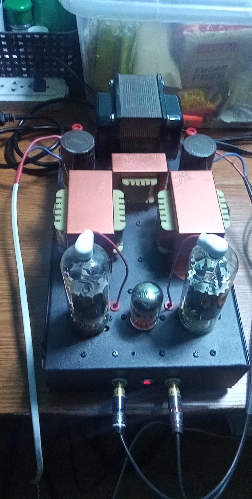

6 days and 22 hours after finishing the amp in the post above, here's a new one:

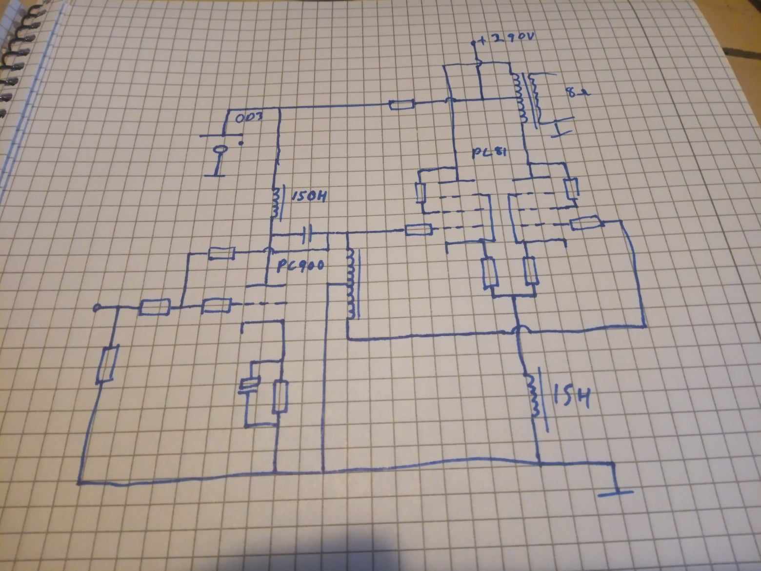

PL81 PP triode with PC900 input tubes and an 0D3 voltage regulator form the input stage (I felt the need for some UV light after weeks without sunshine...)
The phase splitting is done with cheap Edcor XSM transformers and it runs on the same external PSU as both my PL36 amps.

How does it sound?
Thanks, but I already have three dozens or so of those, bought decades ago for some OTL project that never happened. If you have any 6S4S I'm interested?
OldHector: Sometimes I just get a bit "speeded"...😎
I'm listening to it with proper speakers for the first time right now, a bit delayed by a thunderstorm.
Not bad actually, considering the ridiculously cheap iron and the fact that the tubes were chosen by looks rather than electrical parameters.
Nothing particularly wrong with PL81 but the PC900 is not a good choice when you need to swing +-40V.

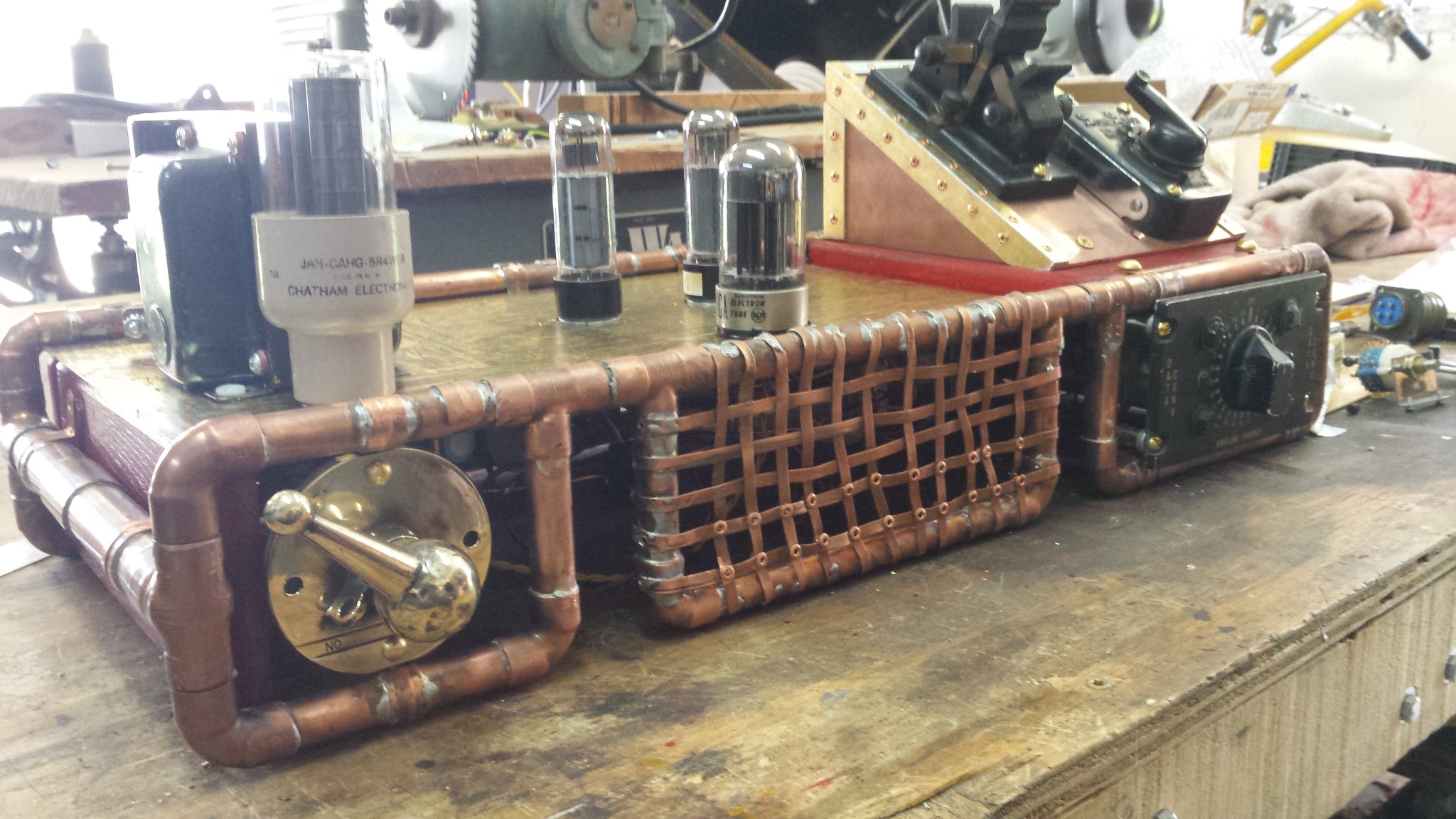

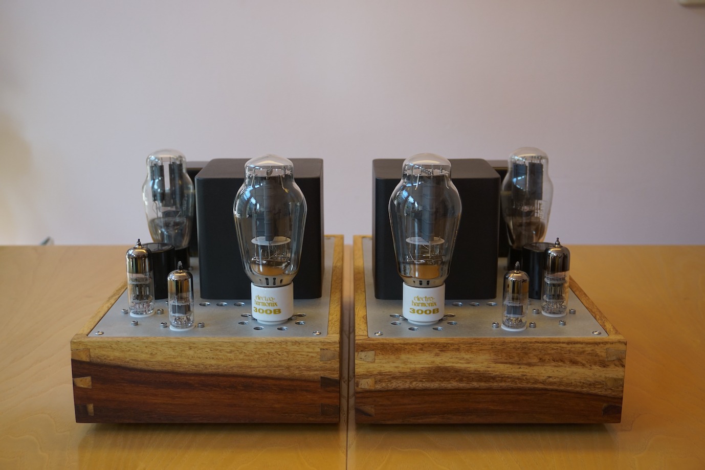

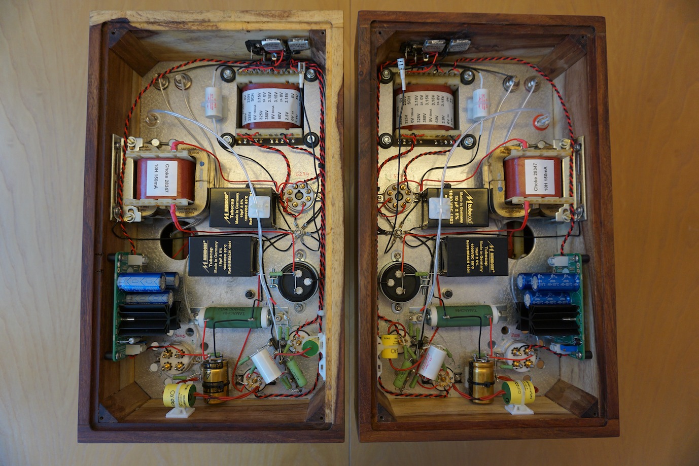

Nice work RR, like the neat layout & wiring. I also liked Mr Fuling 's work - top class.
Andy.
Andy.
RR: nice, neat, compact and hopefully blissful sound. I especially appreciate the dovetail work 🙂

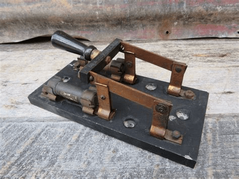

Awesome shapes and structures with those tubes! Still need a "hero" knife switch to complete the look...

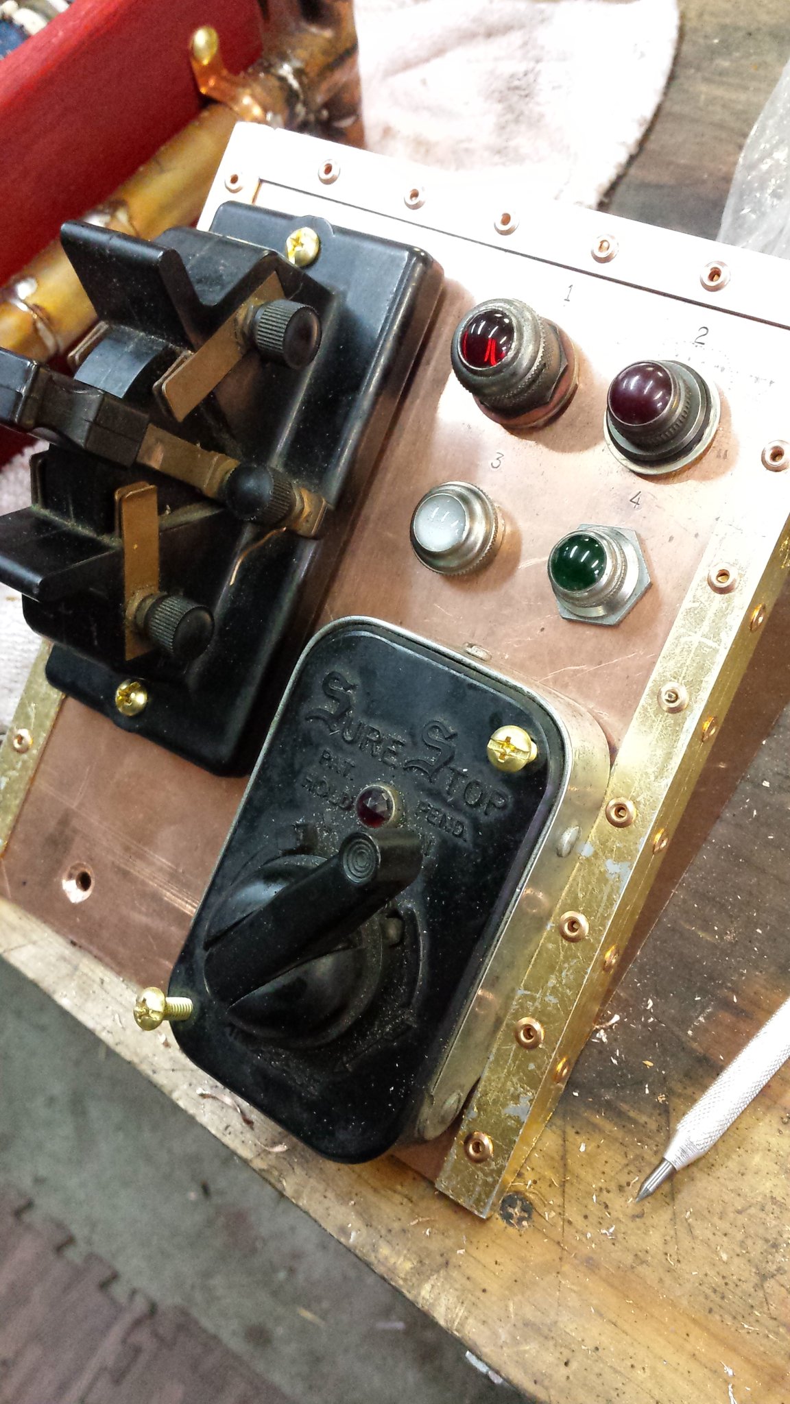

Are those batteries showing in post 11,332, in the lower photo panel?
David
I use something like that on my preamp. 1 is the CD, 2 is the FM, 3 is the TT, and 4 is Streamer.

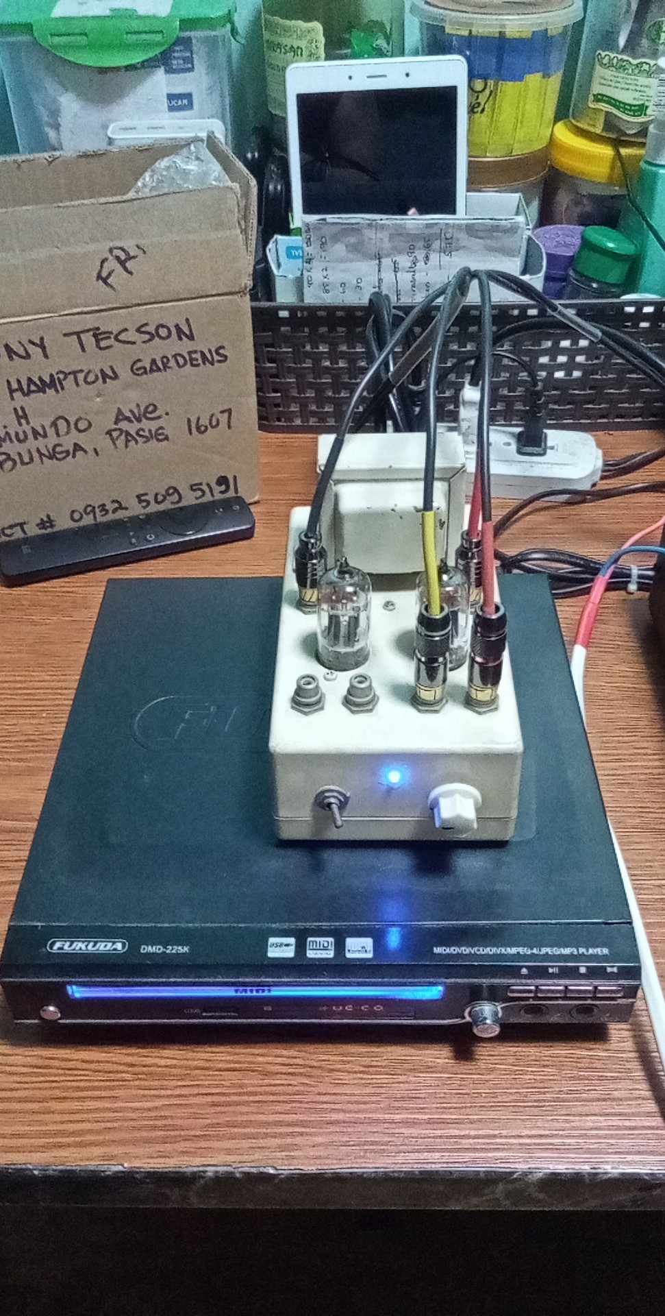

My pleasure David. Here is the preamp in total.
Thanks Duke. it has Slagle autoformers volume controls and remote control.
I like it! Double smile from me...must be fun to use, and Cary says "good job djn! "
