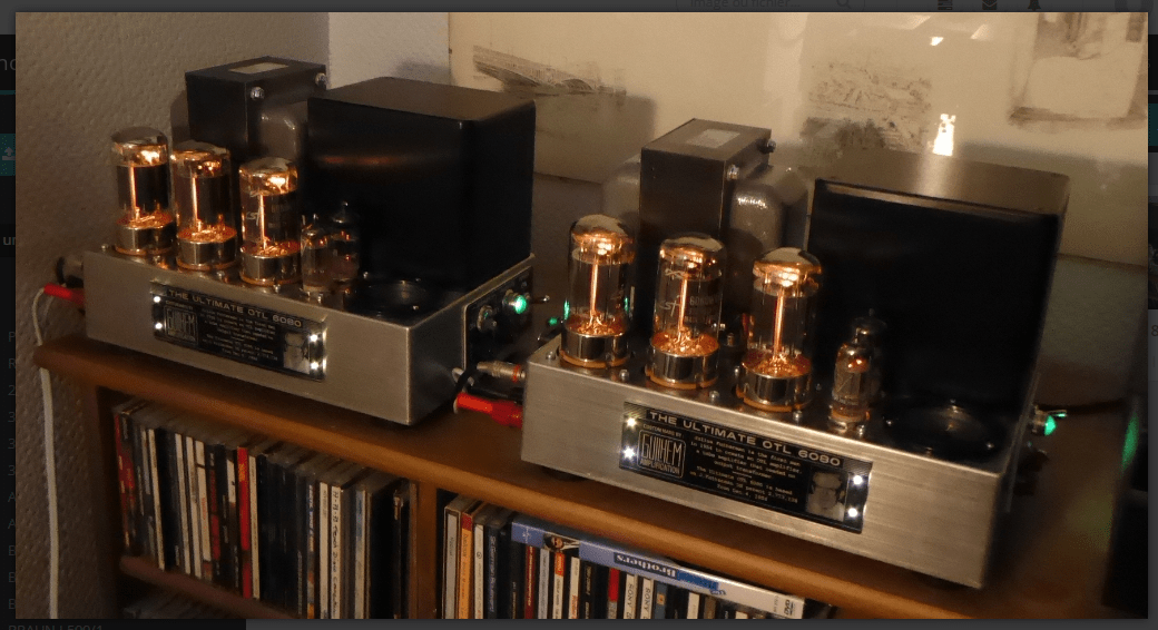

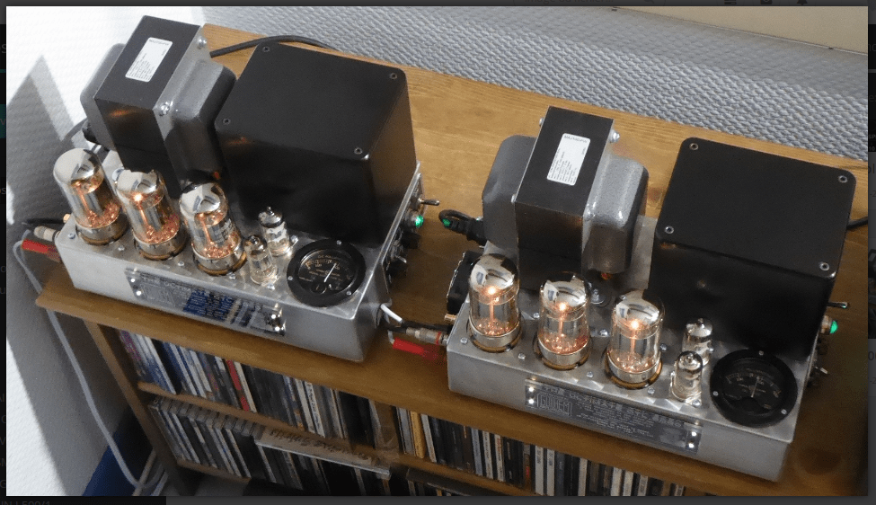

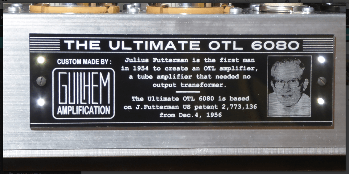

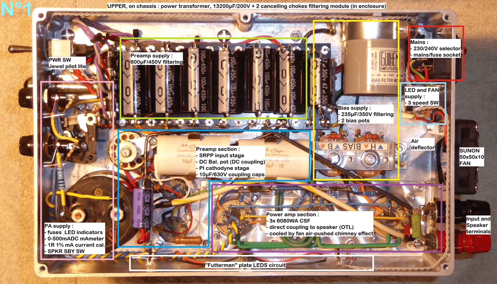

Circa 30 years ago, I wanted to experiment an OTL amp with 7242 regulator tubes which seemed indeed promising, but they cost a fortune both to acquire and power at that time, so I gave up... :confused:
Later, I finally went for the more economical but less performant 6080WA tube, for which I could save a Thomson CSF BNIB stock, saved from trash... This allowed me a very compact pair of mono blocks, based on the Julius Futterman's 1956 patent :

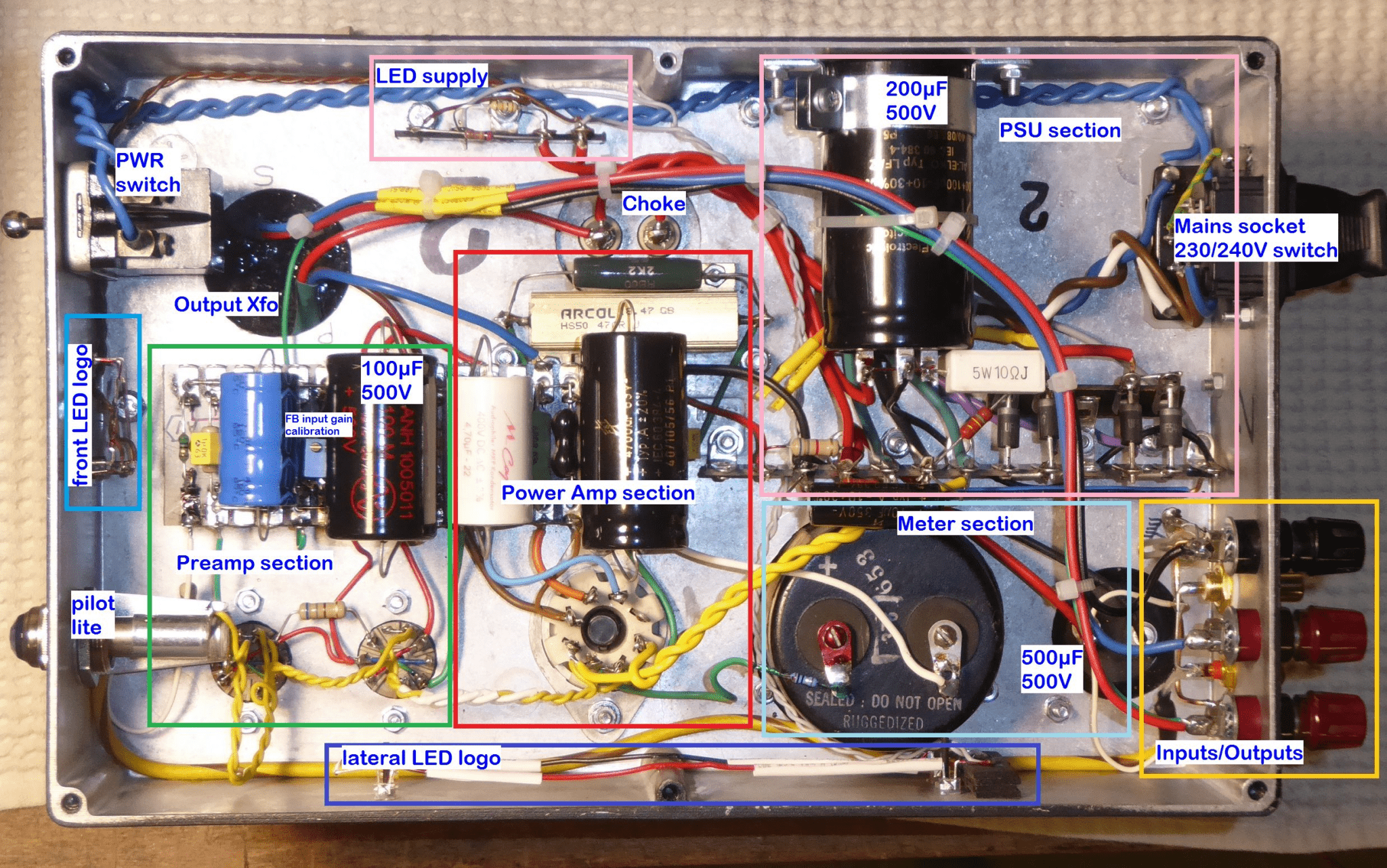

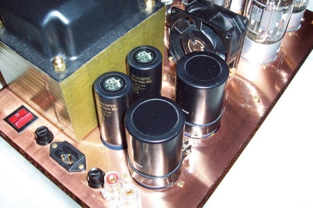

Wow, some cracking work there lads, I'm going to have to up my game, Nice work from Tony & superb layout & presentation from tubelectron. Particularly impressed by the very neat layout & clutter free underside. Do you not have an issue with excess heat though on so compact a chassis TE? Same question to tunerman: that's a lot of big OP valves in so small a space. I've had to fit cooling fans to a few of my amps.
Edit, saw you did use a fan on one amp tubelectron.
Andy.
This^^
I'm an aficionado of efficient real estate design. 2 thumbs up to tubelectron and tunerman

Your right Jim but I'm wary of placing big OP valves too close to each other having built a few amps that get too hot to touch the chassis. I fitted low noise PC fans to a few of my amps to keep both tfmr's and everything else reasonably cool.

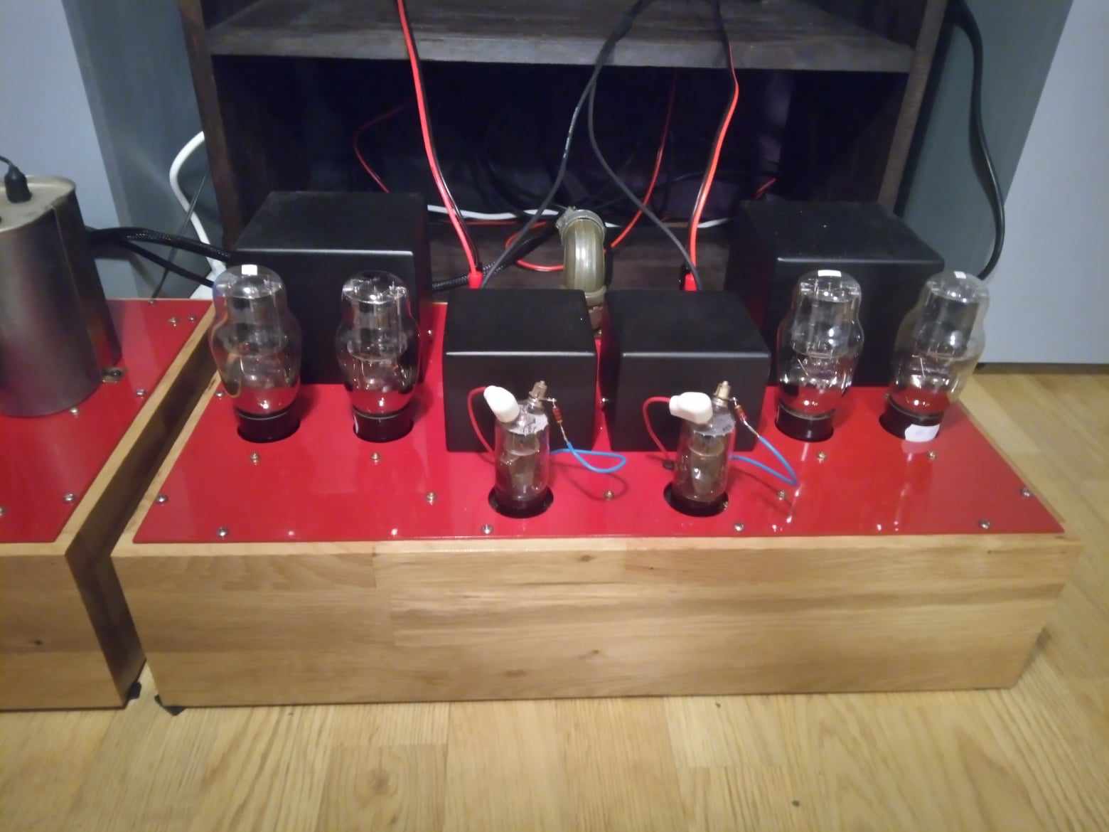

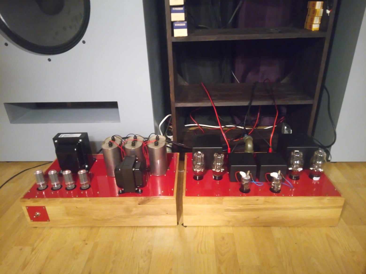

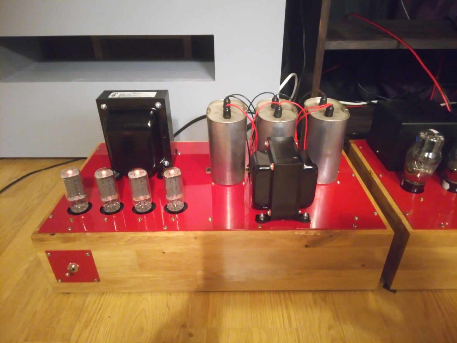

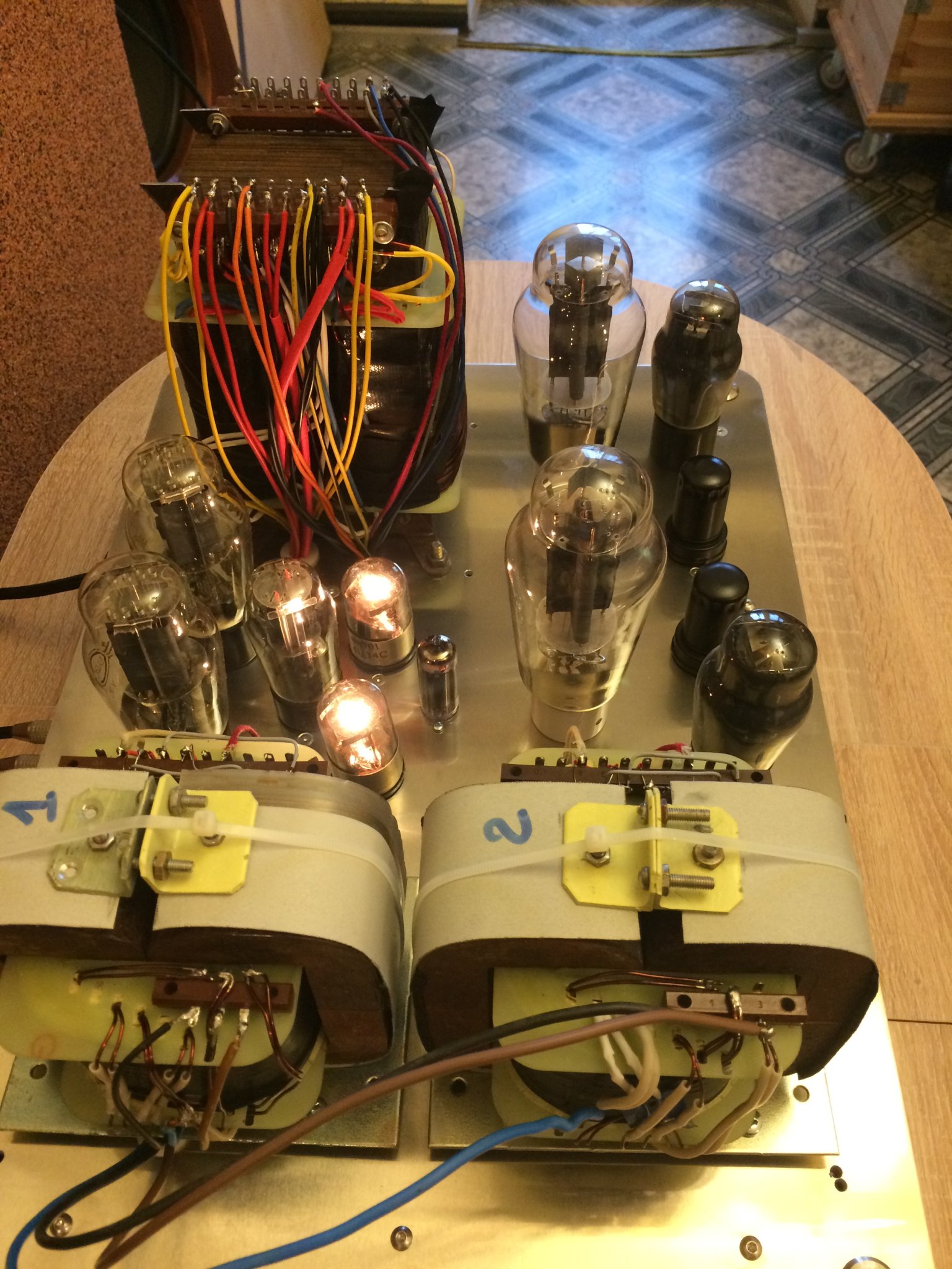

Some blurry pics taken during the test run of my lates build, russian 6S4S (6B4G) PP with CV1135 input tubes and Lundahl ITs and OPTs.
The amp currently operates with cathode biased output tubes but will be modified to fixed bias with Mosfet follower drivers for class A2 operation in the future, I'm still waiting for some necessary PCBs for the modifications.
Sounds very decent already, but with an annoying buzzing from a transformer or choke somewhere inside the PSU. There are six power transformers and thirteen chokes in there and one of them isn't up to the task, even though I tested them on the bench.
