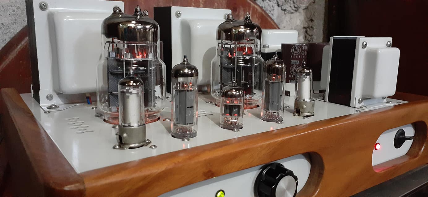

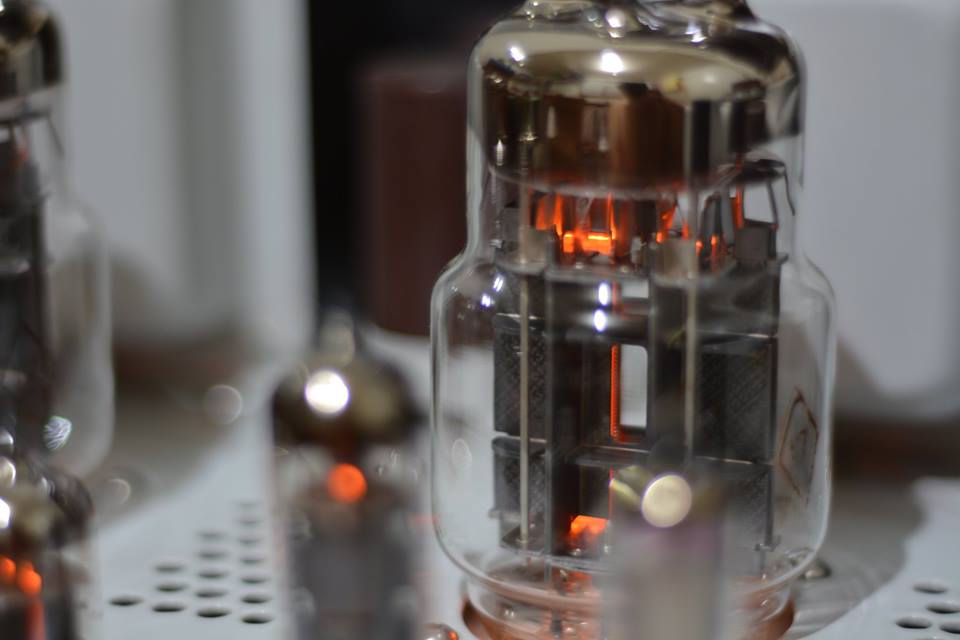

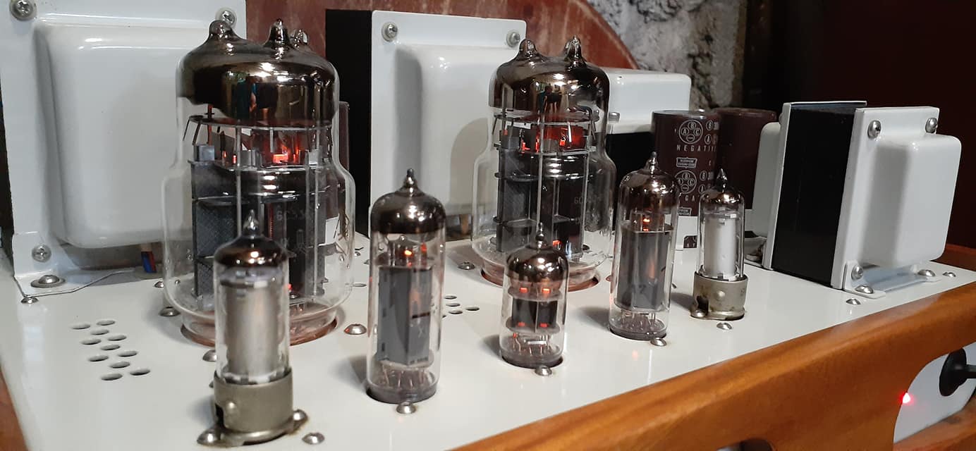

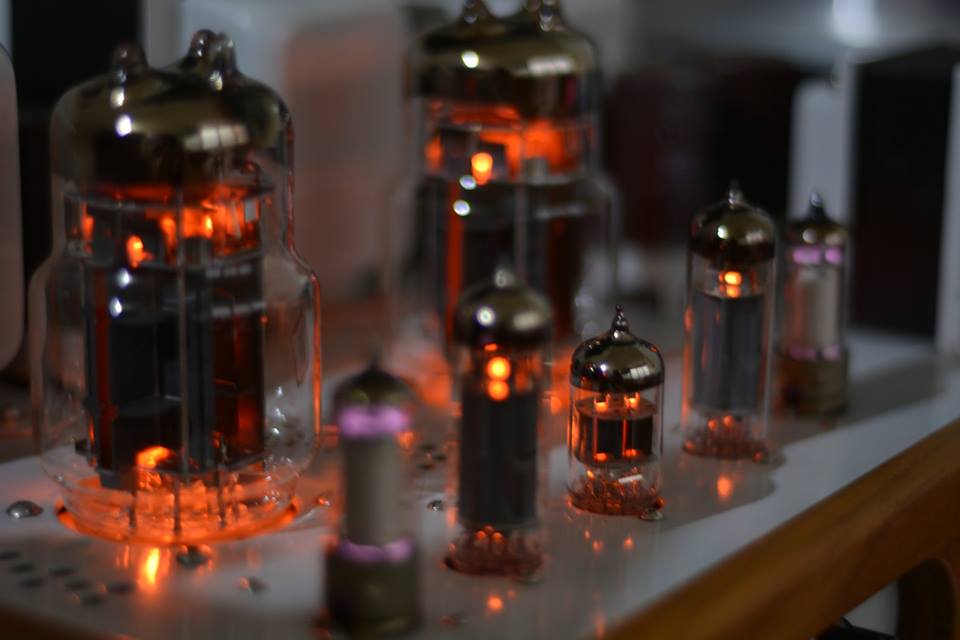

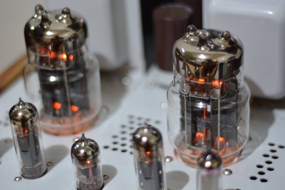

It's finally done. The project that kept getting put on the back burner for me that I really wanted to complete.
Design by Alex Cavalli which is a streamlined Futterman OTL. Parts from the four corners of the Internet - I've been buying parts here and there for years. I couldn't really get a front design that I liked which would set it apart from my other pieces. I wanted a vintage look for sure and finally settled on something that might include wing designs from the 1930s and a pilot light from many eras. The front panels were ultimately done by Front Panel Express. The rest of the design started falling into place this year. The wings, in particular, were a bit difficult for me to align with the pilot light as they came from a jewelry supply store so had their own mounting holes...which were not quite what was needed for a panel mount. Many drill bits and measuring(s) later they were done.
The rest of the parts are working really well together. 6922 or 6DJ8 tubes on the input and 6N6P output tubes. Gold Point stepped attenuator, Cardas input jacks, DH Labs Pro Studio interconnect as input, Cardas output wire, the 370DAX transformer and a Muffsy power breakout board which holds a MeanWell 120V -> 5V transformer for the pilot light. I am currently using photo flash caps which are 410uF. In the future I may change these to something lower. Who knows? There are no LEDs on the amp boards and I decided to skip the NFB circuit. So no, the amp isn't particularly great with Grados. As expected.
The amp is a treat with Sennheiser HD600s, of course. It's also happy with a pair of AT-ESW9. There is a musical rightness to it, even with mediocre sources. With great sources: it's delicious! Like most great components, though, it's difficult to describe what it is doing other than giving me more insight and emotion than many other amps I own.

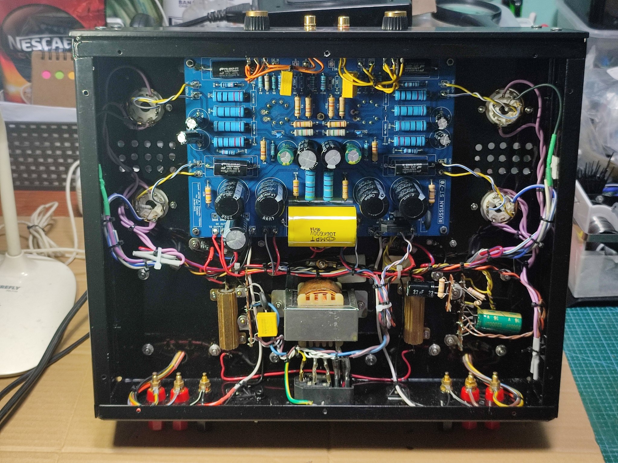

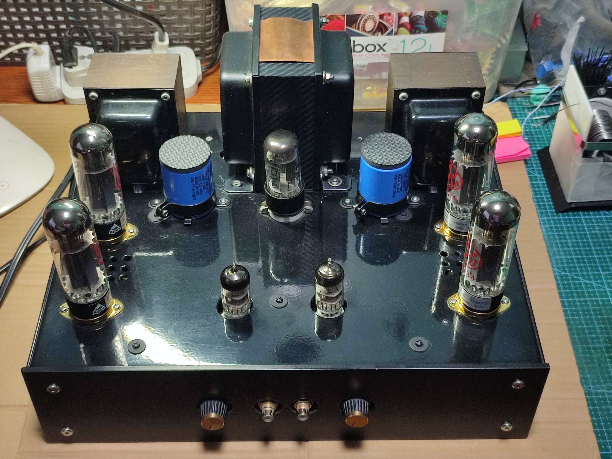

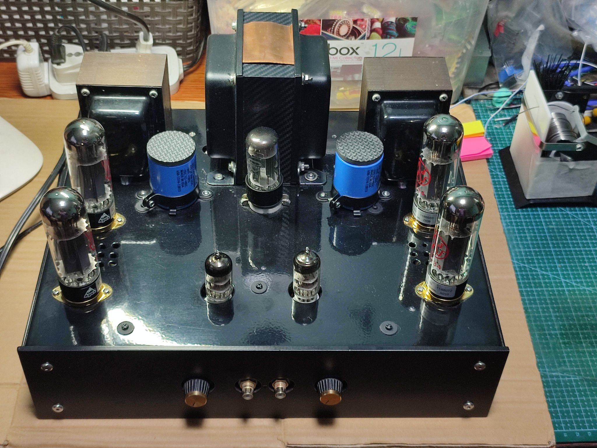

Neat work Tony. What PCB did you use? Also what was the noise like? Noticed the heater wiring wasn't twisted all the way to the EL34's. I've always struggled slightly wiring htrs on octal sockets on power valves which are pins 2 & 7 unlike a small signal triode like the 6SN7 which have htrs on pins 7&8. Wonder why they wired power valves differently?
Andy.
Reactions: 1 user

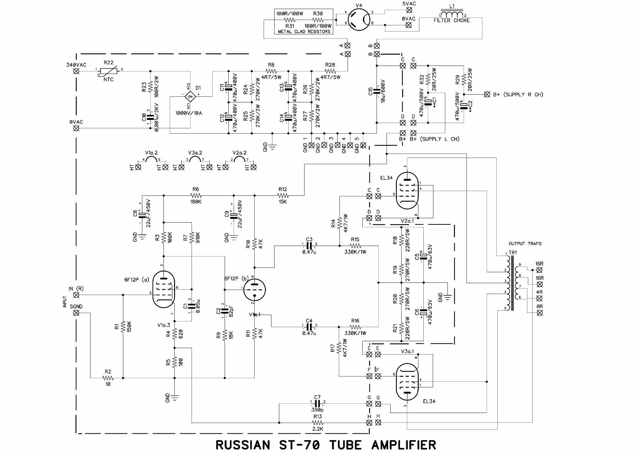

Andy,
i am sure i will raise quite a lot of eyebrow's, the psu is nothing you probably have seen...
noise os quite good, excellent even....twisted wires for ac heaters need not go all the way....
we made a pcb to incorporate all psu parts and then some...so that wiring is kept to minimum....
will post as built and revisions, the 6f12 has far too much gain than the 7199...

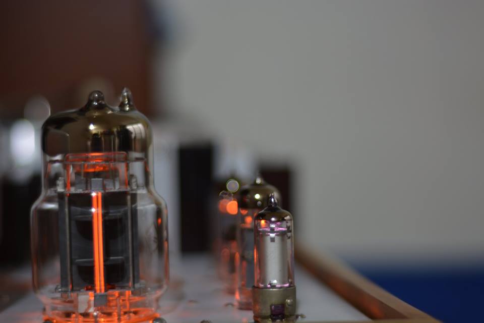

it is not the delay per se, but the avoidance of surges, hence the soft starting wherein inrush of currents to the transformer and psu caps are mitigated, the impedances along with the rectifier dynamic impedance all collaborate to achieve this soft starting...yes, with a delay of course...
in my 6C33 SET, i used a 10k power resistor from psu rectifier cap to the tube circuits to achieve a ramping up of voltage whilst waiting for the filaments to warm up to operating temperature, and at which time the series resistor is them shorted out by relay contacts to bypass that current limiting resistor...it has been almost 12 years since ad the amp still lives on....https://www.diyaudio.com/community/threads/my-russian-set.216206/

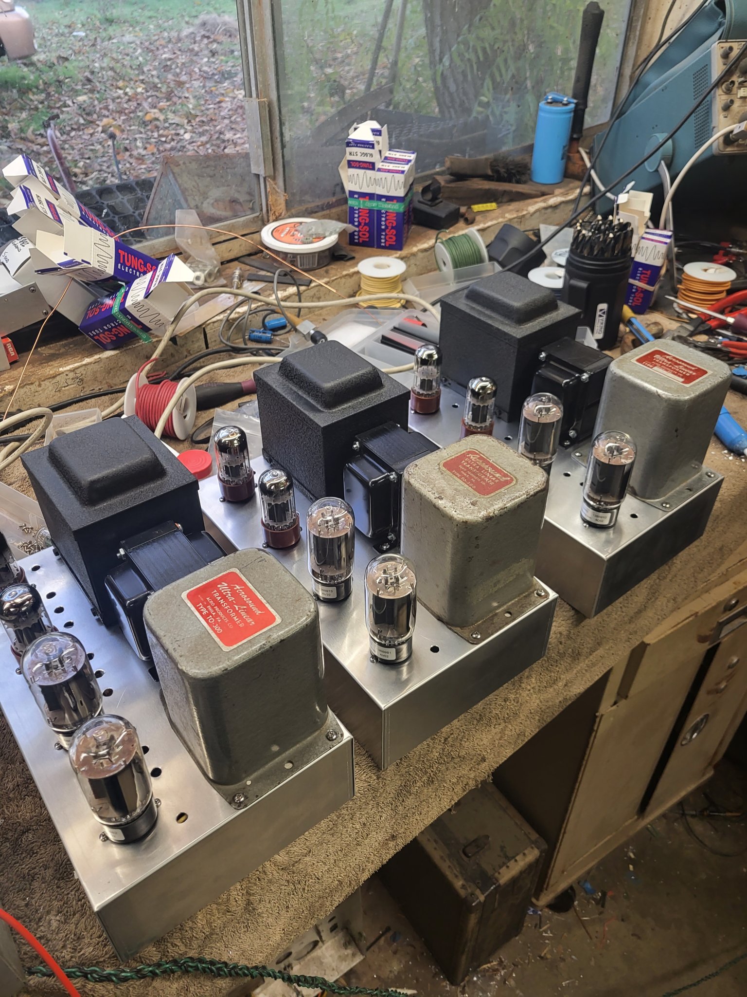

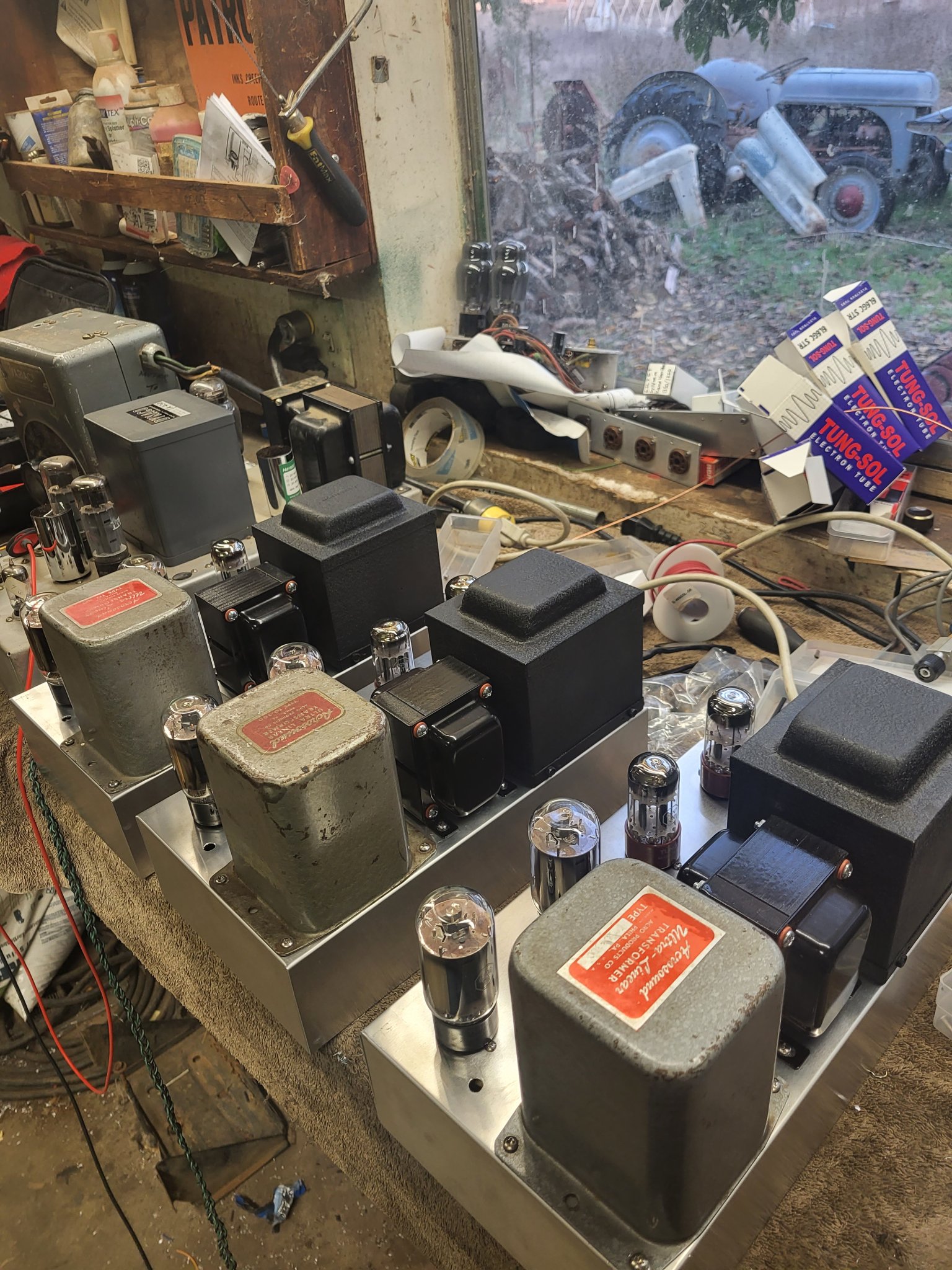

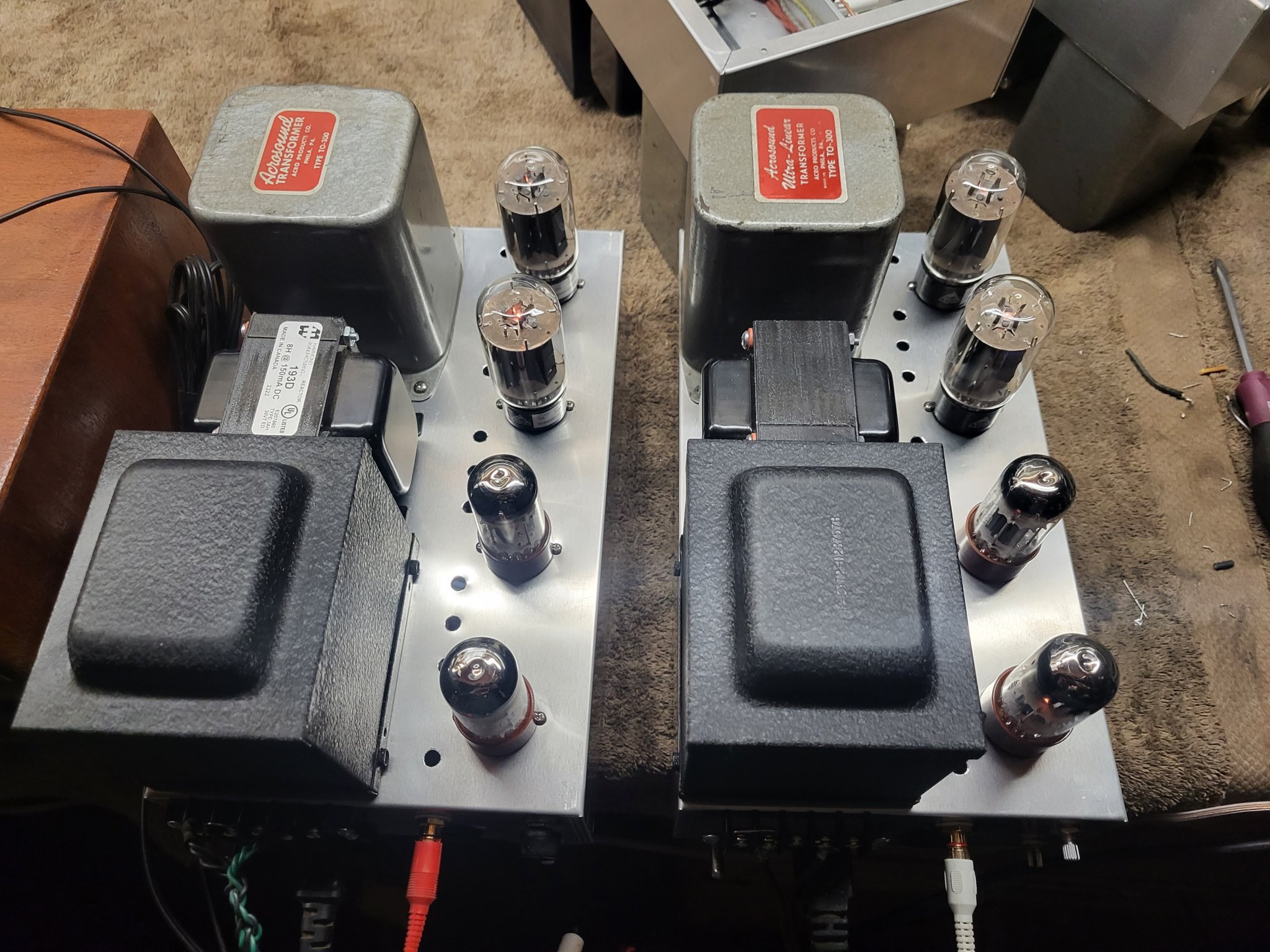

Some photos of the Acrosound TO-300 ultralinear amplifiers which I just built. I'm at the stage of checking for errors and performance testing. There's 4 mono channels of amplification.
Octal plug setup for McIntosh c8 and c8s preamps.
6sl7 6sn7 and 2 matched 6l6 per amplifier, solid state rectified.
~20 watts per channel and they are very nice to listen to with 12 db of global feedback.
Power supply is 3x overkill, ultra beefcake! And there's 4 of them.
