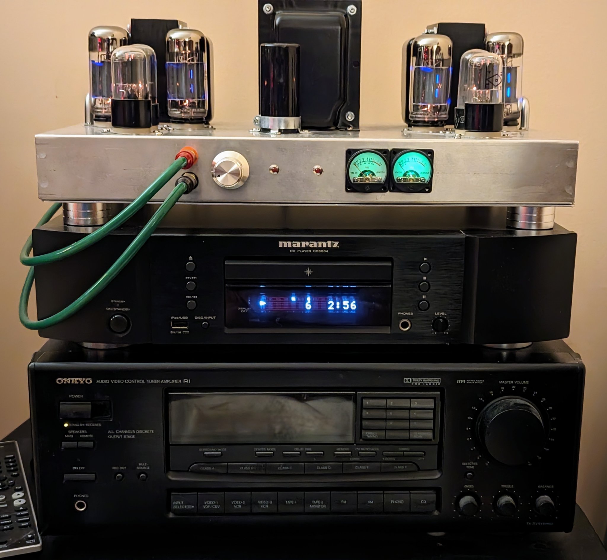

The Onkyo sees very little action these days 😀

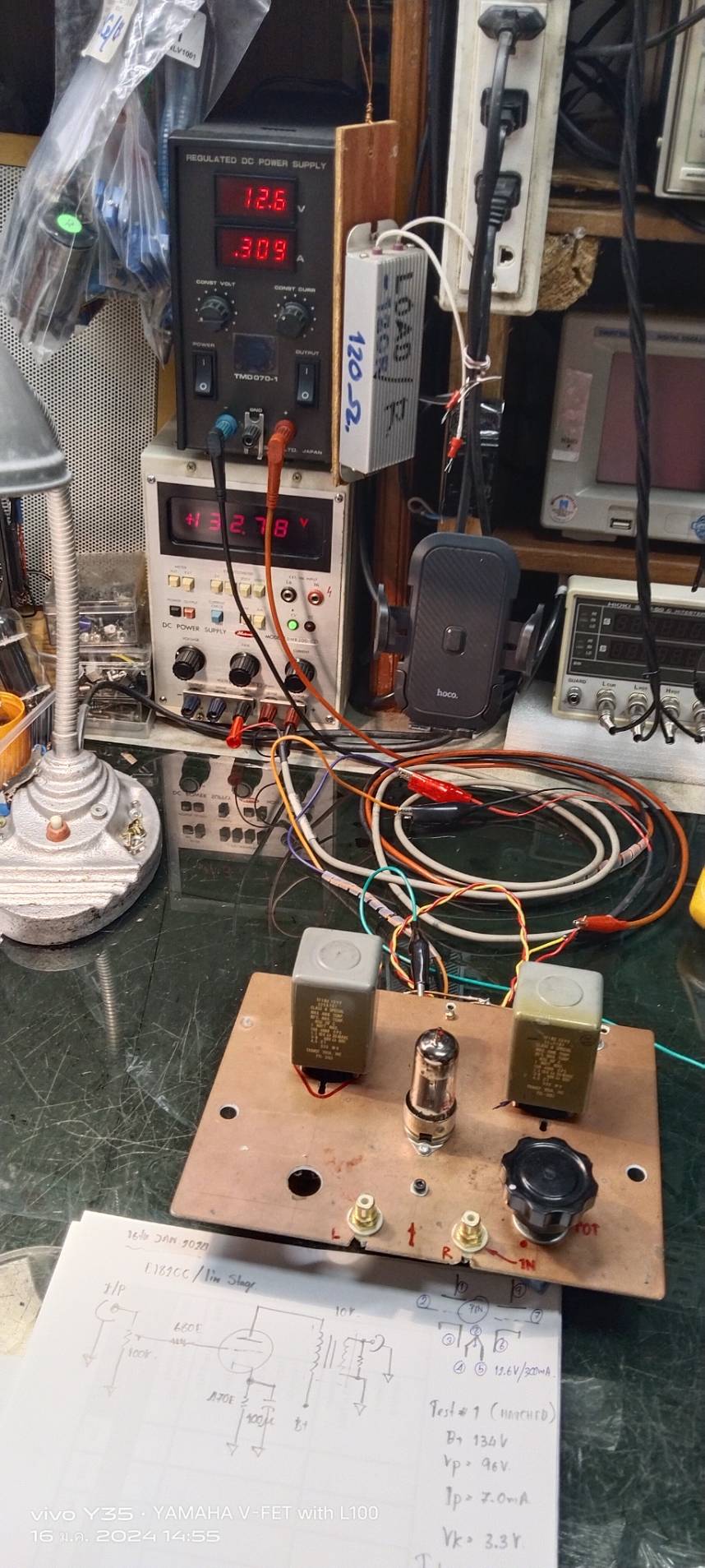

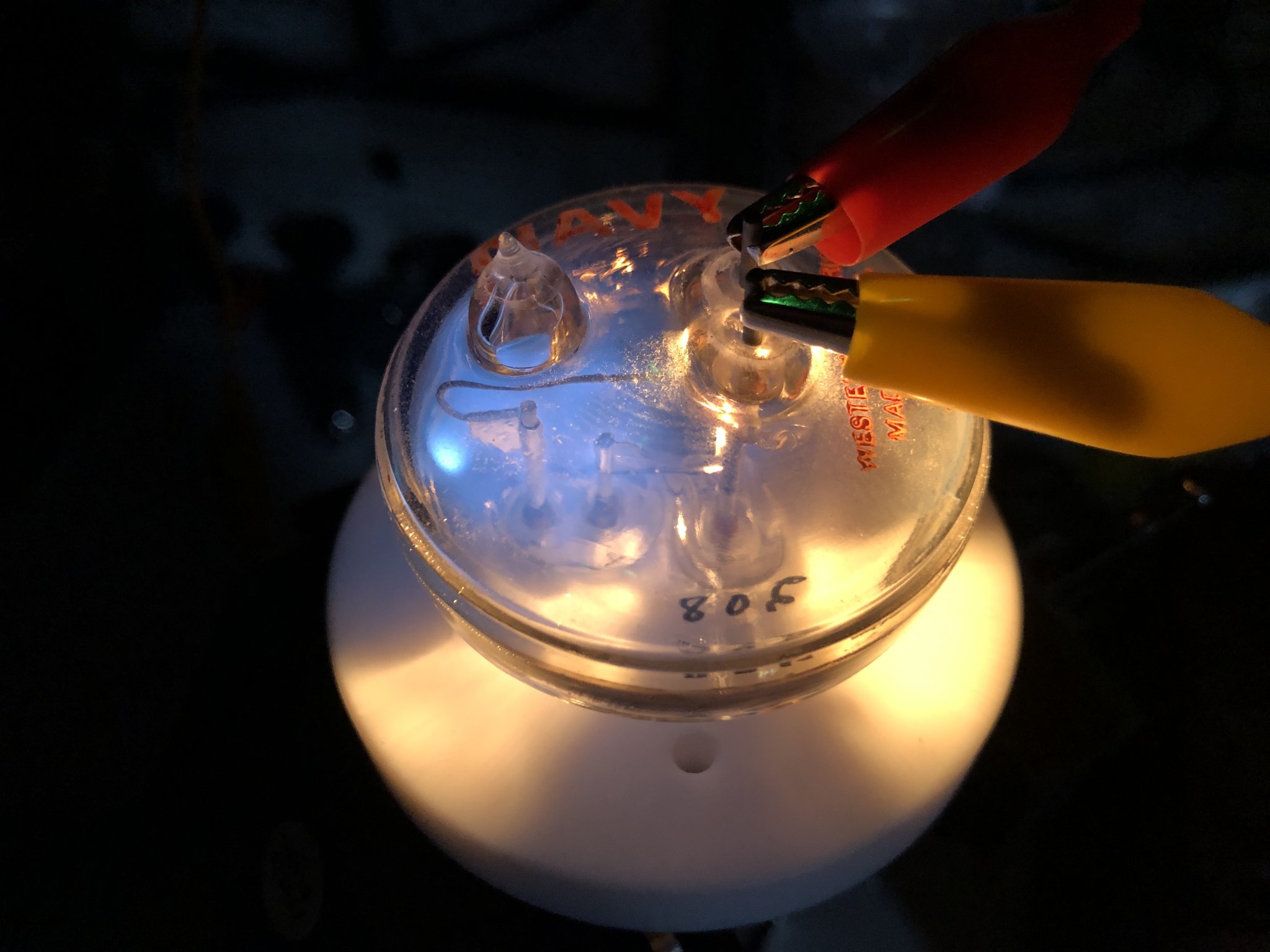

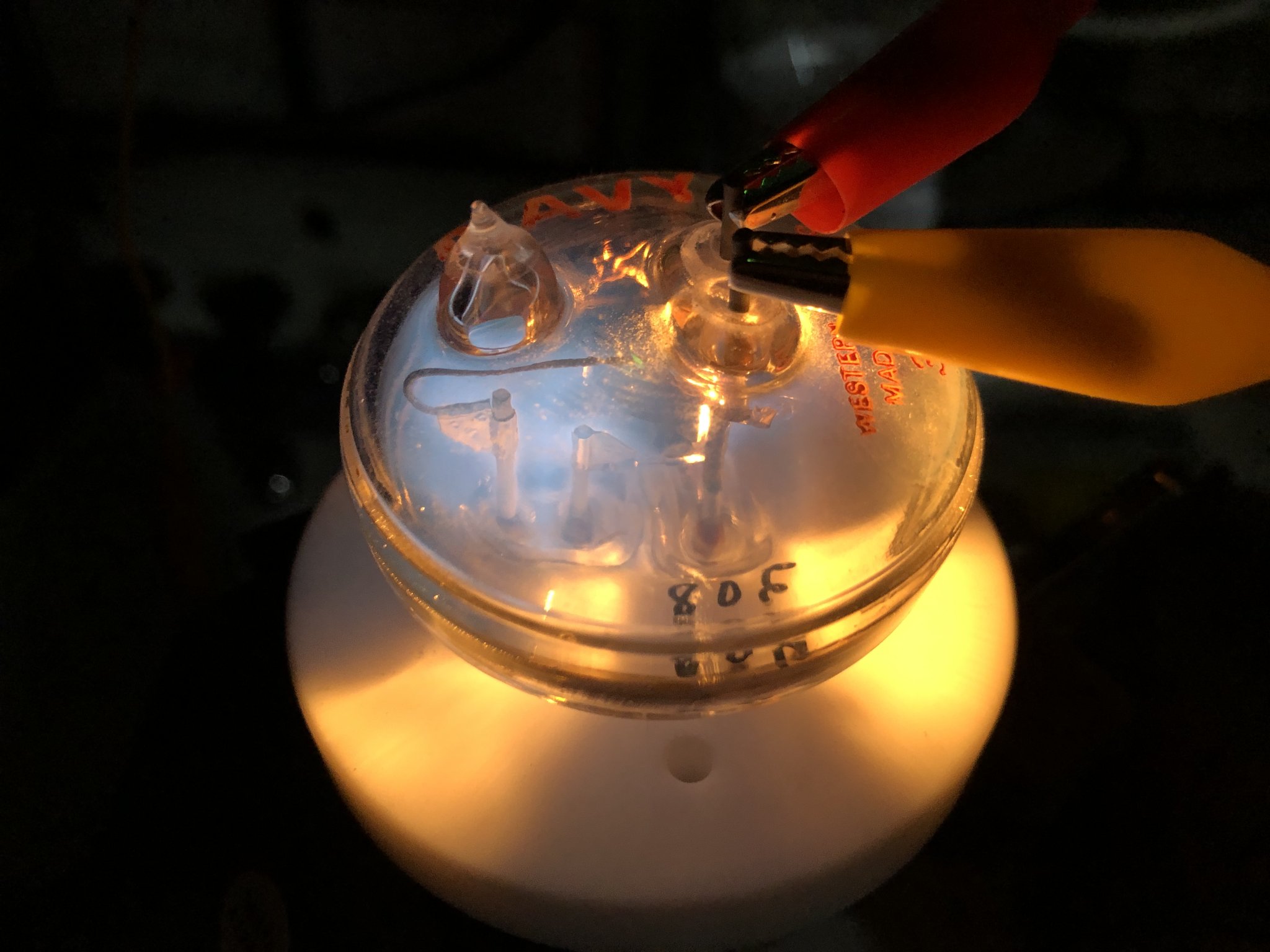

Decided to apply some power to a pair of 368A tubes that had been sitting on my display shelf for years. Long ago I had always toyed with the idea of using them to drive a larger tube and even had some sockets machined. The first tube lit but rather dimly, I recalled them being brighter but oh well. Let it burn in for a few minutes and then noticed it was out. High resistance now. Guess the vacuum was bad and the filament was slowly burning out. Ok onto the second tube. This one lights bright as it should so let's apply some plate voltage and grid bias. Hmmm 100 volts on the plate and no current draw. Crank up the voltage further and see a distinctive blue glow inside. This second tube is also a dud. Oh well enjoy the pictures. I discovered two 388A tubes that I don't even remember buying. These actually light as expected but have different dimensions on the pins so my old sockets will not work. Later on I'm going to wire up a Hammond SE transformer and feed my distortion analyzer right into the grid as it can output 16 volts. Should be an interesting experiment!

Sorry for the 368A duds. RIP.

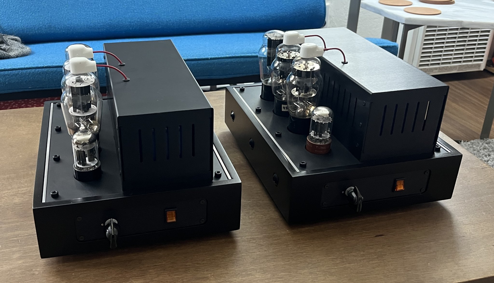

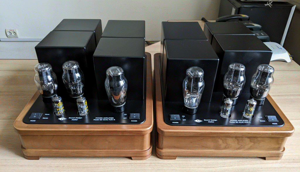

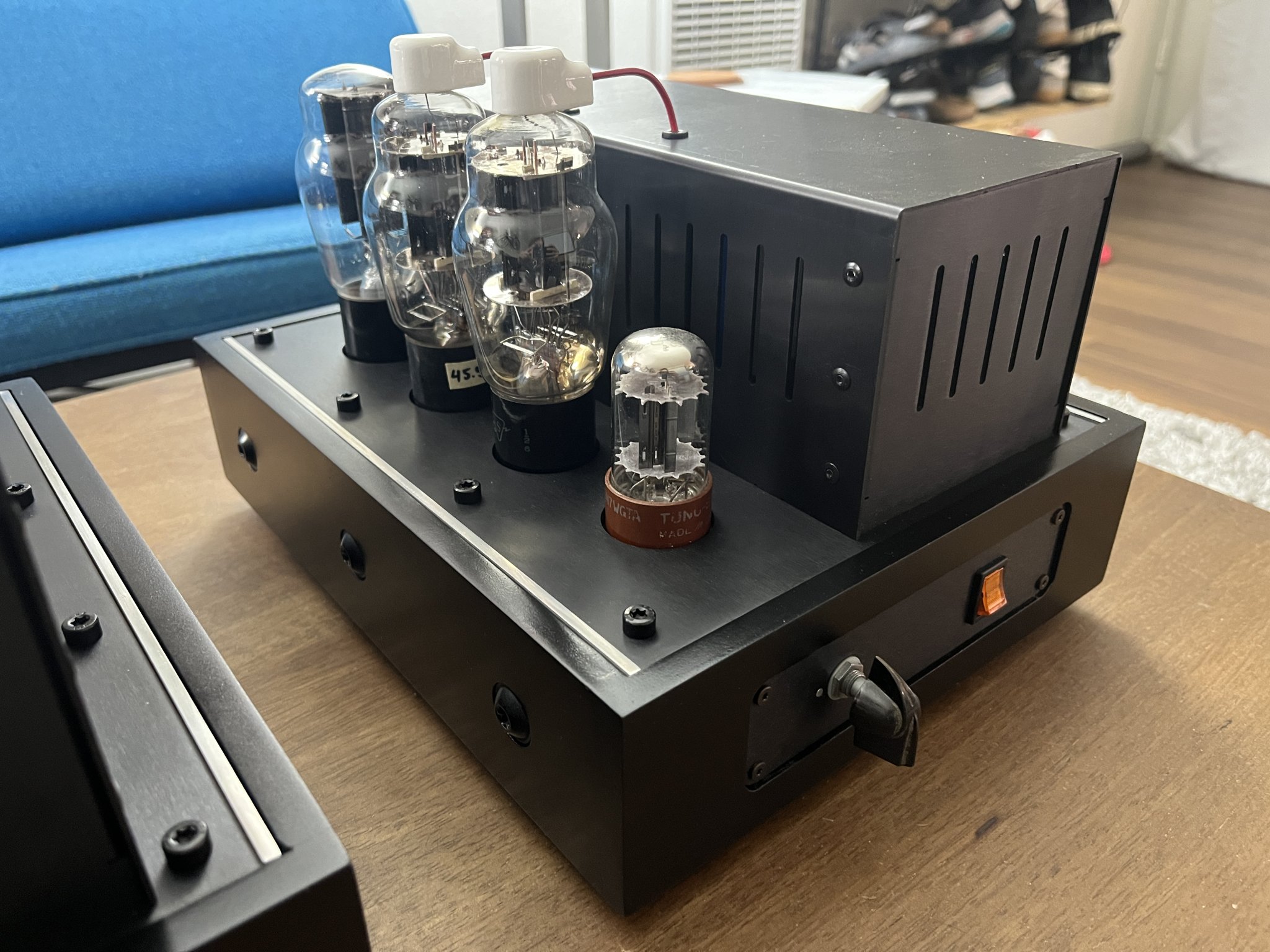

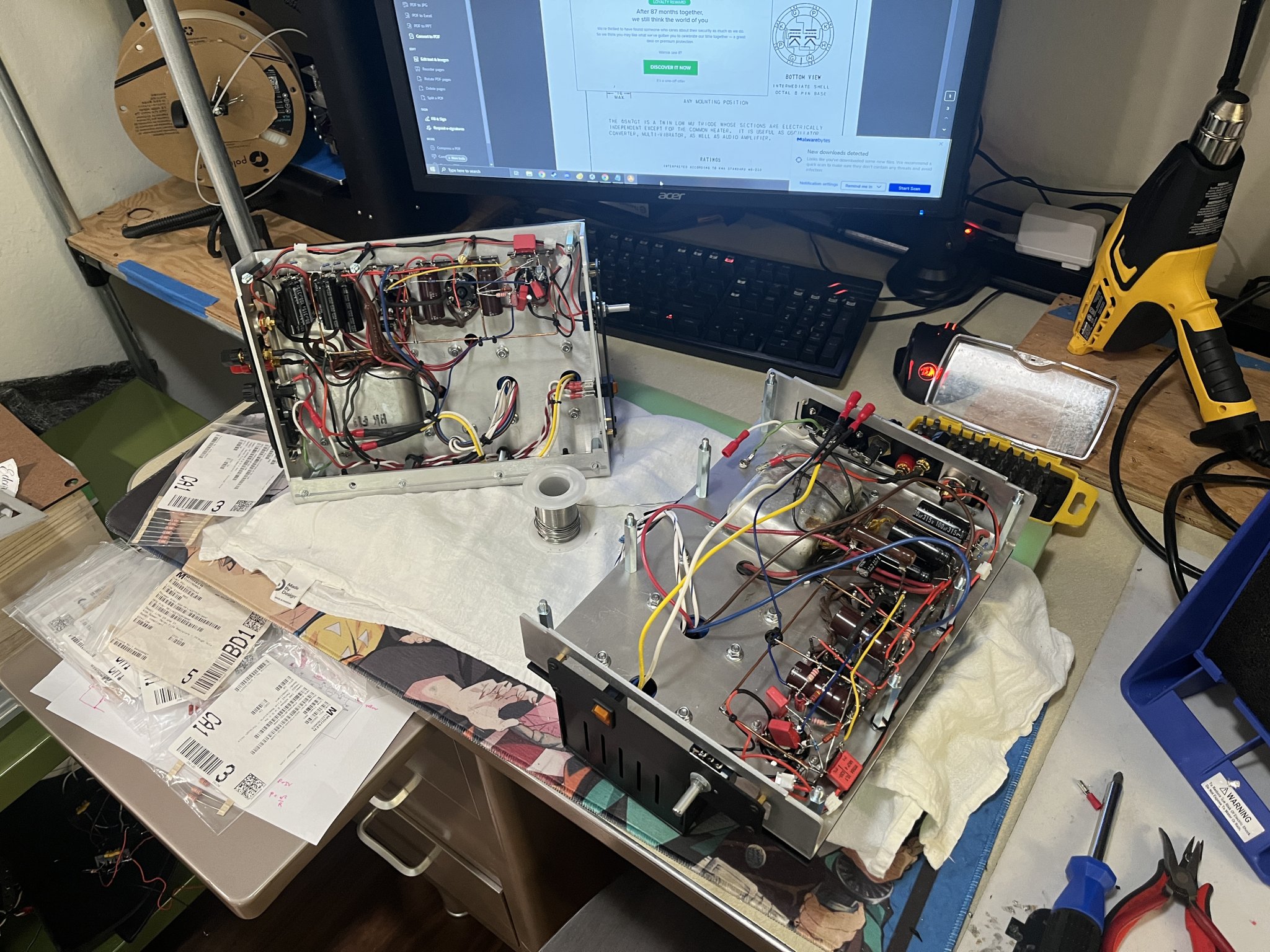

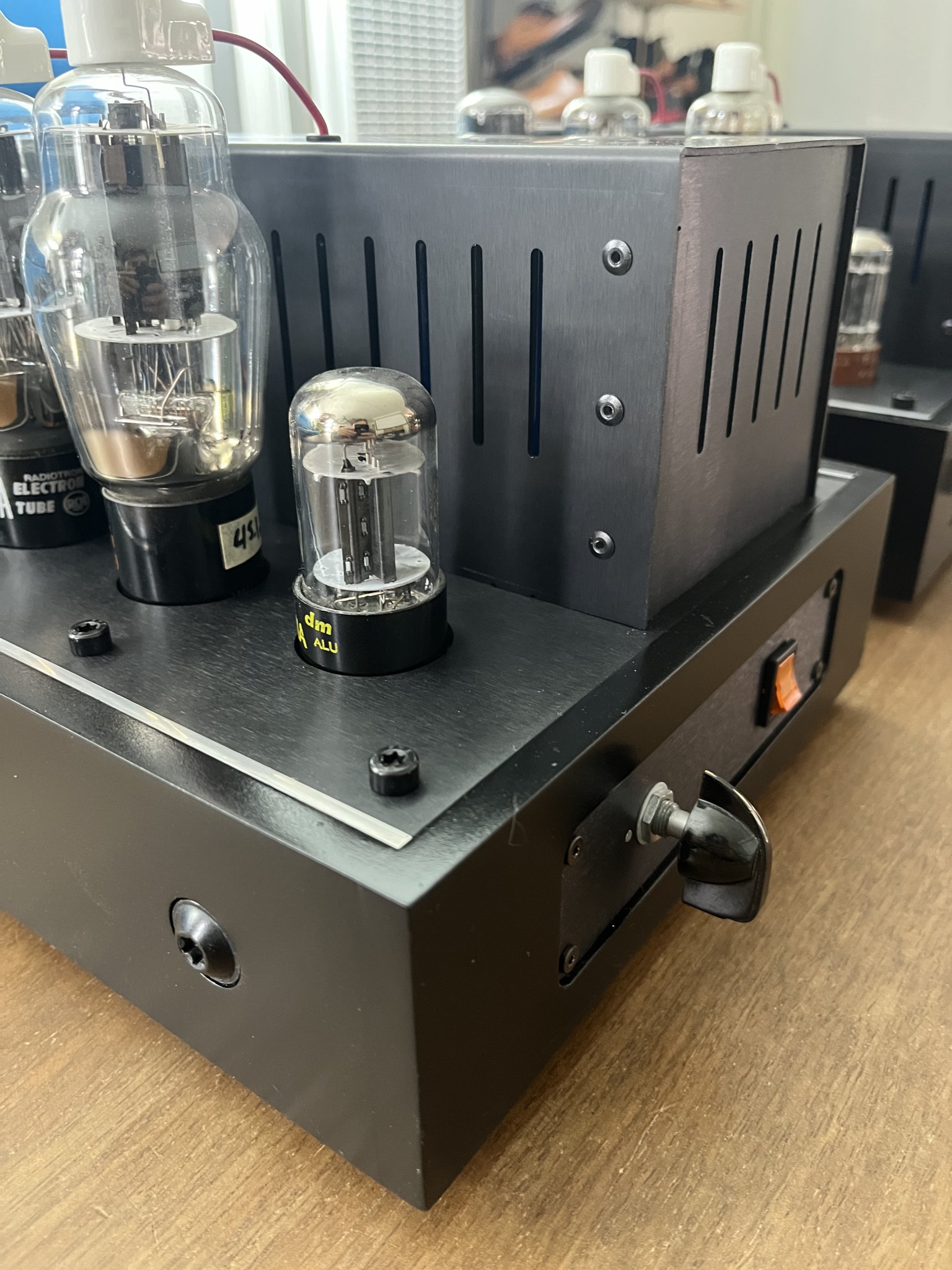

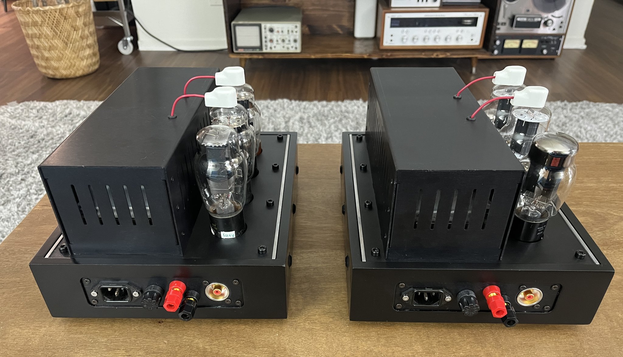

I had two Hammond M3 organ power transformers that had been begging to be put into monoblocks for the last 6 years and if I finally got around to it. I built these around the power transformers and 6BG6 output tubes, with the design goal of having the amps occupy an 8.5”x11” letter sized footprint. Front end is a 6SN7 and rectifier is 54UG.
The chassis construction is all original, custom designed by me. Cut, formed, and anodized by SendCutSend.
The trim is painted MDF.
Close up of some of the cosmetic fasteners. Thrifted from my line of work:
The internals are point to point. I got quite deep into PCBs for a while, but decided to go back to basics for this one.
Thanks for looking!

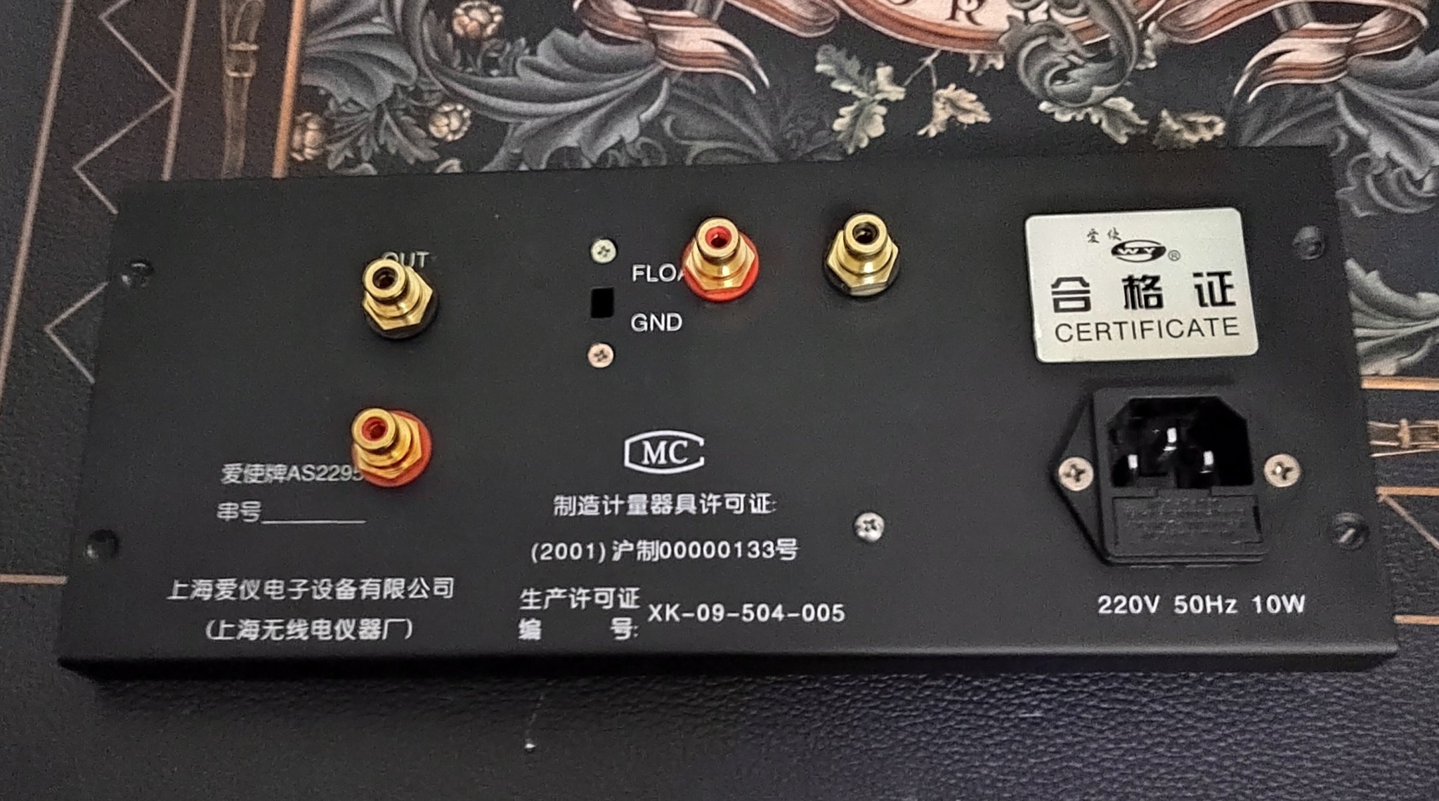

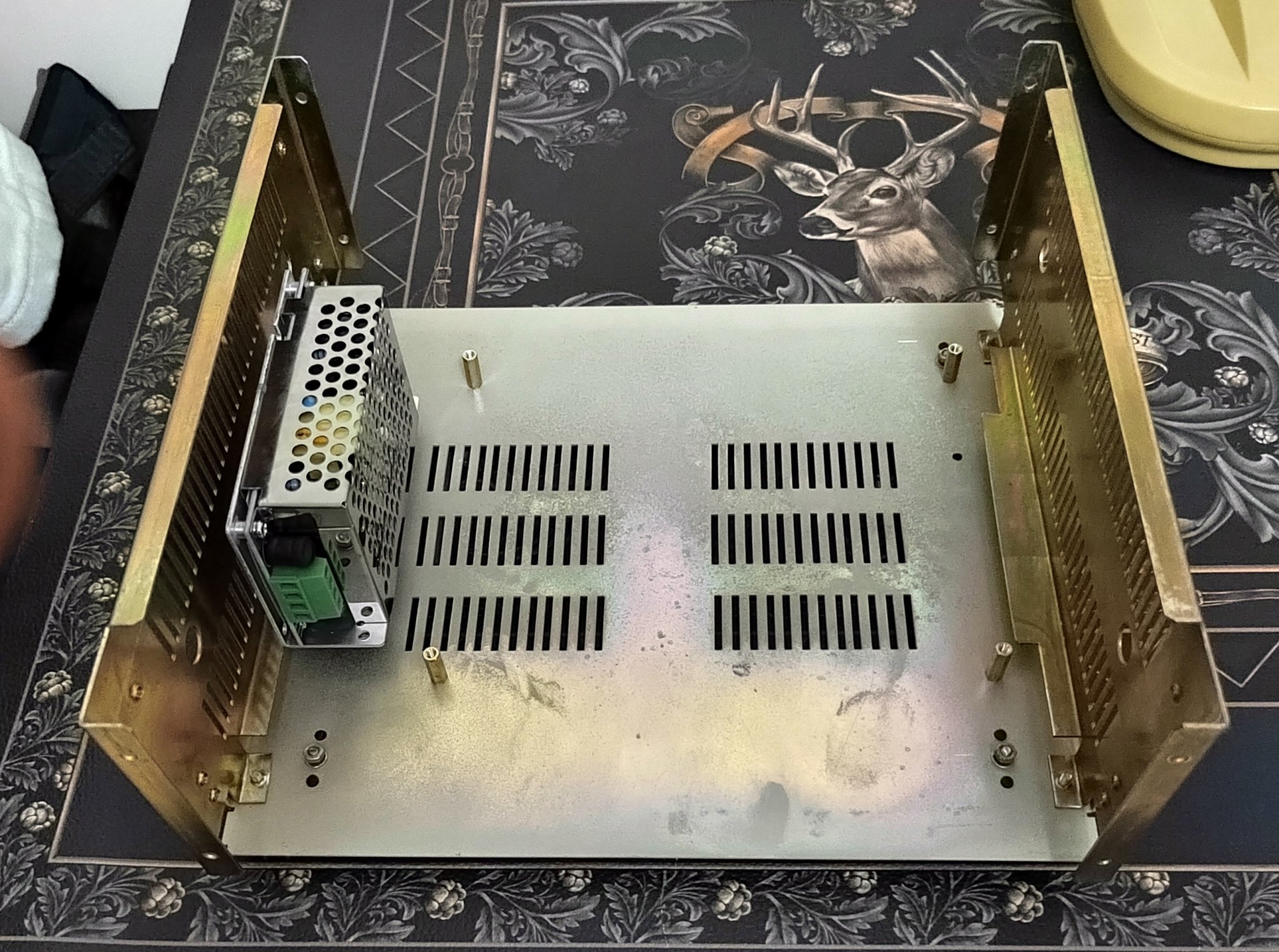

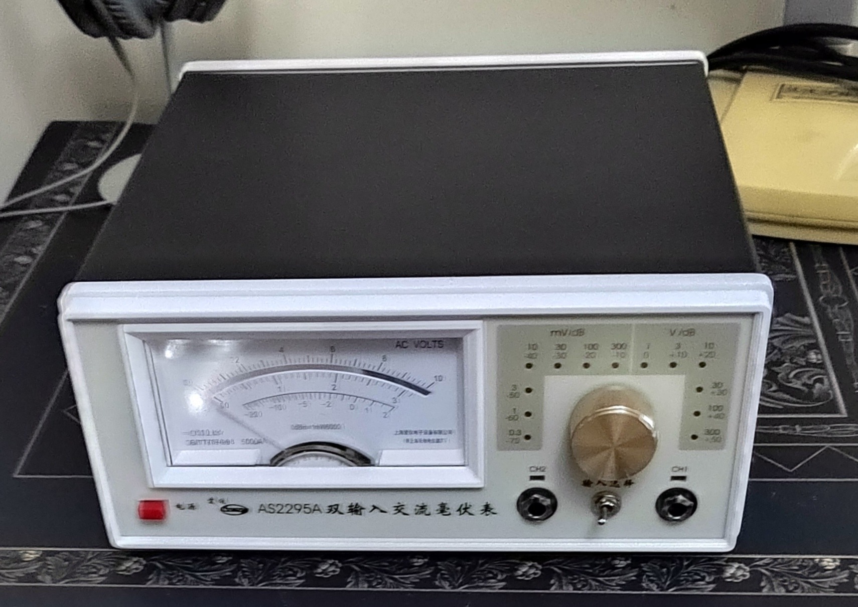

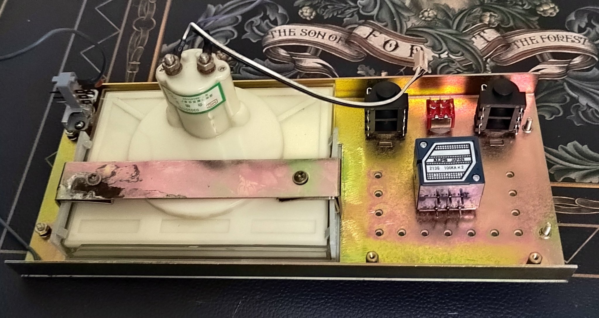

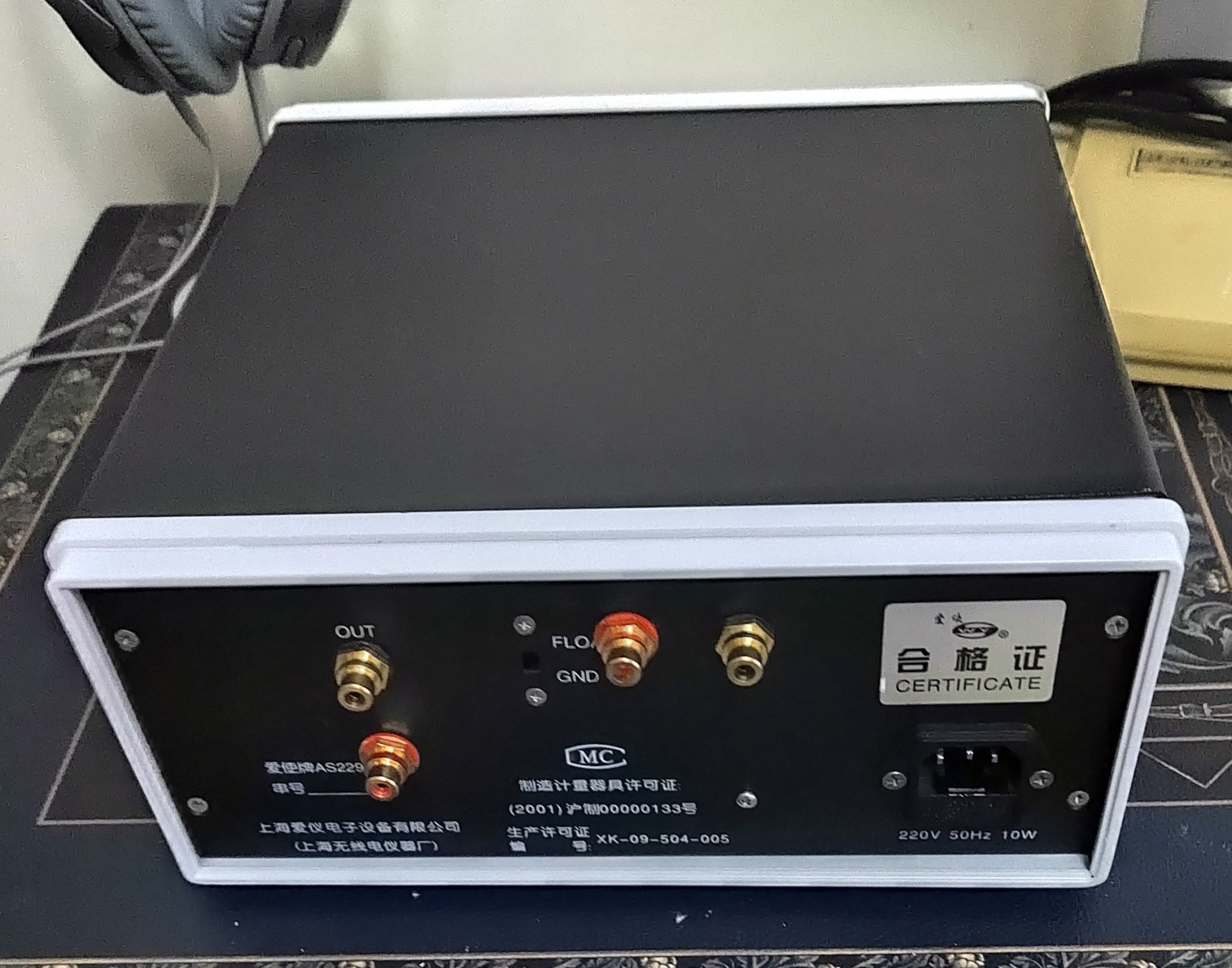

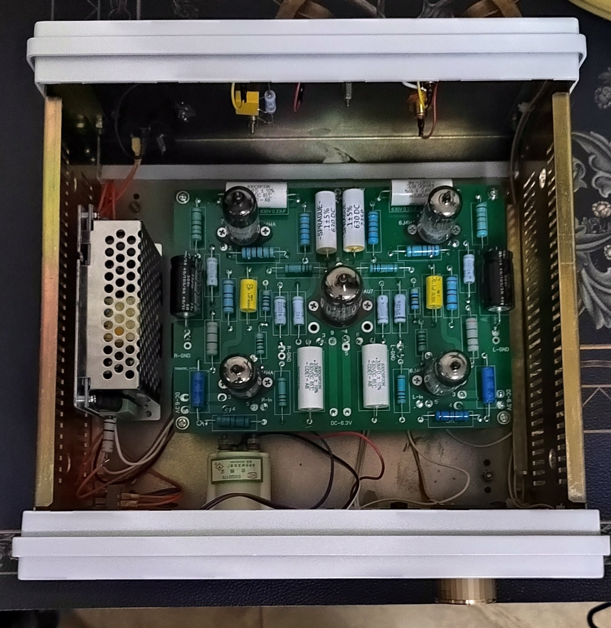

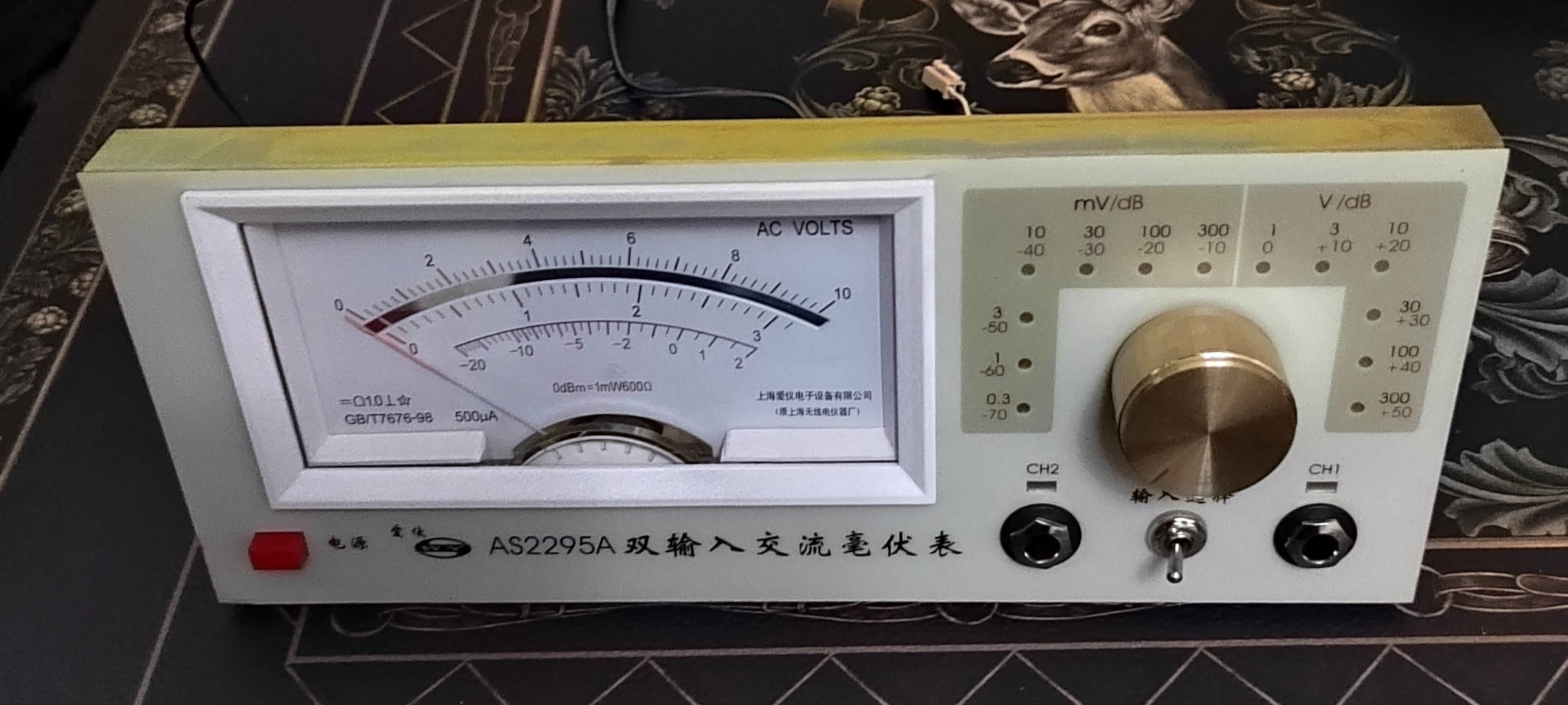

A front stage of an electronic tube was made using a millivolt meter case.
The schematic is very simple, even my mother can visualize it(by the way, my mother is an retired Tektronix designing engineer):
LTP input with 6n1p and 3mA CSS, DC coupled to differential driver with ecc82, auto-biased PP el12n.
Frequency response: 7Hz-200kHz 1w/8ohm
THD: 0.01% 1w/8ohm

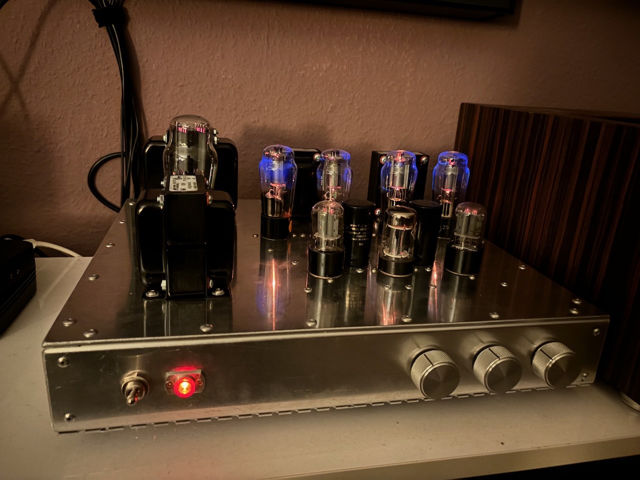

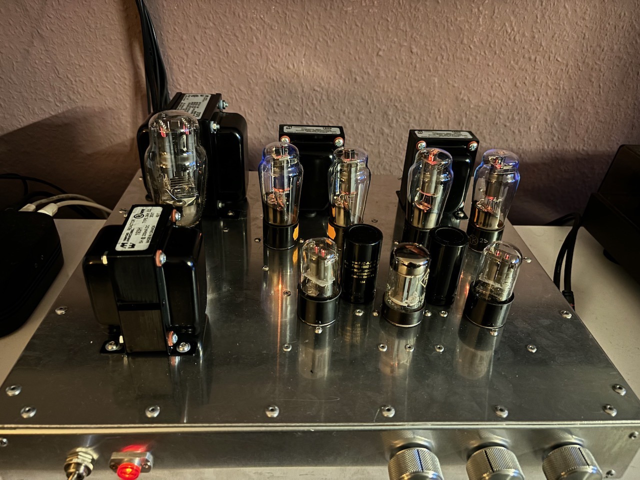

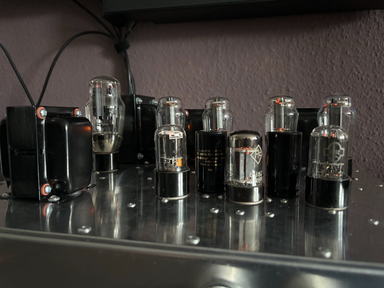

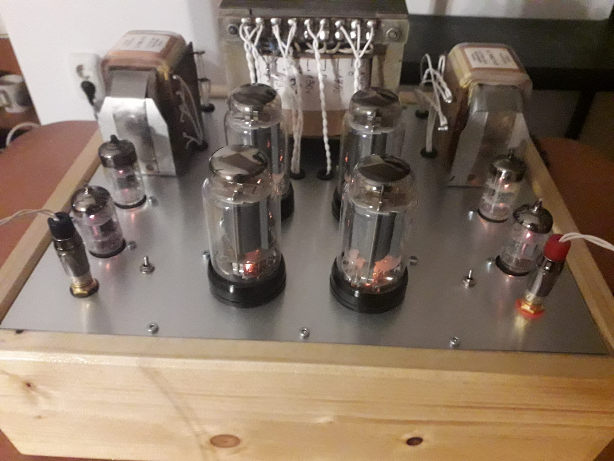

Just an interim amplifier (had to dismantle my EL34-amp for rework). 5U4GB, 6F6, 6SL7, 6SN7 (all tubes old russian equivalents)

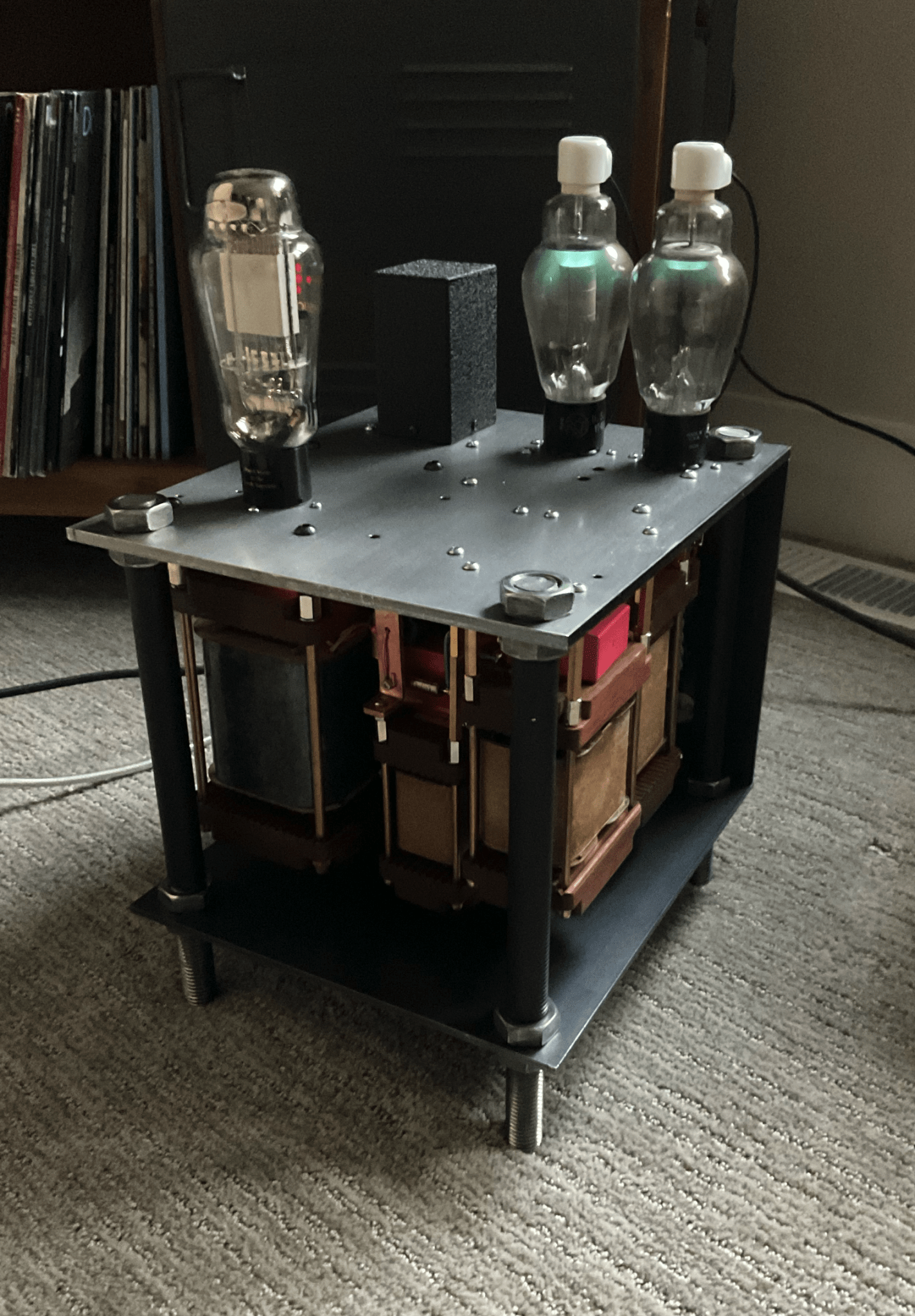

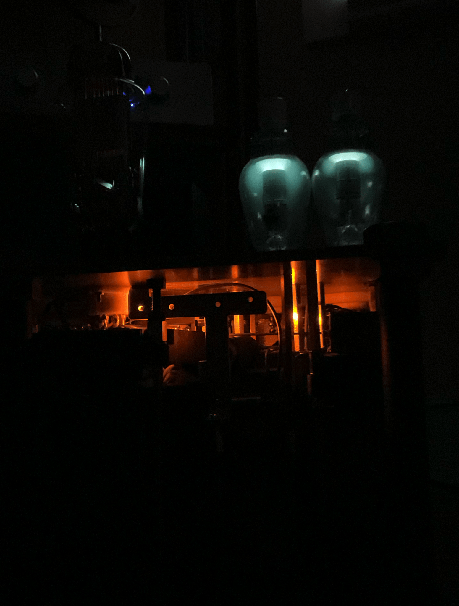

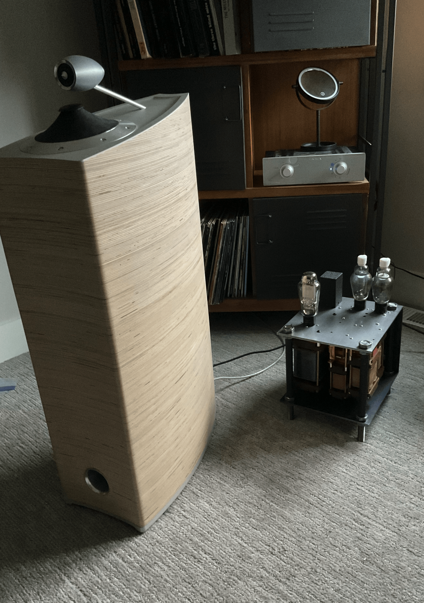

Hi Everyone, hope all is well. Here is my latest pair of monoblocks. An EML 30A spud. The beautiful 866A rectifiers are glowing blue which nicely contrasts with the LED bias that glows orange/yellow under the hood. They weigh about 80 lbs. each. And, most importantly, use Muse Coils Minotaur iron.
SVStube, nice work there, especially impressed with the chassis, how did you print the lettering?
Banpuku, nice design, if a bit deadly, but forgive my ignorance where are the monoblocks? All I can see is a power supply and a speaker?

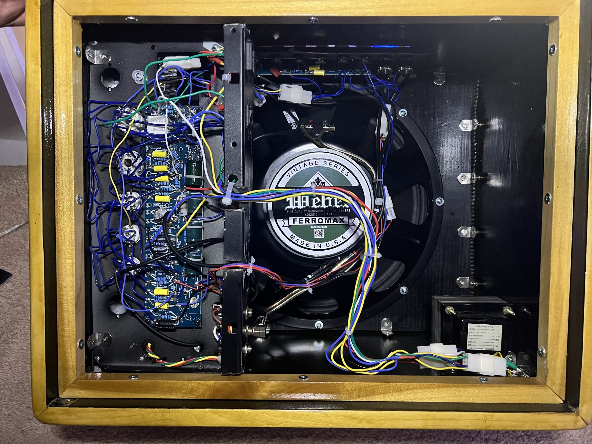

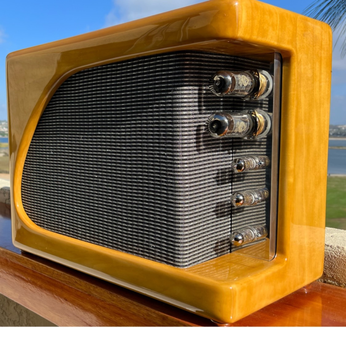

Waiting on parts, welcome to the forum, nice cabinet work, is it a guitar amp or mono hifi amp?
