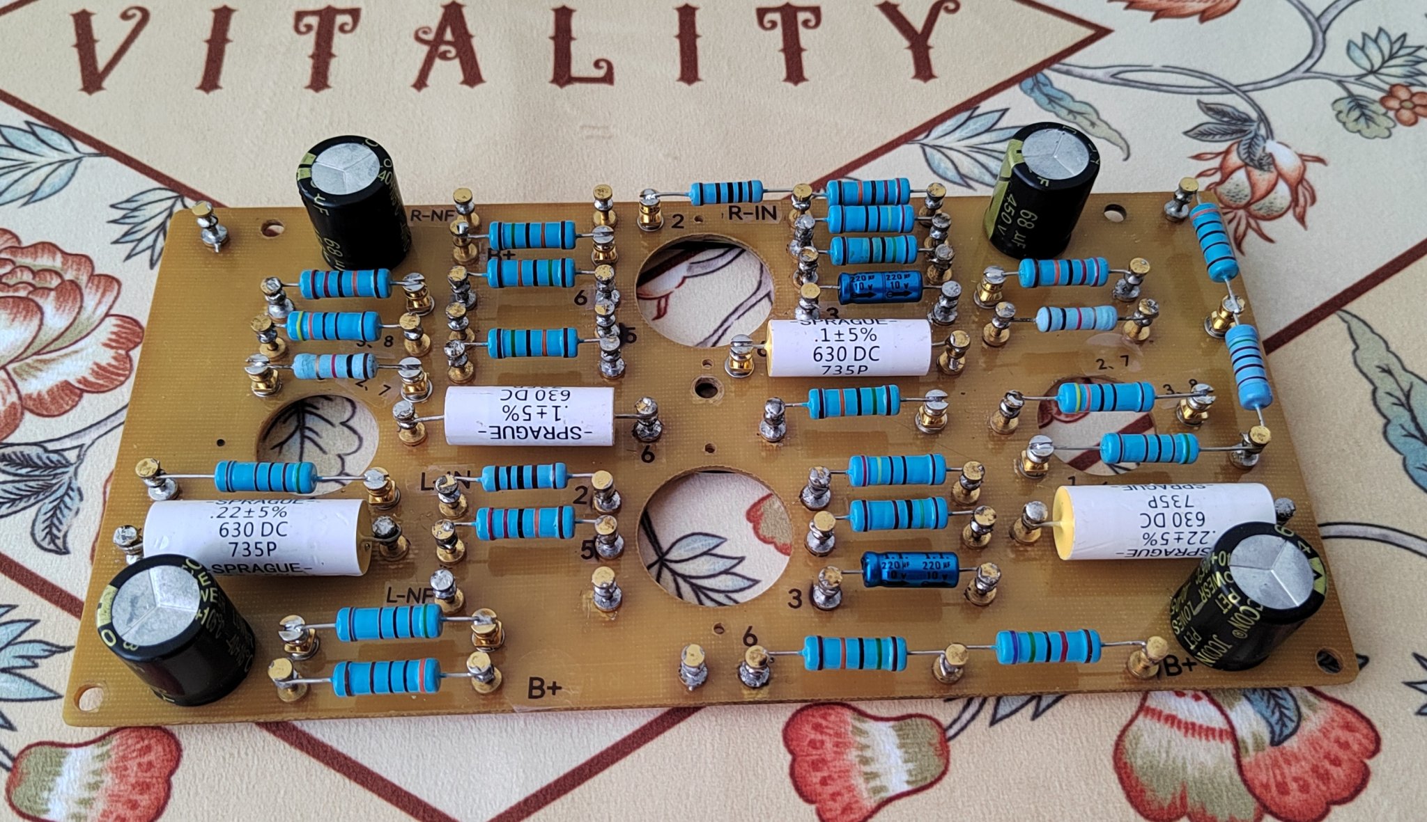

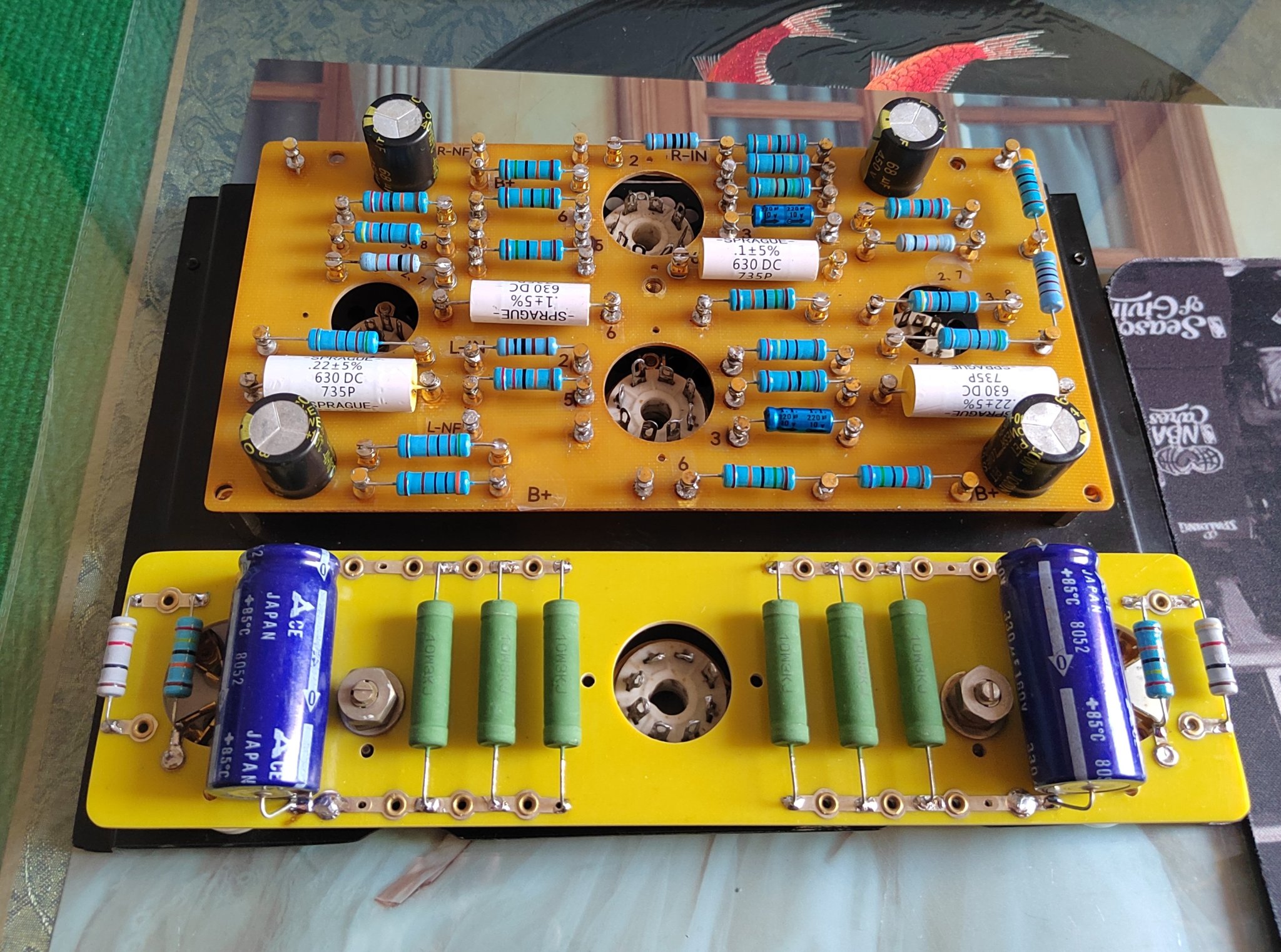

Hi @Shef , you are using tube sockets which allow screwing wires to the pins. Can you point to where you got them?<Posted a great breadboard picture>
Search for "octal relay socket"
Thanks @quadtech , using that search term I even find them at Mouser 👍Search for "octal relay socket"
I am not able to find a similar thing for Noval tubes, though. Don't they exist?

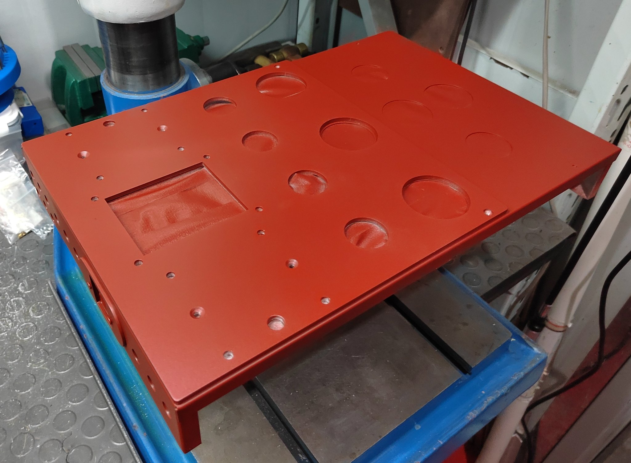

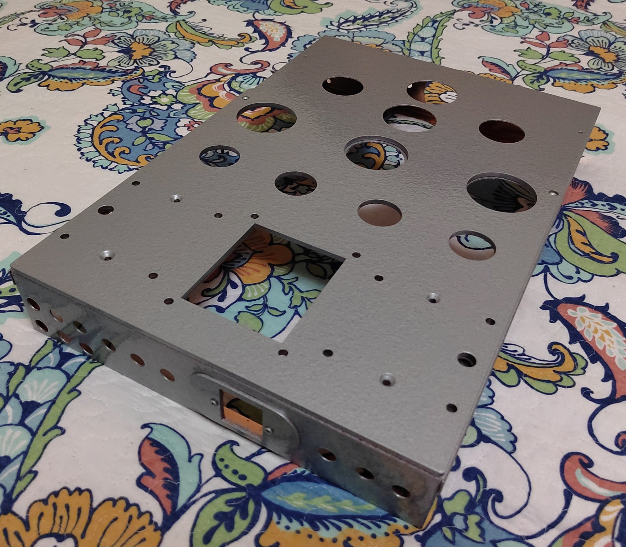

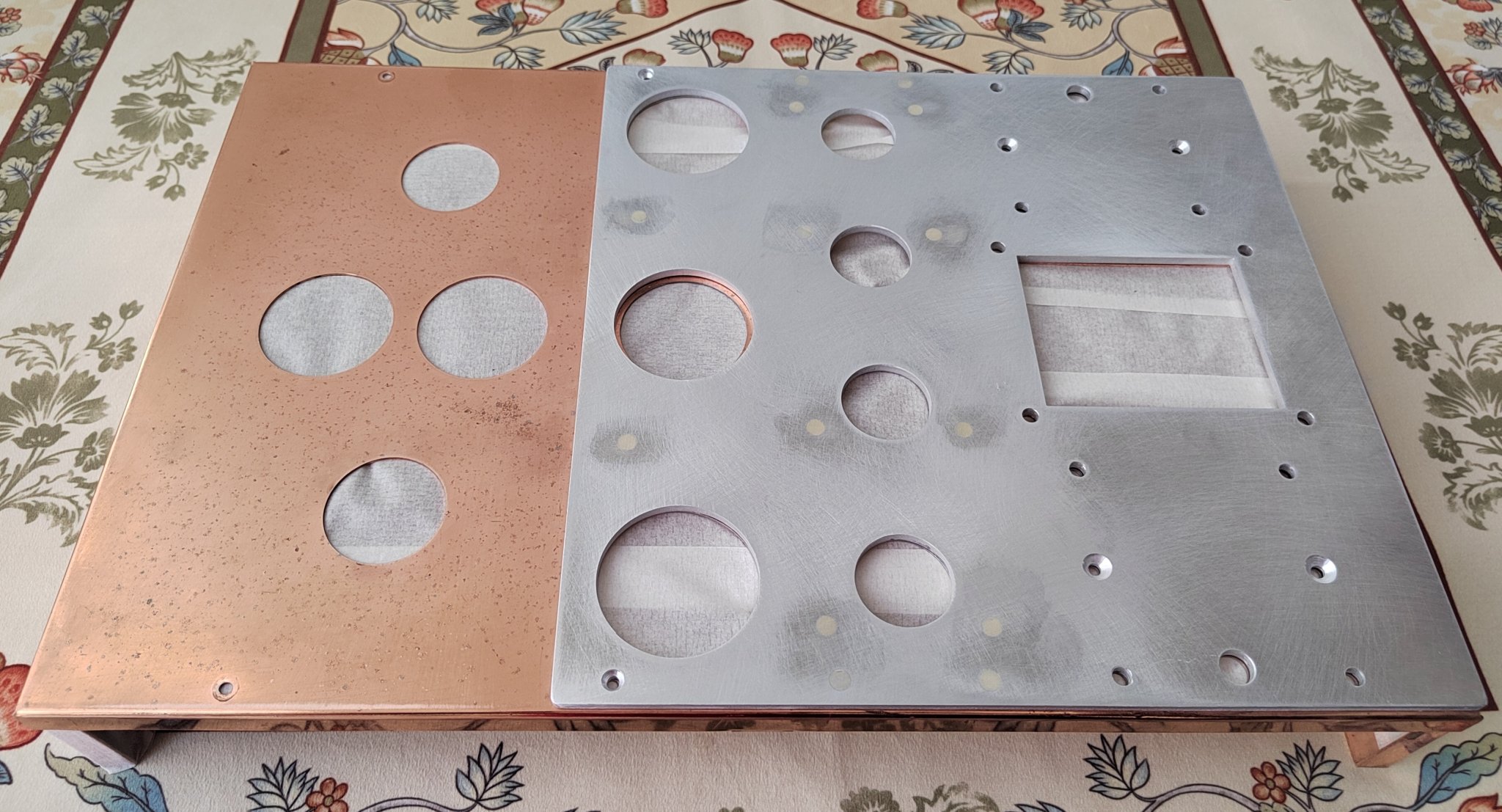

Nice! What did you fill the aluminium plate with?
I made a few mistakes on my last build and was thinking of gluing some screw heads into the holes before powder-coating but filling and sanding would be much better.
