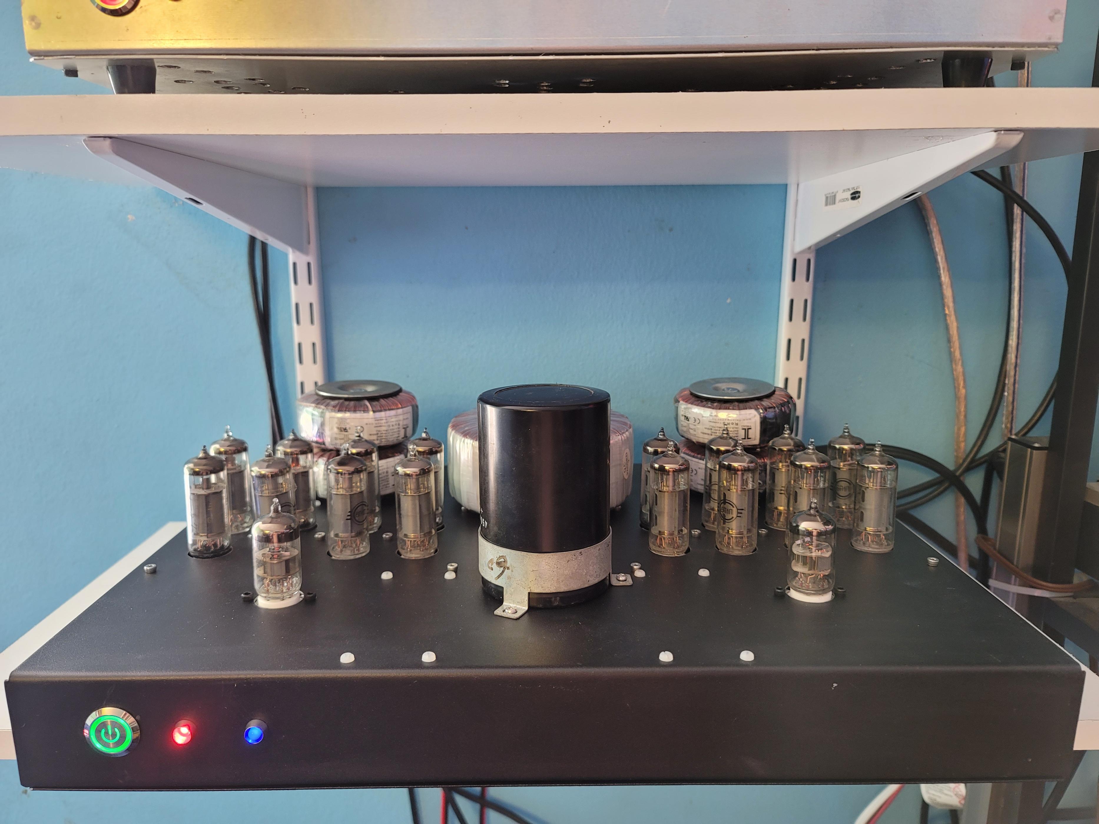

Stupendous!
What design is it? Are those 6CL6 output tubes?
It's The Stupendous 6P1P 4PP amplifier!
It uses 8 6P1P triode strapped per channel and makes 8W of class A power.

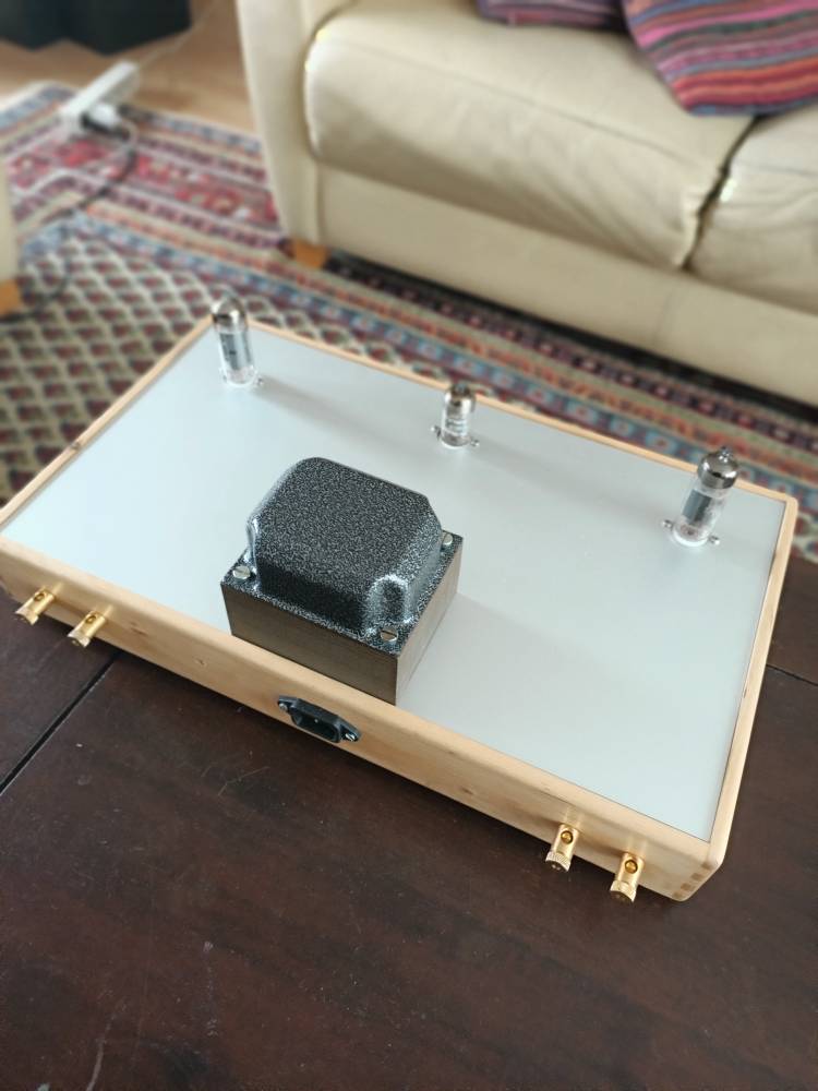

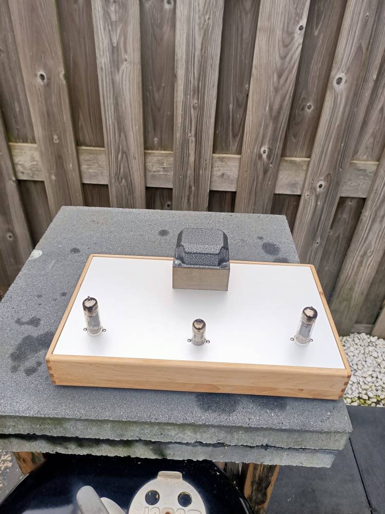

Got them from Triode Electronics TO-9105-1. Very small. But capable. That's the reason I built a RH84. It has some tricks to make a small output transformer sound bigger.Which UGTs are so small that they fit inside?
There is going to be a raspberry pi based volumio with hifiberry dac inside...So an all in one streamer and amp.Damn Bas that was slick but were have you hide the input?
Nice, yes there are lots of new options to connect things and less with cable everywhere.

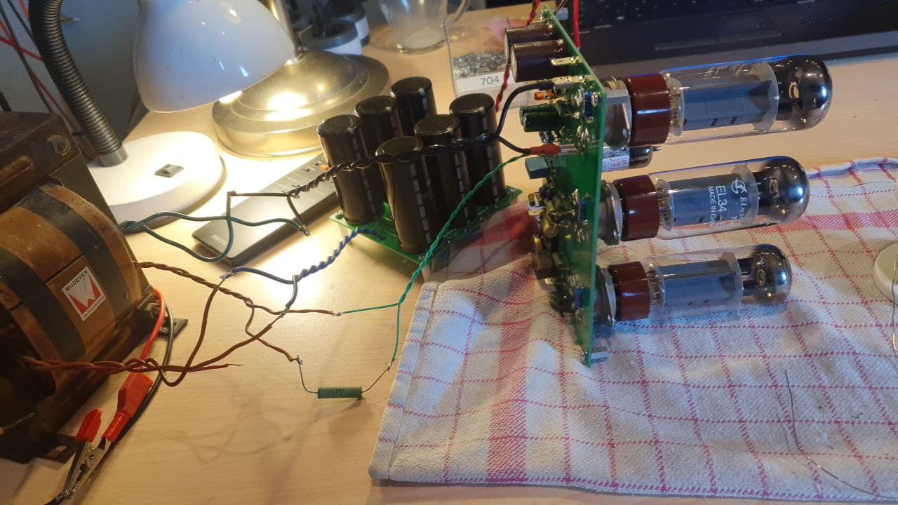

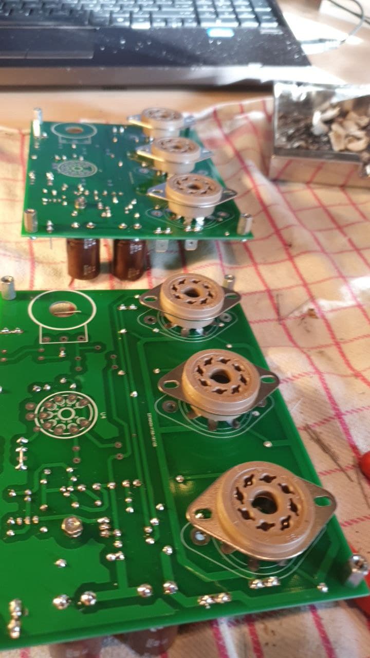

Specs?A friend of mine finally found the time to build some of the boards i drew back in ''19 for a tube regulated power supply with 3X EL34 or KT88.
About 300mA continuous max, tubes need 150V headroom or so to provide that.
Output adjustable between 150-400V
Maximum dissipation in the trioded EL34 is a hair over 80W for the three.
Ripple is under 500uV.
More pictures, tube regs are fun
Heres another picture, friend got it to work.
Works well, without any filtering in the supply output noise is measured at around 2mV RMS into a 150mA constant load. With about 5VRMS ripple in.
Could have been better, i designed in a Zener reference that is noisier than a VR tube such as the 85A2
