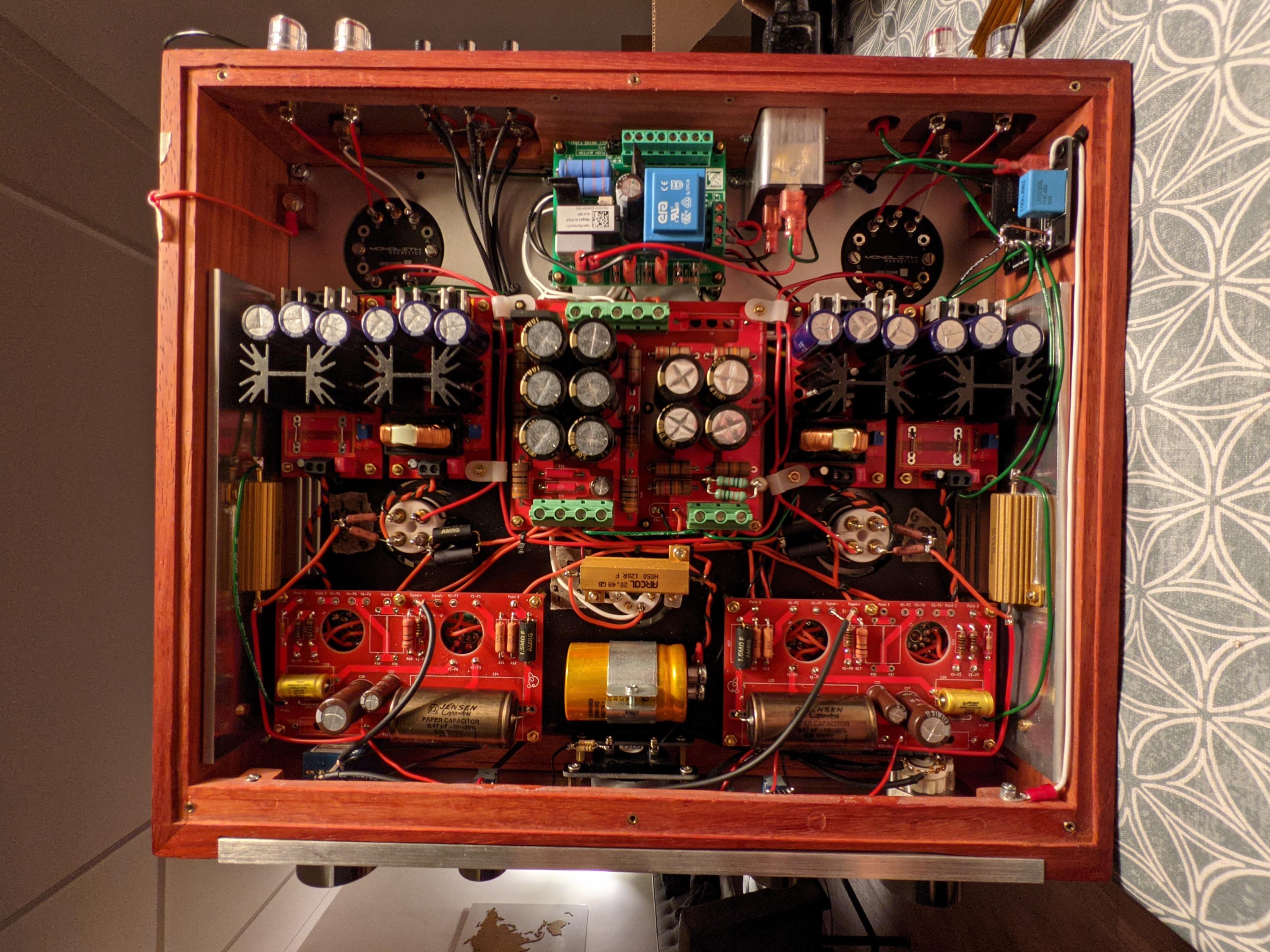

I finally finished my amp. Based on the Glasshouse 300BSE ....

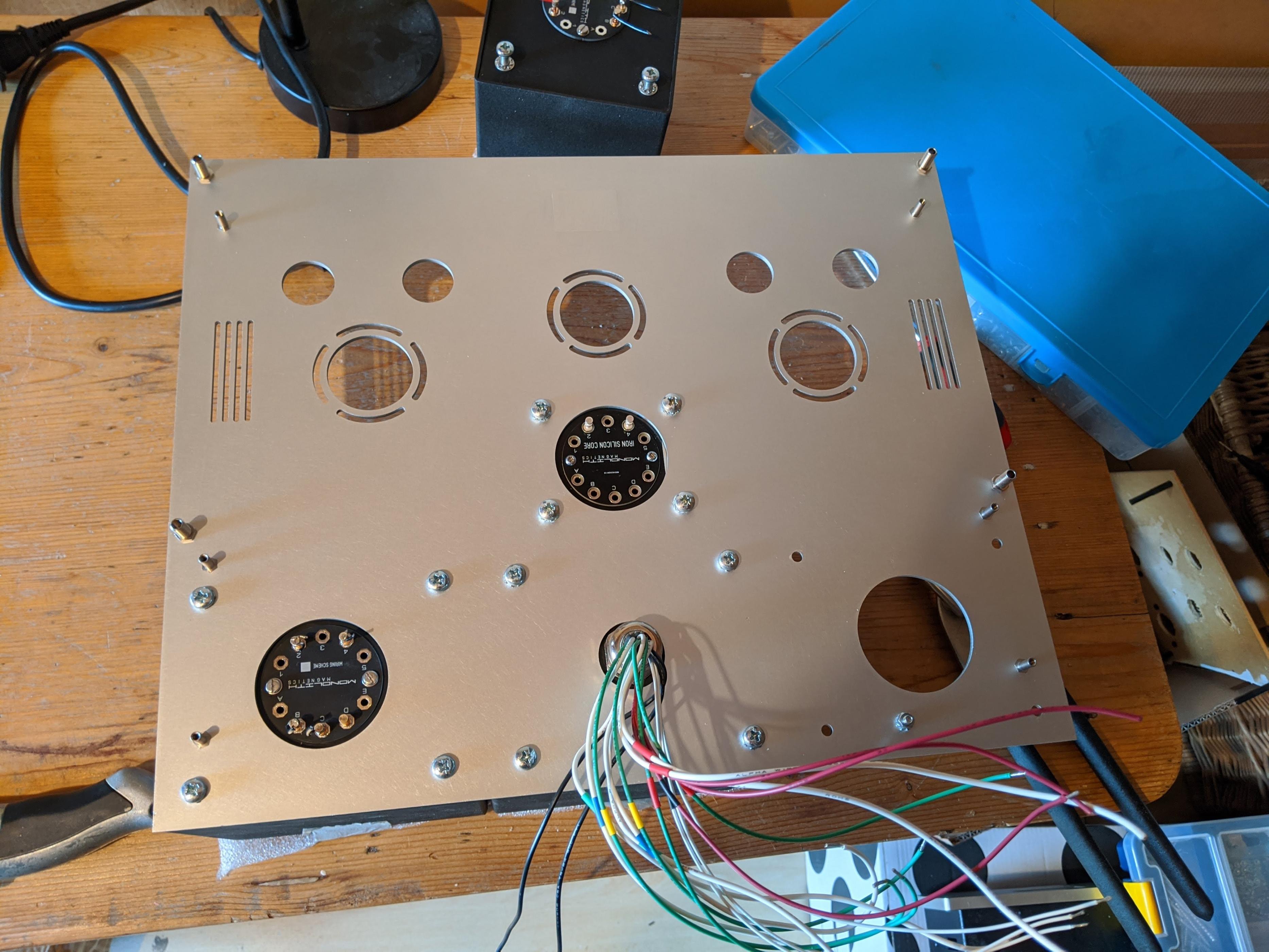

Stunning build!
I keep zooming in on the photos to try to work out how you managed not to have any screws showing on the top. Is the top plate a sandwich with the screws countersunk under the beautifully elegant top plate?

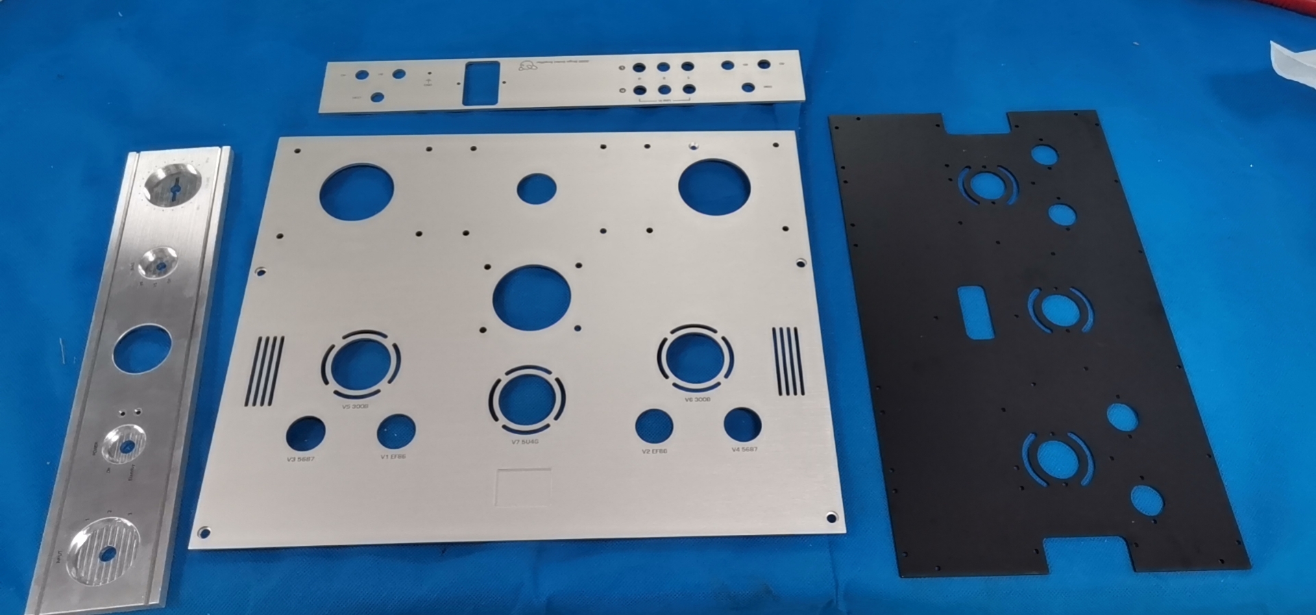

I'll have to investigate your laser cutter. I'm now persona non grata with the local one I've been using after they messed up the last job on expensive imported panels. I insisted on a refund and they won't talk to me any more.
The black plate with all the boards is sandwiched to the bottom of the top plate. Everything is fastened with treaded standoffs that are welded into the bottom of the top plate.

Yes, everything is 3mm aluminium. Front is 10mm.
The whole reason I went with China is cost. Most local companies didn't want to do single pieces or charged a fortune for them.
Frontpanel express does really nice work but they couldn't anodise the panels after milling.
In the end, all panels combined, with shipping, the Chinese were something like 150€ cheaper then Frontpanel express.
It did take more effort explaining everything, checking, rechecking, lots of emails etc.

Jeeezzz, that IS something I have to consider when I want to fabric a front panel. I did make a design for it but I am still reluctant to let them
realizing it into practice my front panel due to their huge costs.
