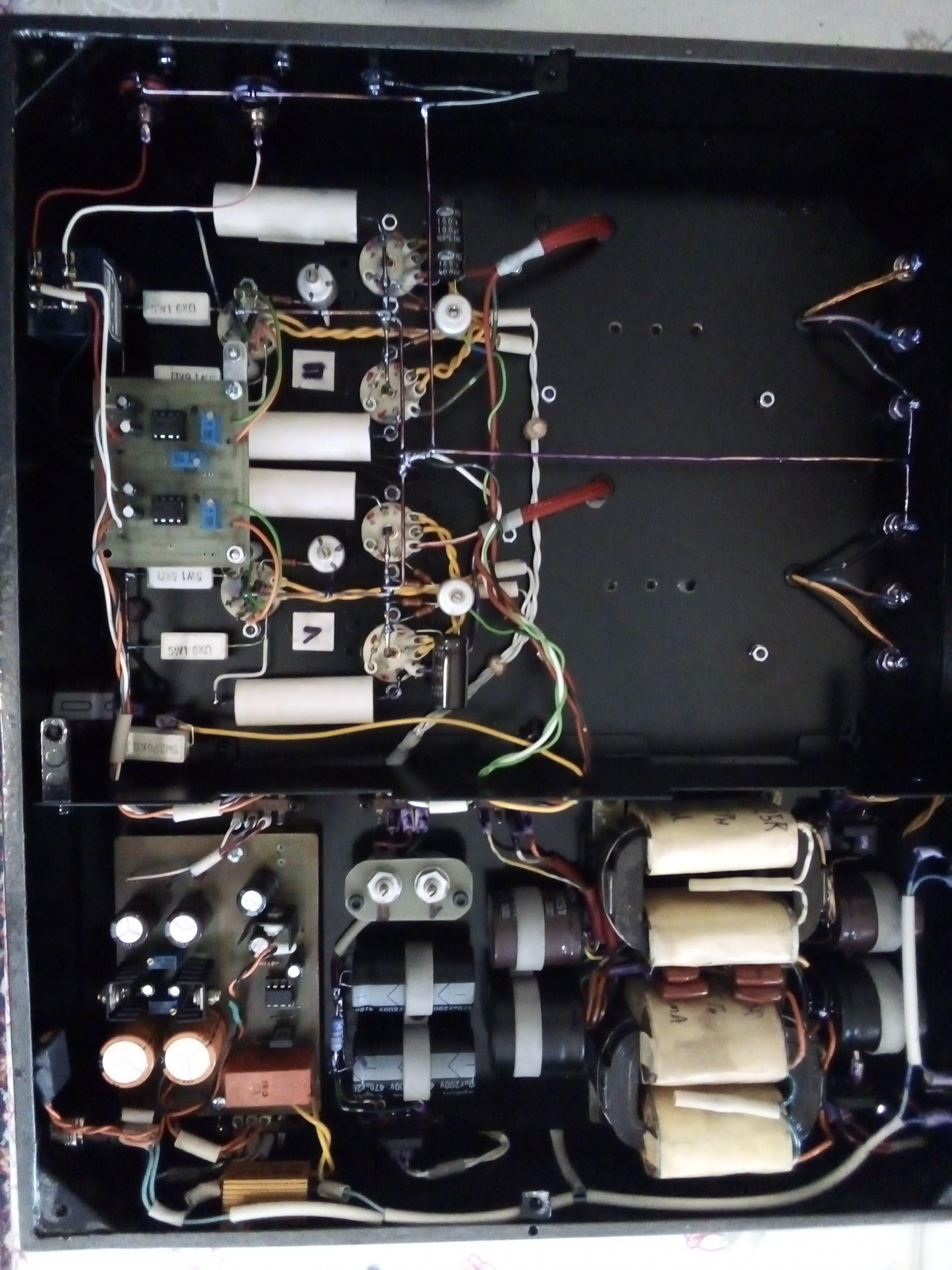

The underside is well organized and so straightforward. Nice.
The case and integrated cage is perfectly executed; it gives me ideas and I might have to borrow your idea and stop forcing myself towards left right symmetry.

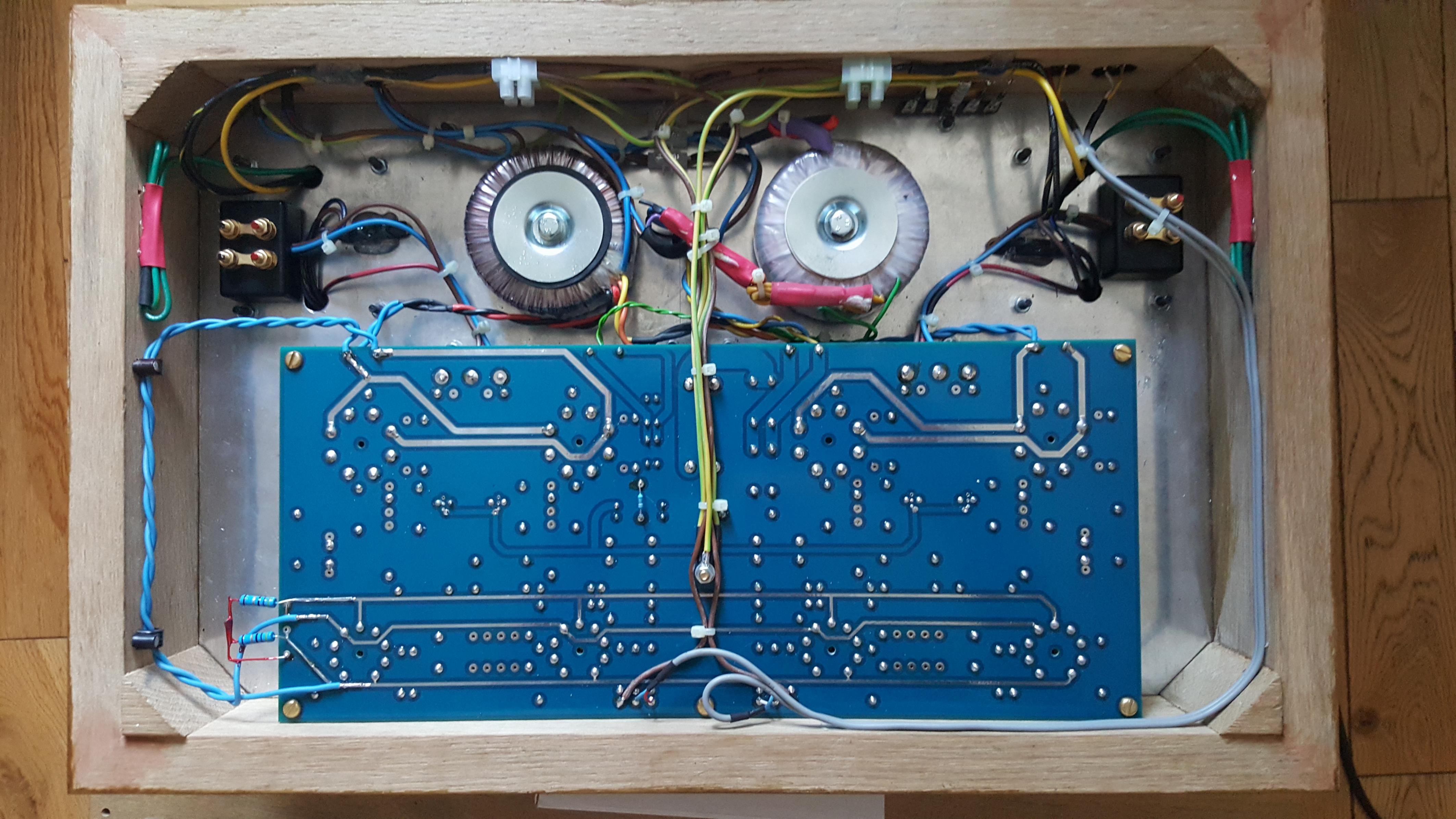

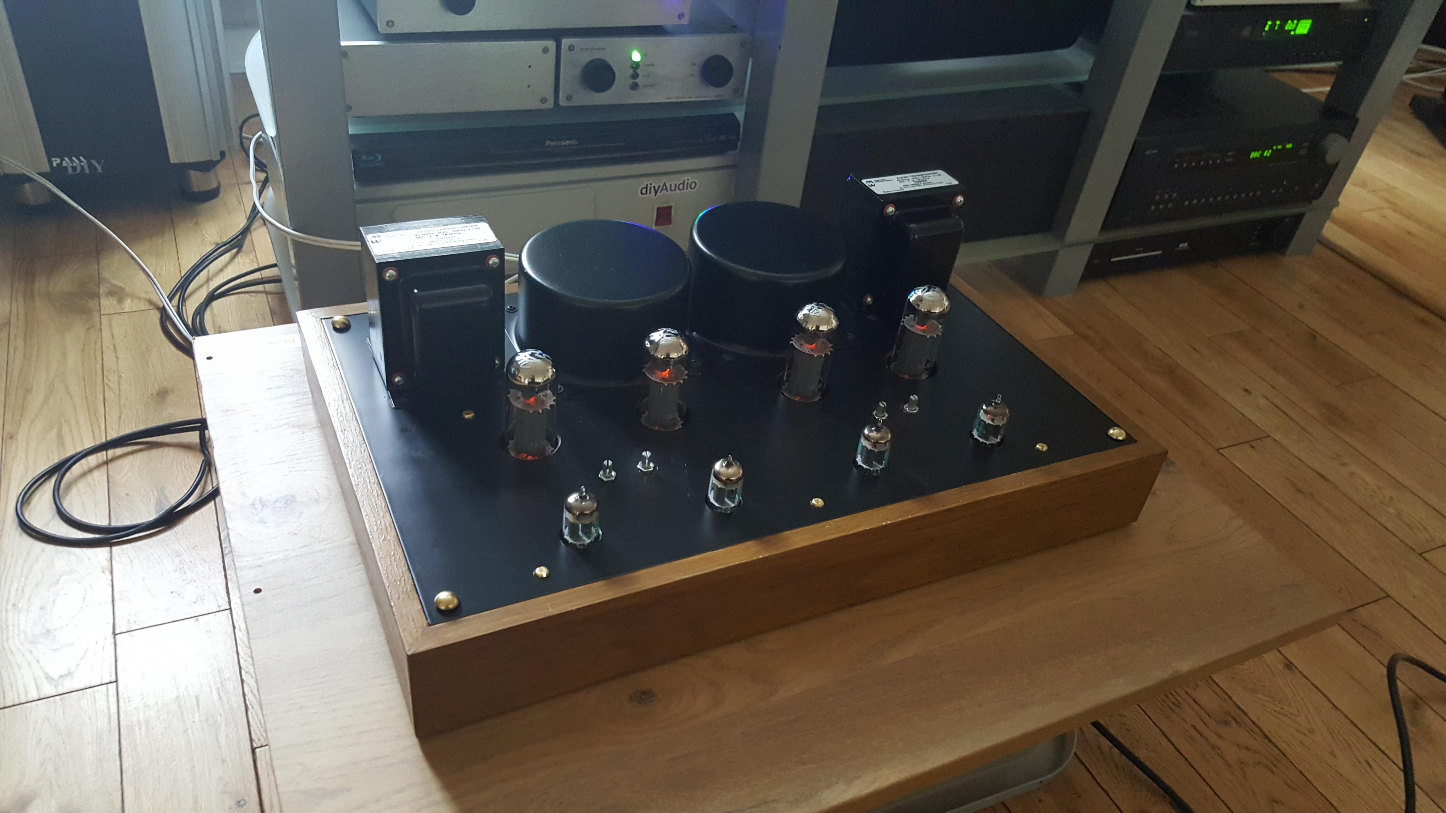

I've just finished my version of the Williamson 5-20. I'm extremely impressed with it.
The build thread is here Building a Williamson EL34 amplifier
It weighs an absolute tonne as it has six heavy transformers and an Oak frame.
Although it outwardly appears like two mono-blocks in one chassis it isn't.
The toroids on the top of the chassis add together to provide the AC for the B+.
The toroids on the bottom of the chassis provide the HEATER and Cathode bias.

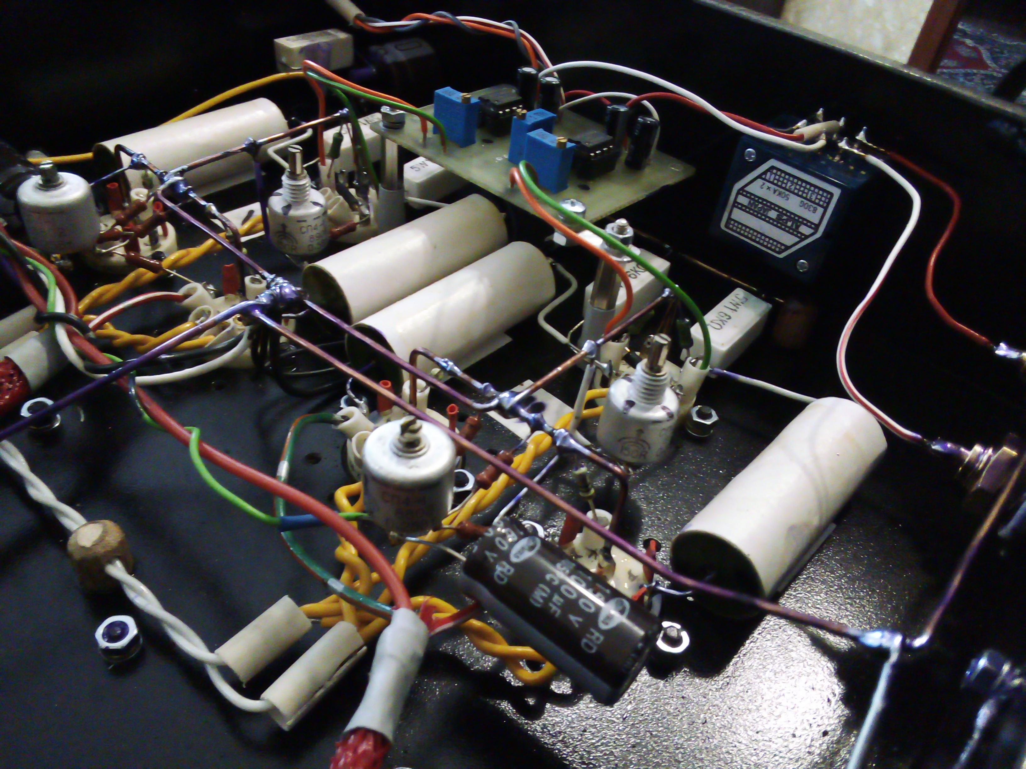

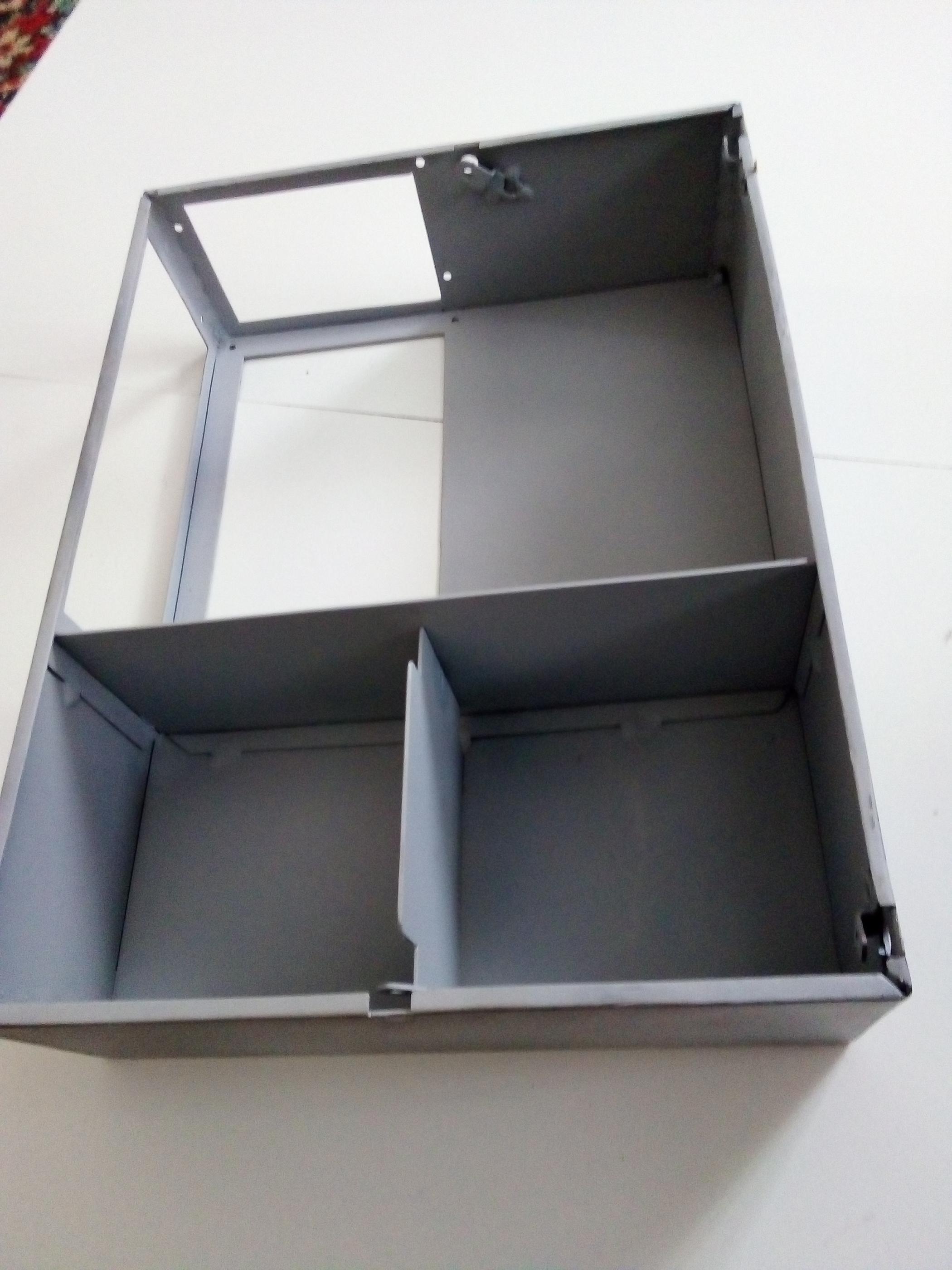

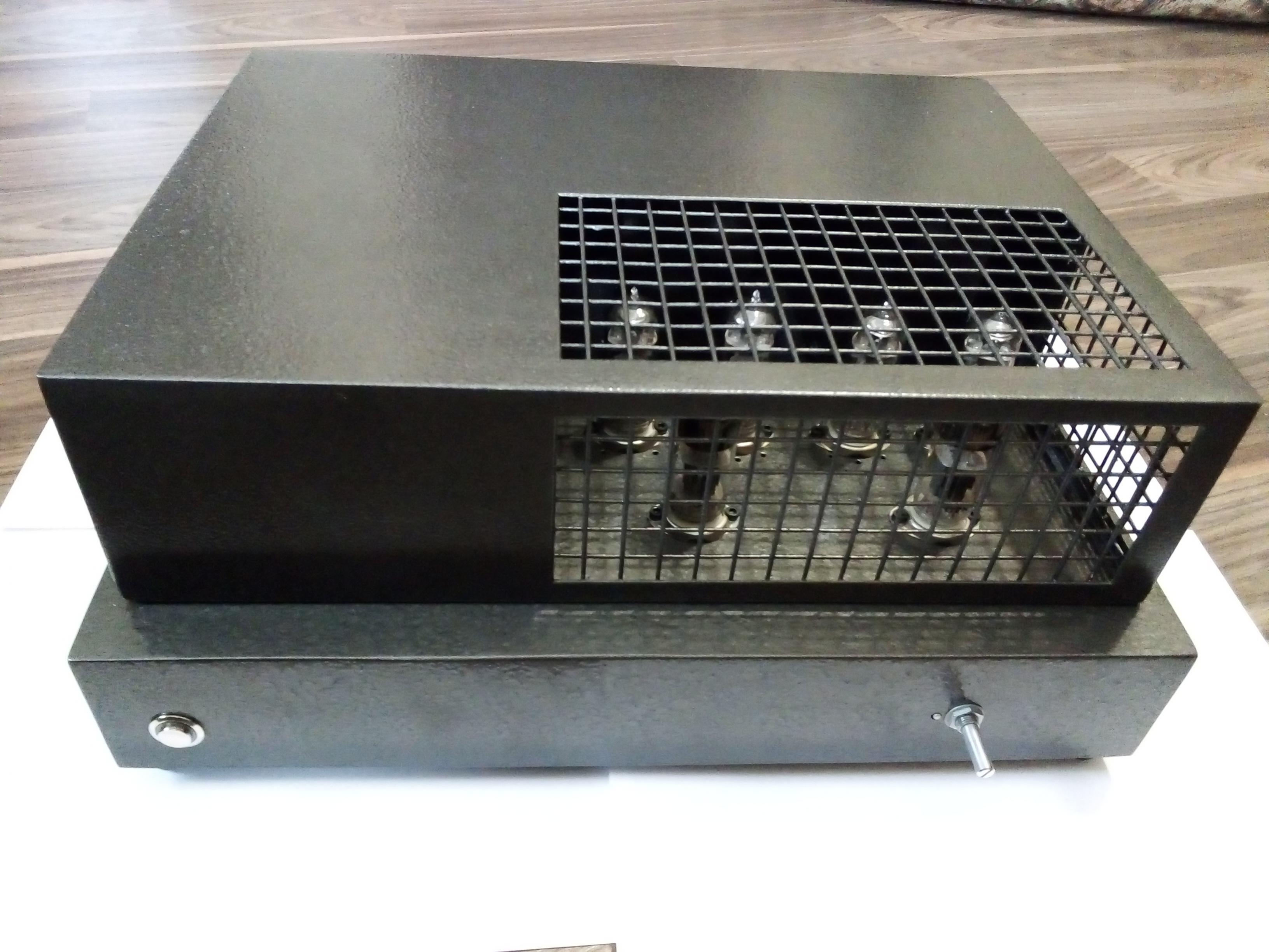

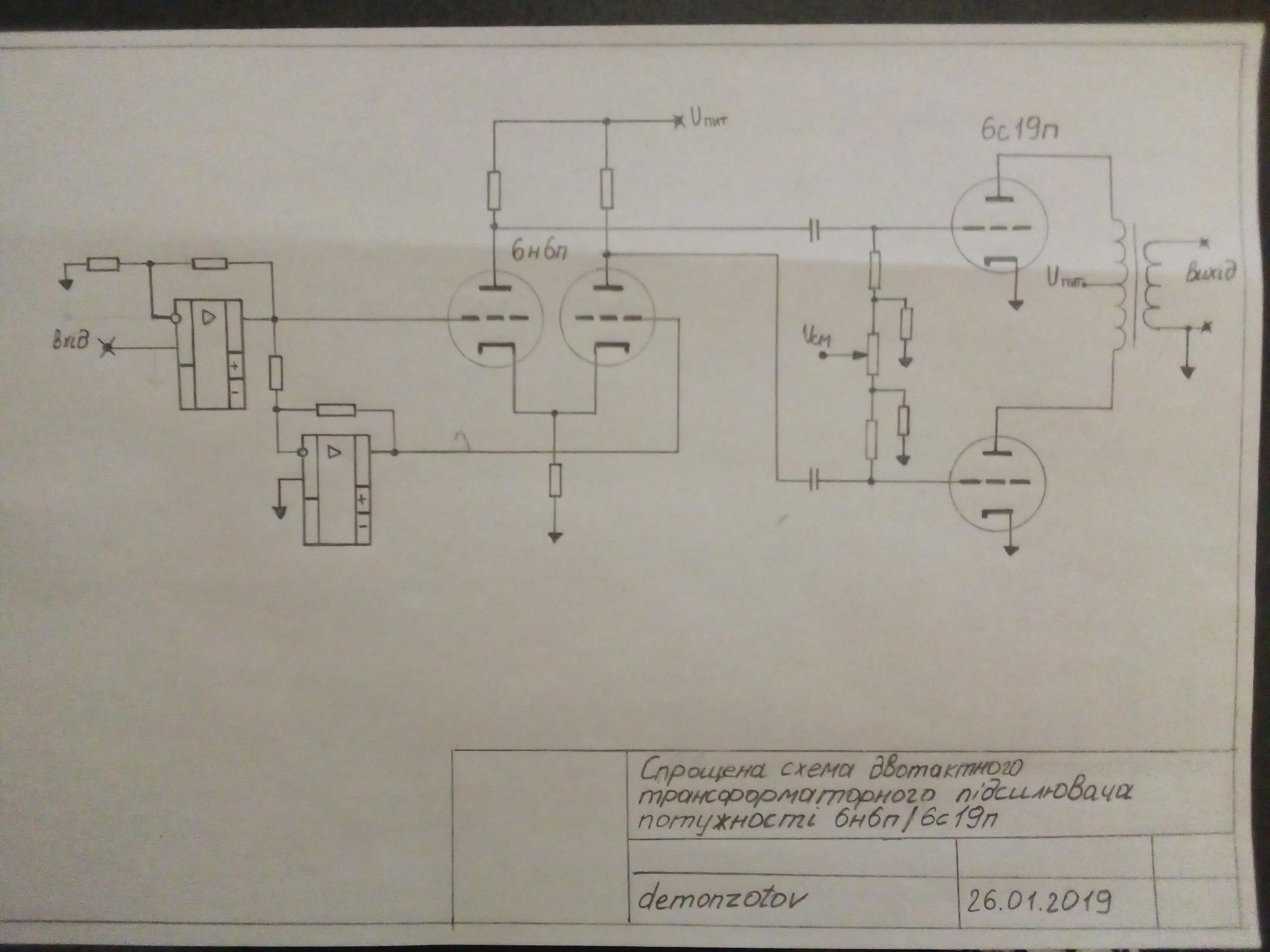

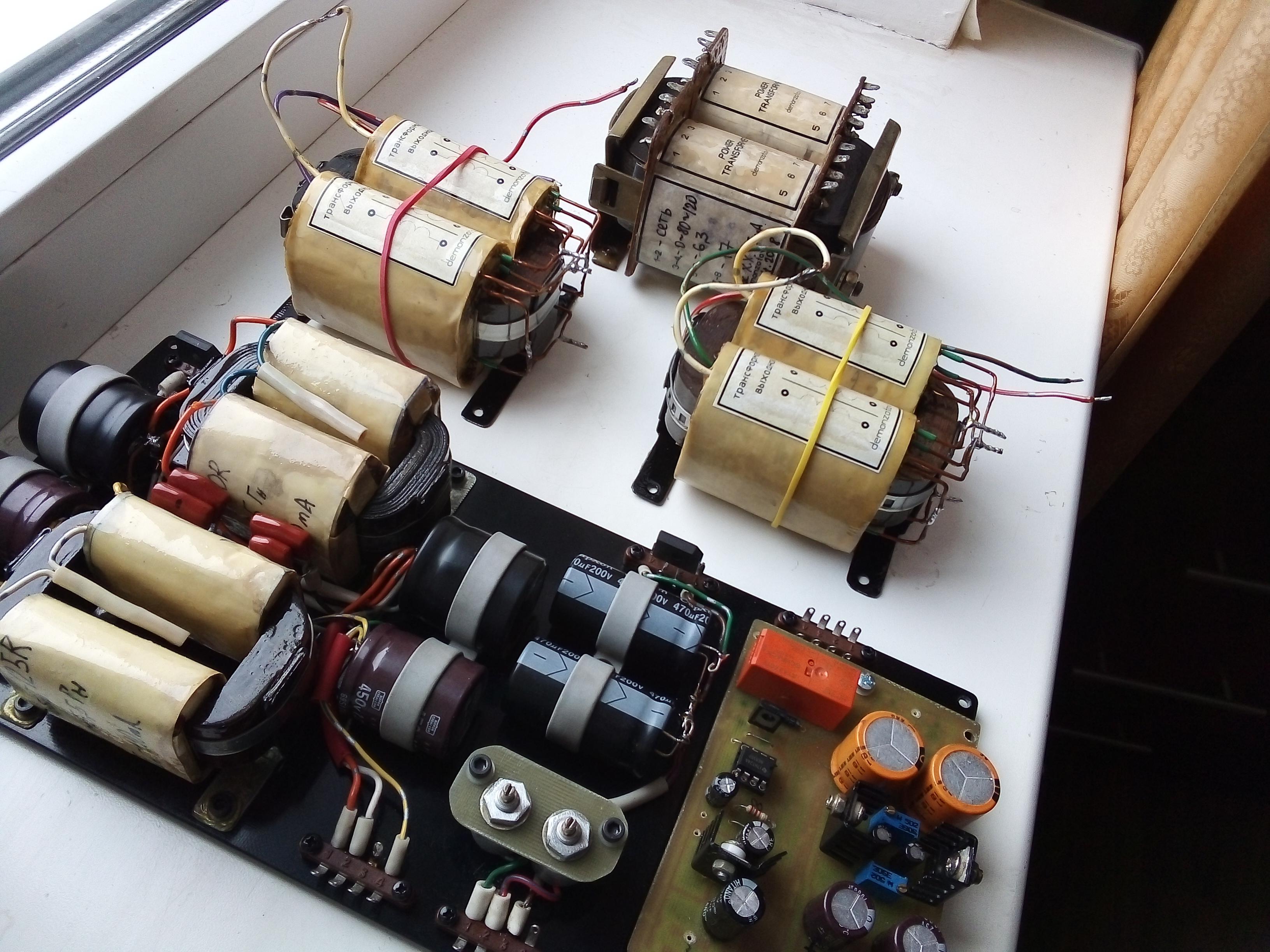

6s19p / 6n6p / lme49720,15 watts amplifier circuit, if anyone is interested
You've posted this in the pages of finished projects

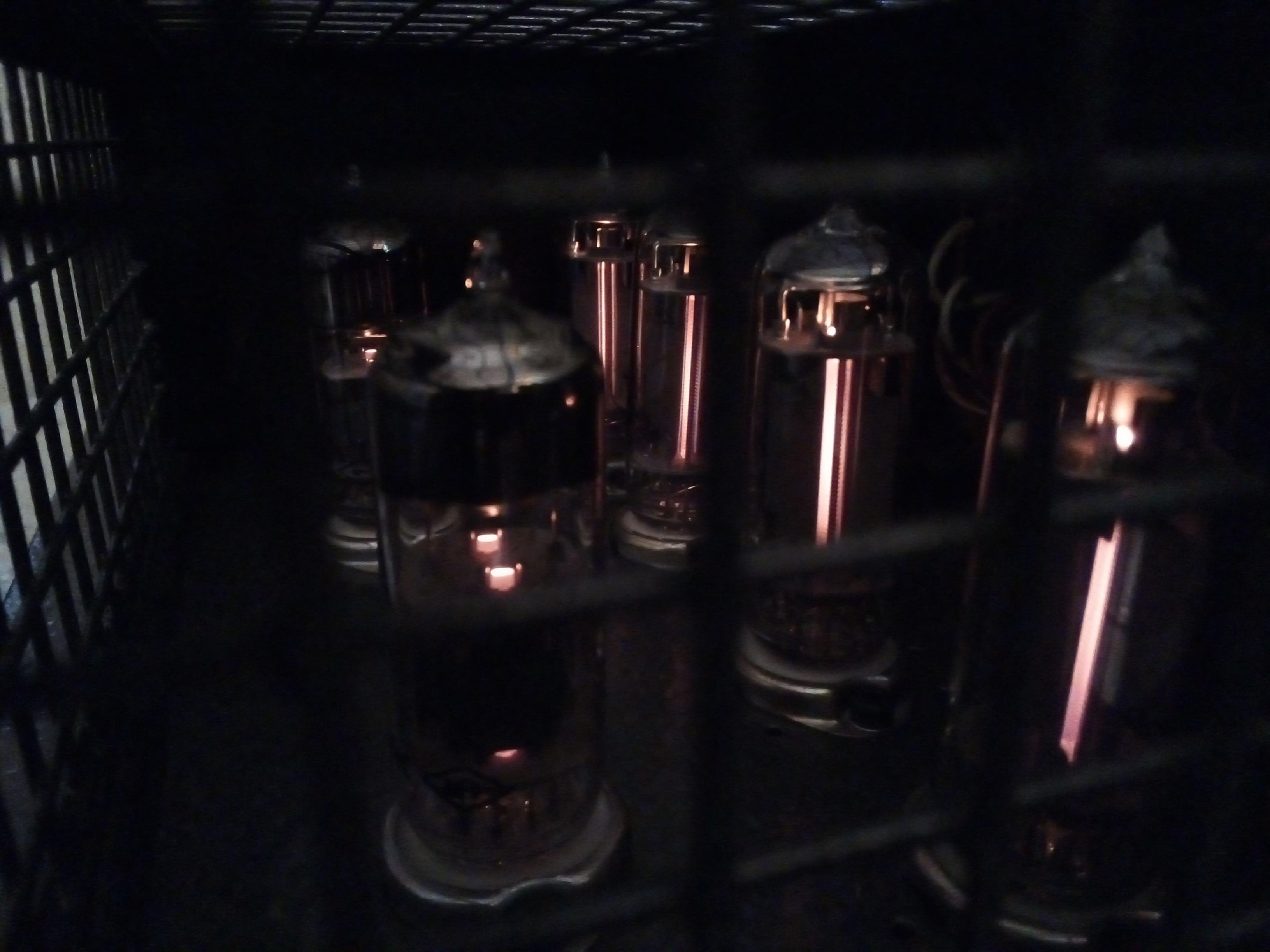

one more photo
one more photo

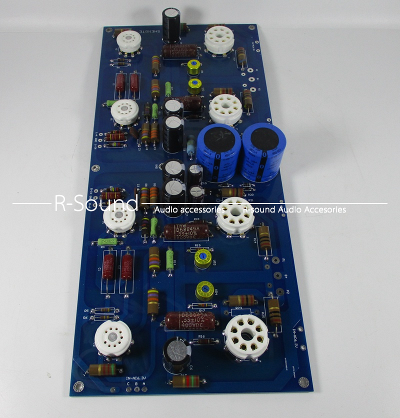

The populated PCB is available from E-Bay which is a real bonus. The bias circuit needs a bit of modification as discussed in the build thread. Other than that it is a really easy and high quality build.
4 x EL34 and 4 x 12AU7.
Hammond 1650H opts.
I put socket savers on the 12AU7s so they poke up a bit higher on the chassis.
Hammond 1650H opts.
perhaps you could publish this schematic with component values added?

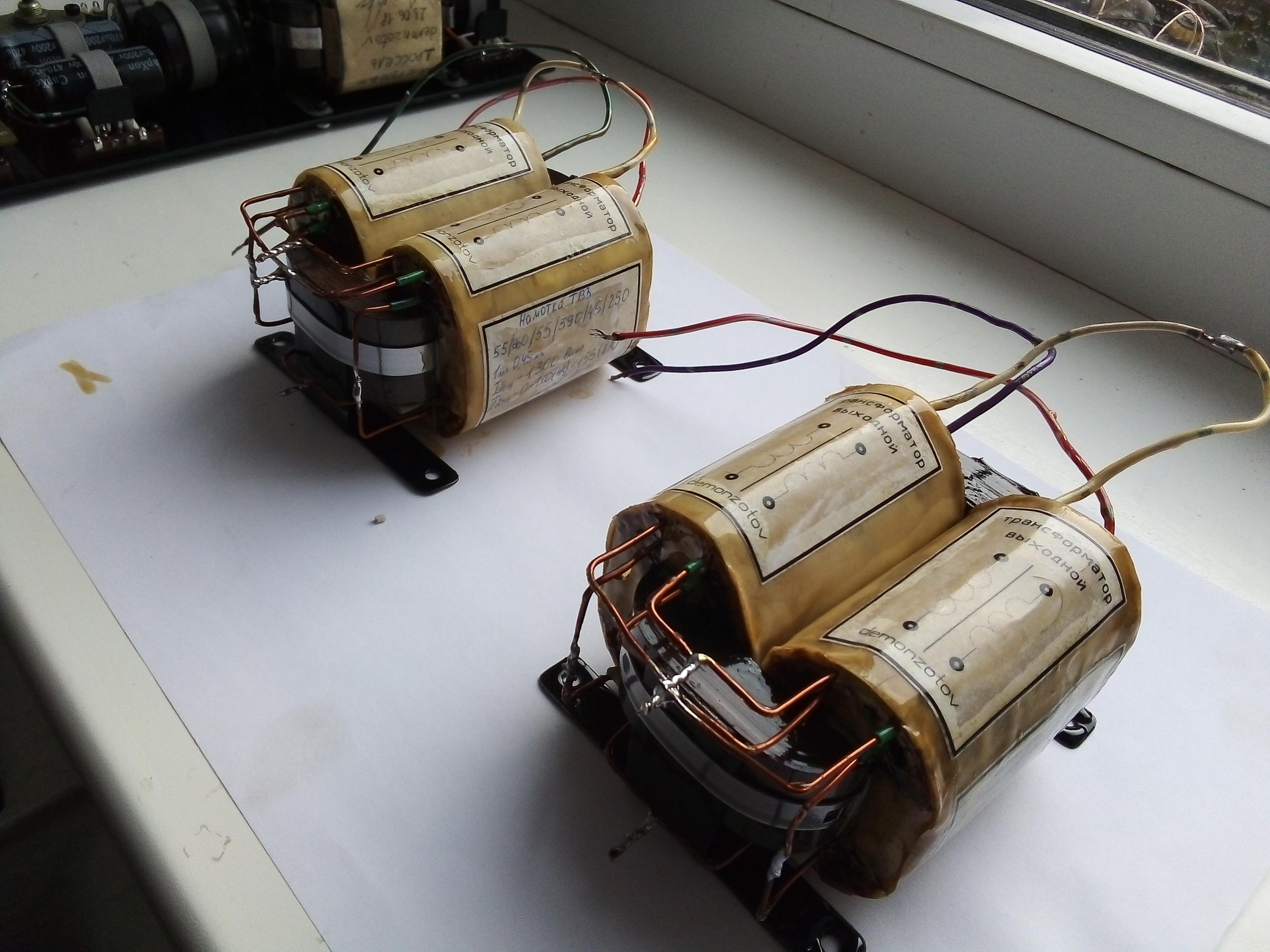

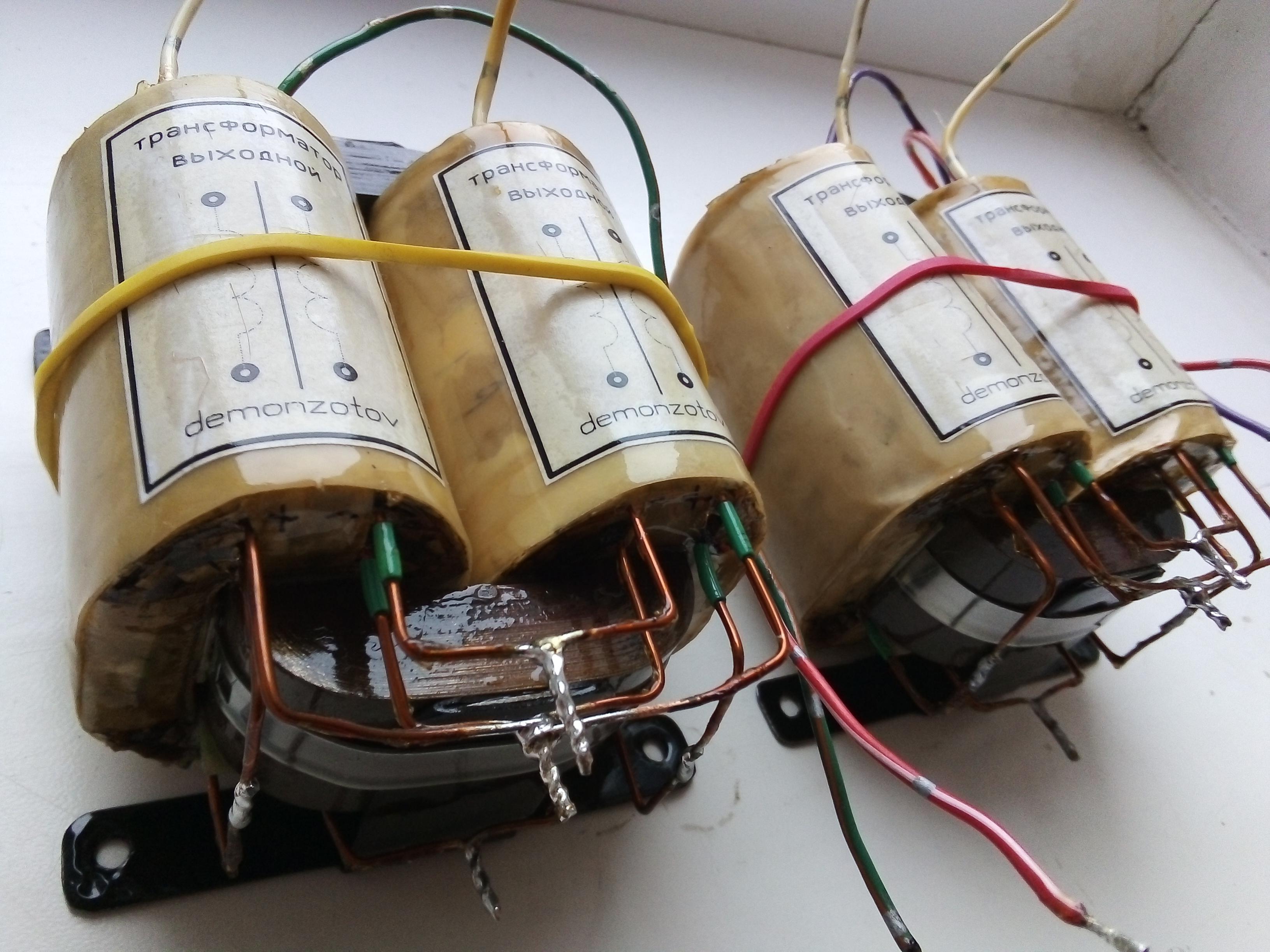

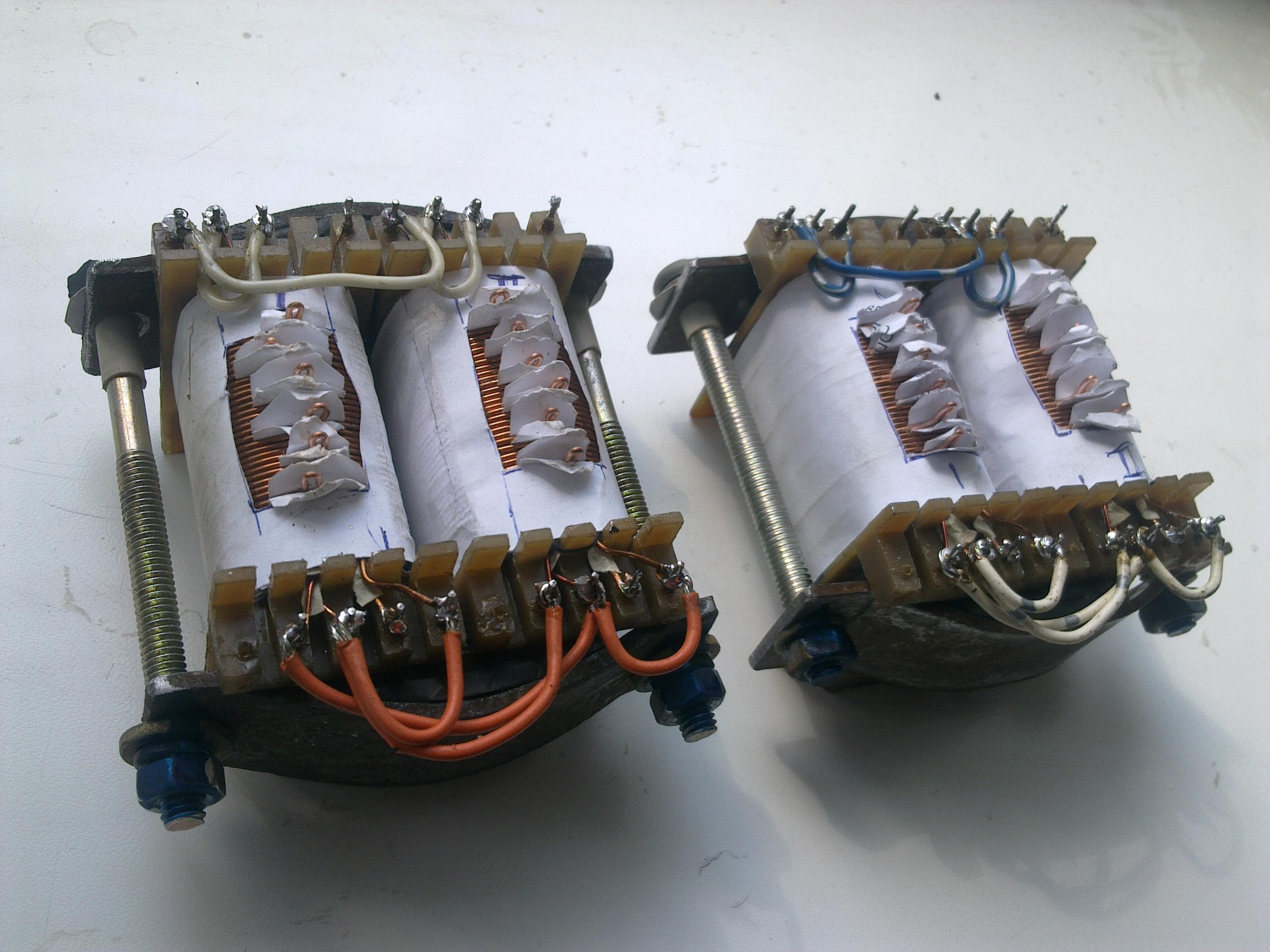

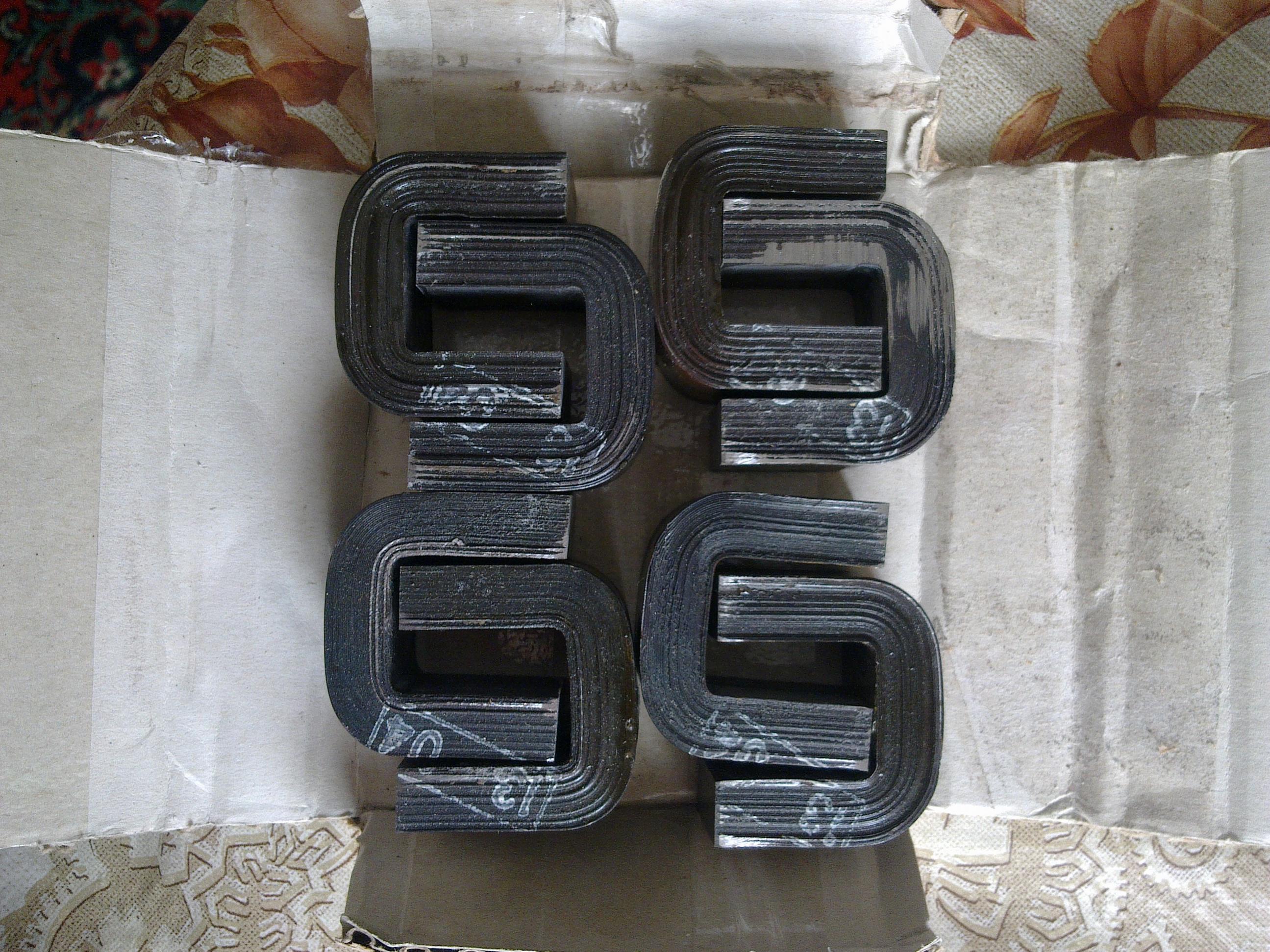

Did you make those transformers yourself or...?

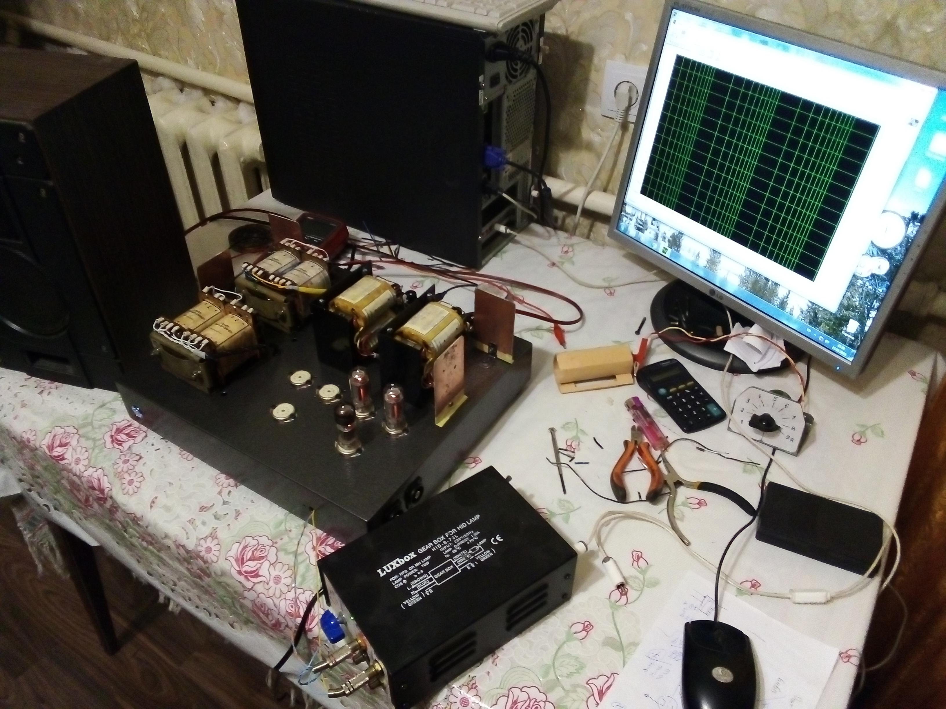

output transformers шл 25\25 and chokes are homemade , the power is converted from industrial тс70.first, the circuit was on a breadboard and the parameters of the output transformer were tested to get good performance, then a transformer with taps 4 and 8 R
Joined 2009

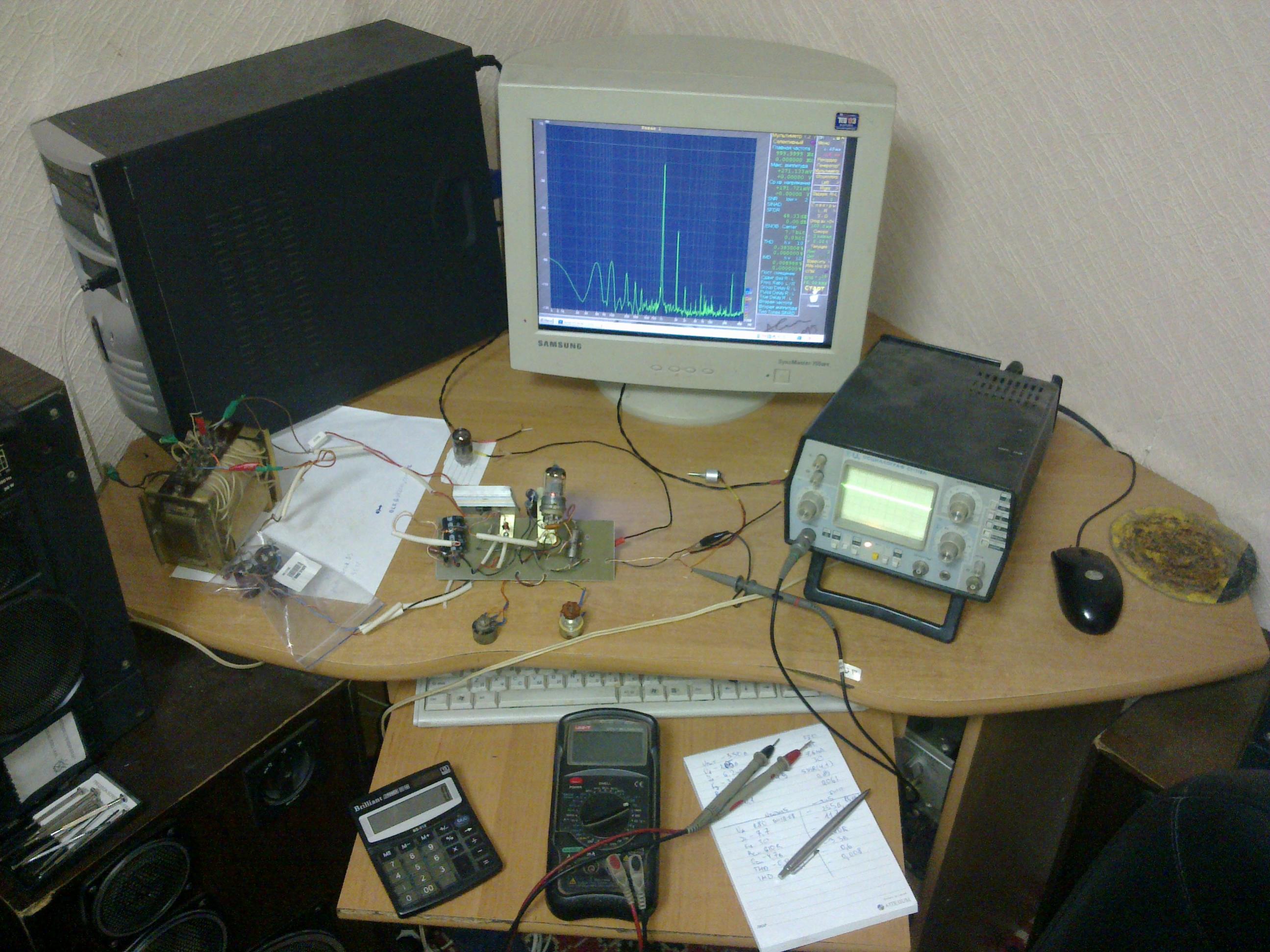

one more photo
Looks good! did you also make the chassis ? Looks to be as much work as the electronics inside it.
That second picture displaying the spectrum analysis:
I cannot see how much the 2nd harmonic is below the fundamental ( if I am interpreting that picture correctly of course...).

Here is the E-Bay link.
Williamson push-pull Amplifier circuit board For 12AX7/12AU7/EL34/KT88/6P3/6L6 | eBay
If you are contemplating building this amplifier please take time to read my build thread as there is a minor issue with the biasing.
Joined 2009
Just so darn curious, but this link, like several other eBay listings that I’ve noticed over the past few years, uses the word ‘fever’. A word of our times you could say. But I’d like to know what Chinese word keeps getting auto-translated into ‘fever’ and what the heck was the author really trying to say?
Probably just the "high temperature".But I’d like to know what Chinese word keeps getting auto-translated into ‘fever’ and what the heck was the author really trying to say?
Those "fever electrolytic capacitors" in the listing are Cornell Dubilier 381LX, which are rated at 105°C
