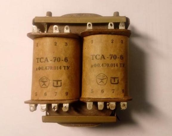

What is " industrial TC70"?output transformers шл 25\25 and chokes are homemade , the power is converted from industrial тс70.first, the circuit was on a breadboard and the parameters of the output transformer were tested to get good performance, then a transformer with taps 4 and 8 R

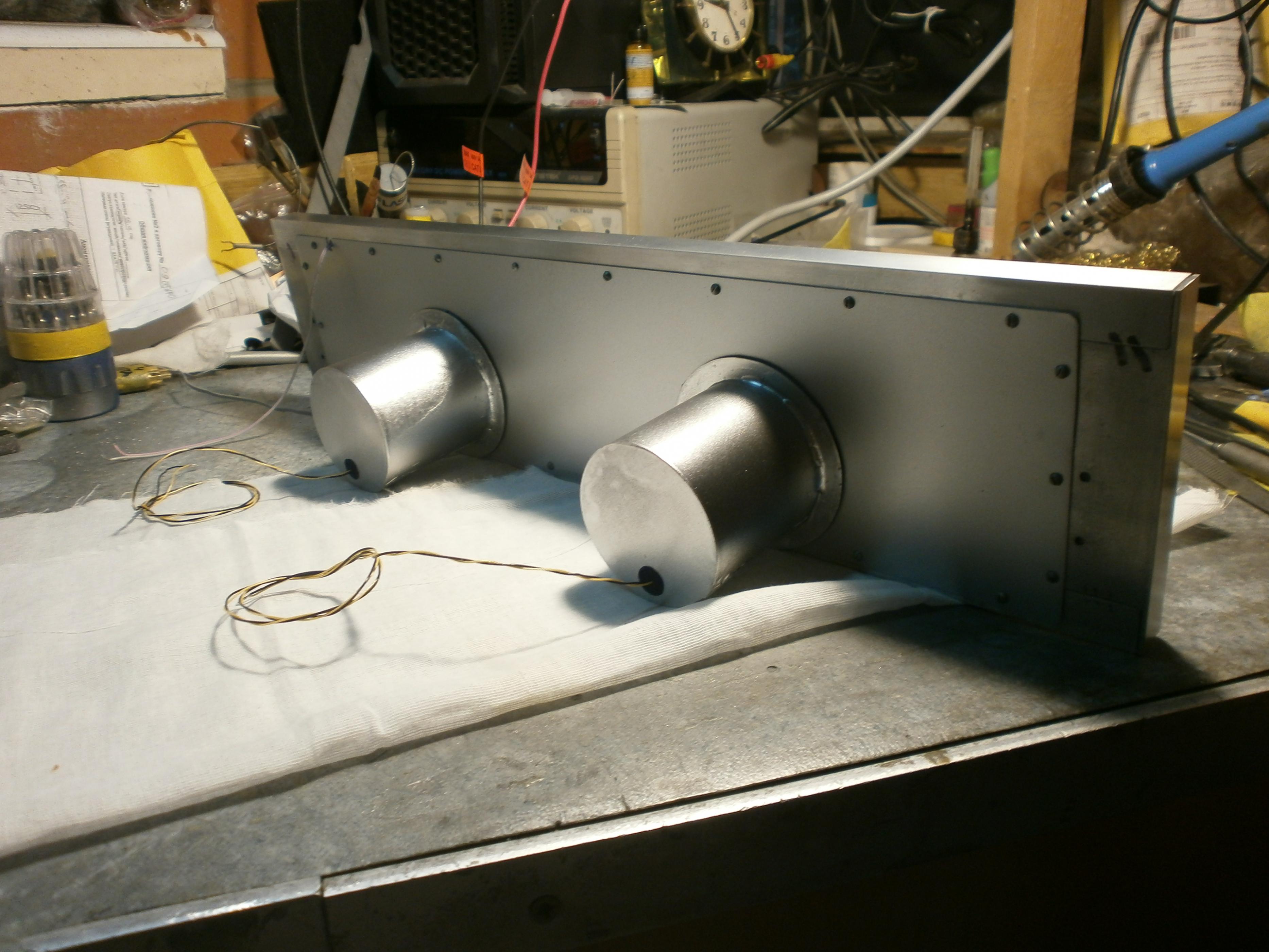

TS-70 (Russian "TC-70", from the "трансформатор силовой" - "power transformer") is one of the standard Soviet-era C-core transformers, which were widely used for consumer electronic devices.What is " industrial TC70"?
Those are still somewhat popular here as the core donors.
Pictured is the TSA-70, which is low-cost TS-70 version with the aluminium windings.

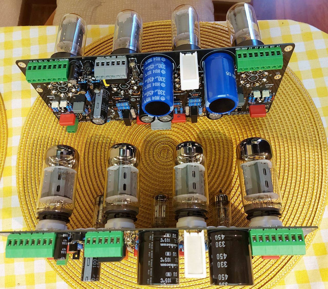

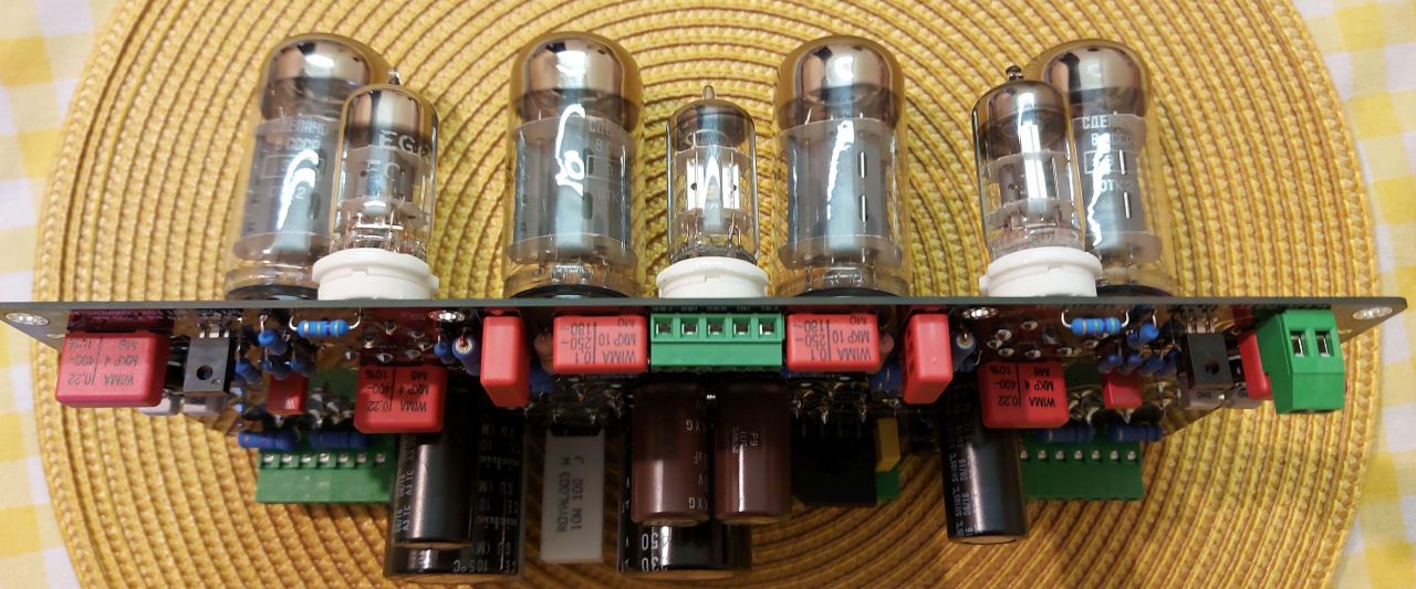

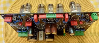

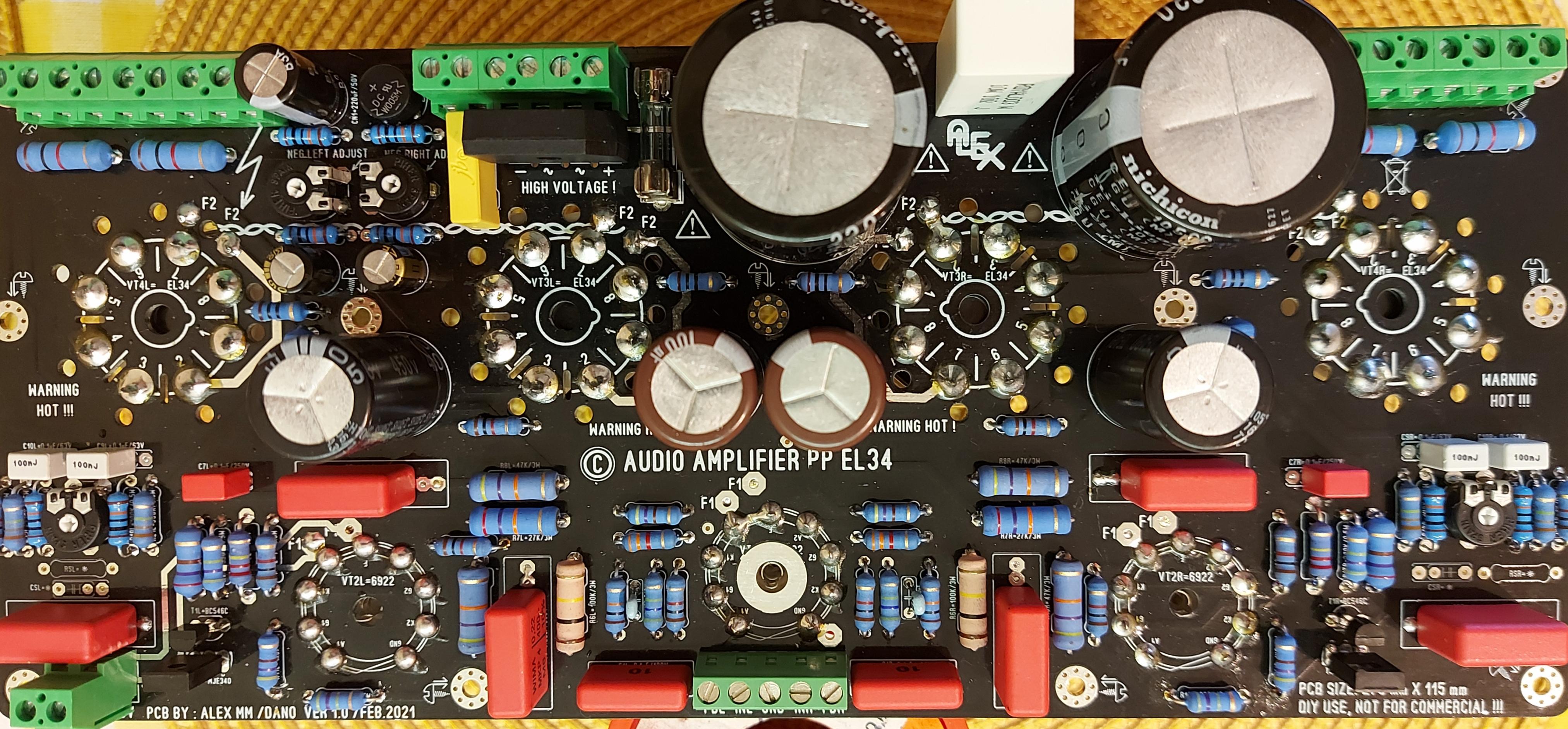

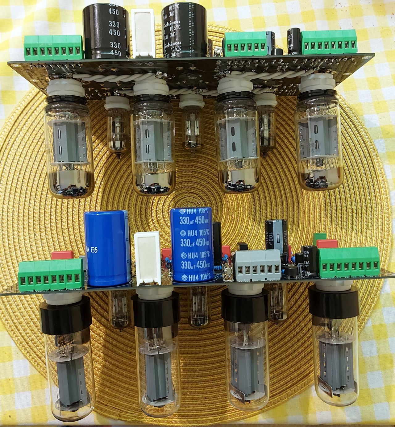

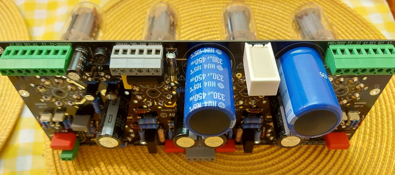

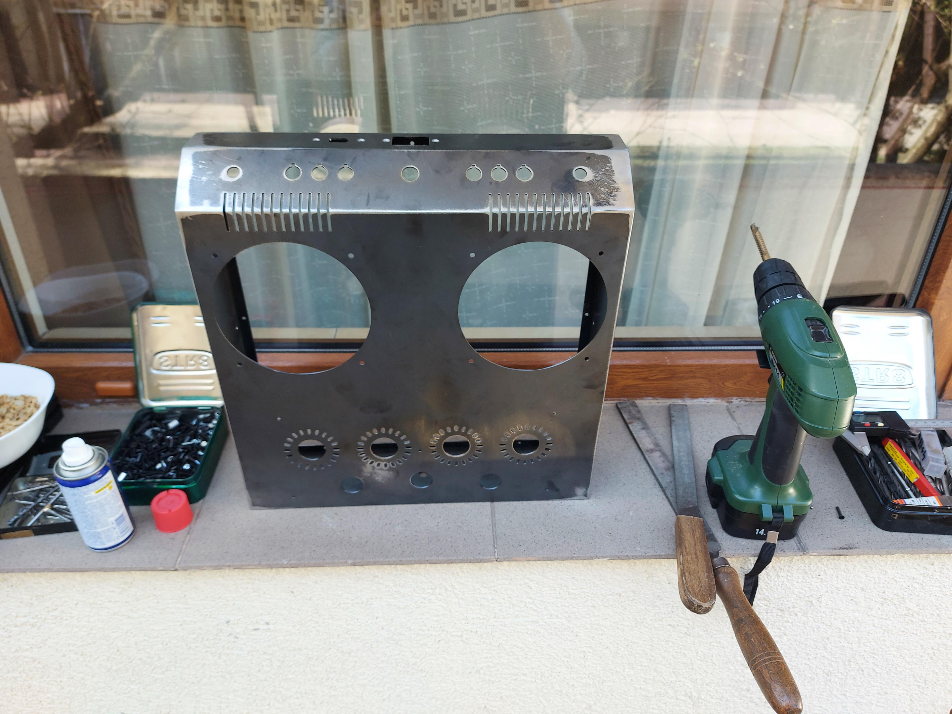

Work in progress.🙂

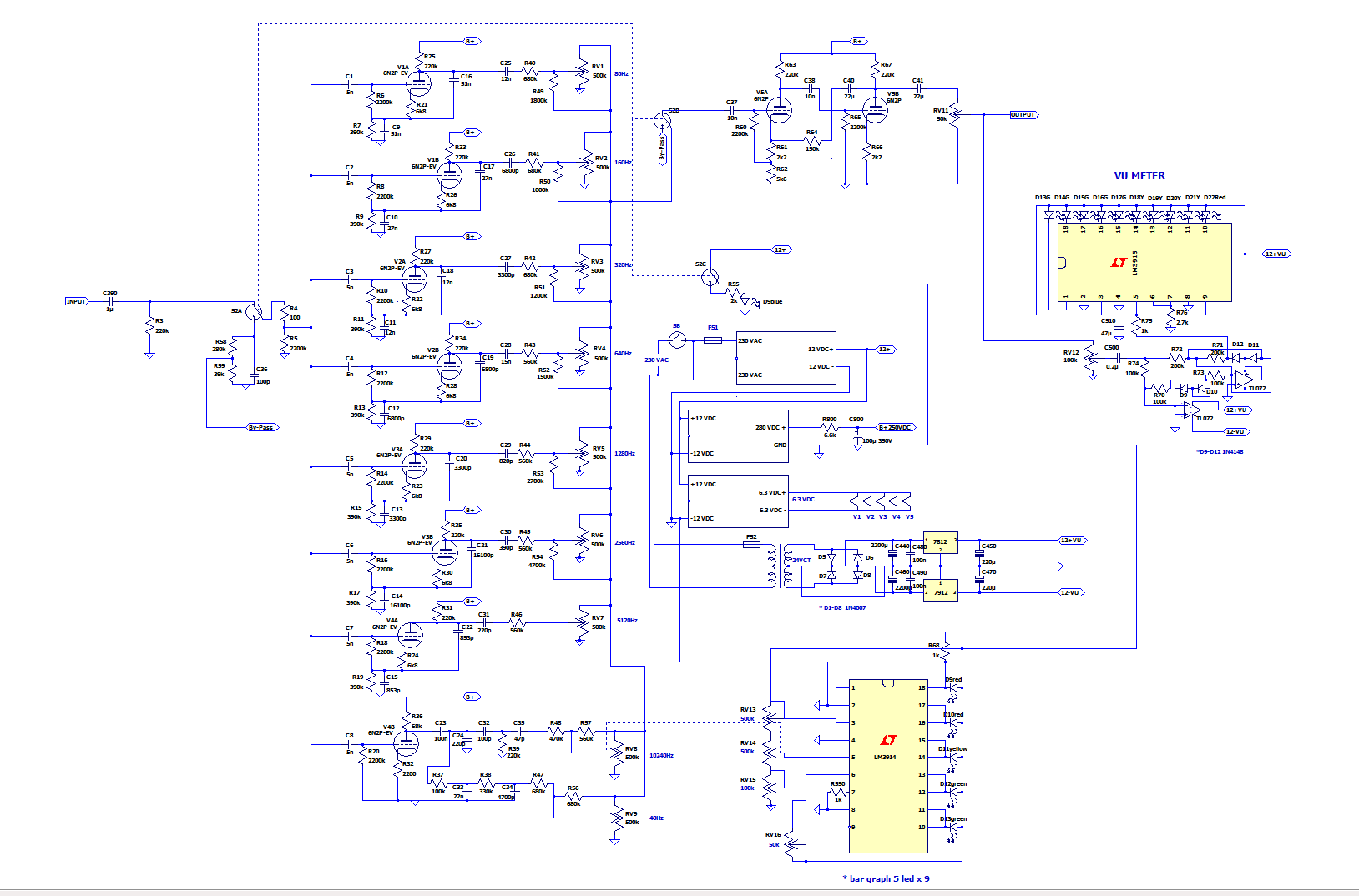

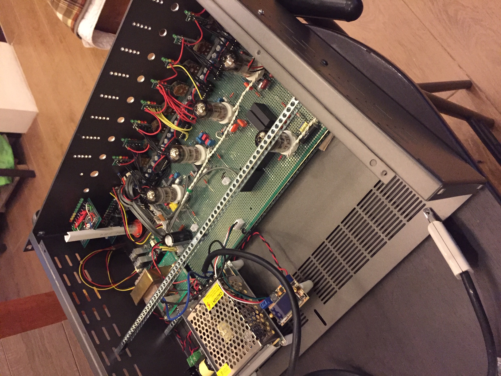

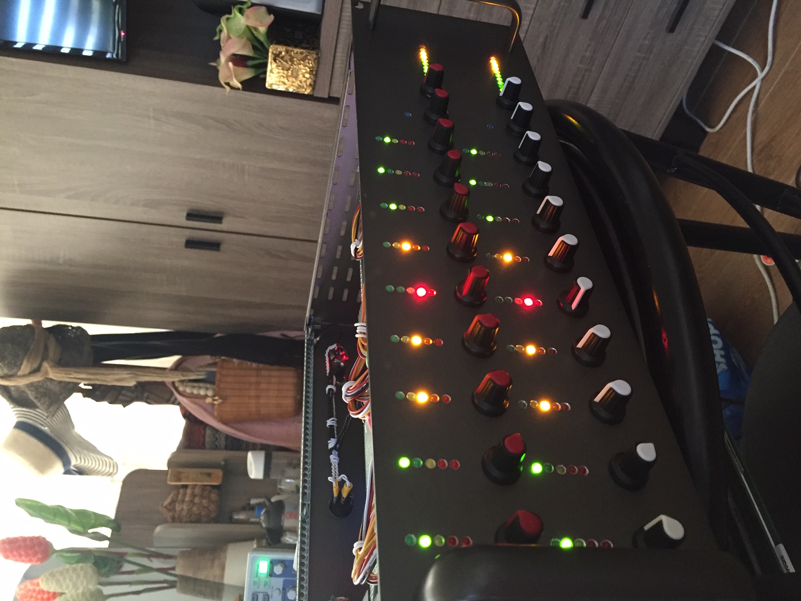

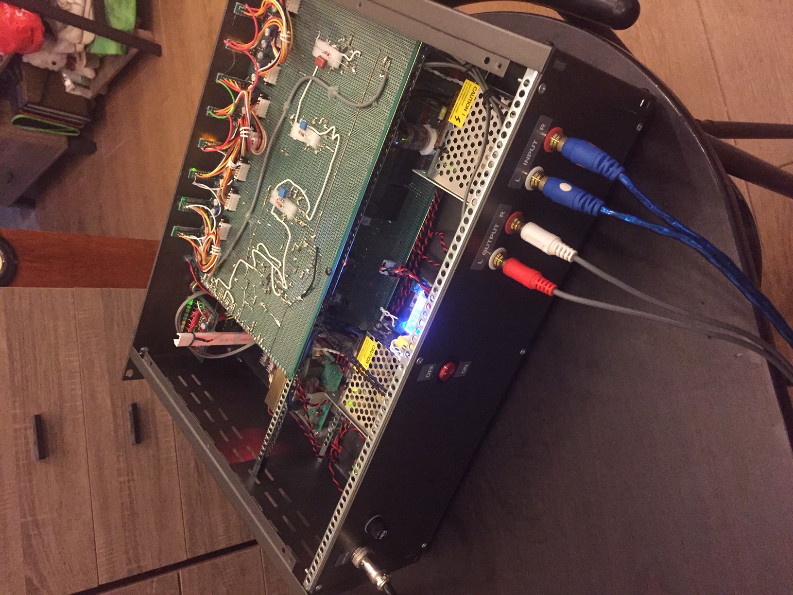

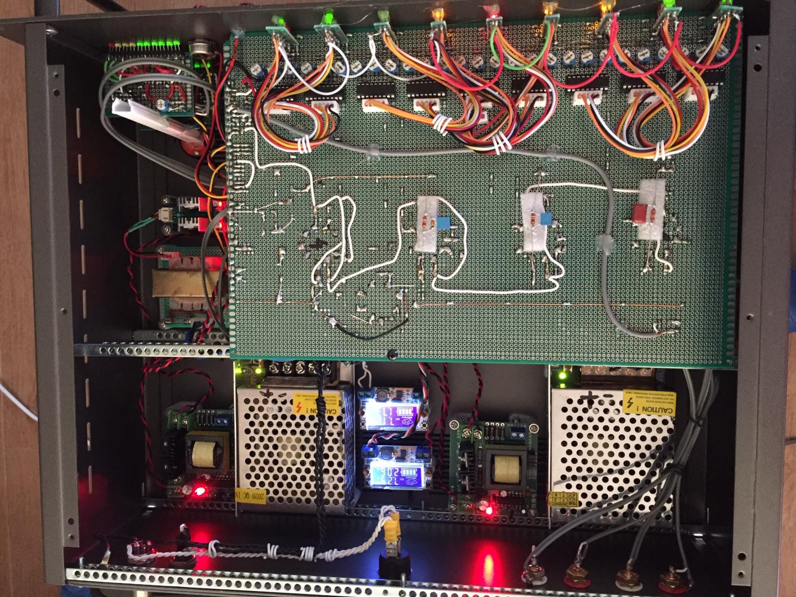

The Blonder-Tongue Audio Baton replica now finally finish, initial noise problem was due to the boost module of poor quality, thank to "kodabmx" with different boost module all noise are gone.
I am very happy with the result and most of all sound beautifully, frequency interaction work very well living space for some interesting effect.
The two channel are completely independent so very flexible adjustments on frequency response, full waive VU meter, THD 0.15%.
The most difficult task has been the space in the 3U cabinet, really a question of millimeters for host the two channel.
Really happy to bring back from 1959 some electronic master piece and more happy on 2021 to enjoy the music.

About UV-meter
Thank you for your flattering review. This is my own development based on standard arrow indicators.

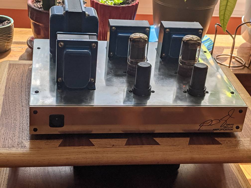

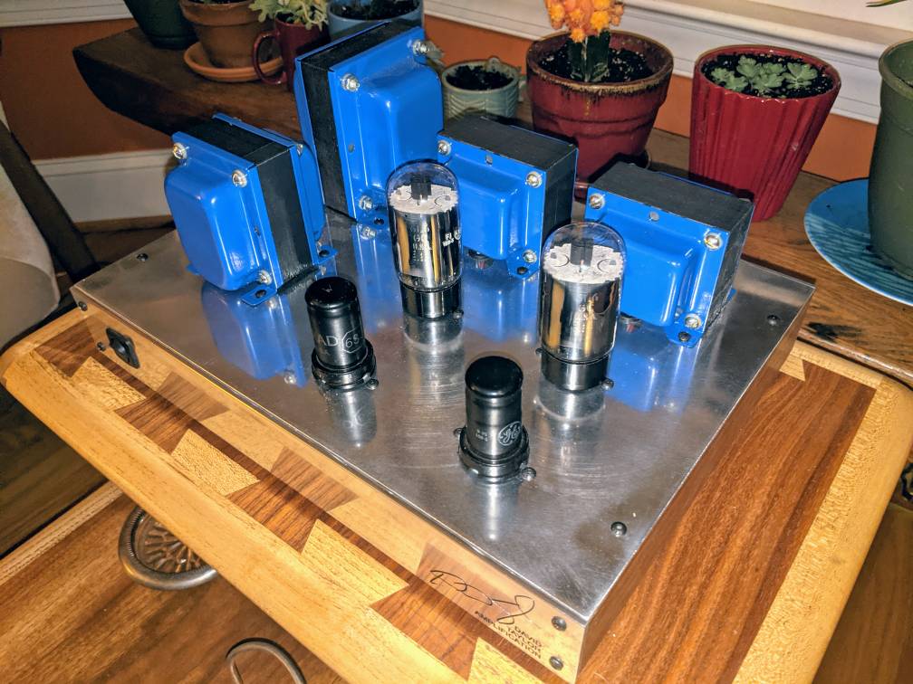

Nice amp kuroguy -- 16 weeks for the transformers is a long time to wait, but well worth it I'm sure.
