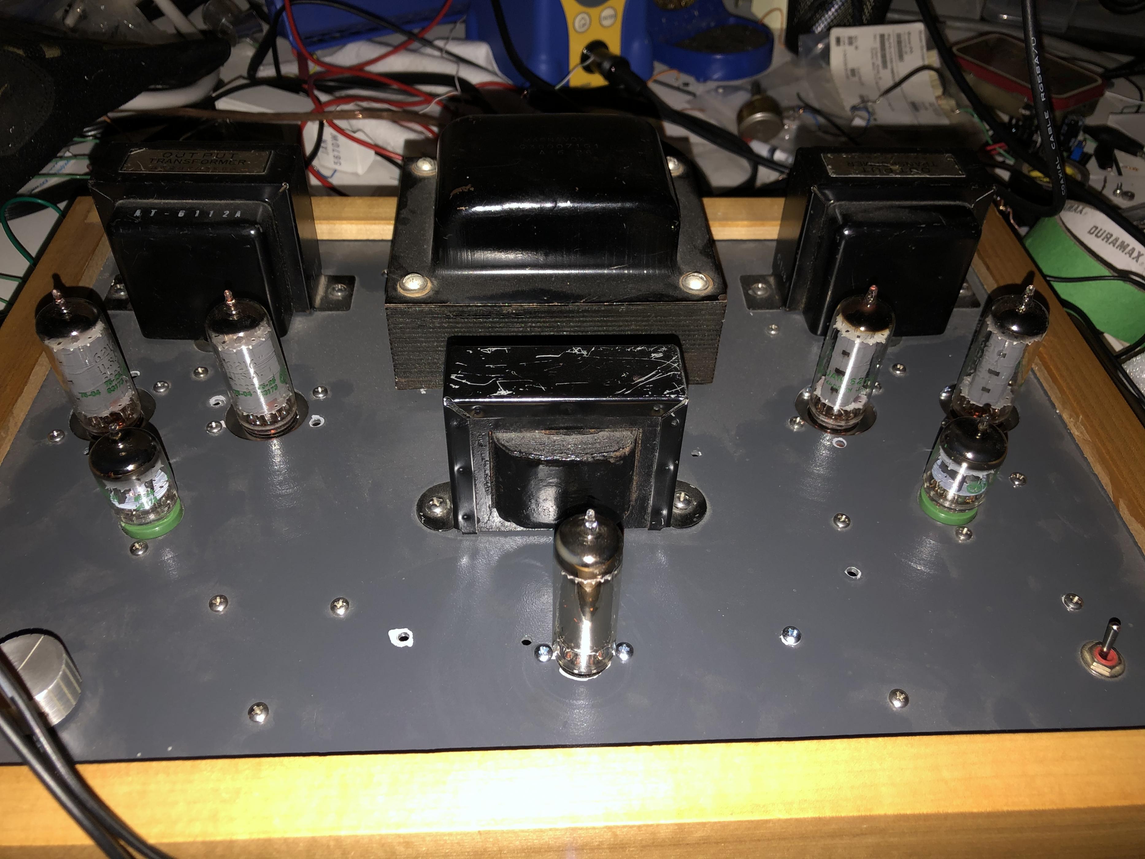

A while back I posted a schematic for my amp using 6216 output tubes. The feedback was wired incorrectly and corrected. The 0A2 regulator tube is a new addition for the screen supply. I used to have an LR8 regulator with a pass transistor but wasn't happy with that design. As a safety feature the bias supply holds a b+ relay closed. The tubes run at 260v on the plate and have the idle current set for 27ma.
This chassis was used for a previous design that never went anywhere so it needs some touch up paint.
Just curious. What was it about the LR8 regulator you didn't like?
It wasn't the LR8 itself but something popped on powerup during bench testing. The pass transistor was salvaged from a monitor and rated for 1200vdc. I rebuilt it slightly different using a found schematic but something wasn't quite right. With a 20 turn trim pot there was a lot of "dead space" so to speak with the pot and when it got into the adjustable range it was very narrow. You can't beat the simplicity of an 0A2.
