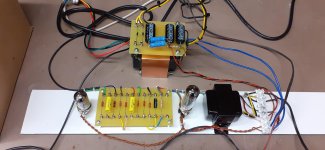

Very well done!
Logical- one can see the schematic by looking at the photo of your circuit.
But we do not know which tubes are used. Moreover, how is the filament supply done. No hum? Do not detect how this is done except from those brown twisted leads.

Valves on my circuit are 12AU7 preamp and EL84 output, filament supply is 6.3v ac directly from the power supply transformer with 2 x220 ohm resistors to ground to provide a virtual 0v. No problems with hum.
The only thing I'm not really sure about is the screen2 to Anode resistor value, at the moment its 220 ohms at 5 watts - does this sound reasonable to you guys ?

Thanks Stevie for the info! The reason why I asked you for hum problems is because in the past when I made a tentative breadboard with a setup like yours, I was facing those annoying hum problems. But after having made a proper print layout I got rid of that. And in stead of a 2 x 220 ohms I used a single humdinger trimmpot. with its
wiper connected to ground (Merlin Blencowe's advise 🙂 ).
About that 220 Ohm 5W connected to the screen2: How much screen current is flowing when you drive the EL84
at low anode voltages?

The voltage across the resistor is 0.59 volts, resistor measures 219 ohms, so that gives me a screen current of 2.69mA, this with an anode voltage of 241 volts.
Power is therefore = 0.59/219 = 1.9mW
Any comments welcome .......

At what voltage operates the Vg2 ? You have to determine the voltage drop across that screen resistor to get the correct resistor dissipation ( I thought this was your question?).
Here is my latest prototype, one channel of a proposed stereo SE hifi amp, seems to sound OK as is, now onto a proper build.
What tubes are you using?

Stevie, did you had the time to give the data of Vg2 and the voltage drop across that screen resistor?
Have completely overlooked that the voltage drop across the resistor was already given 😱 . So your calculation is correct. There is nothing to worry.
