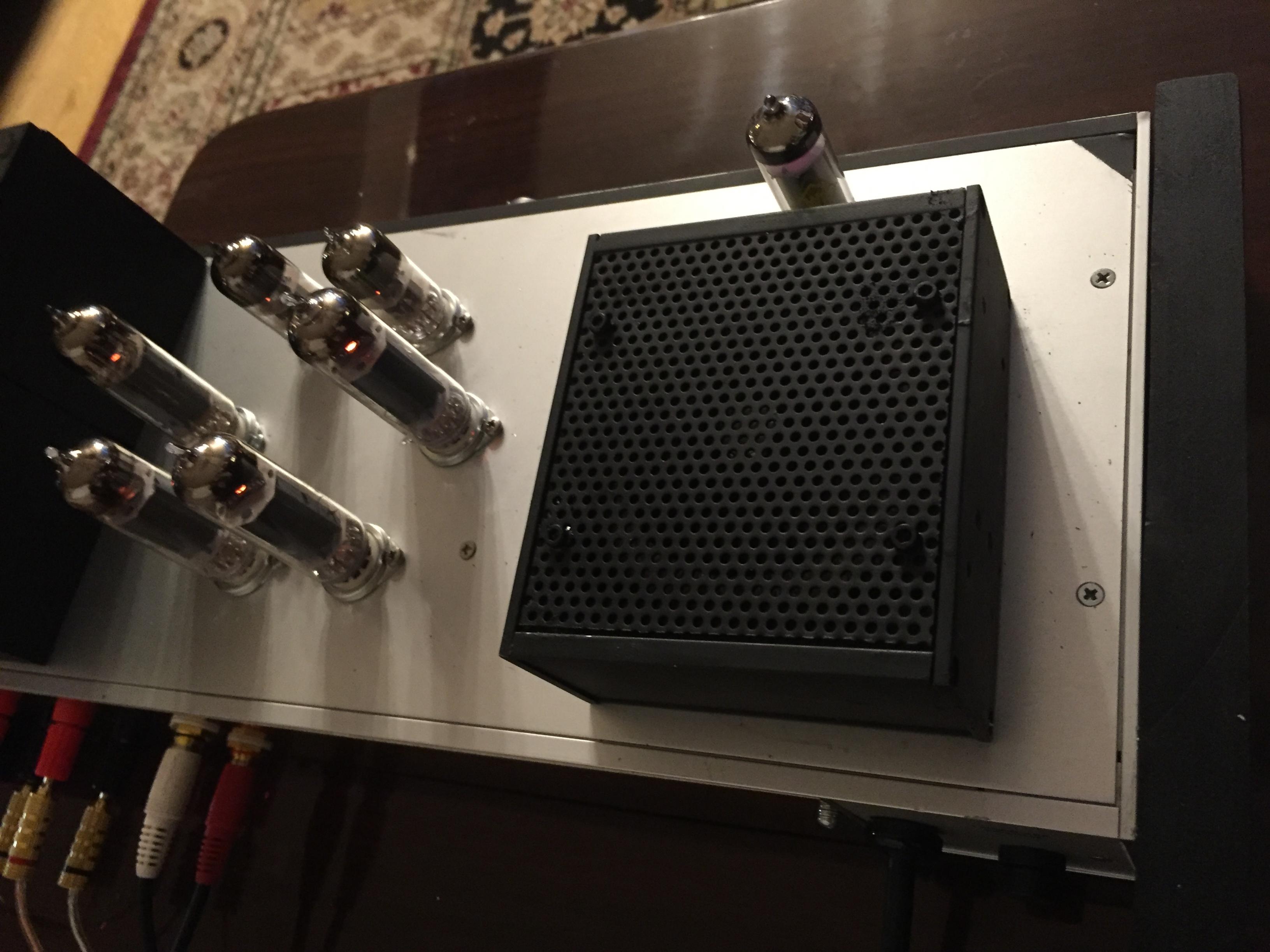

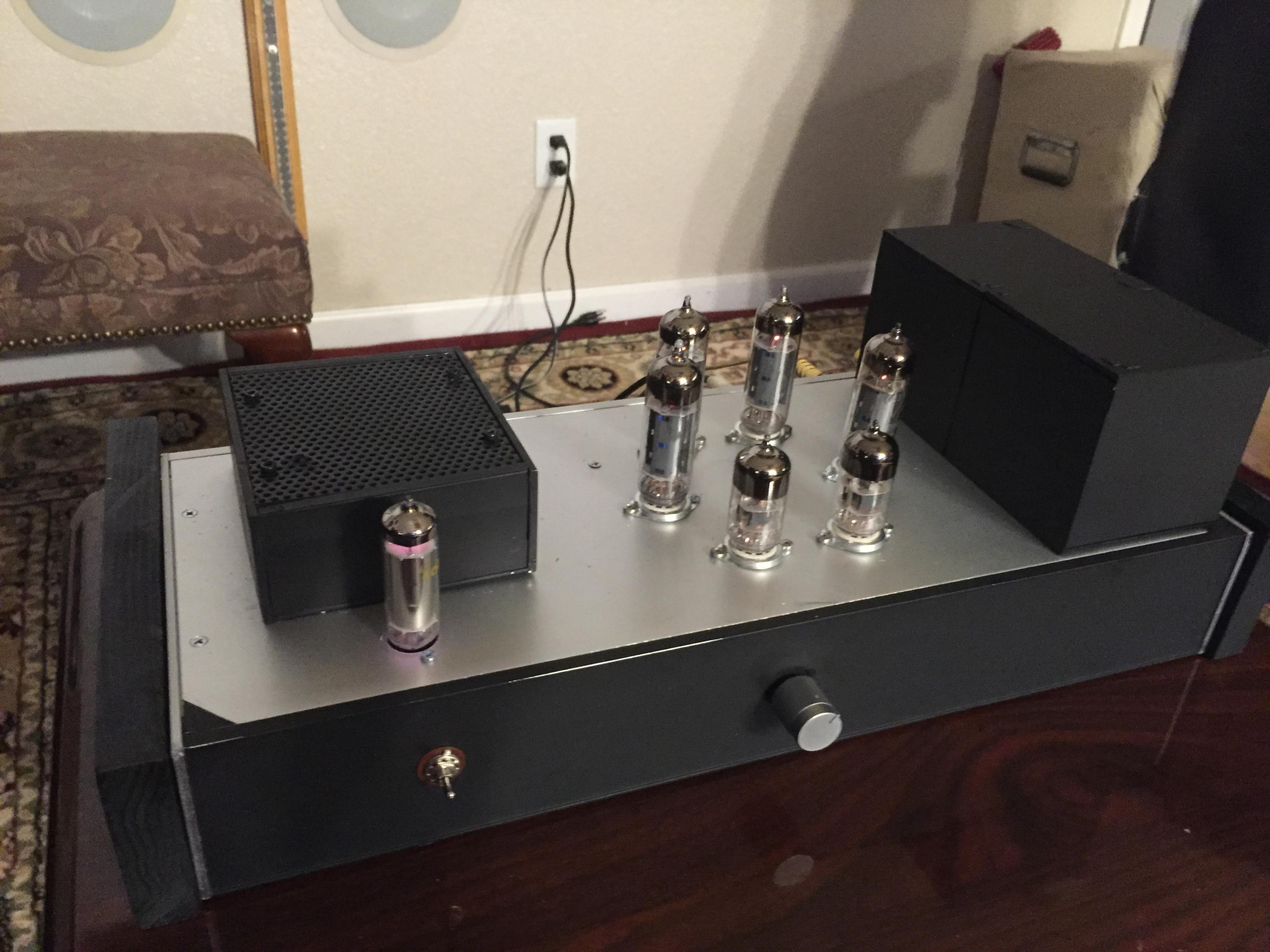

2x7.5W, pentode push-pull, class A. 6P15P output tubes.
Power transformer box is ready, painted, still drying...
Hmmmm... aesthetically speaking, the power switch is off the shelf, the knob is far too small (granted, it is the proper finish), and there is no cover for the toroidal transformer.
Since this build is a complete and utter failure, you need to send that... that... monstrosity over to me right now and I will dispose of it in an environmentally friendly manner. And tell you what, since I like you, I will do it all for free.
Please do so via insured overnight courier. And pack it carefully.
Kidding! I can not wait to see the finished side by side.

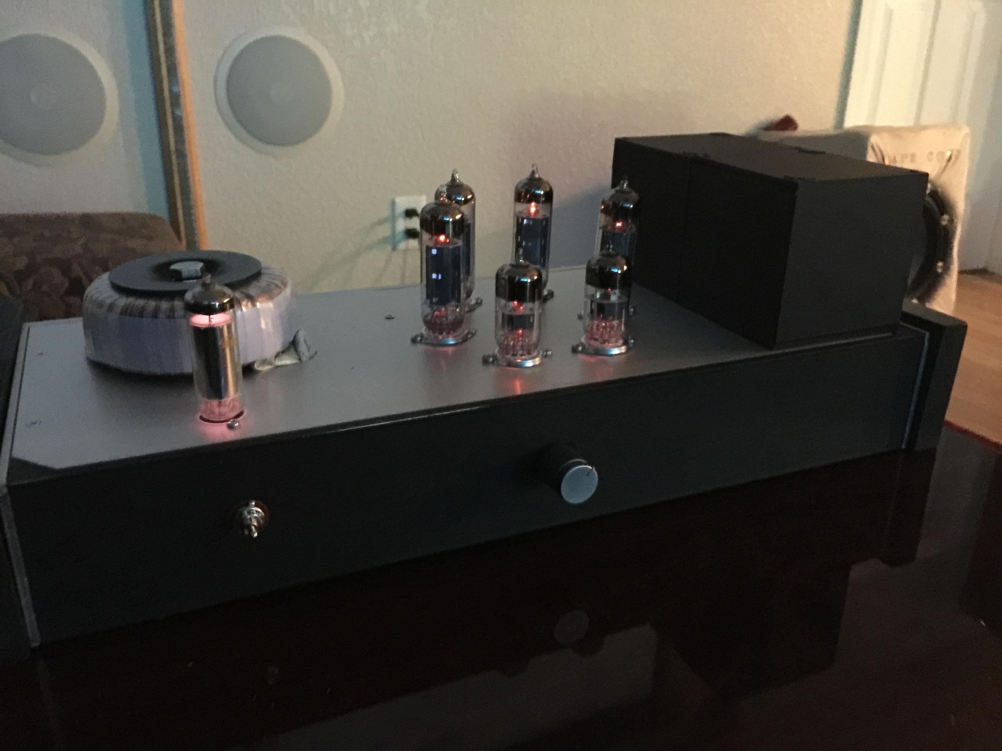

Here you go... Grab it and feed to the 3-D printer. ;-)
Nice! So are the boxes for the output transformers also 3D printed too? And the transformer box, the perf top is also 3D printed? Or just the sides?
No, but you can! It is the fastest way of shipment!
Look'n good. Next time spray the top plate. I use an etch primer after some fine sanding then Epoxy Enamel paint. Over a few weeks it drys rock hard.

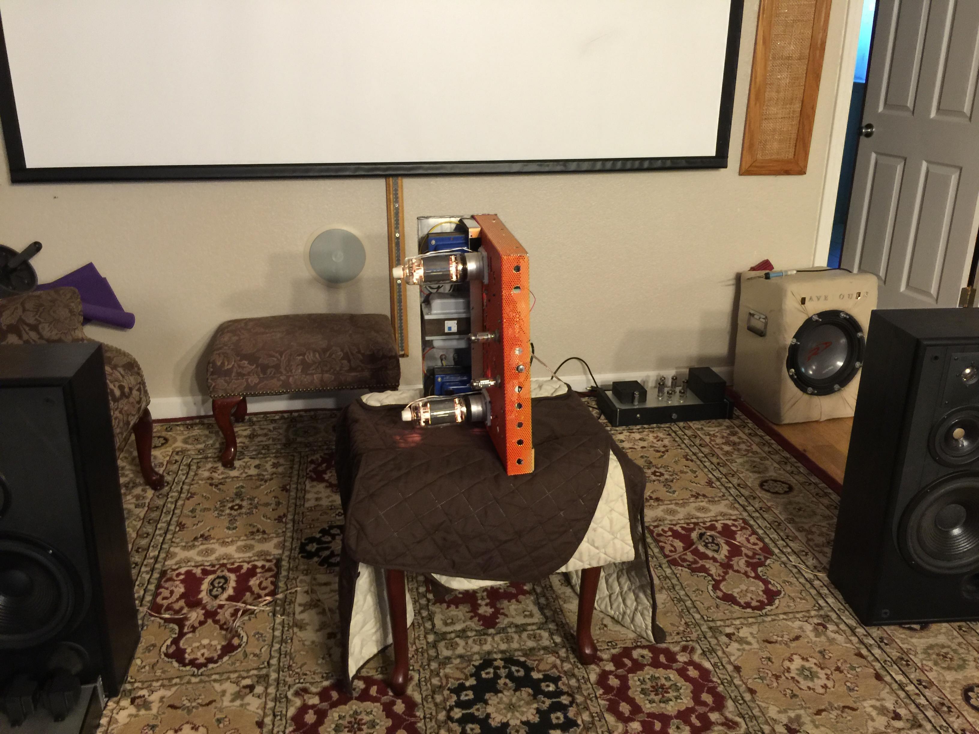

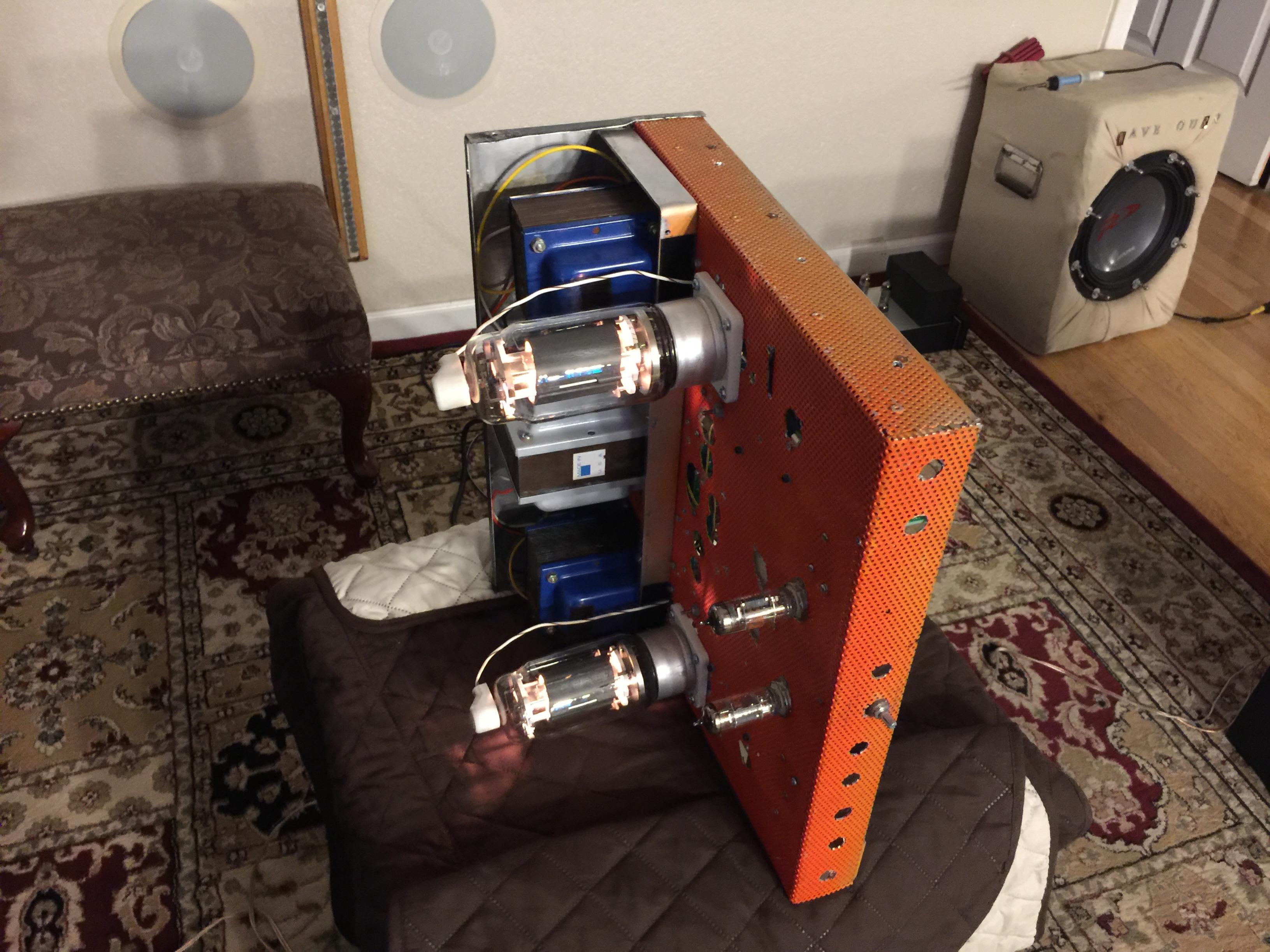

The first field test of a 2-stage Gu-13 amp prototype. Sweet! 18W from 18 Hz. 6Hz-35 kHz -3 dB
