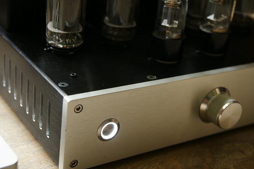

Wow! That is a great looking amp. How did you do the top plates? That mirror finish is very nice with the glass and other accents.
very easy,need any sheet metal (stainless,brass,copper) I use naval brass (to avoid corrosion) this time.Use palm sander,400 sandpaper than 800,and finish it with good polishing paste

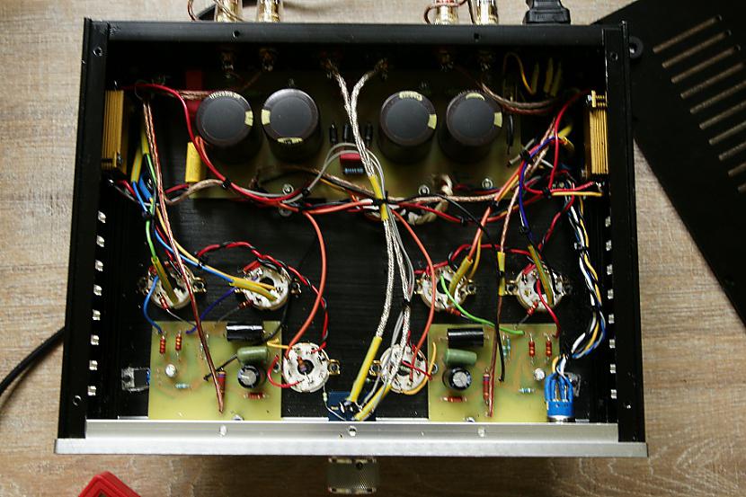

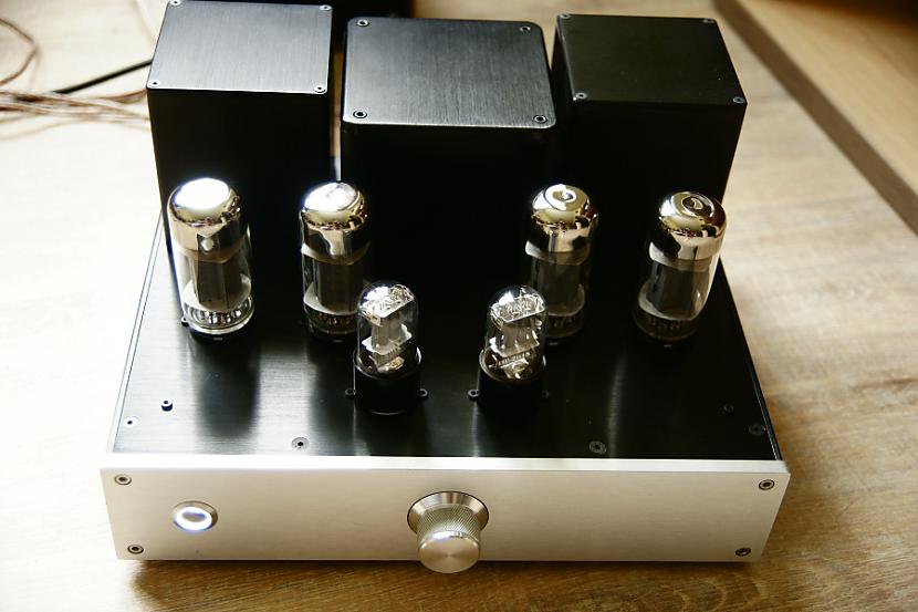

The amp in the 3rd pic, is the chassis a kit, or homebrew, I like the modular design for prototyping!

Extrusion.
For my ears its sounds nice and clean (i measure around 17W and -0,7 % distortion around 10W if i remember correctly) - only if turn- up the volume to the max -
can hear the distortion caused by the CCS ( i saw that with scope) - otherwise behaves like a normal tube amp and its very simple design. But I will not listen so loudly.

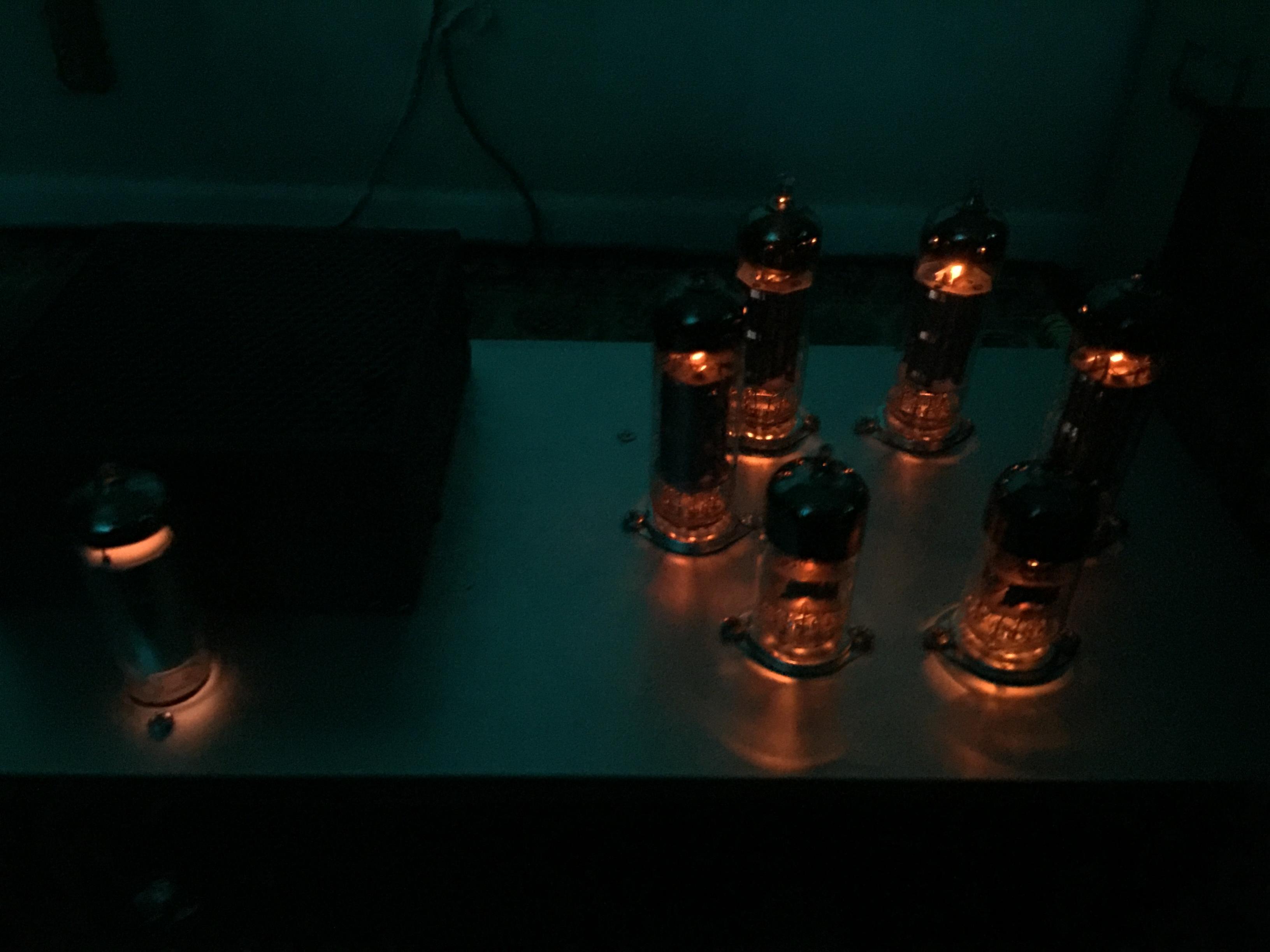

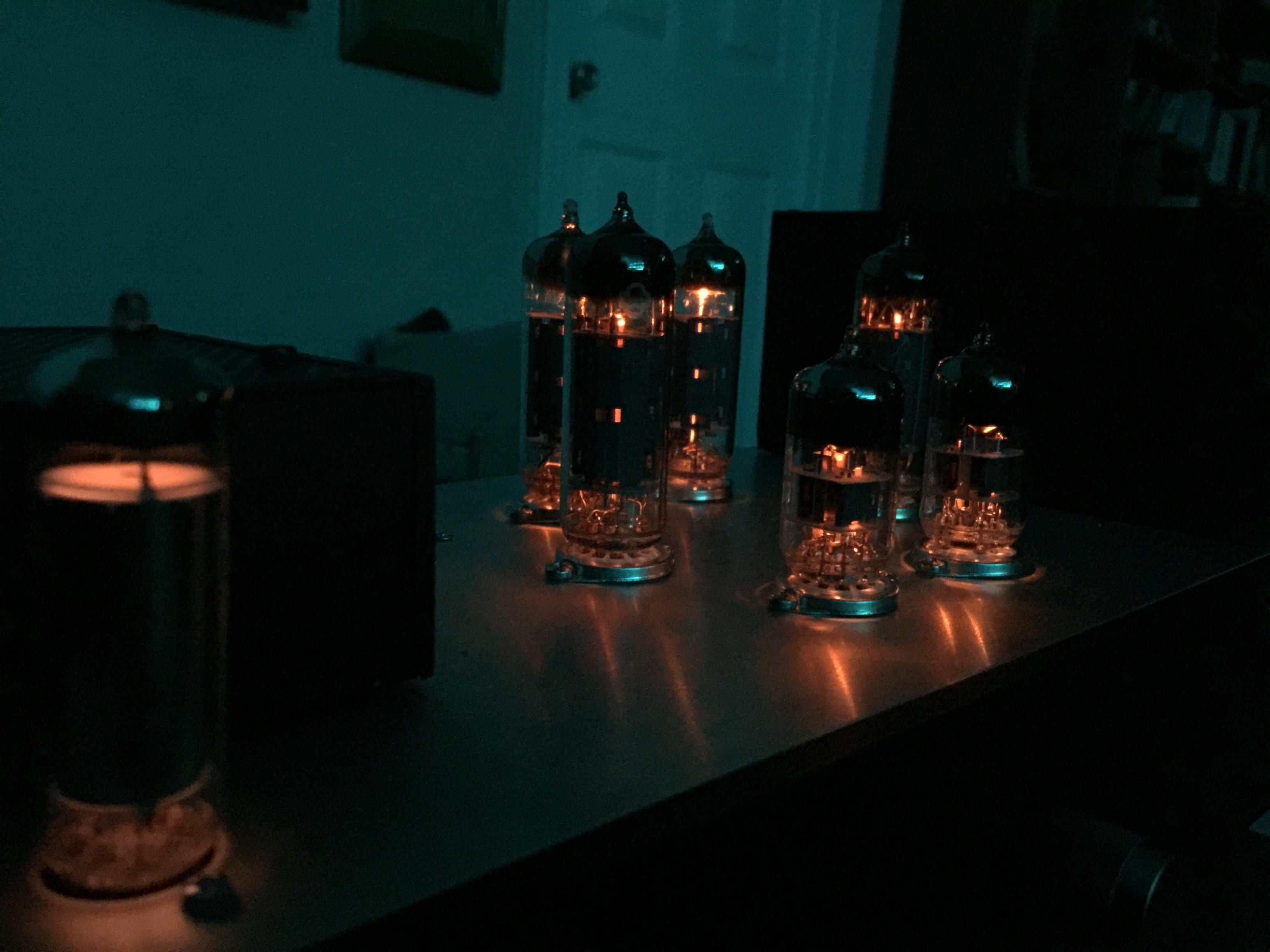

on these tubes, plate-glass seal is 200-180´c max..
you are redplating.. and cooler hidden inside glass ampoule, uh oh
Here was Wavebourn Gubernator - 71 prototype during the test... Ideal temperature regime for all components. USSR taught me to design electronics equipment for all special conditions. ;-)
https://www.youtube.com/watch?v=iCUFJF_j108&feature=youtu.be
not 180-200.it is 220 C .after 60 hours of work they get max of 340F (170C)
measurements show that special made thick glass ampules are cooling down anode caps by about 50-60F .
Let me repeat now.they do not need forced cooling 🙂
