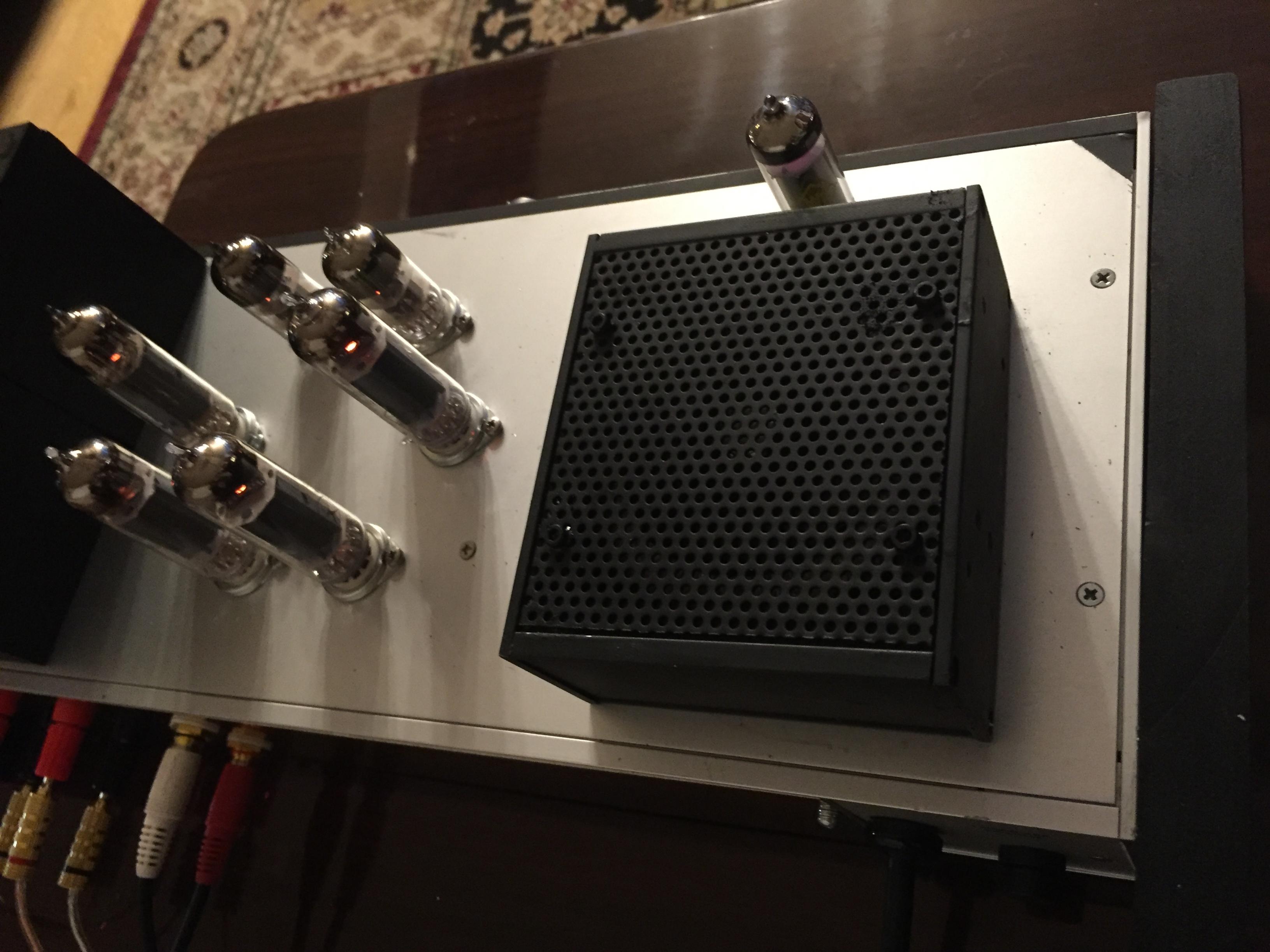

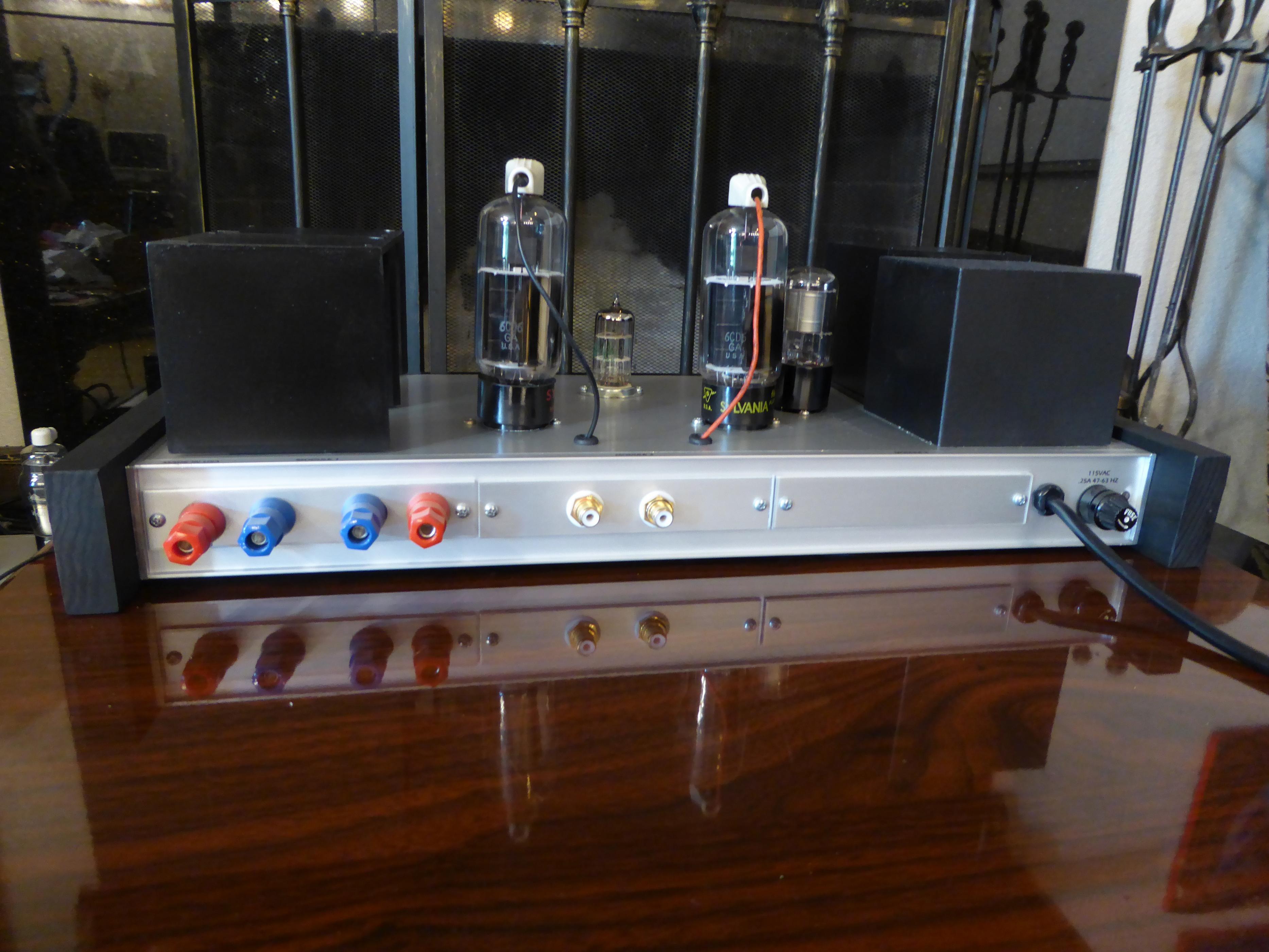

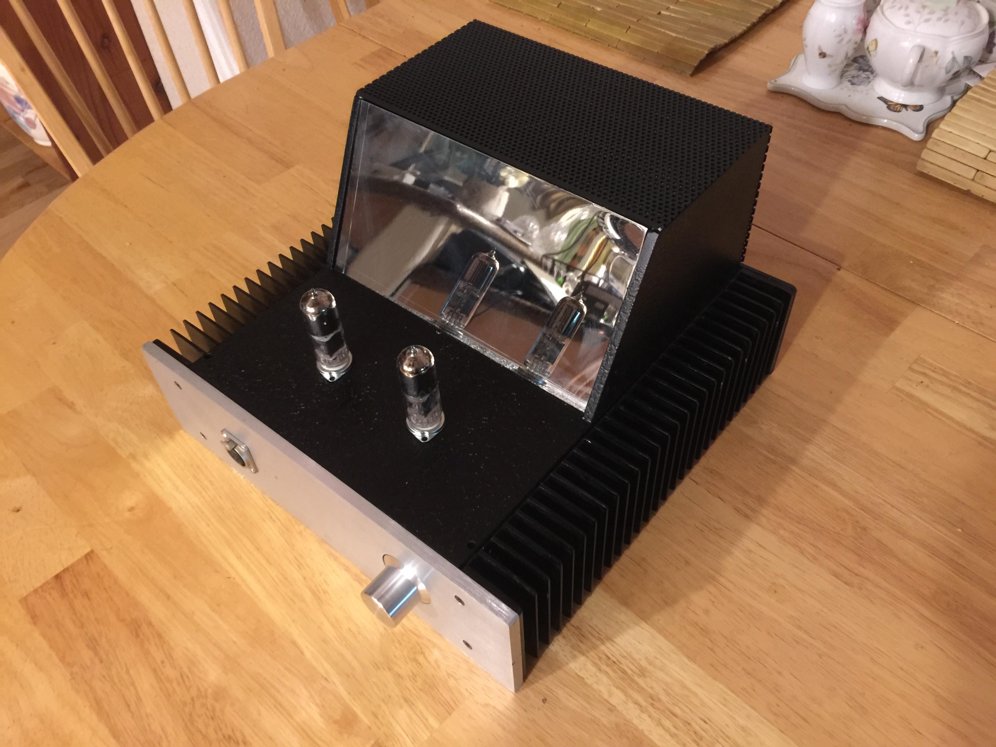

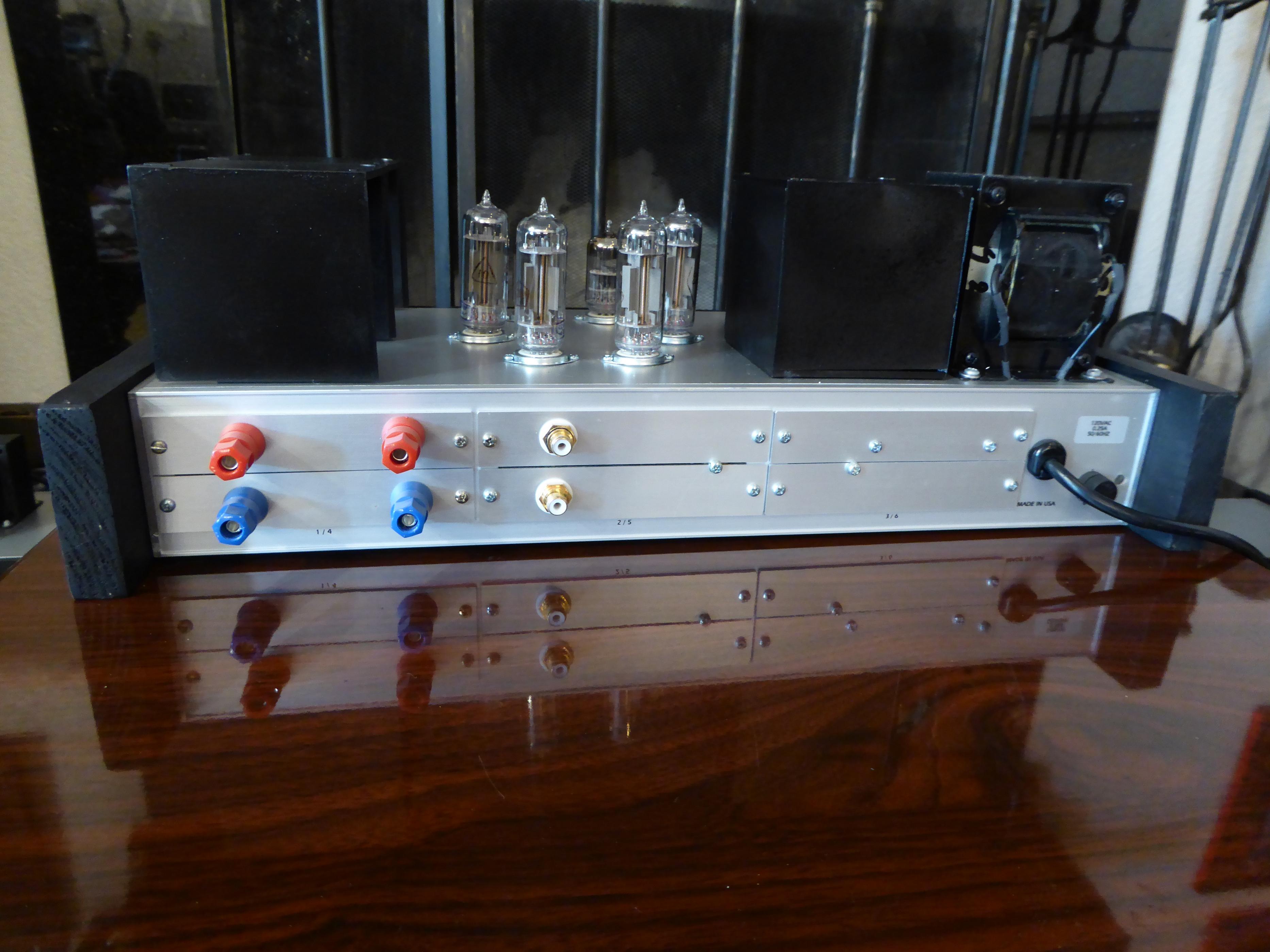

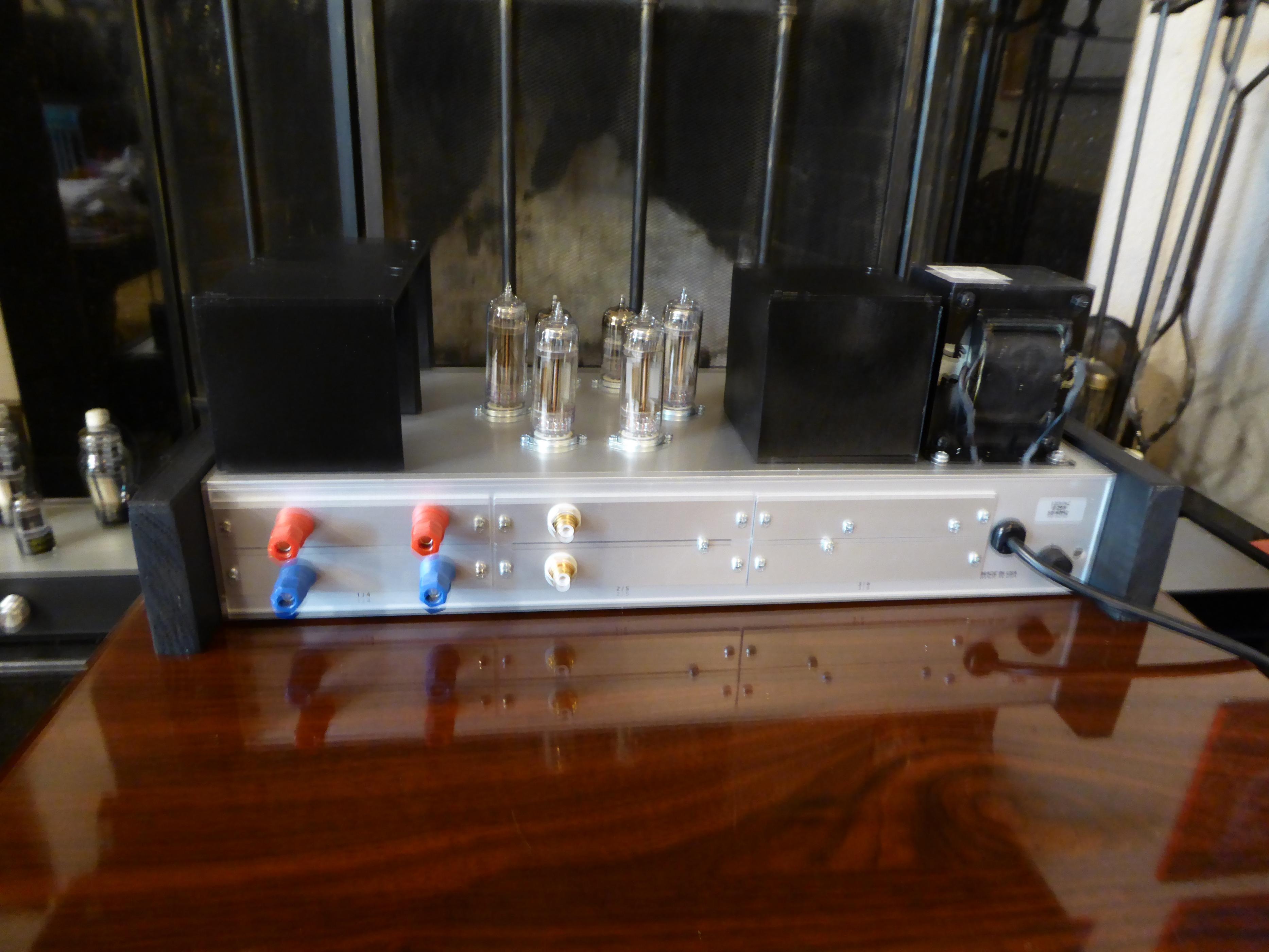

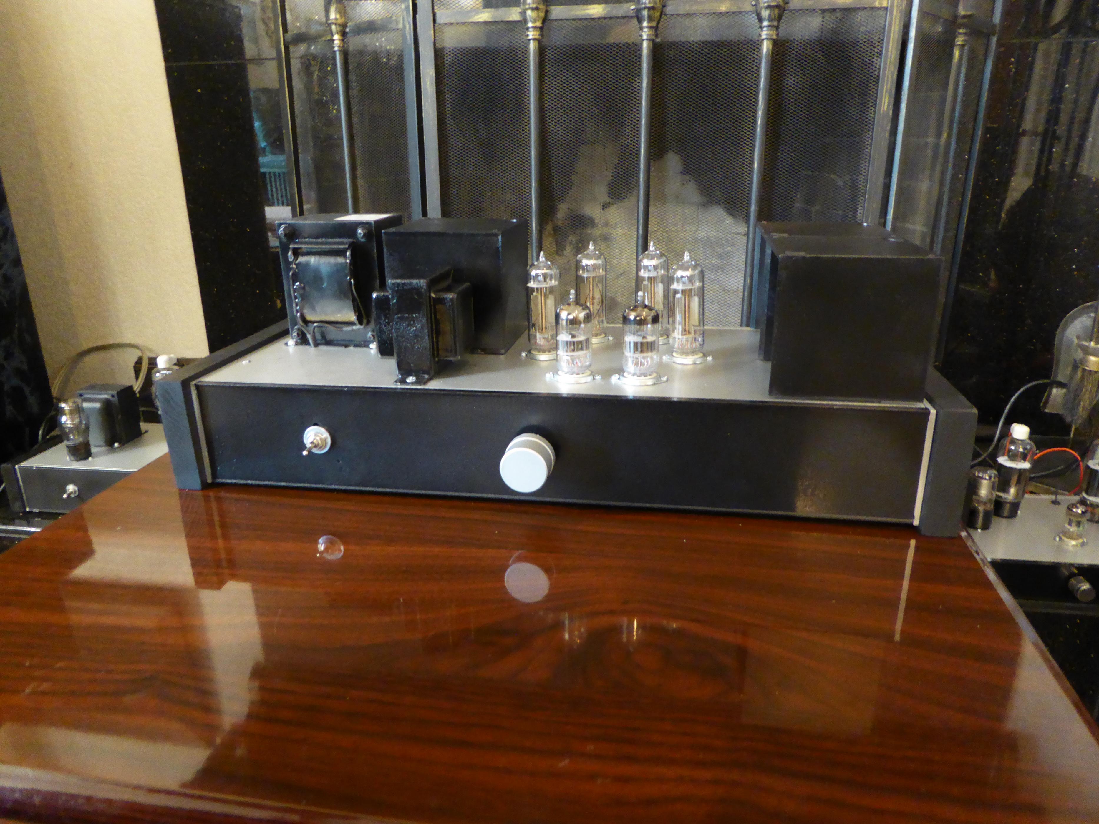

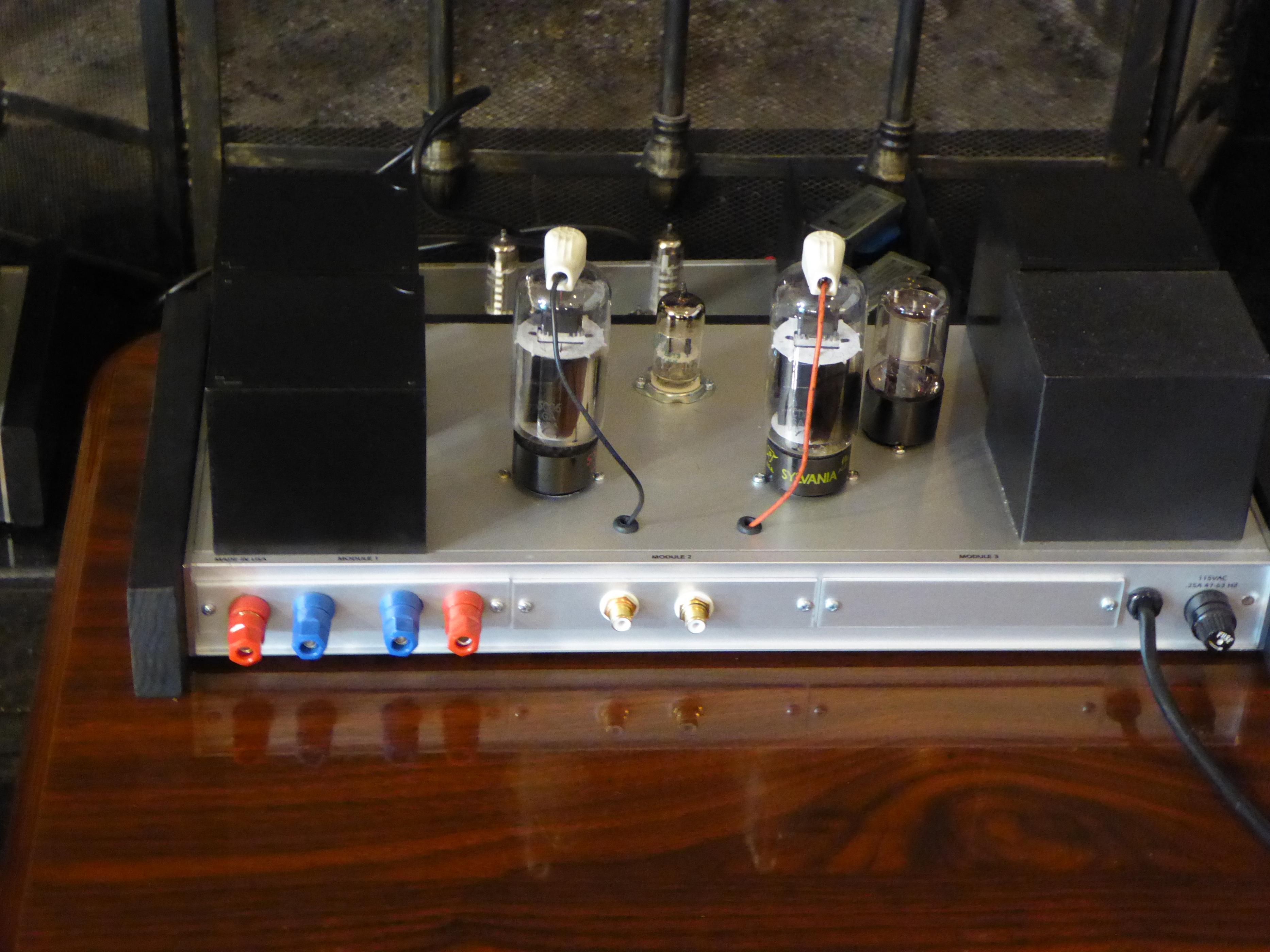

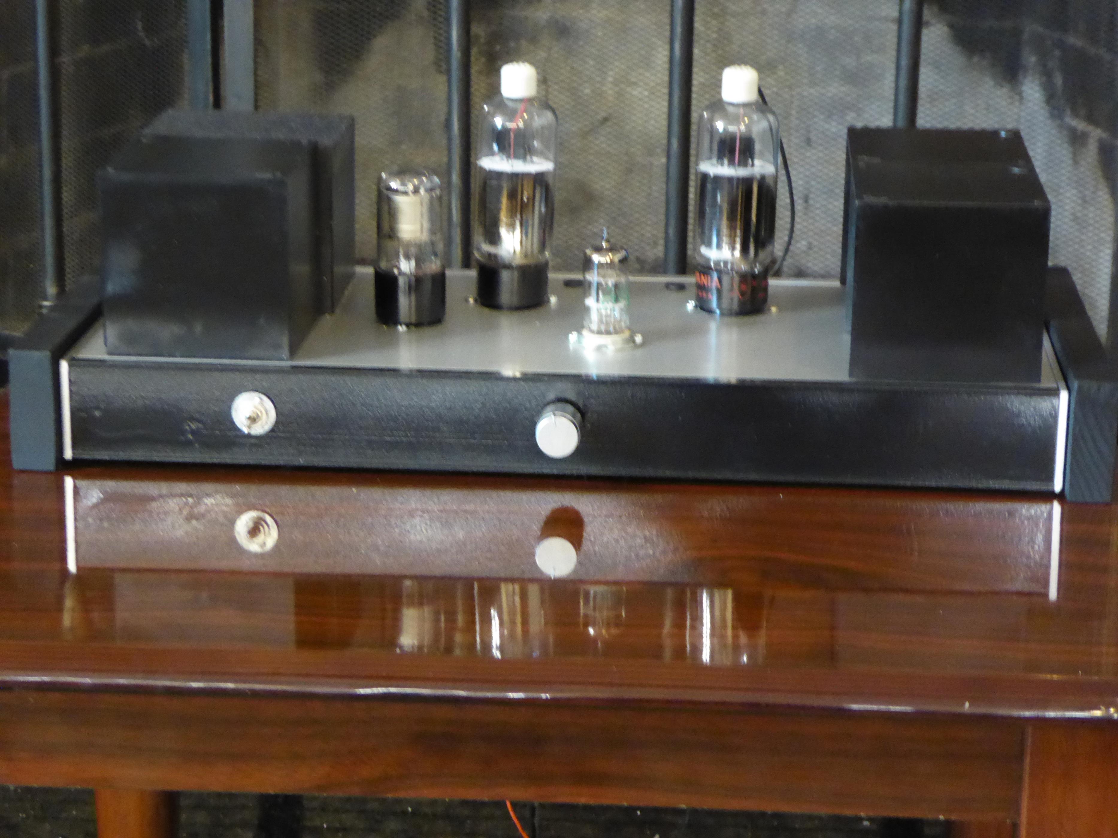

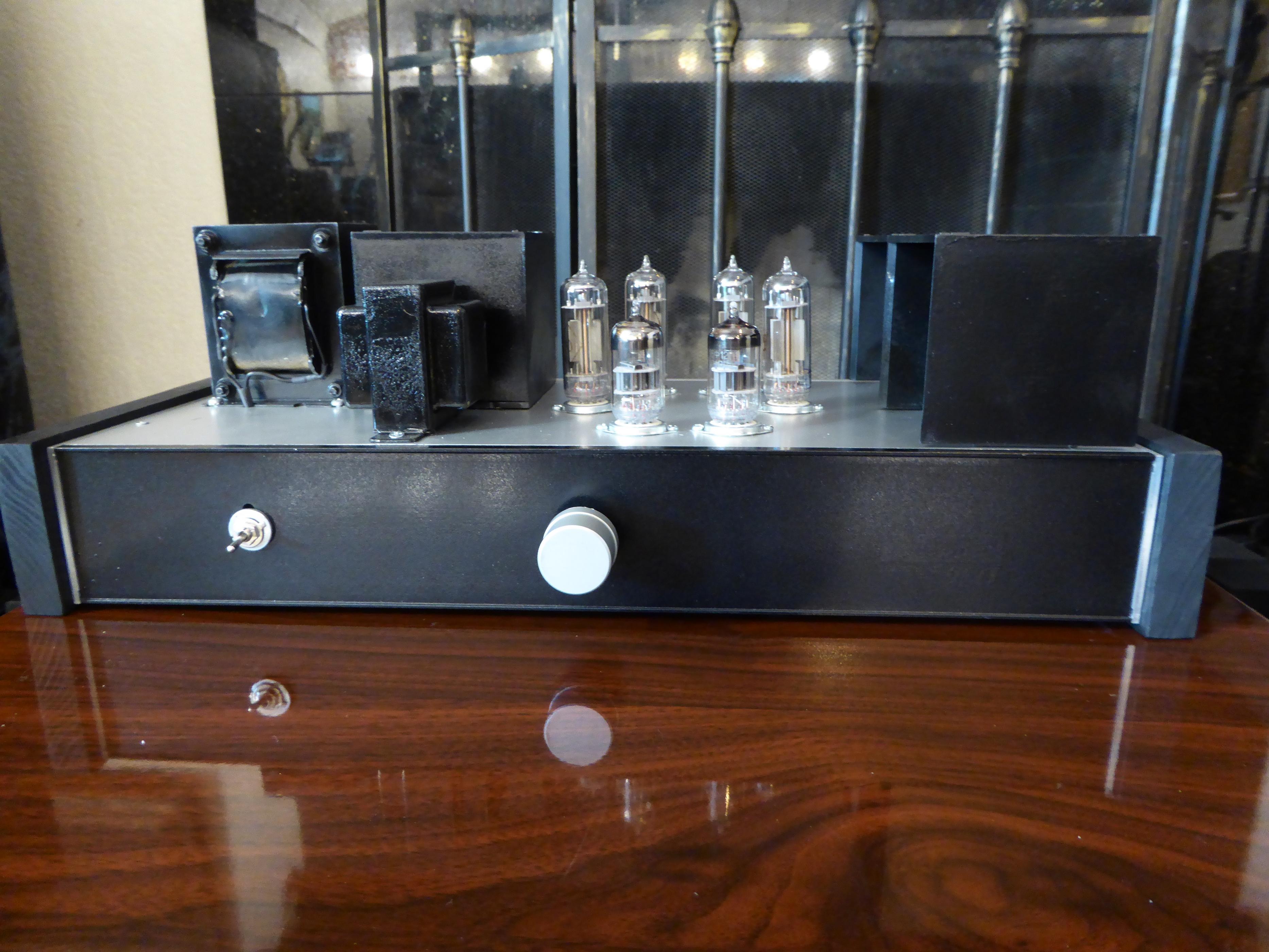

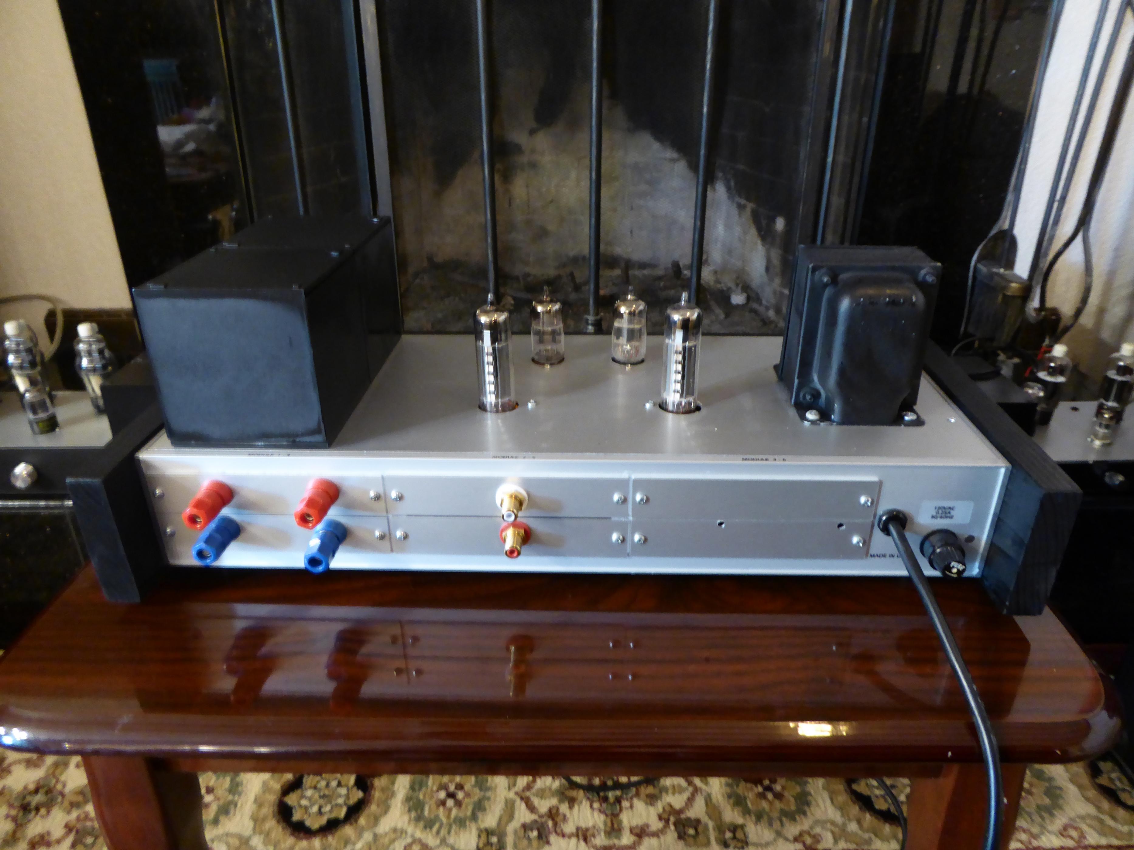

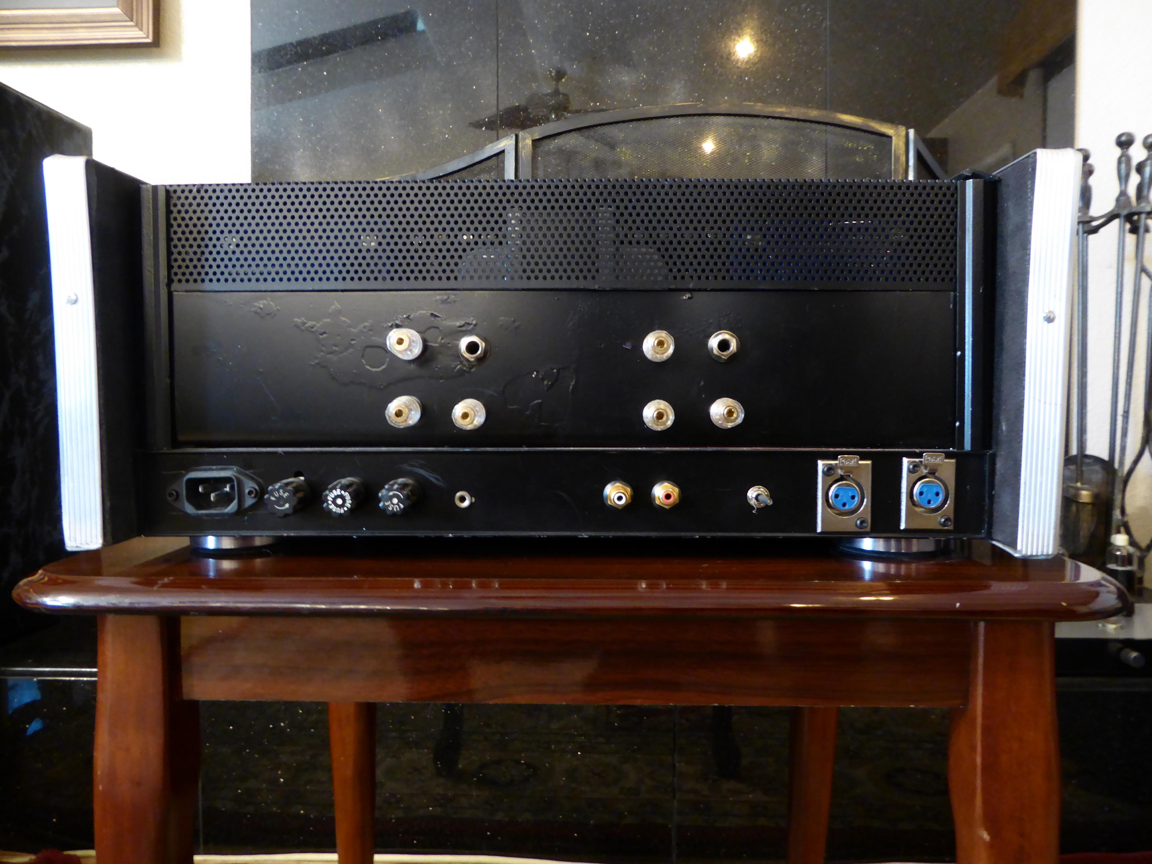

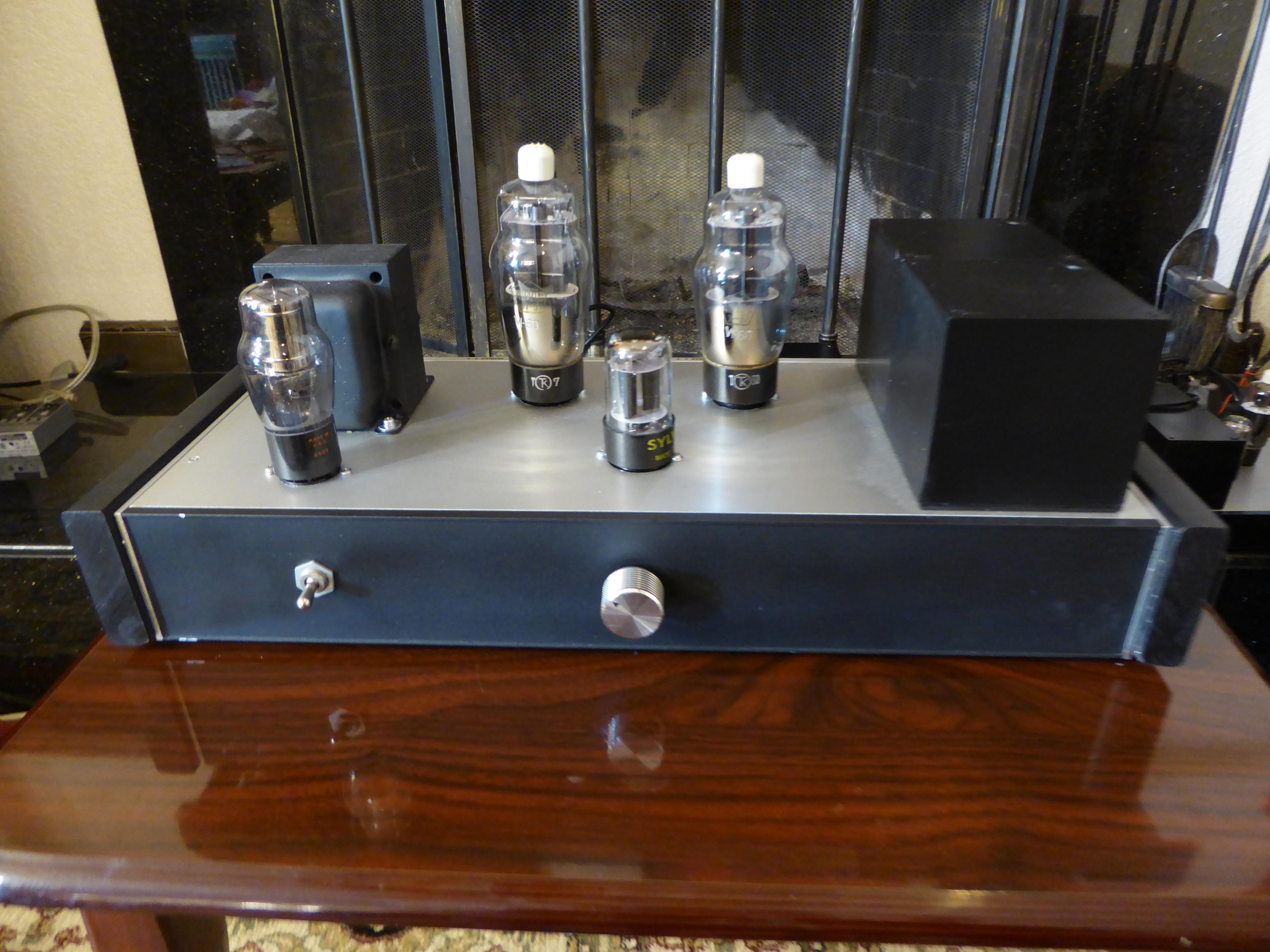

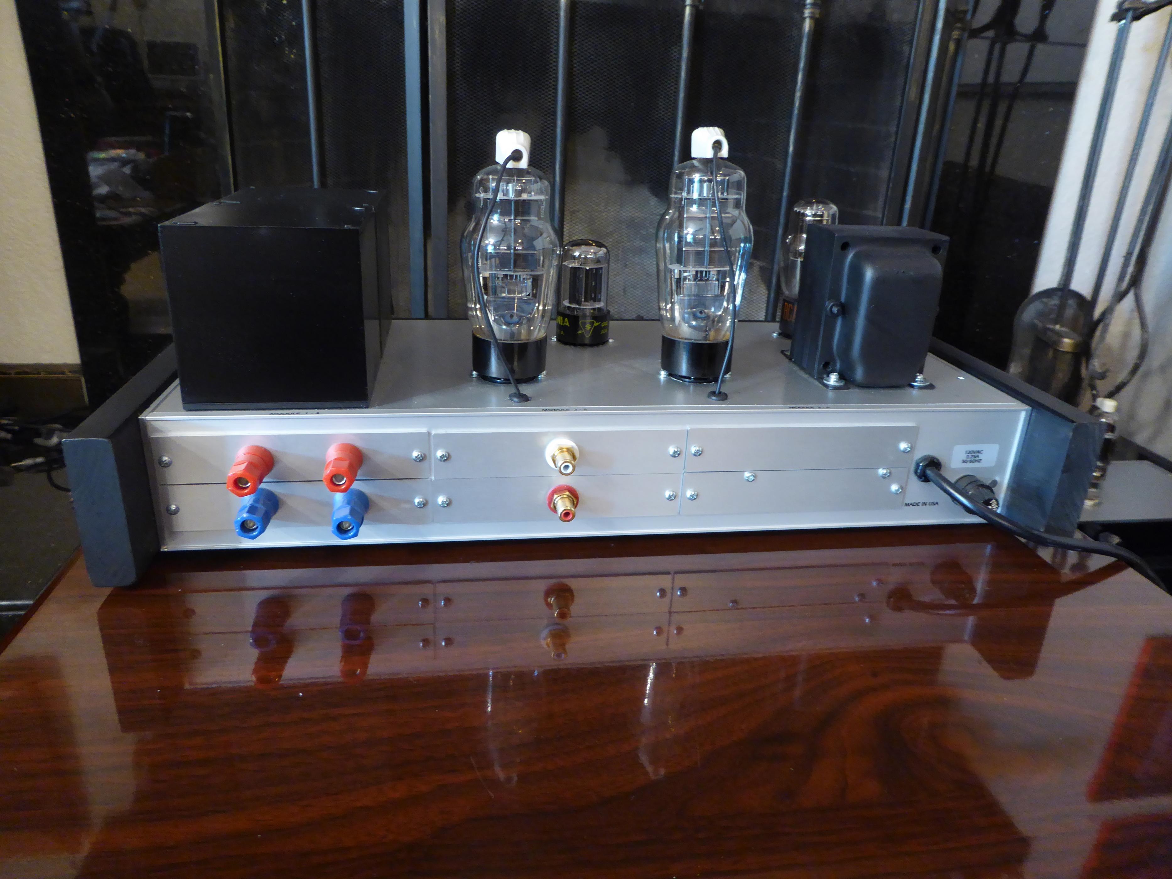

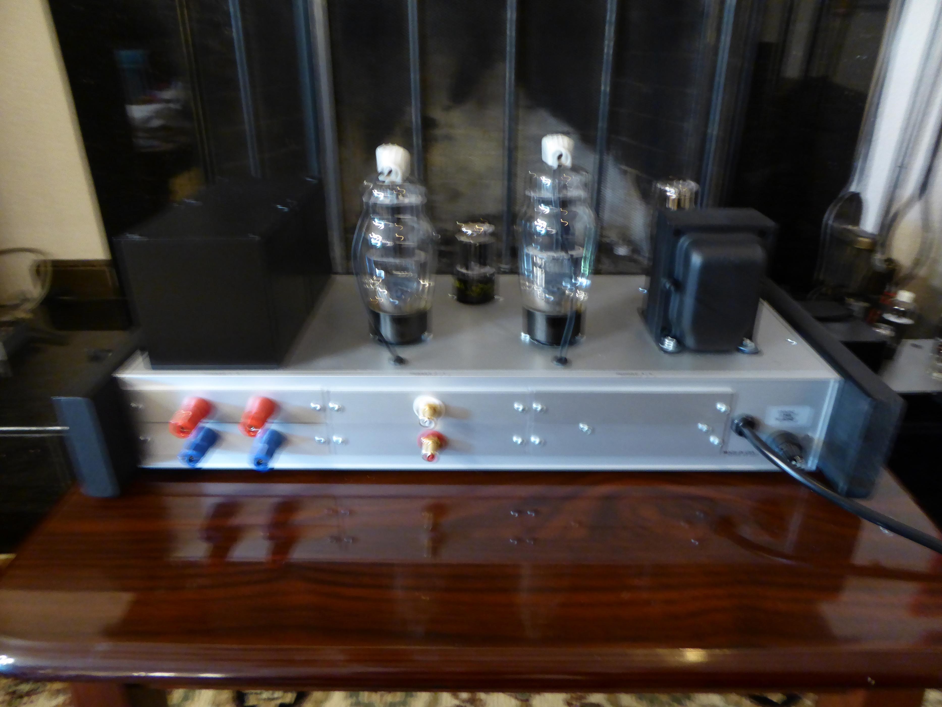

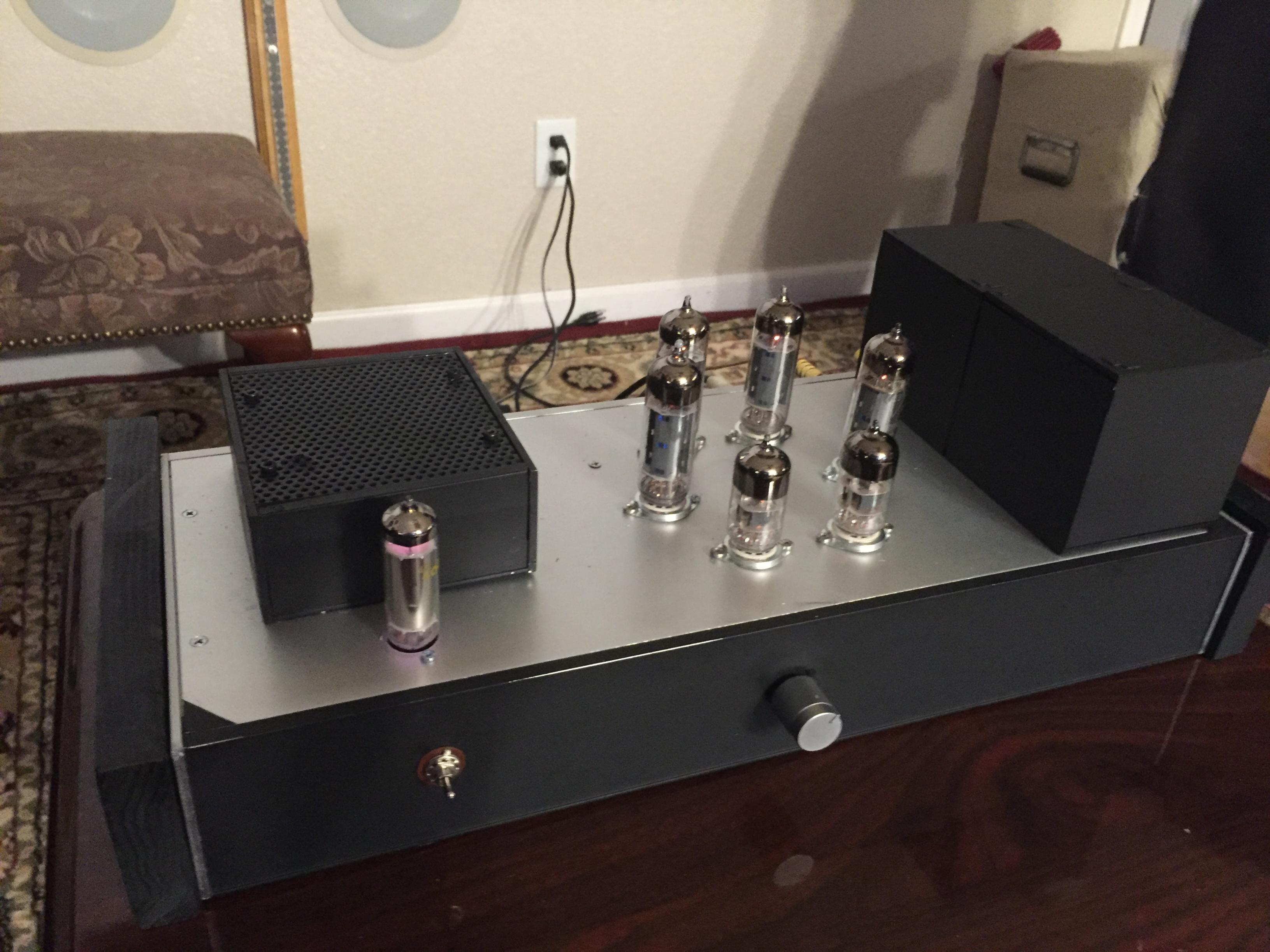

We've made a bunch of amps already. ;-)

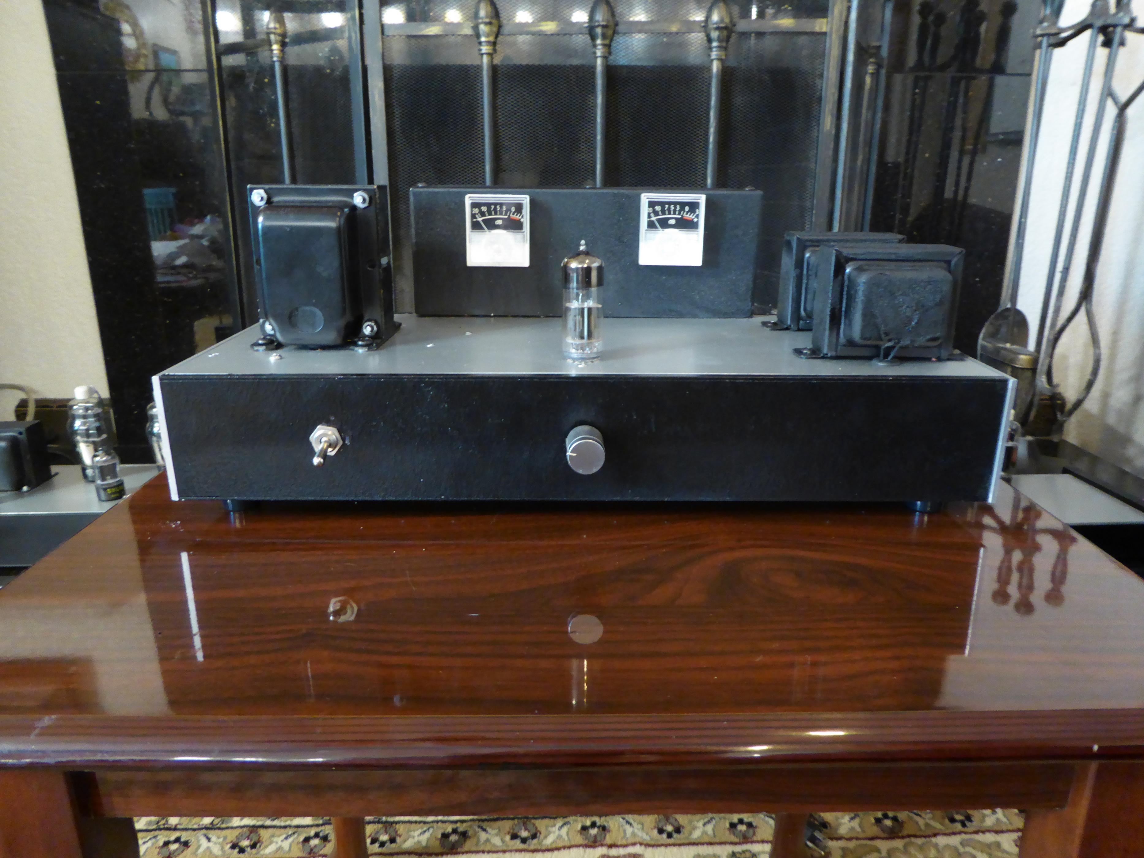

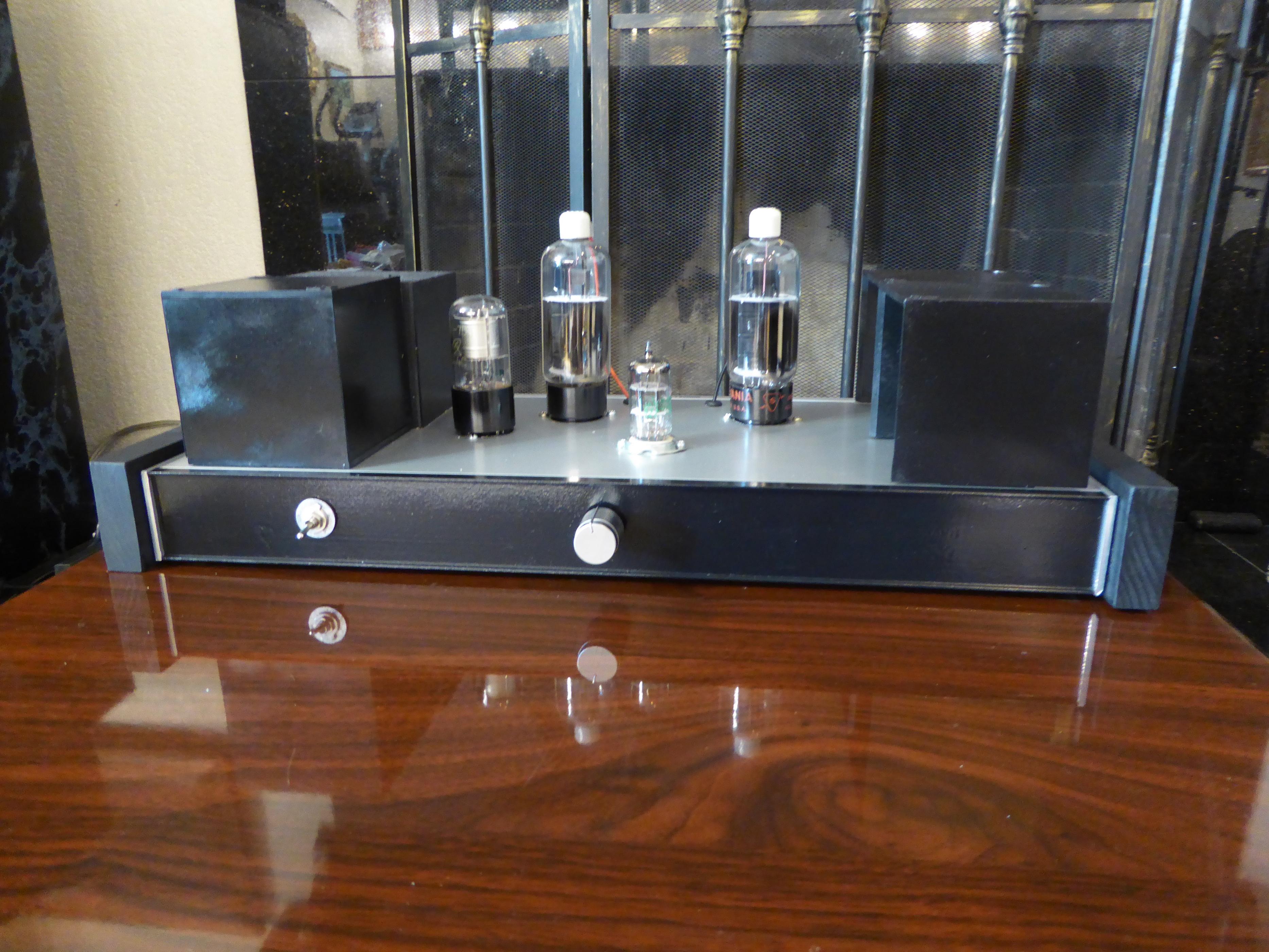

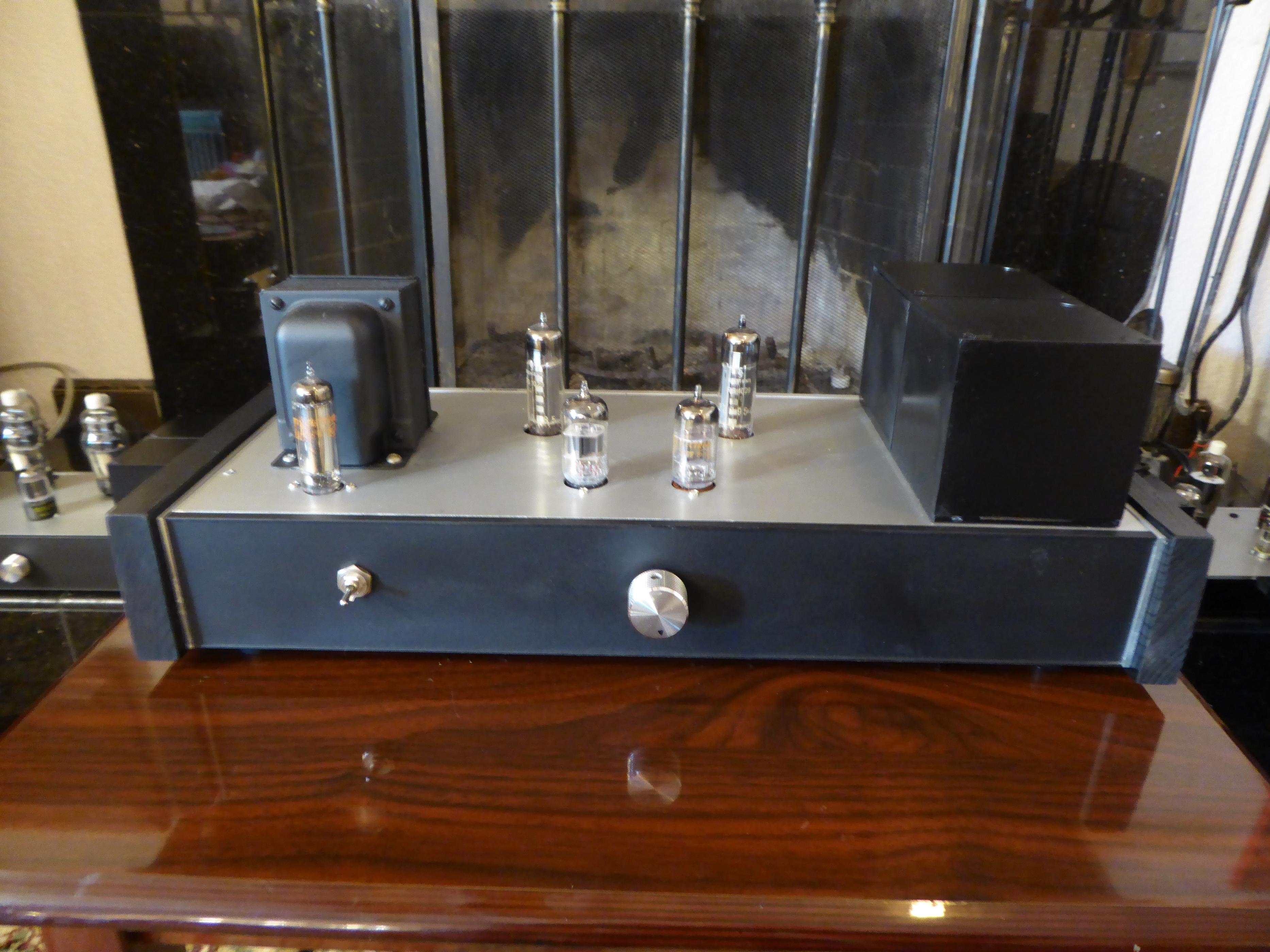

...and some more pictures...

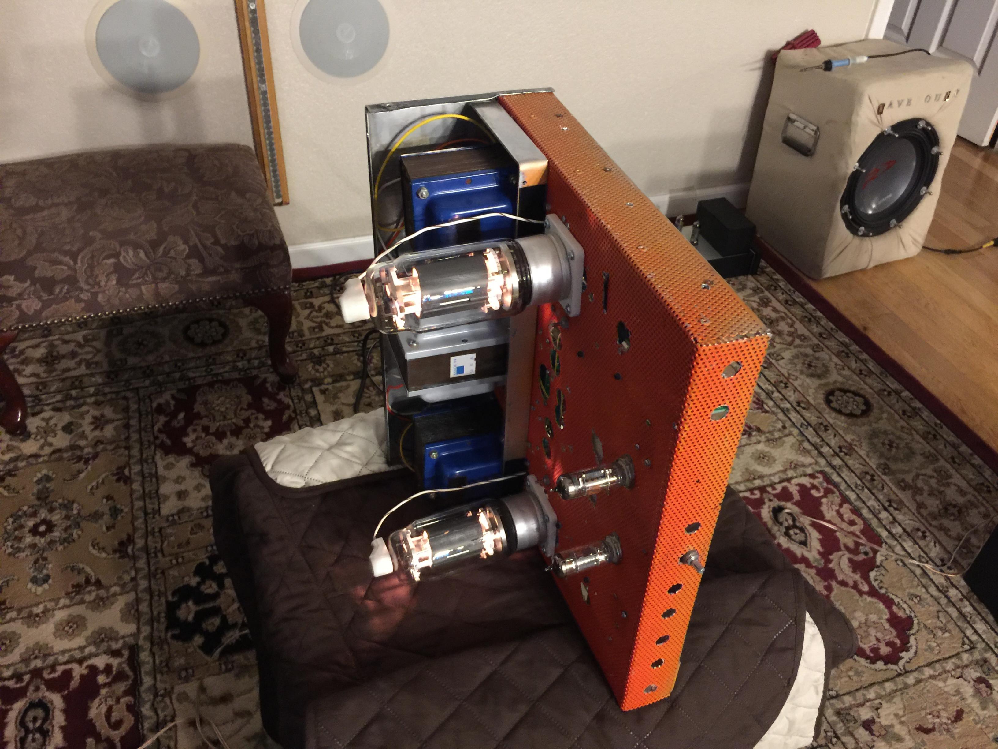

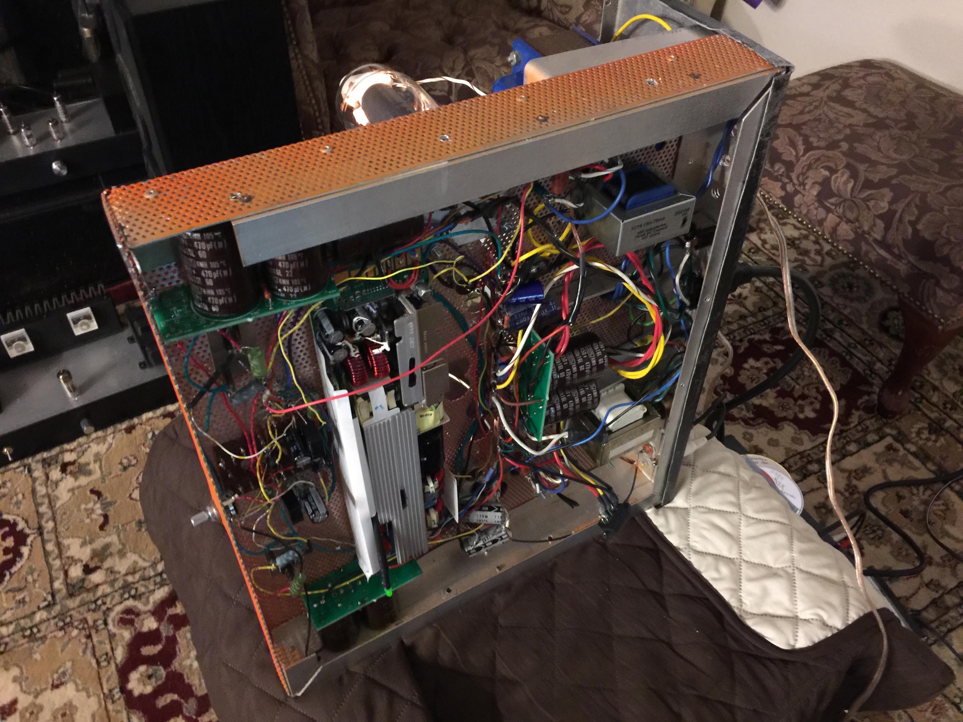

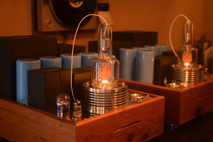

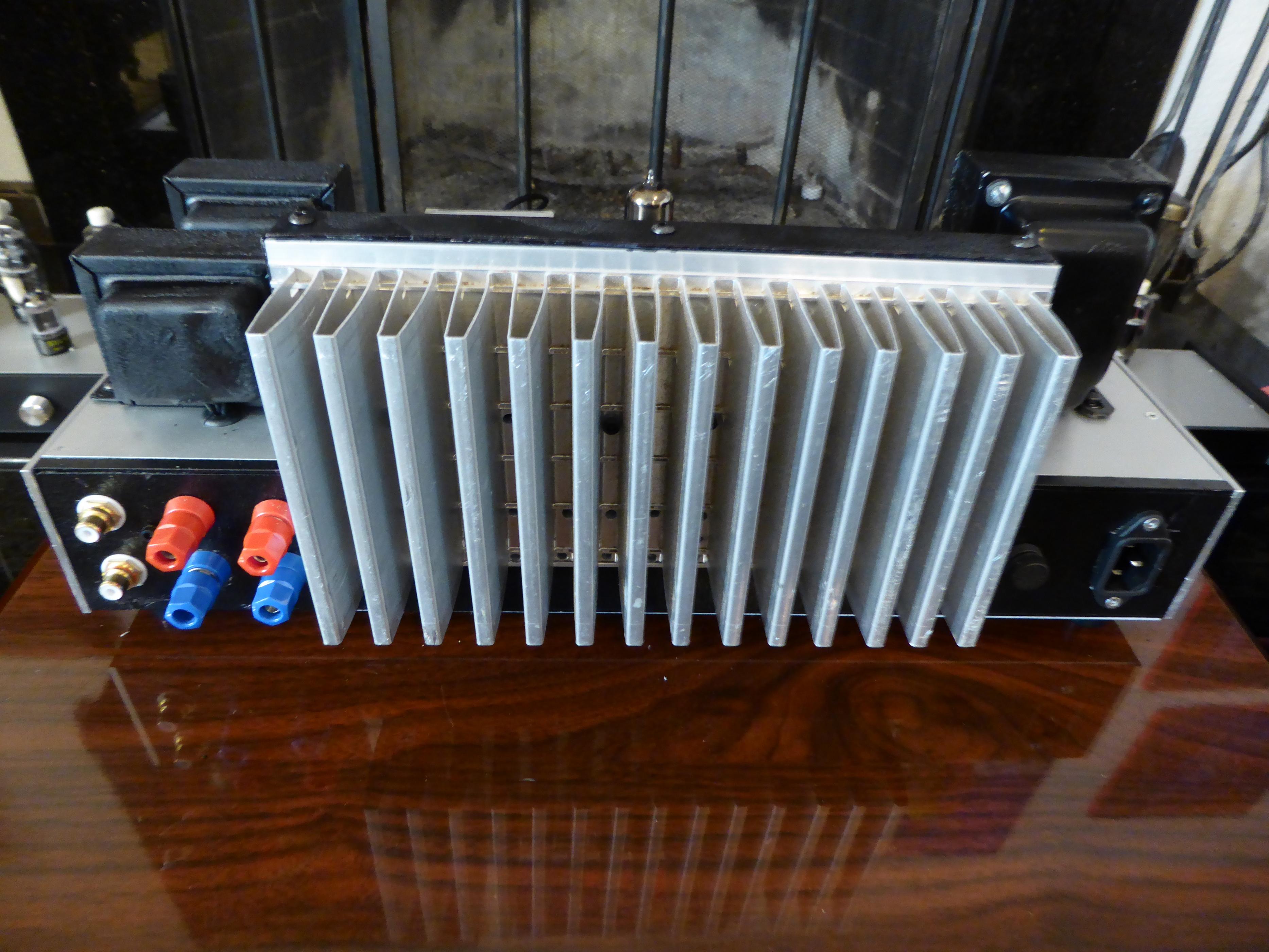

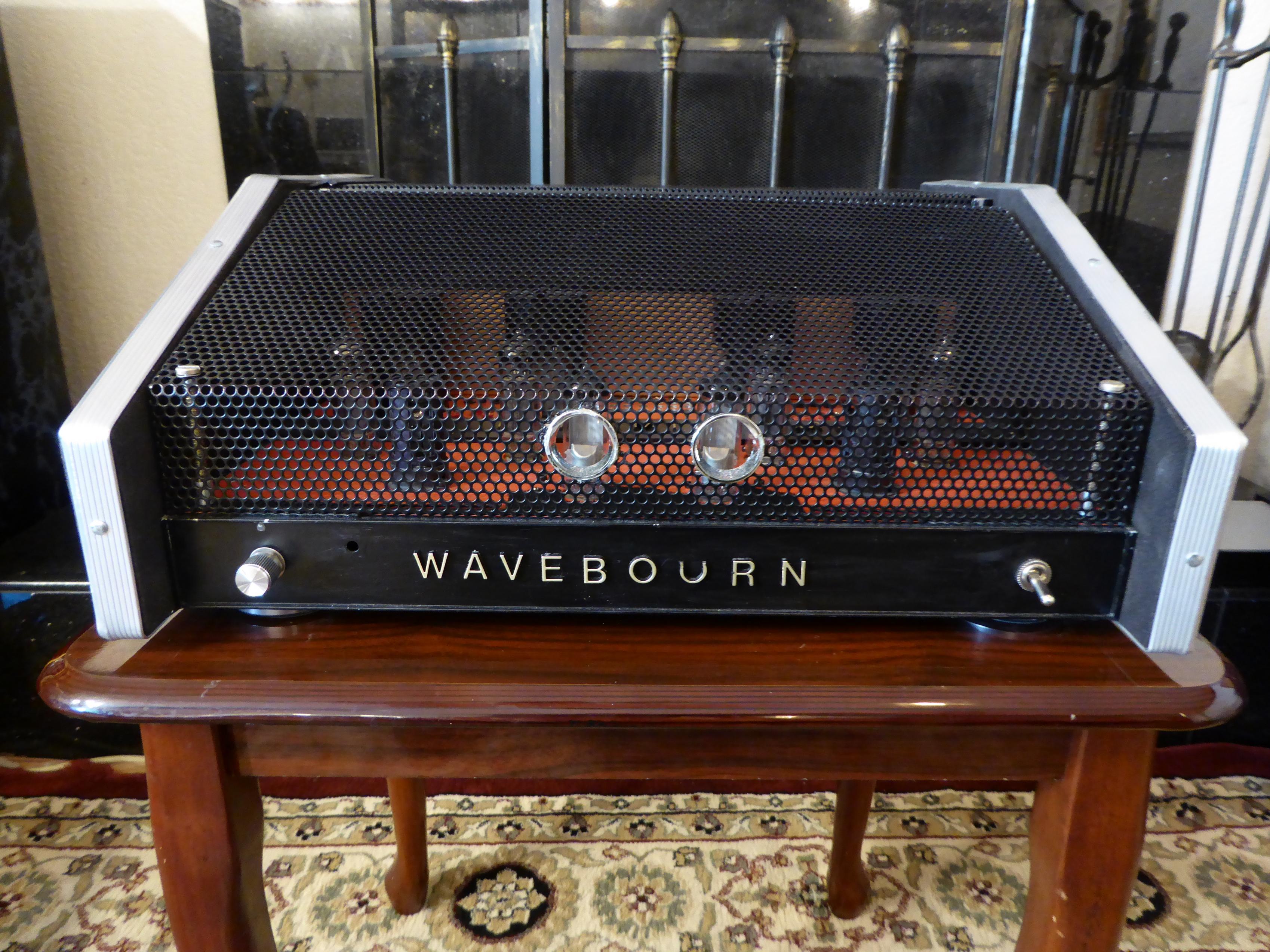

Just a head up about directly heated tubes, you may want to avoid running them horizontally. The filament can sag and get closer to the control grid. In some cases you may operate the tube with the filament aligned with the vertical plane to avoid the sagging but either right side up or upside down would be best.
Thank you my dear for the wisdom, but a server PS designed for strong forced air refuses to work in horizontal position, so I had to put it such a way in order to test. The filament fortunately is hung on good springs so nothing bad happened. 😛
Don't worry, I will run it properly as soon as the cooling problem solves. 🙂
OK OK, I surrender!During a month? 😉
To daqwin_carter: it is also an aestetical issue; tubes look better standing up.

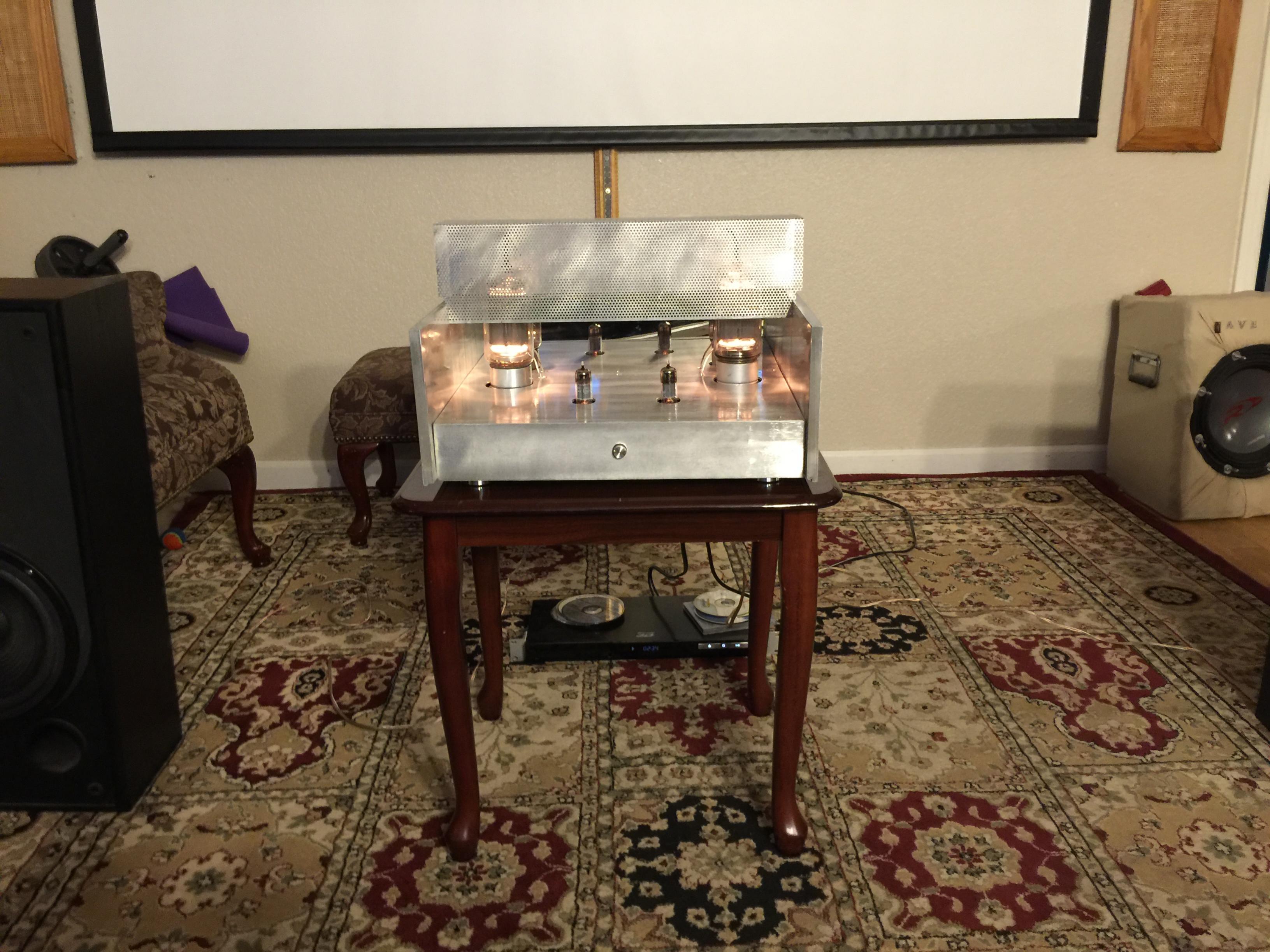

Could you give a few details, ampage voltage?
Sure 🙂Could you give a few details, ampage voltage?
it is class A 60 watt amplifier.Anode voltage 1060 volts 120mA.All transformers
custom made by Monolith magnetics.
cabinet wood recovered from 100 plus years old oak barn 🙂
