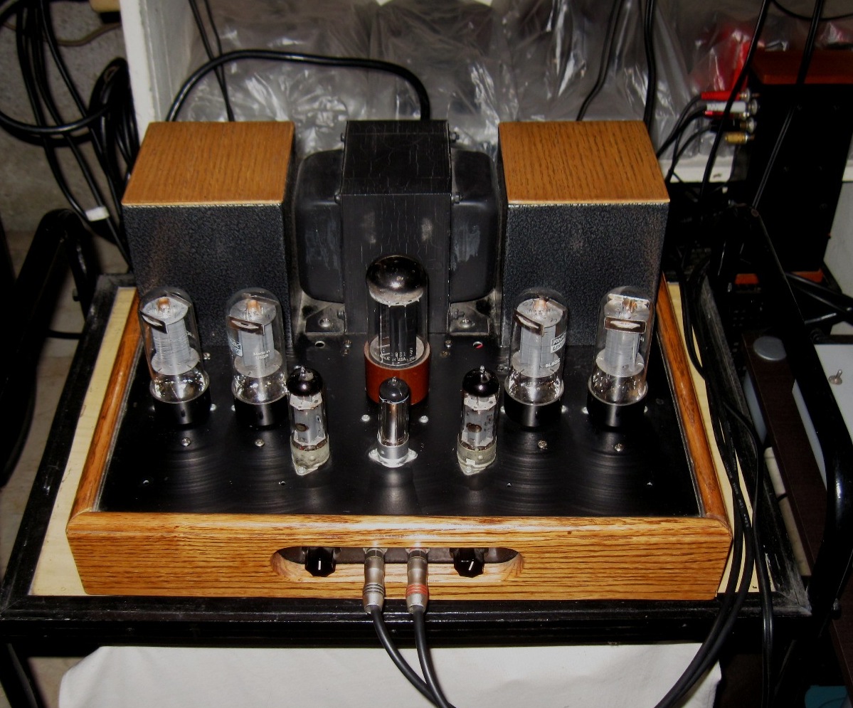

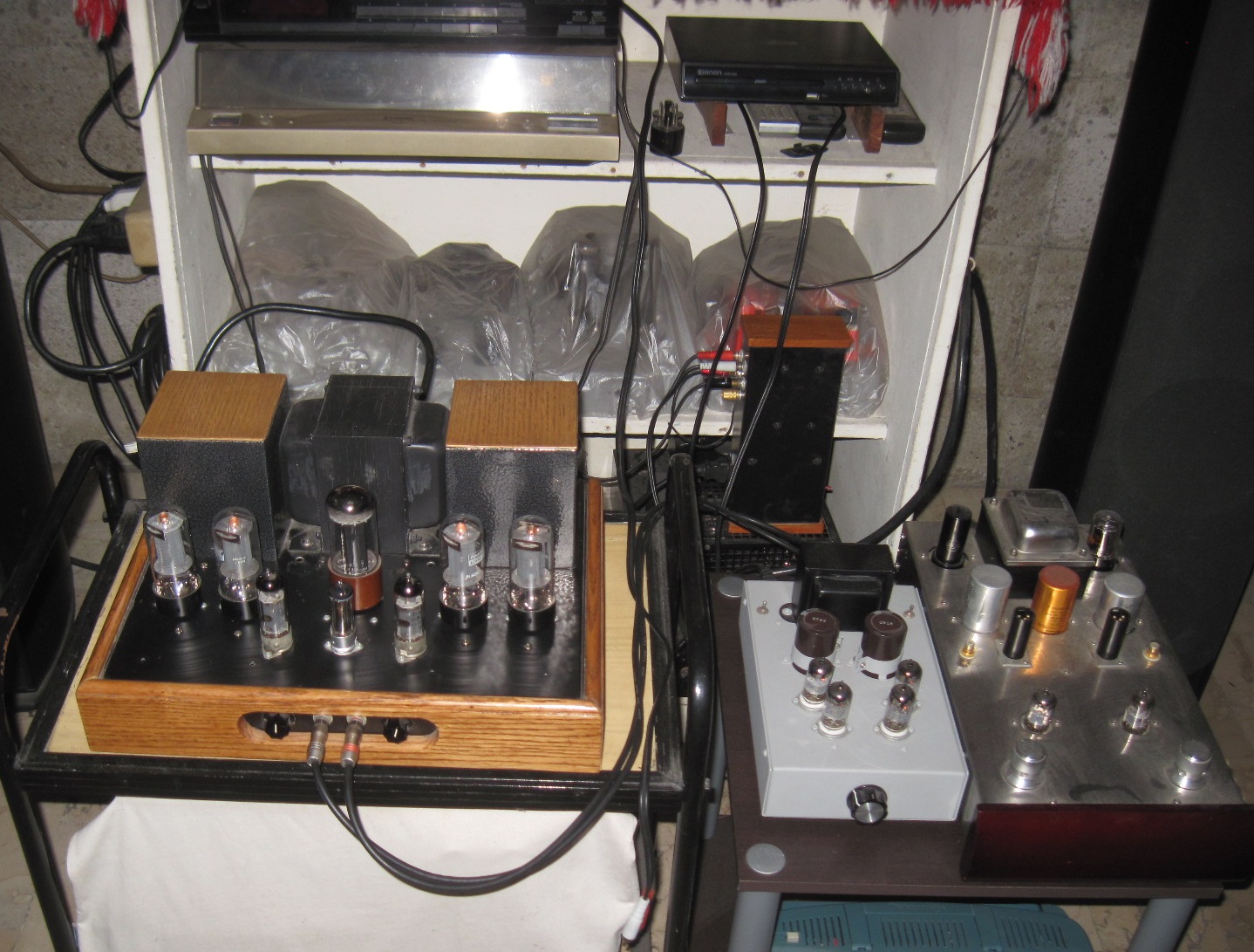

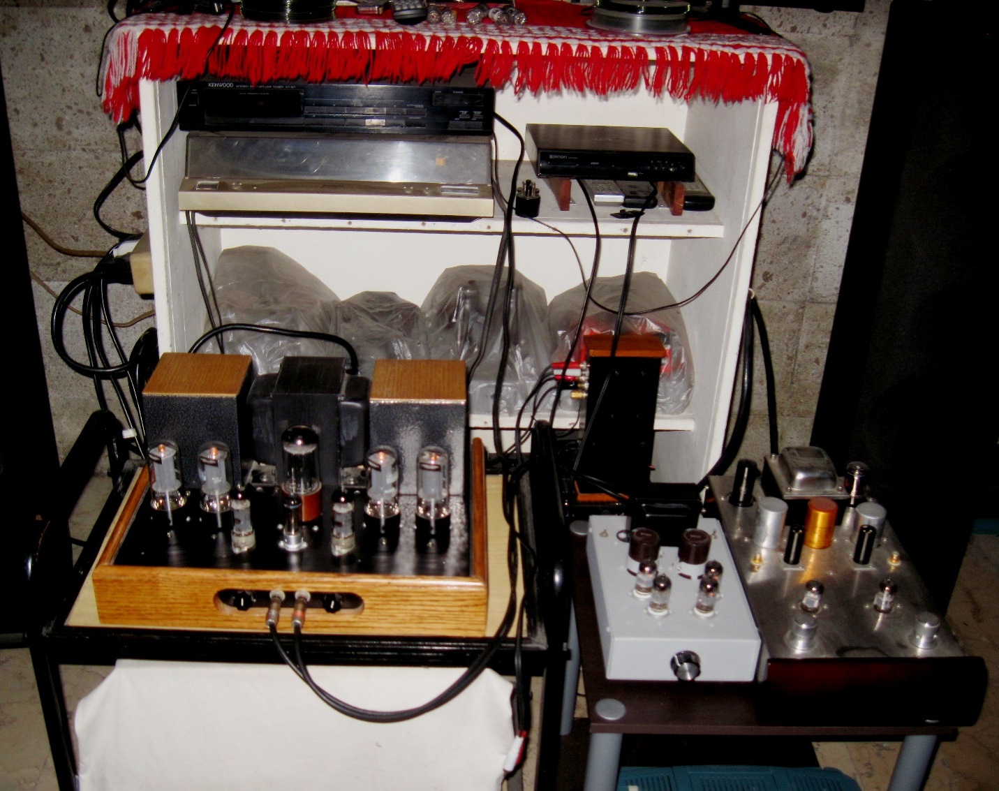

lazy saturday noon listening to my newly rebuilt triode
wired 6L6 Pset driven by6BQ5 pentode at input.....
Rubber Soul, in one of my favorites from the Fab4.....
each 6L6 biased to about 15 watts of plate dissipation....
total power draw from the line is about 160 watts.....
tony, is that an unusual set-up to drive a 6L6 using el84 since el84 is also considered to be an output tube.
power tubes can also be used as small signal tubes, nothing unusual about it....
when so used, they run very long lives...
btw, i made the OPT and power traffo for this amp....

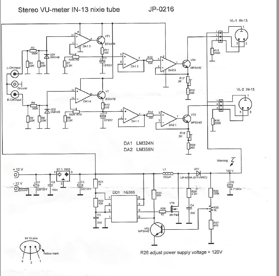

Nice Amp...can you share the IN-13 VU meter schema?
Thank you very much...i have a dozen of them so now I can use them as extra added attraction to my GK71 PP amp..

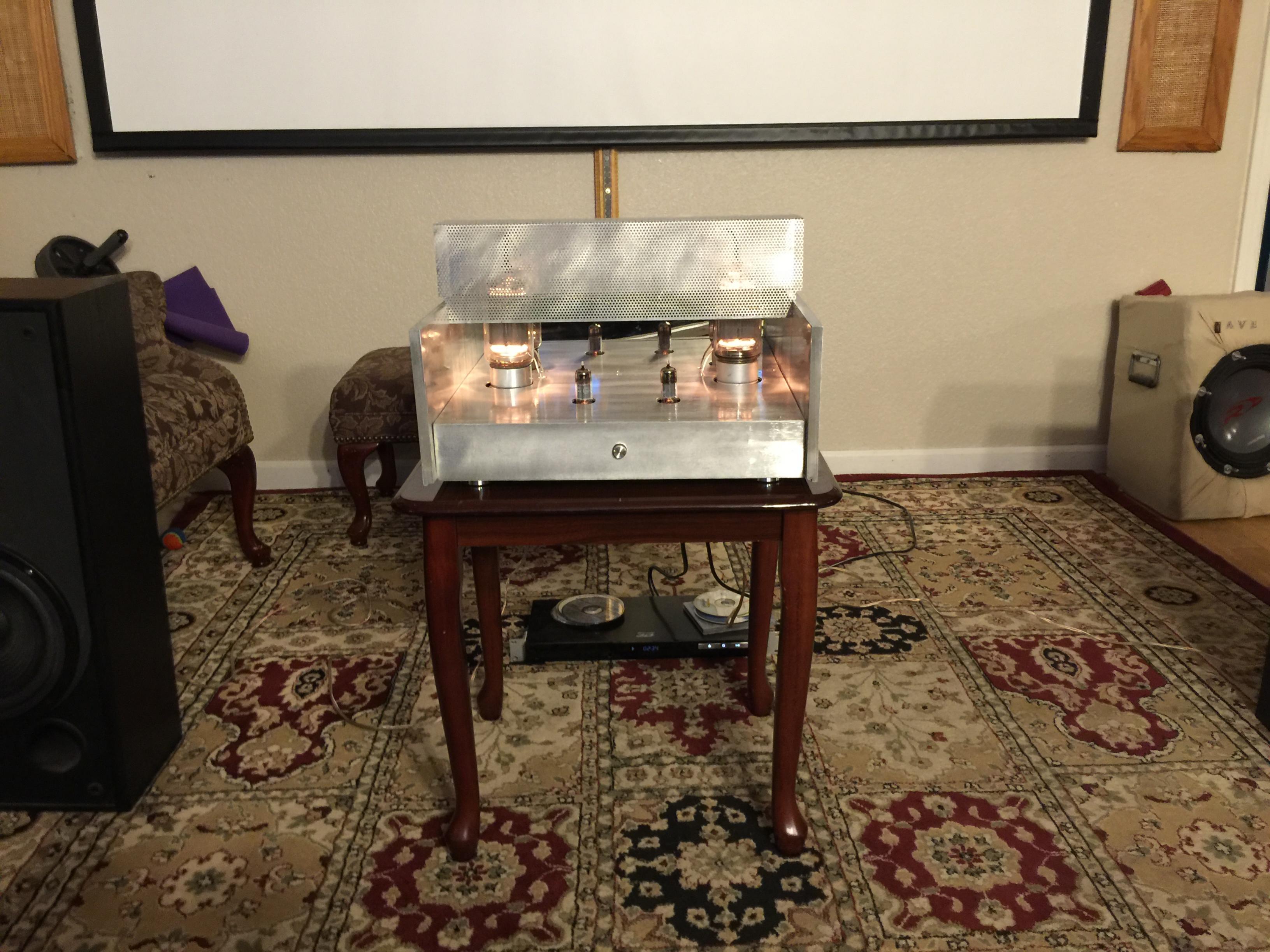

Here is a new amp playing:
https://www.facebook.com/Wavebourn/videos/vb.371503329574641/1148575651867401/

Very nice.deep bass

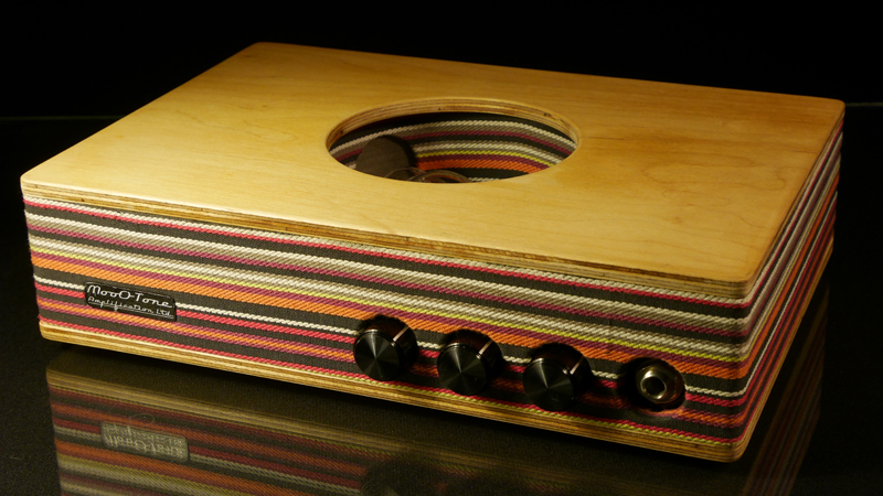

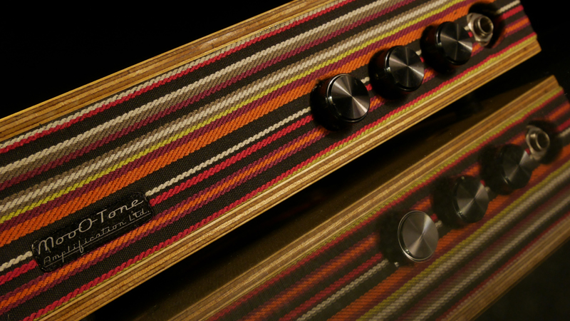

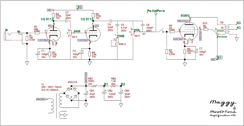

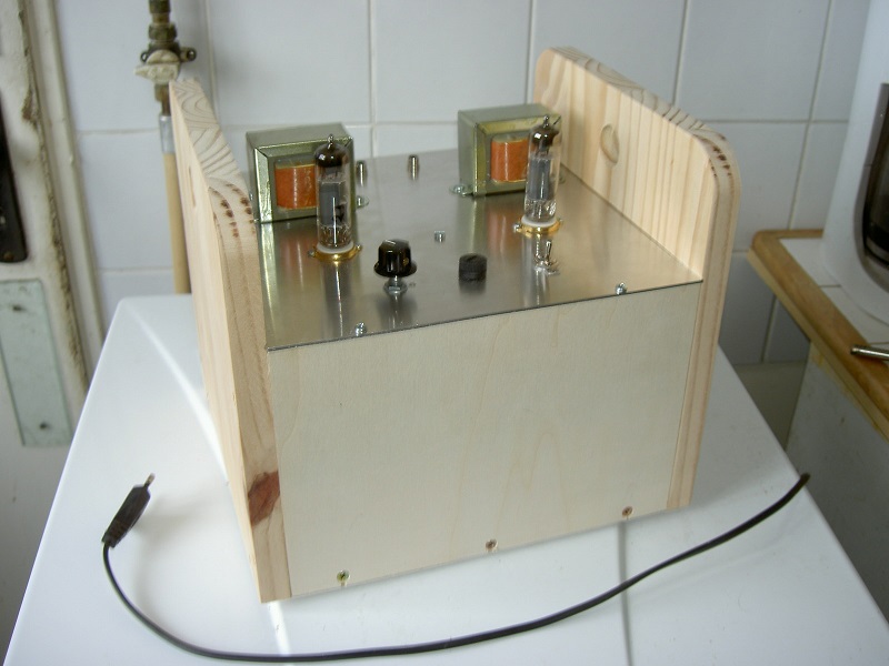

DIY Micro Guitar Tube Amplifier
Work in progress needs tuning... (but i think it will remain as is...)
Preamp runs cold. Needs tuning for more current and a bit of more 3rd harmonic.
It uses a 6112 tube for the preamp and an 6G6G tube for the "power" section.
Bonus Video, enjoy! 🙂
https://www.youtube.com/watch?v=CSizkeTcDNU
Every nice, I like the cloth surround. I built a Fender champ which is just as easy as this one. It uses a 6V6 and 12AX7.
Standard tubes give you standard sound....Thank you mhouston. Yes a 12ax7 with a 6V6 i think is the "standard" for home use.
Yes, especially 12AX7 which is standard for guitar amps.

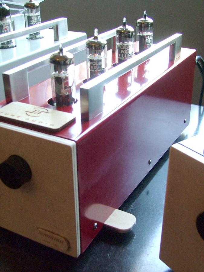

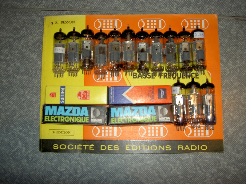

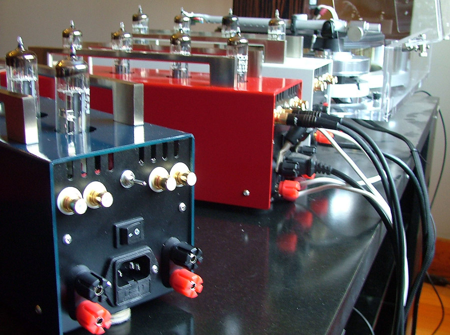

Little compact design using PCL86 tubes for 2 x 10W/channel class A. 😎
Very very nice. Could you share schematic?
