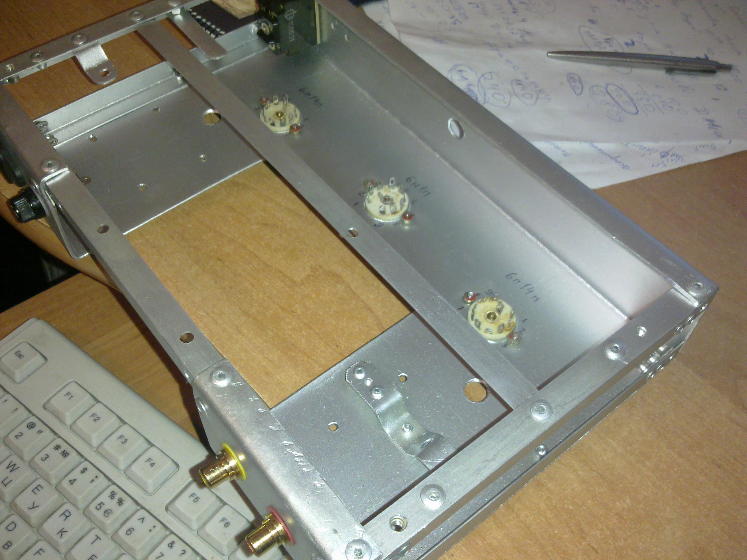

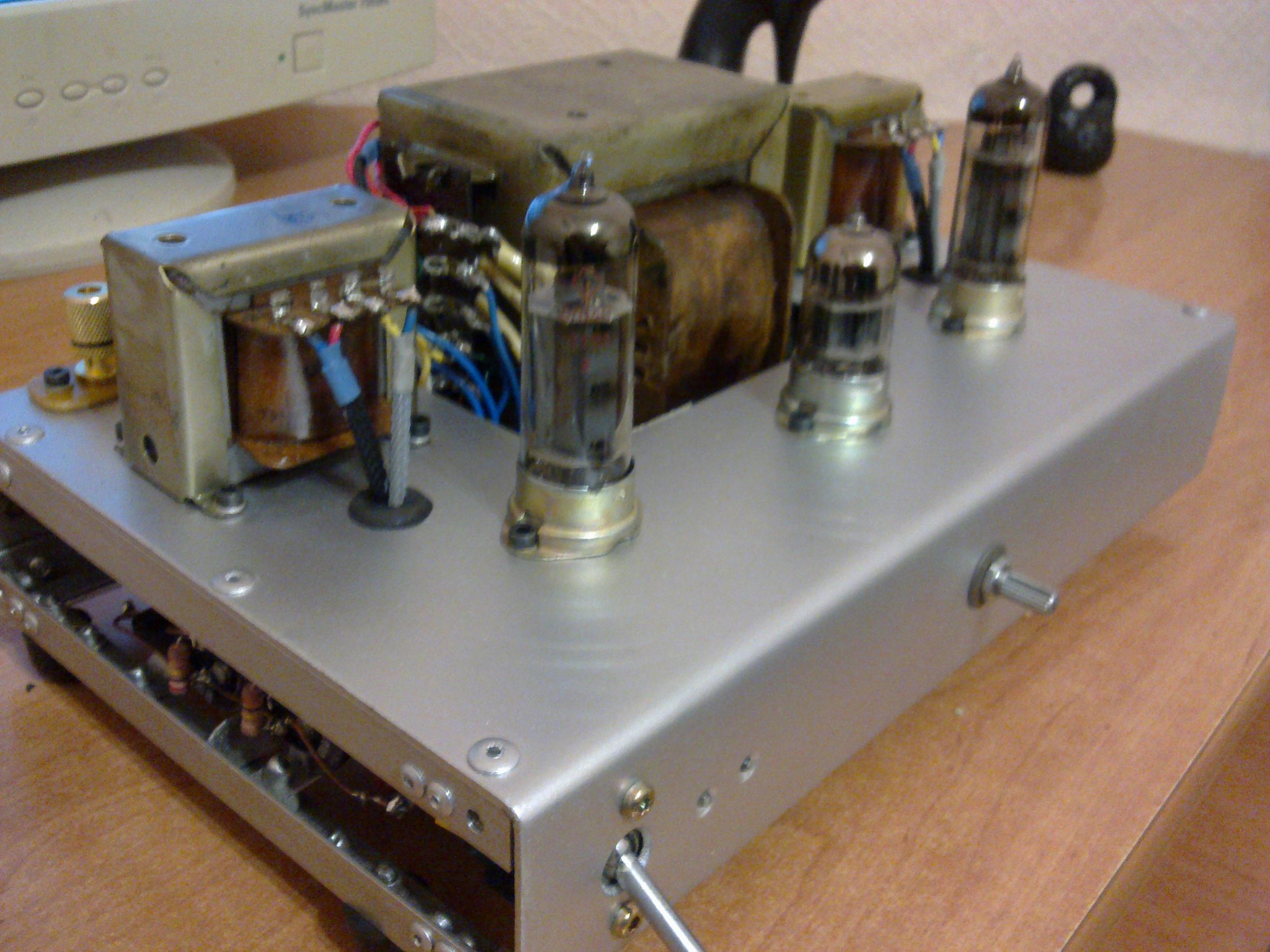

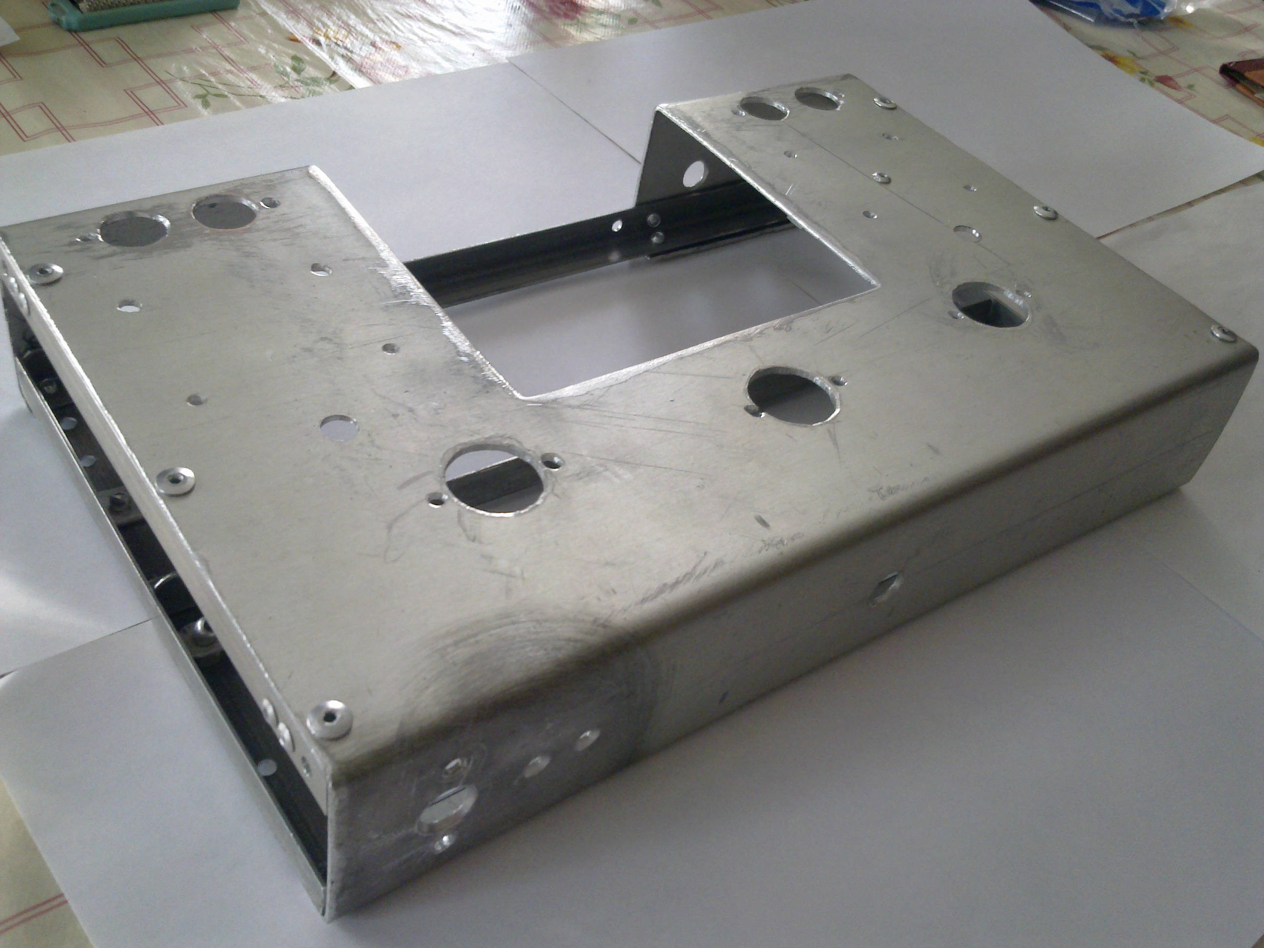

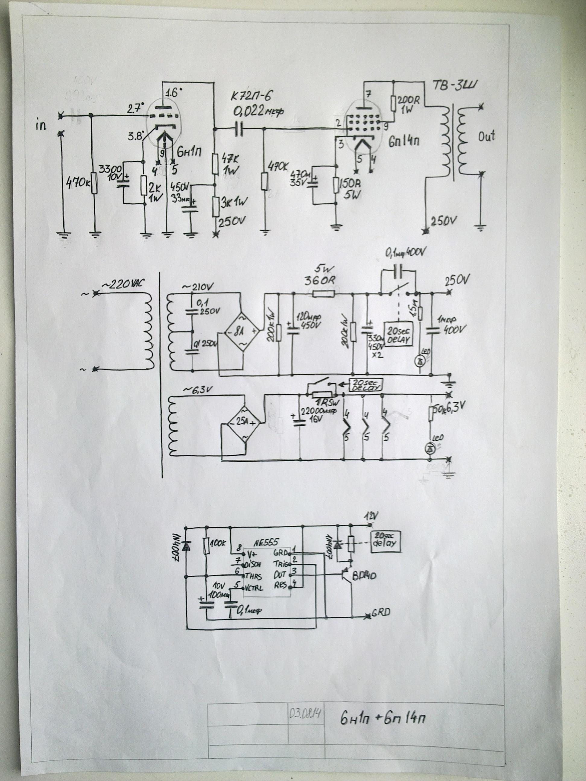

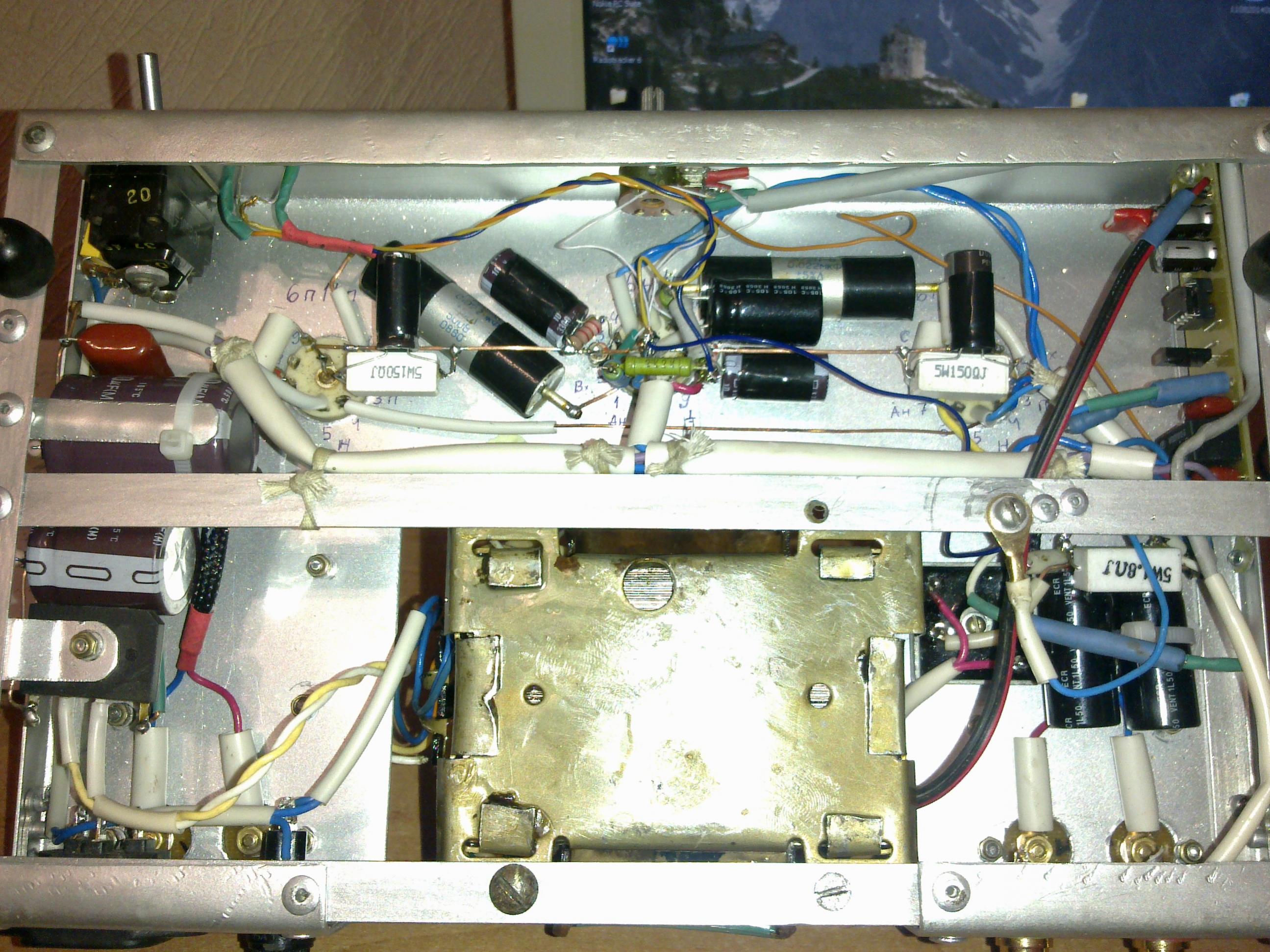

6н1п+6п14п SE без оос

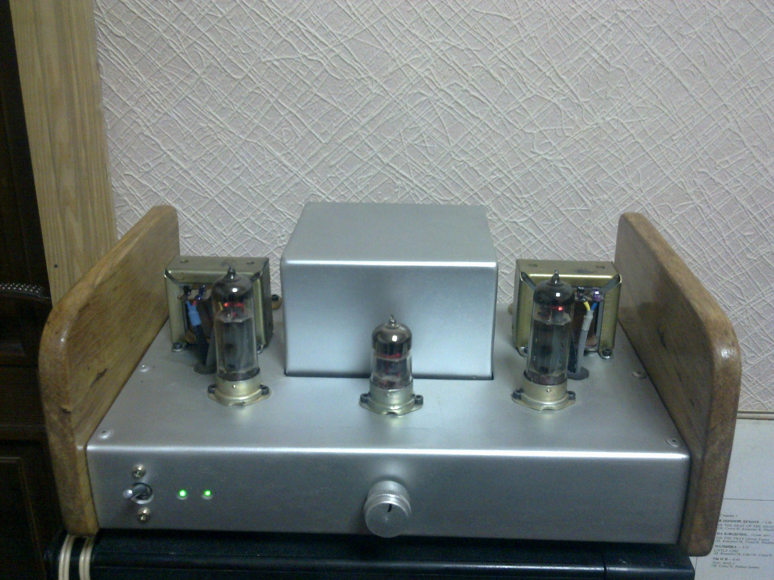

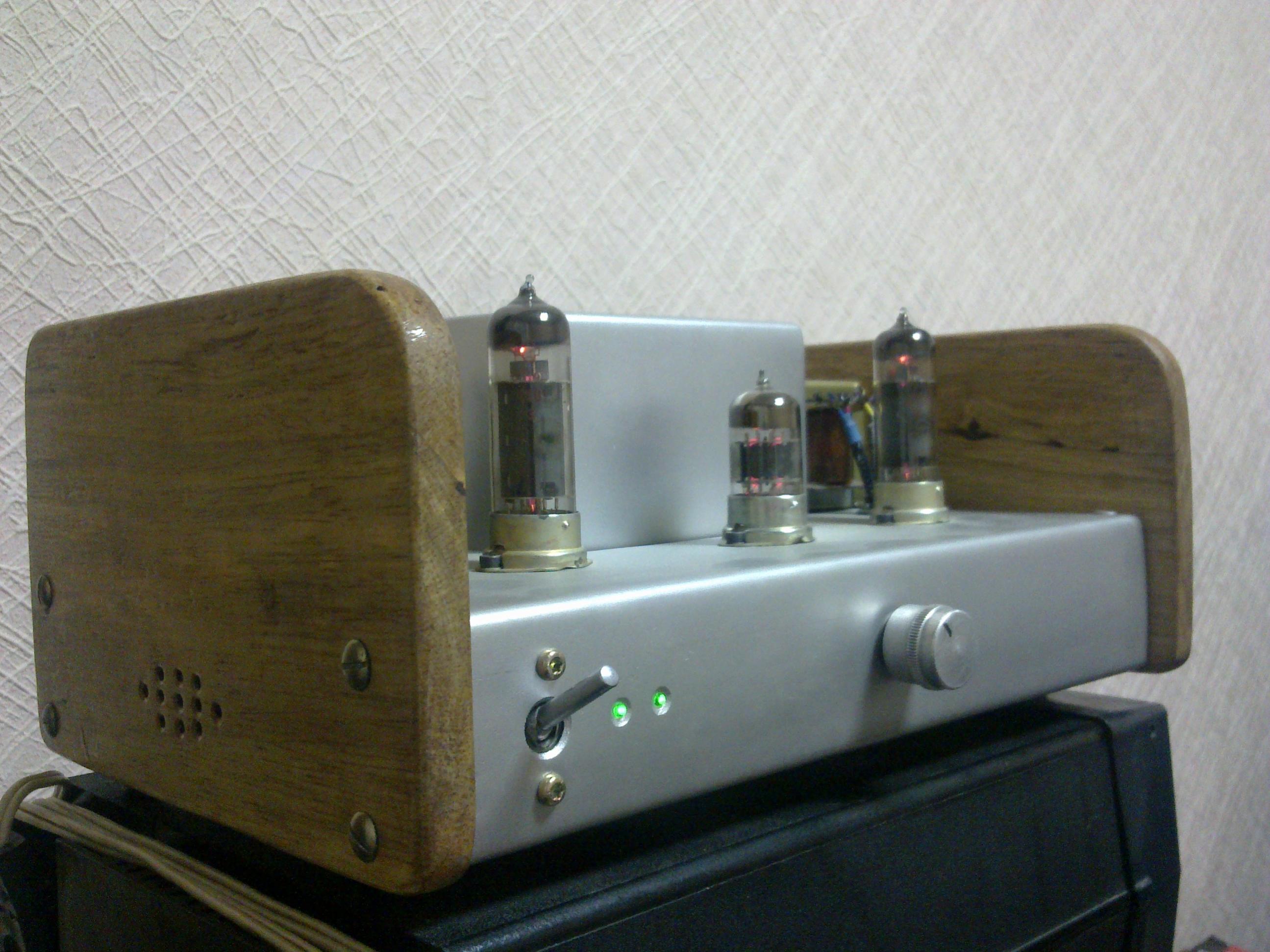

How does the amp sound?
I have built some el84se and ecl 86 , but i am not satisfied with the sound. I used some opt who came from some old radios...
Hope the ukrainian people will get some peace soon!!

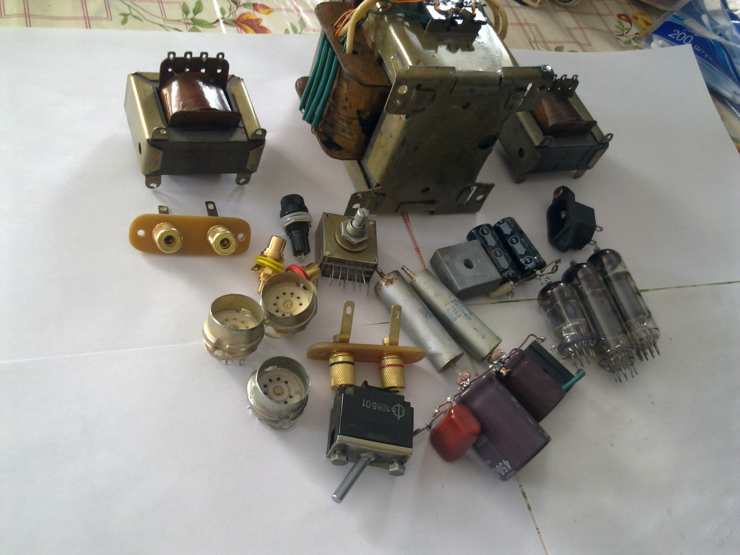

sound quite happy, this is the first tube amp, built on the ruins of the old tube TVs, and by the way the construction itself cost a penny.
I like the aircraft switch
congratulations
congratulations
yes definitely noticed the switch from an 26

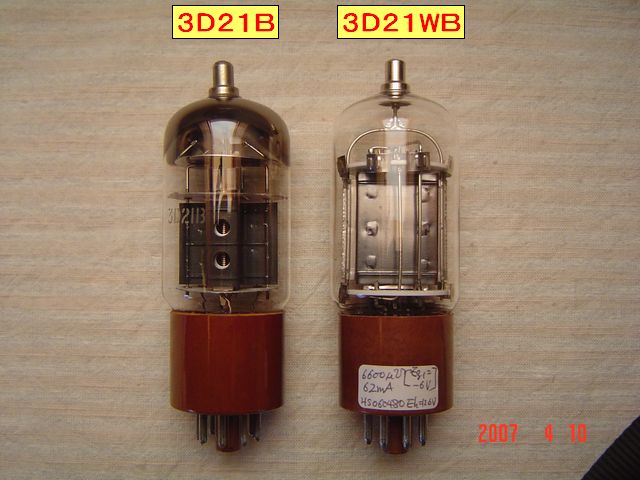

3D21b AB2 amp
3D21B AMP;
Does Anyone have the data for the 3D21B; I can find 3D21, 3D21A, 3D21WA,3D21WB, but not 3D21B.
The 3D21 has 15 watt plates the 3D21WA, 3D21WB have 40 watt plates, I have no idea what the 3D21B has

http://frank.pocnet.net/sheets/201/3/3D21A-B.pdf
15W plates.

I have lots of NOS 3D21WA/WB but all of them are Gassy none of the 3D21/3D21A, 3D21B are.

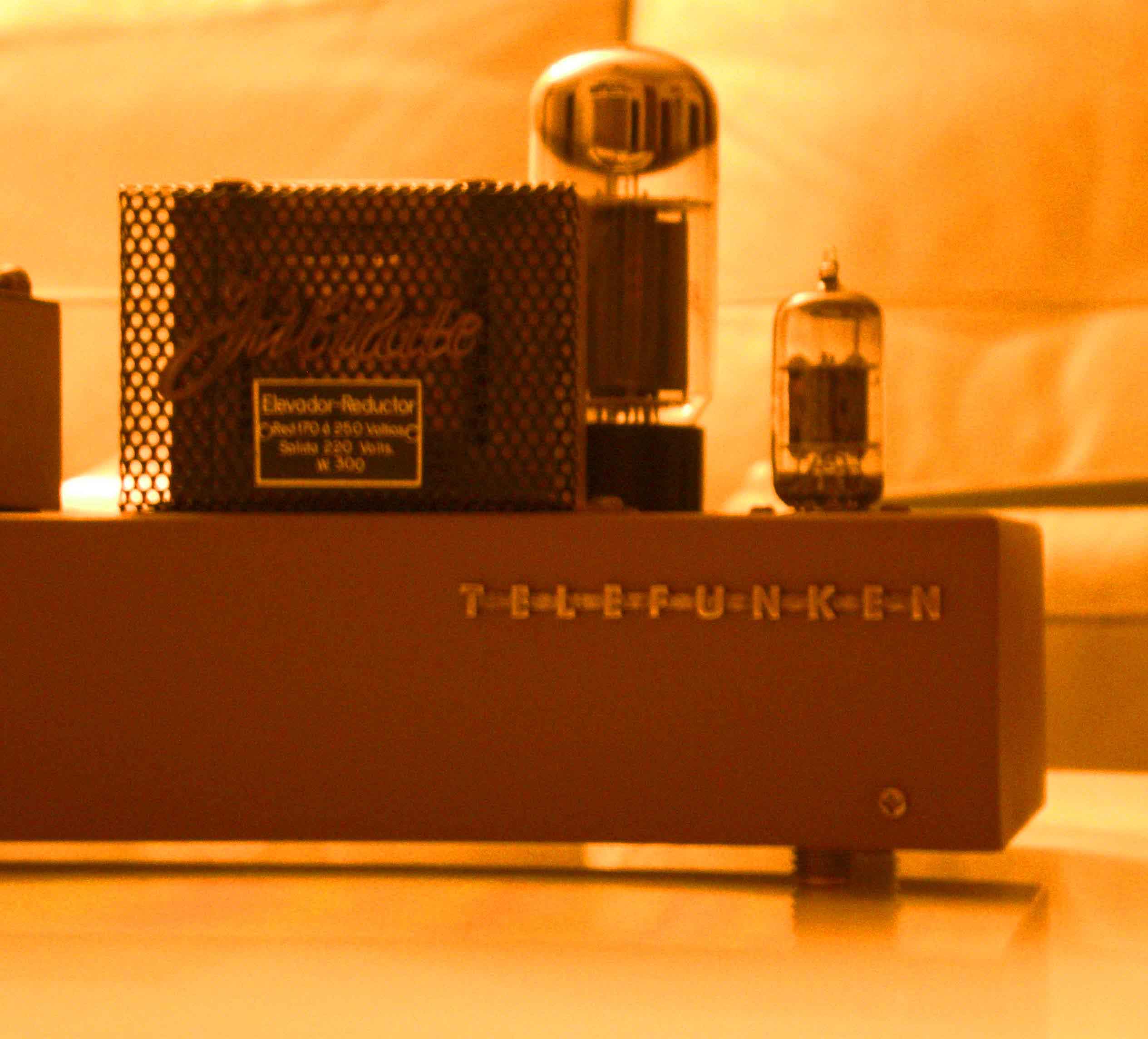

This one looks really nice, especially if you like vintage amps like I do. It looks old but it's just an illusion. I should take better pics for this one and maybe open a thread to explain what it is all about. Maybe someday.

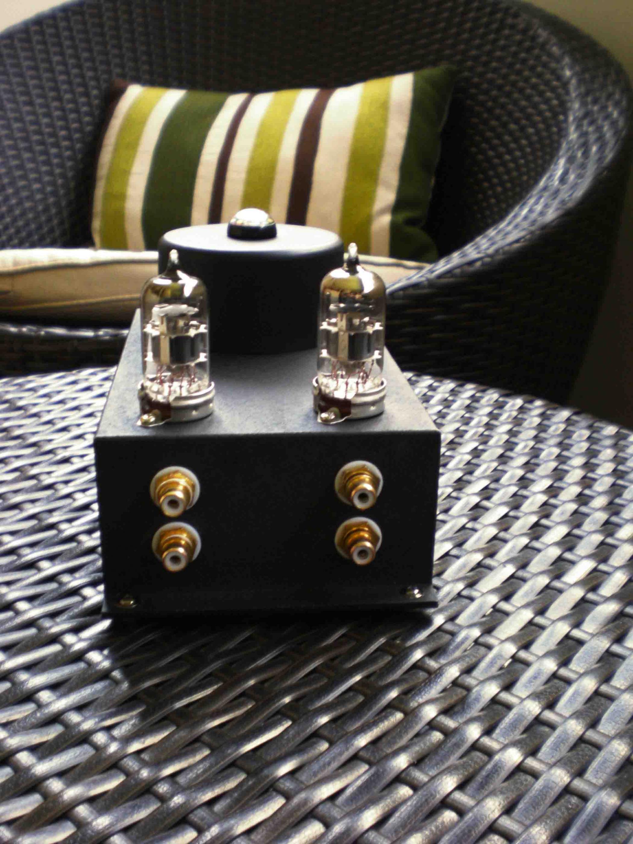

Oh I forgot...

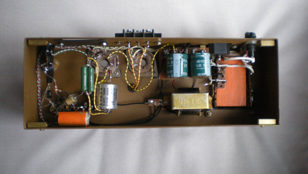

I built this phono pre for a friend, nothing fancy, just a quickie. Anyway, he's pretty happy with it and listens to records everyday. He's weird this friend of mine, only plays singles. No LP's no CD's ....huh? Pre sounds pretty good. 6DJ8's....designed by.....oh I forgot his name.

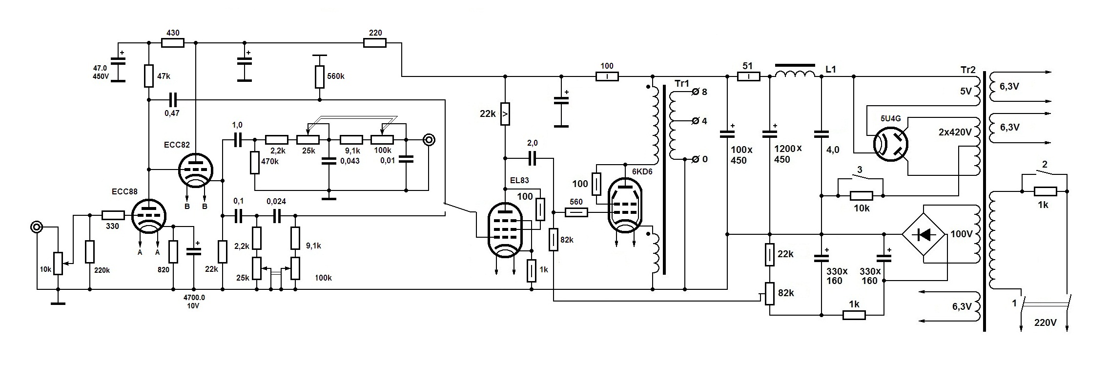

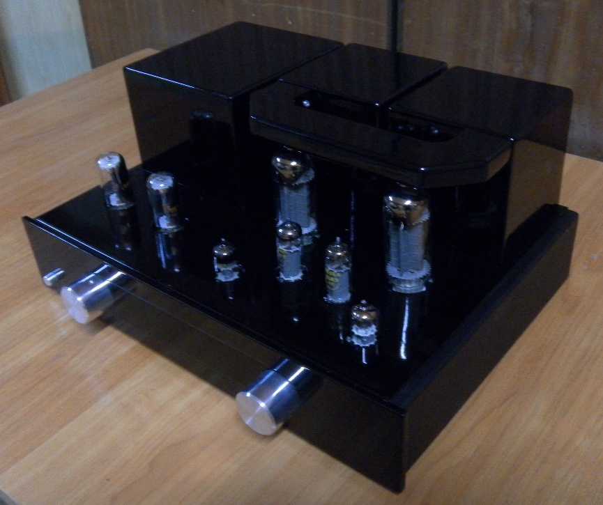

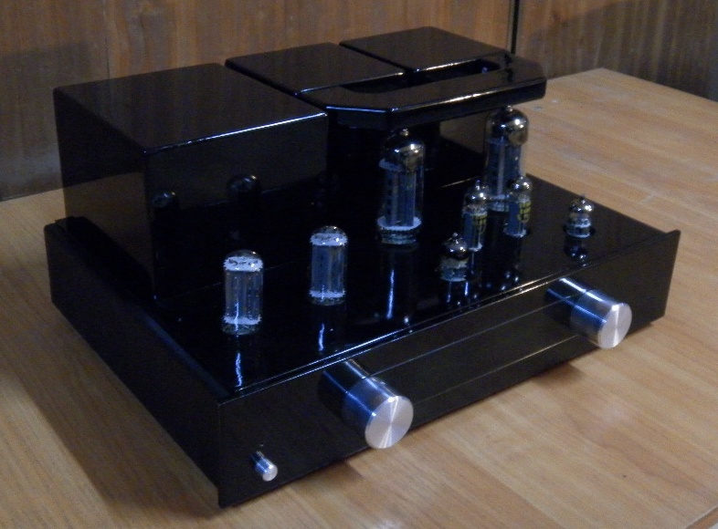

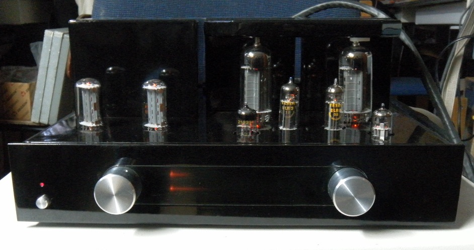

My SE ECC88-EL83-6KD6 amp.
Very nice finish....is you 6KD6 in triode mode? do you maind sharing your schema?
thanks
thanks
6KD6 included in triode mode.
Amplifier also includes two way crossover.
