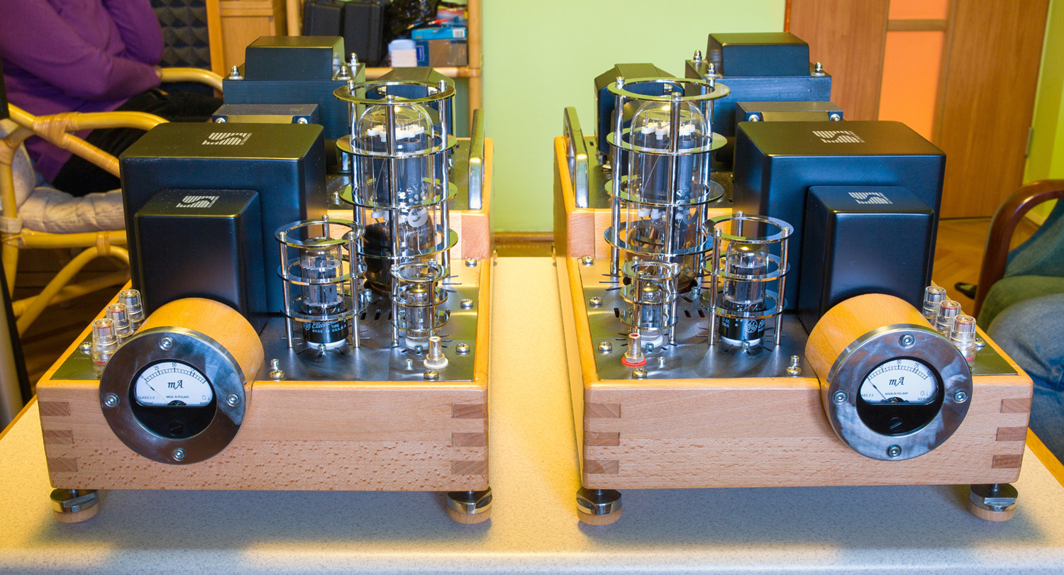

Hallo,
This is revamped version of my baby twins.
OPT transformers/chokes from SAC Thailand included!

Must sound as good as it looks. Very nice.
Curious, what is sitting on the cabinet in the second picture in the background?

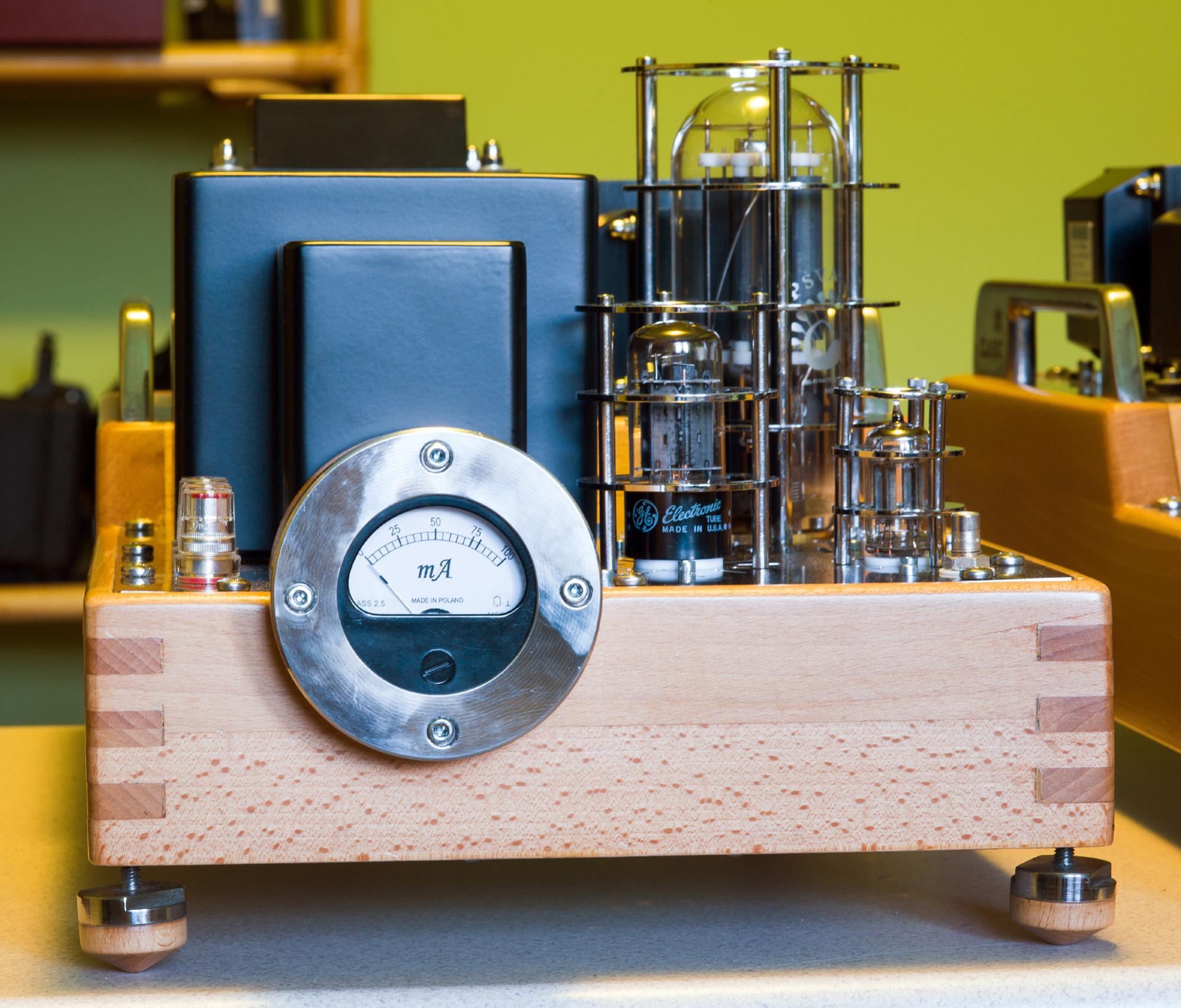

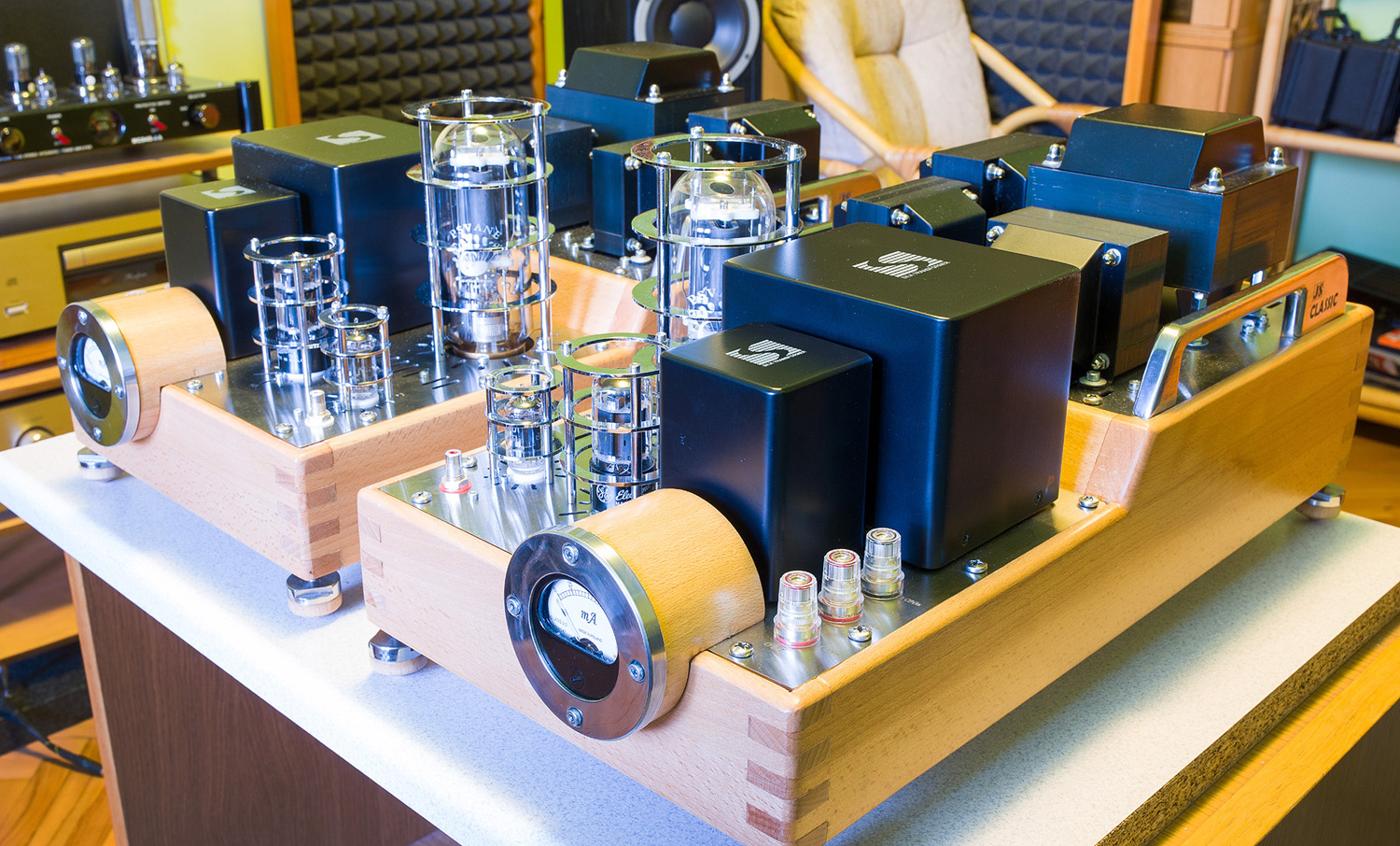

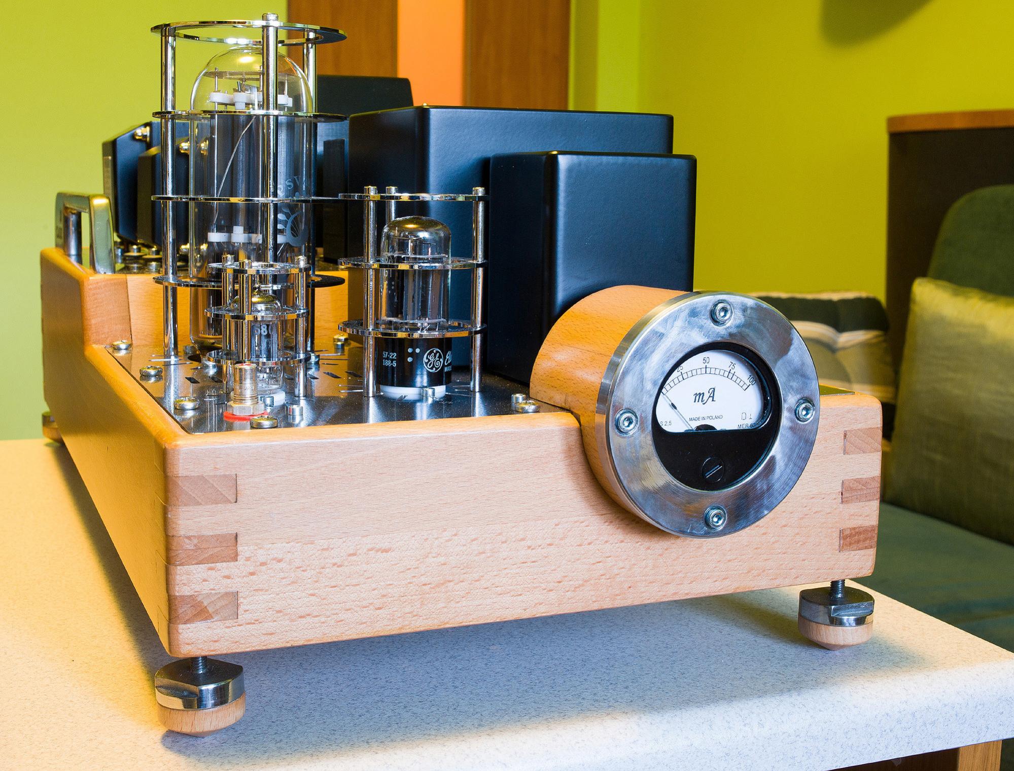

Hallo,
Very nice work...What model are those Silk output transformers? Wondering how it sounded. What's your opinion?
845 twins
The seat is exclusively reserved for my wife.
She likes to study the impression on the dedicated followers of audio faces suffering from audifile nervosa during the audition.
Jarek
Hello overtheairbroadcast,Must sound as good as it looks. Very nice.
Jarek
Hello vt4c,Very nice work...What model are those Silk output transformers? Wondering how it sounded. What's your opinion?
As Hoi predicted:
Bass is rather lean but enought for me.
Middle tone very good.
Cristal clear high tones.
Specs: Pout max=17W,
Bandwidth: -3dB 25Hz, -3dB 32kHz, -6dB 50kHz (at 4Ohm load Pout=12W)
No global NFB.
OPT transformer SILK 5k, plate choke 50H 30mA.
Yes some parts from vt4C too,
Greetings,
Jarek
