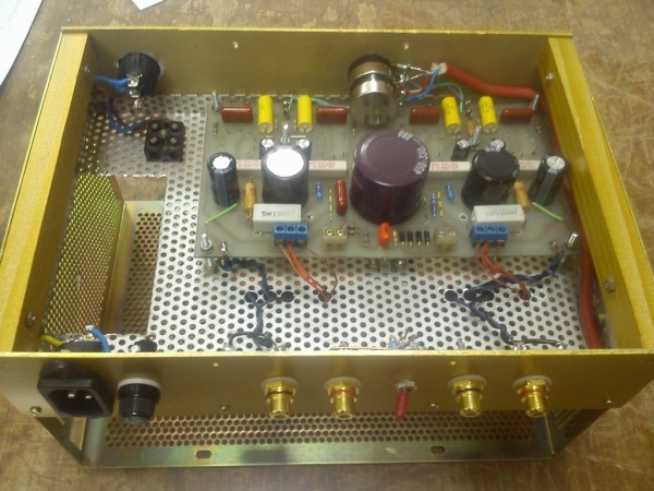

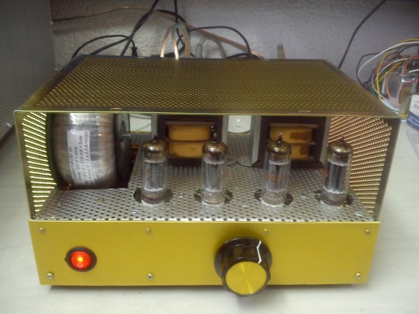

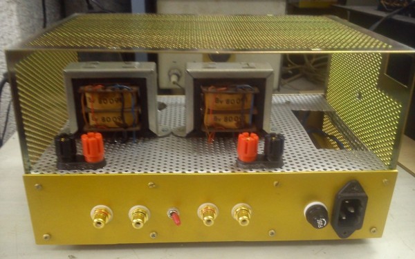

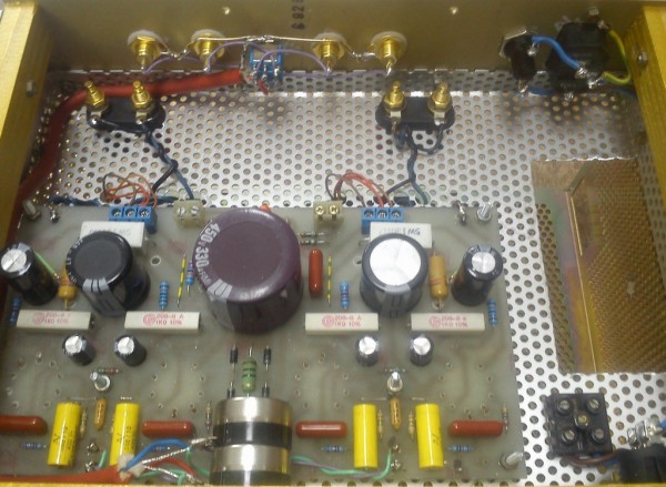

Stereo amp with 4 tubes 6FD7, but 6DR7 works fine also.
Push-Pull output, long tail phase splitter, 2 inputs, and 2x~6W at outputs.
Very, very creative use of interior space and metalwork...

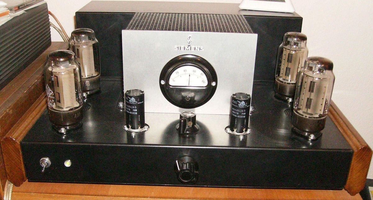

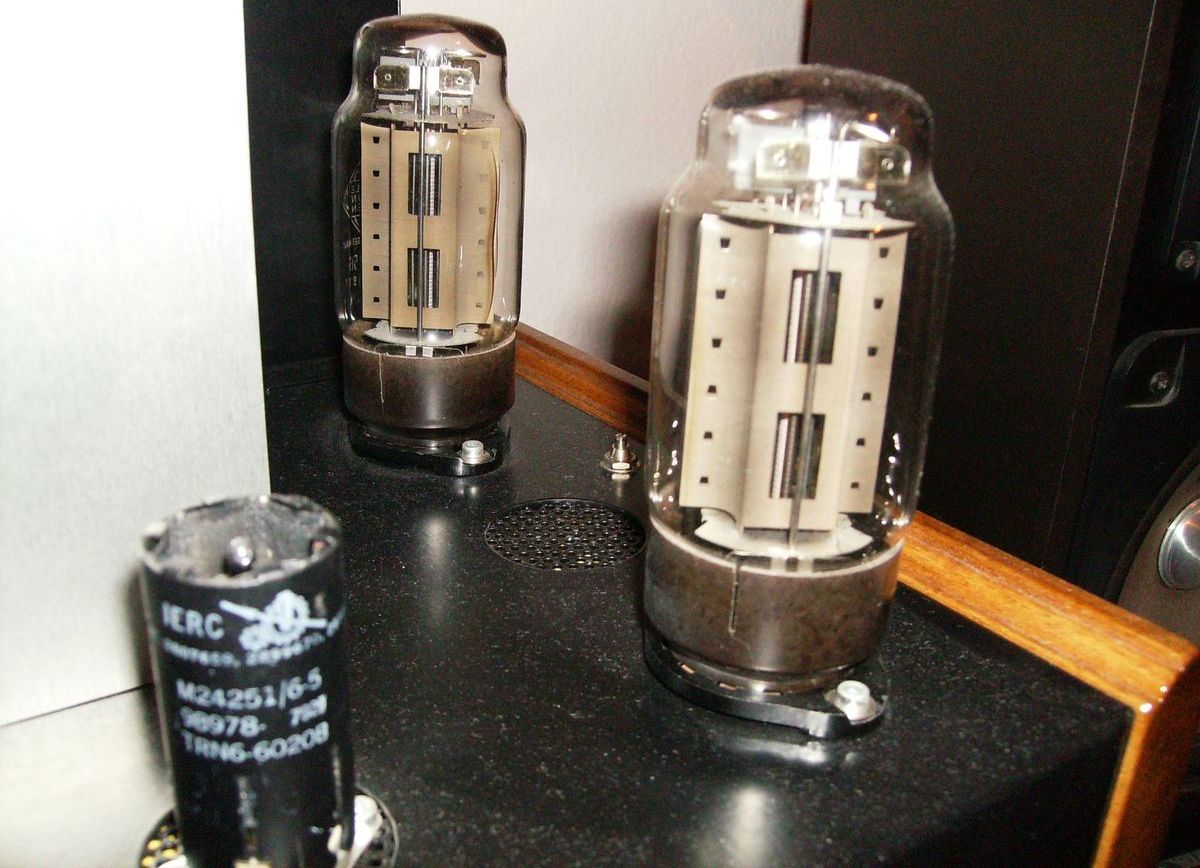

Hi Zal...... I've 4 pcs EL152 and have been desperately seeking out for a schematic for years.
Can you help or anyone out there?
Thanks!
Zekk
Thanks!
Zekk
Thanks!
Zekk
Hi Zekk! Sorry, but i have a friend who built a SE amplifier with EL153. Here: http://www.diyaudio.com/forums/tubes-valves/226554-telefunken-el153-se-circuity.html
Both EL152 and EL153 are derivated from LS50/GU50. Maybe helps.

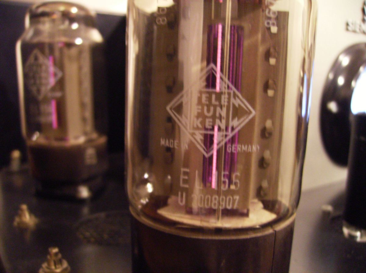

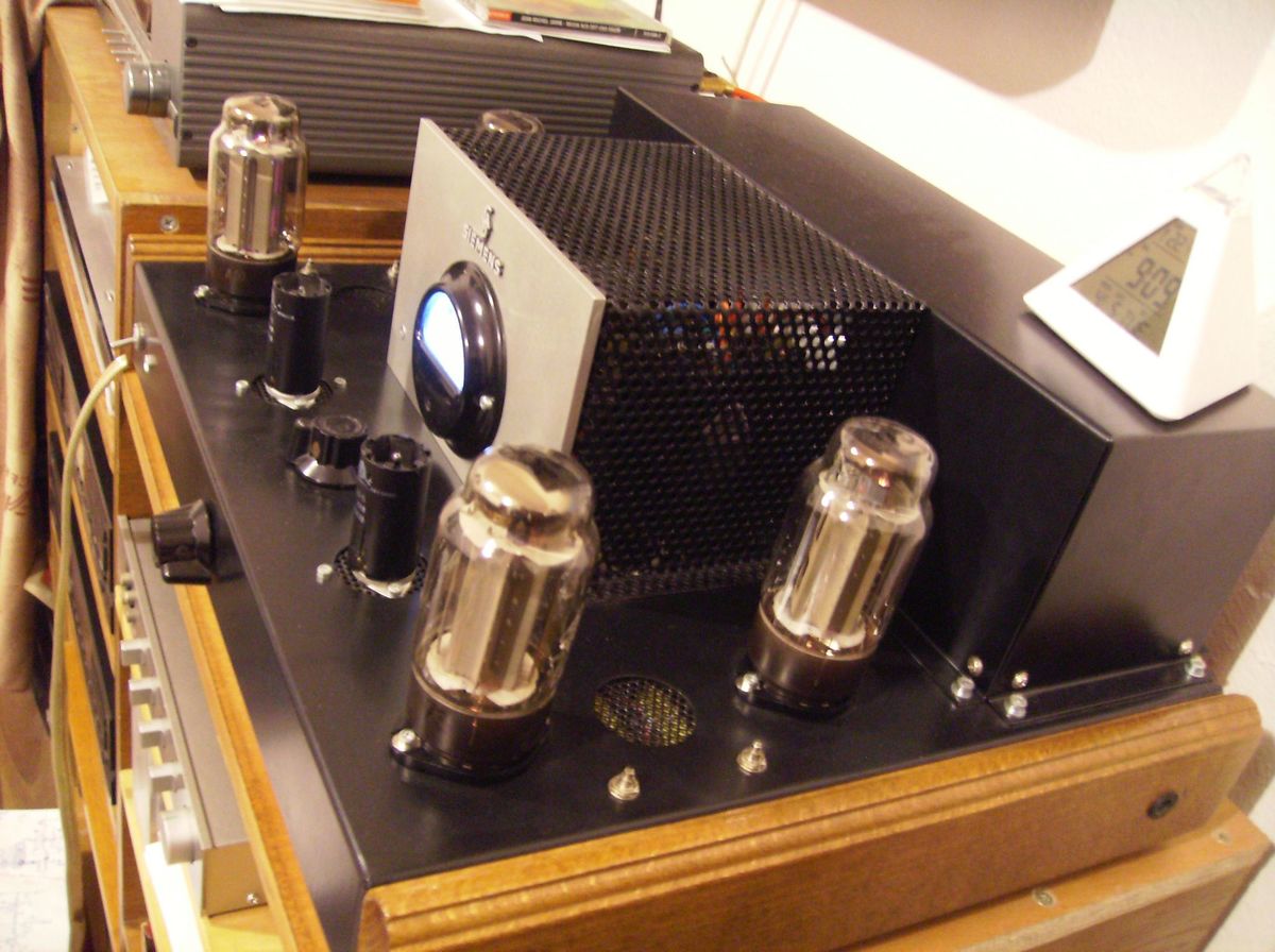

Hi asterkao! No, this is a PP amplifier with a cathodyne phase splitter. Some details: Ua +420V, Ug2 +350V, Raa 3,5k, no NFB and a 300W power transformer.Cool EL156!
Tri-pole SE ?

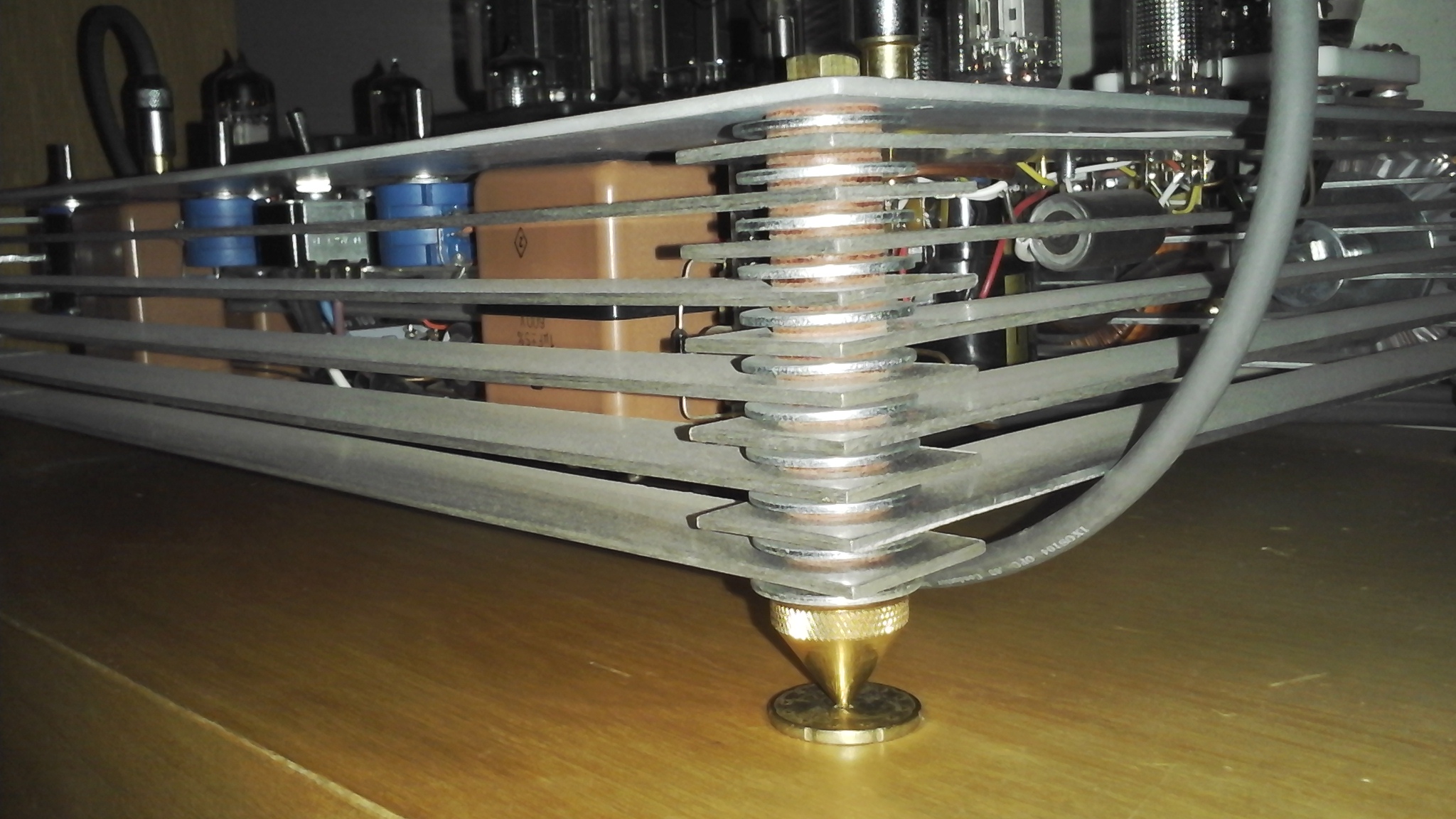

See my thread "new otl project"
No recent activity. ..... someone else should build one of these !!!
Nice, interesting industrial design. Why should someone else build one though?
Hola Smith, I like the concept of your OTL, the power supply is integrated? Did you use Circlotron?
