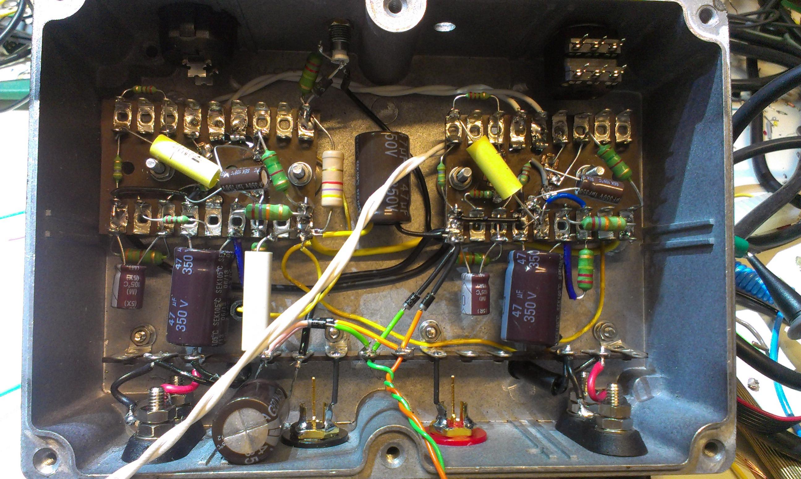

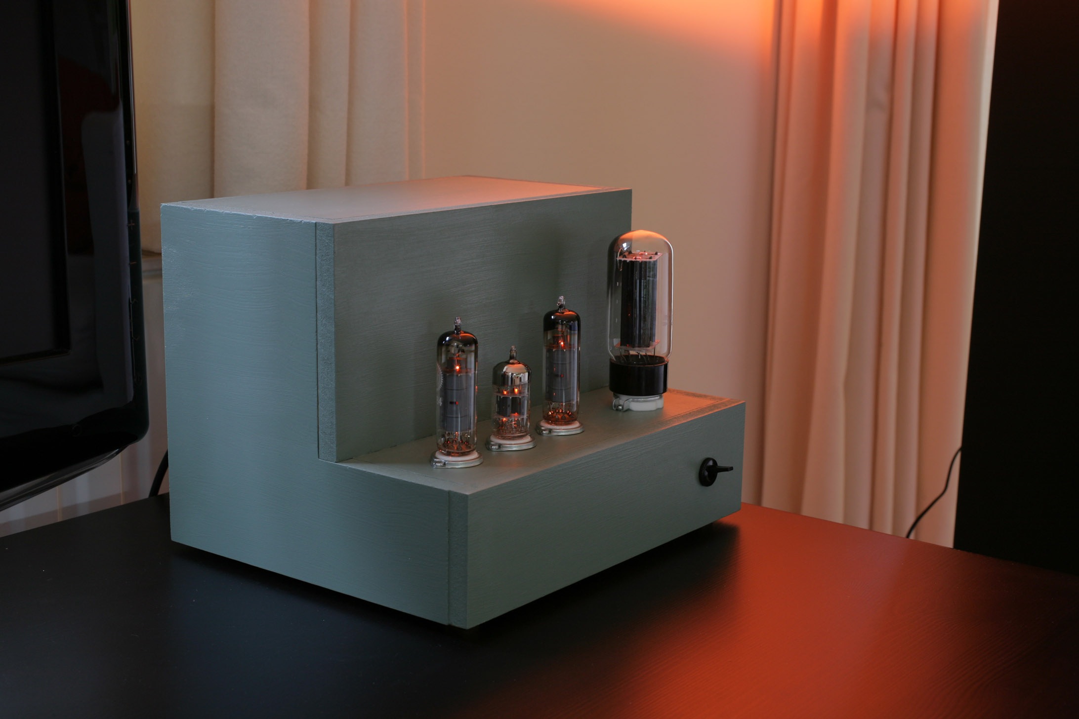

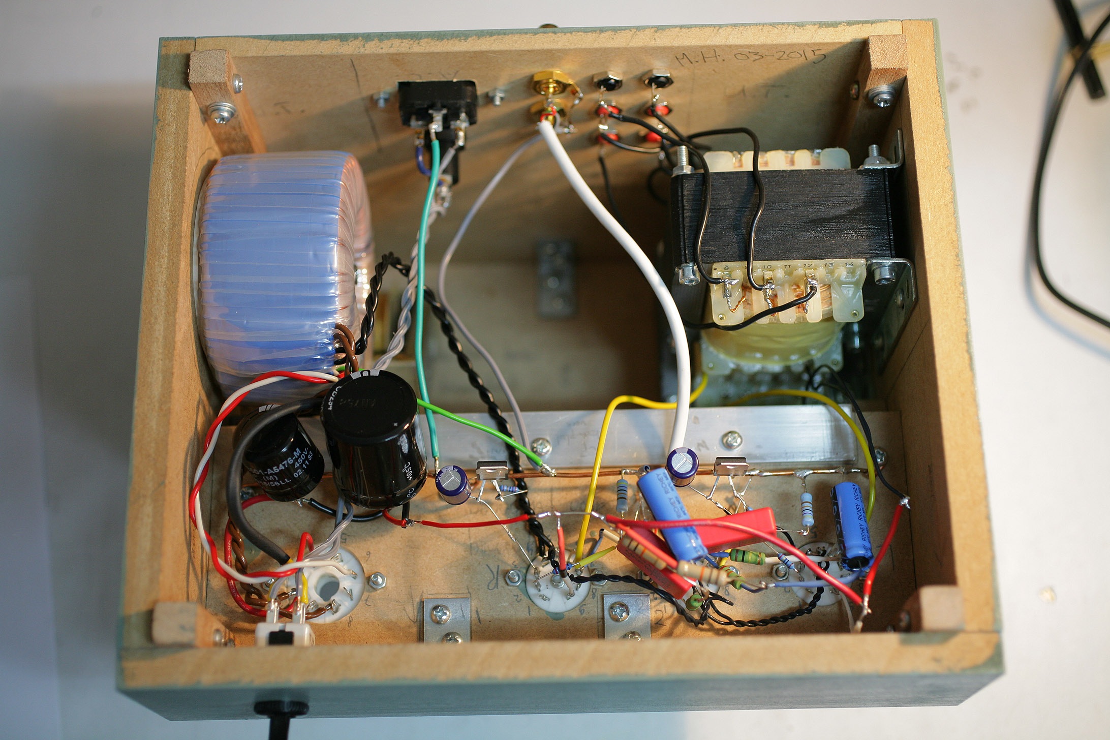

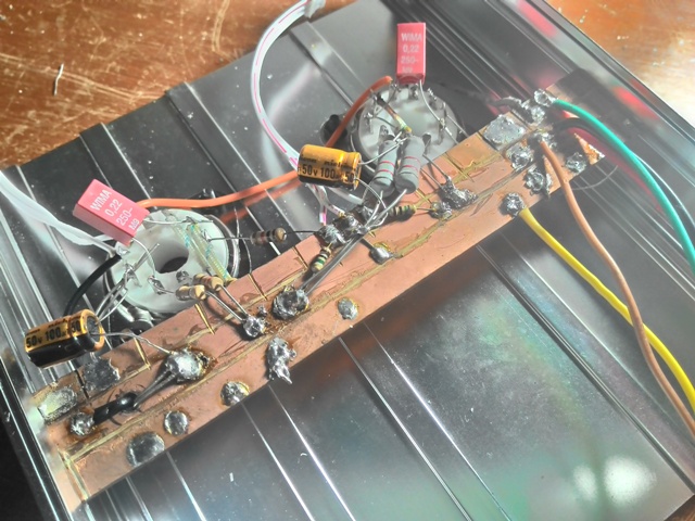

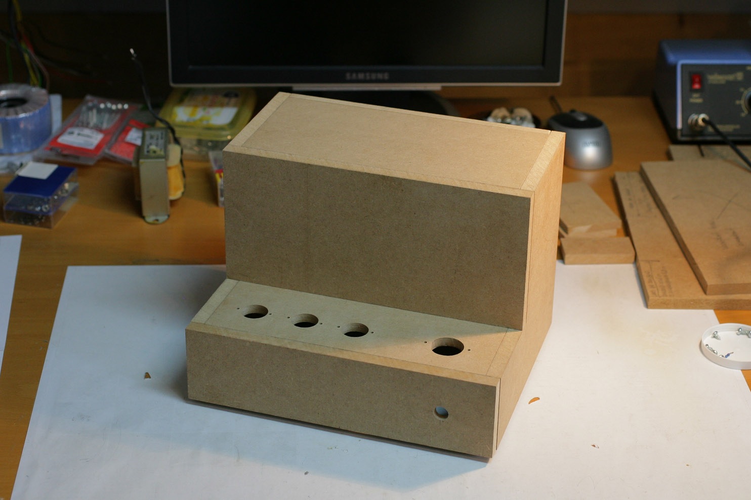

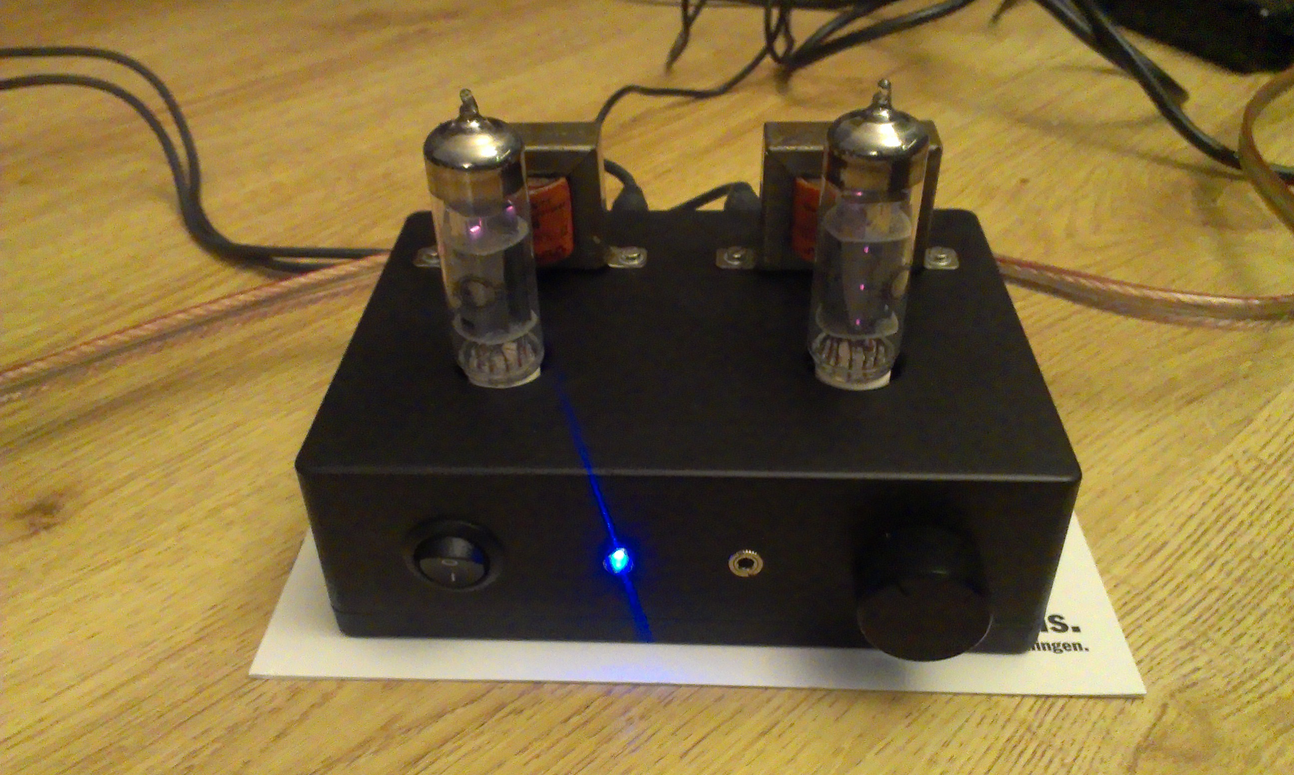

This is my latest DIY tube amp:
small stereo 2x3W ECL82
12 Volt DC powered with internal DC-DC converter for 200 Volt @ 75 mA
Amroh/Muvolet 7044 output transformers (NOS)
Cast aluminium enclosure
External power supply 12V 4A max. (the amplifier draws about 2.5 Amps)

@gertk: my kind of amp! love it.

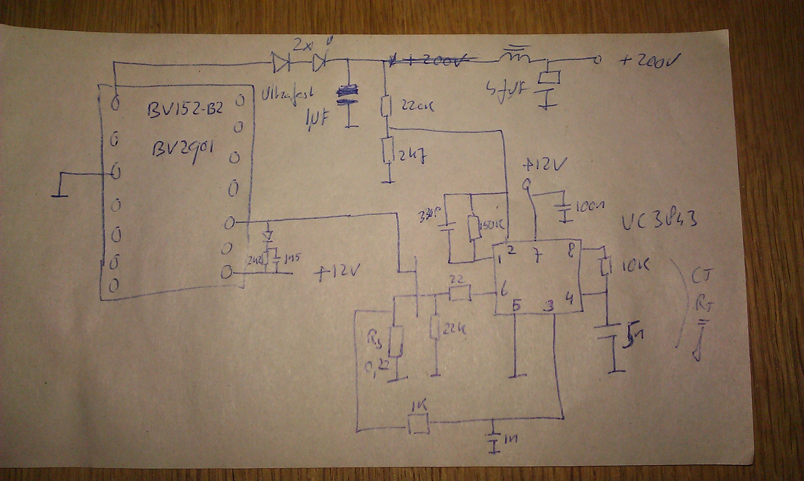

Mind sharing the DC converter schematic?

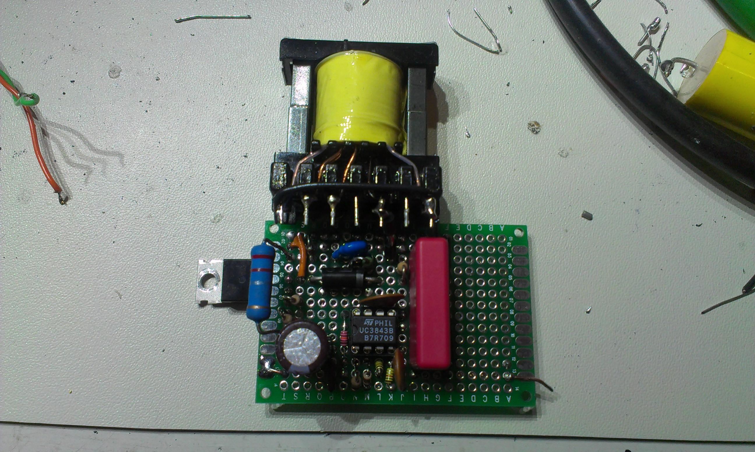

This is the circuit but unless you can get hold of the same transformer it is probably not much use. The transformer came from a scrap alarm control board..
Circuit around the UC3843 is pretty much from the datasheet. Some tinkering was required with frequency, the snubber circuit and current limiting. For the power FET you can use anything with a voltage handling of about 100 Volts and low Rds.
I used two ultrafast high voltage diodes in series for the output voltage after a single one died after a few seconds.

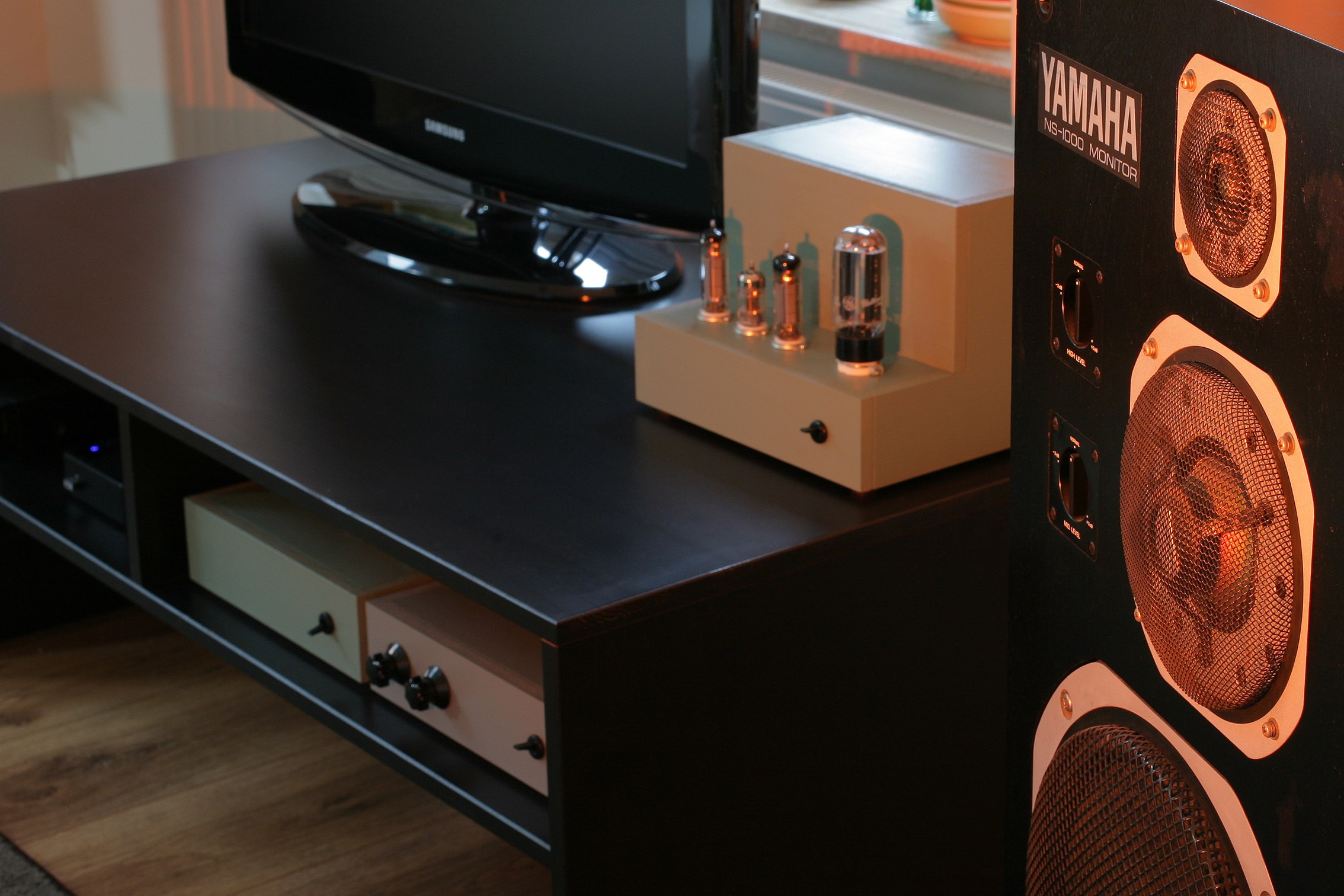

RH84 revision 2 build
Single ended pentode EL84, plate to plate feedback.
Schematics by Alex Kitic, as found on his RH Amplifiers blog.
Features auto bias and... an on/off switch!
It sounds very good, great bass on a pair of Yamaha NS-1000M.

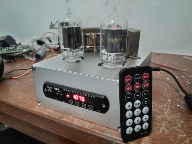

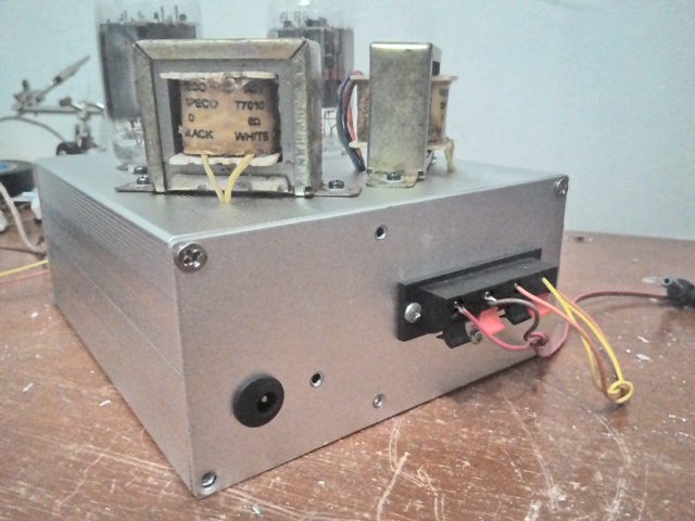

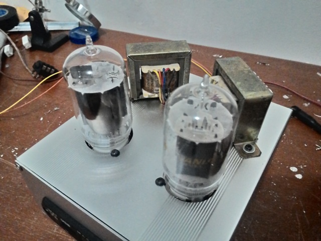

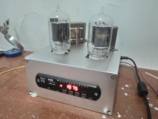

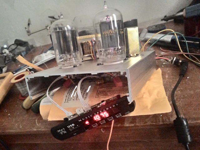

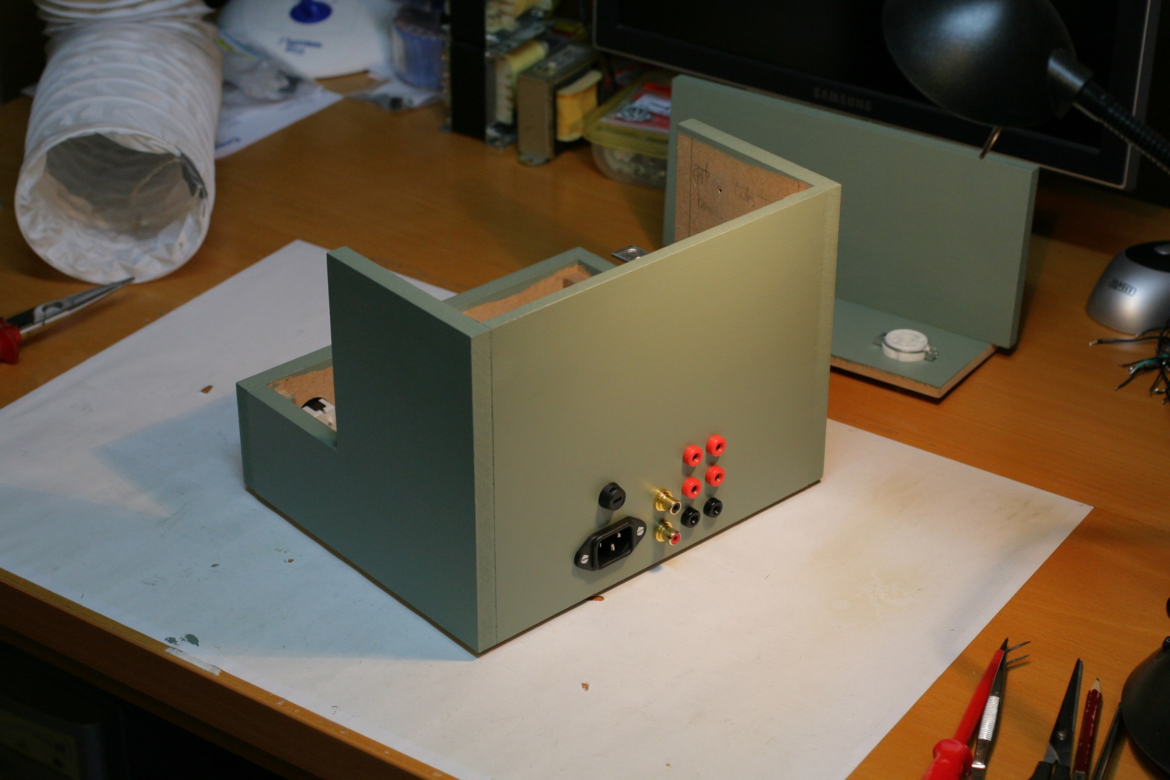

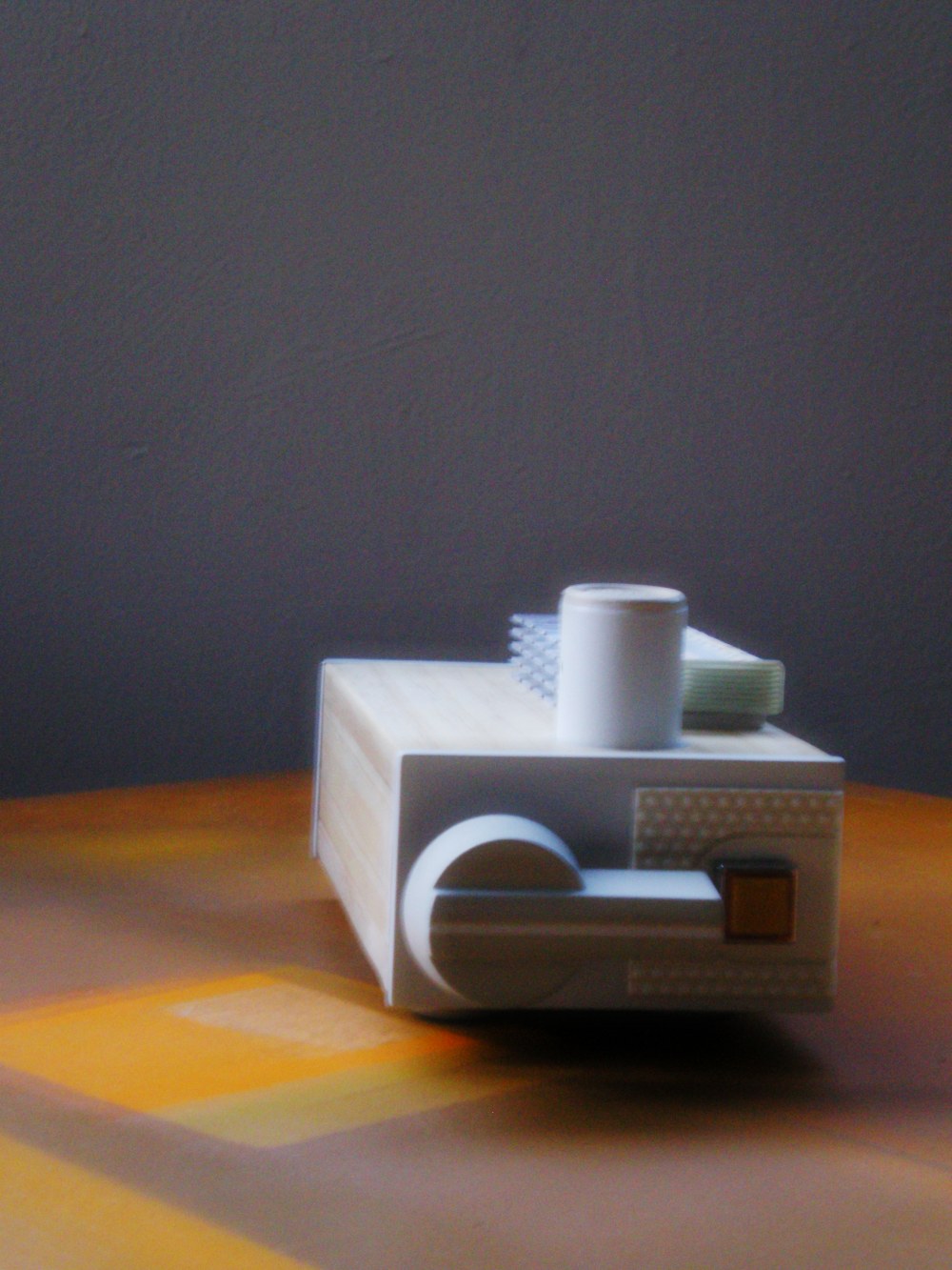

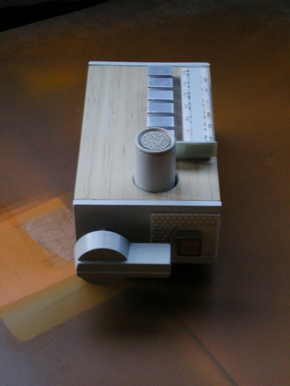

Just finished this desktop amp: SE 6LR8. Similar to gertk's amp on post 6601, this one is also powered by 12V laptop style charger with internal DC-DC converter raising 12V to 275V. Fitted some cheap FM radio+USB+line in module with remote control. I also use cheap 70v line transformer as OPT. They sound decent although having no gap for single ended application. Sorry for the crappy phone pics.
