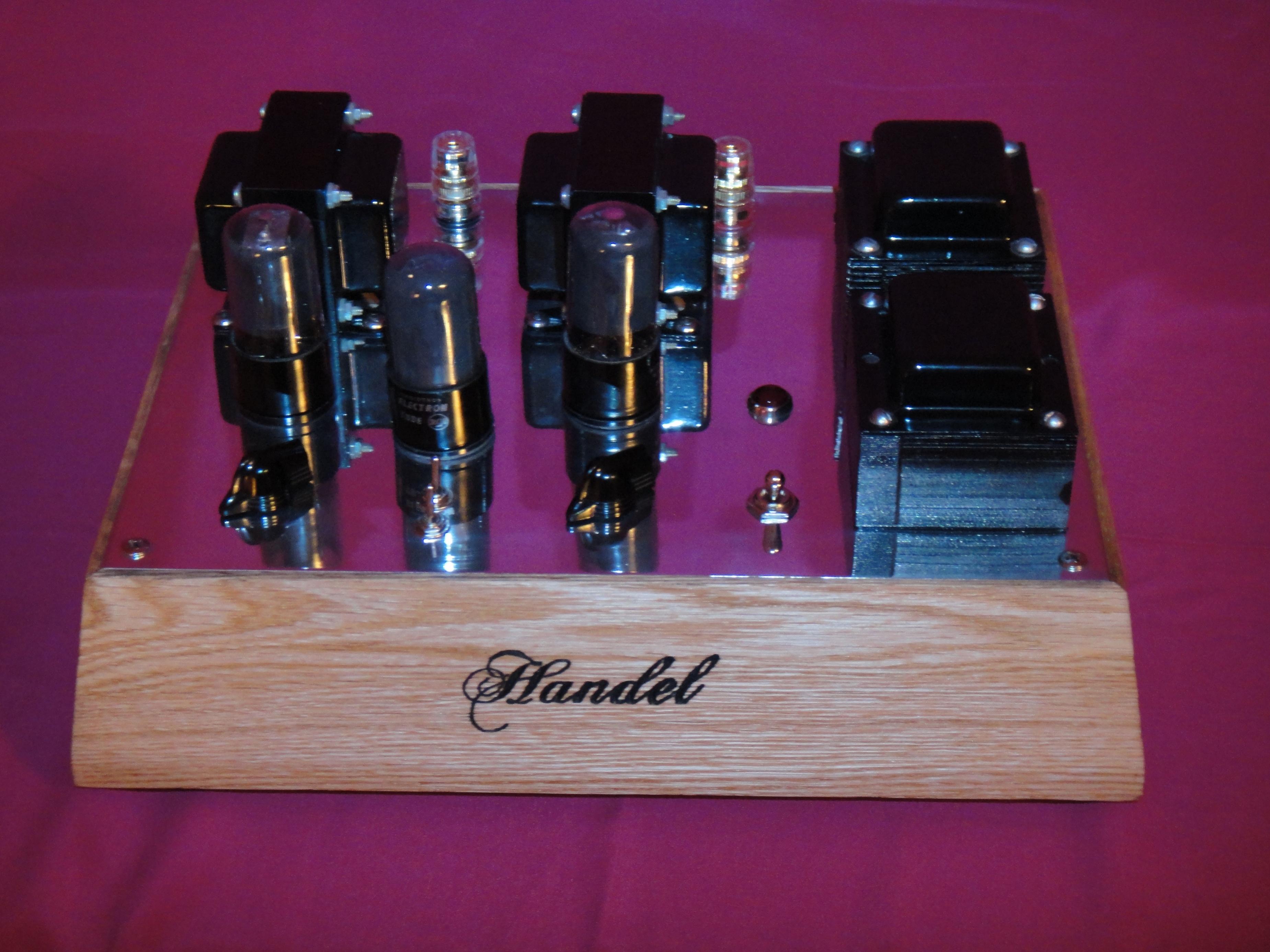

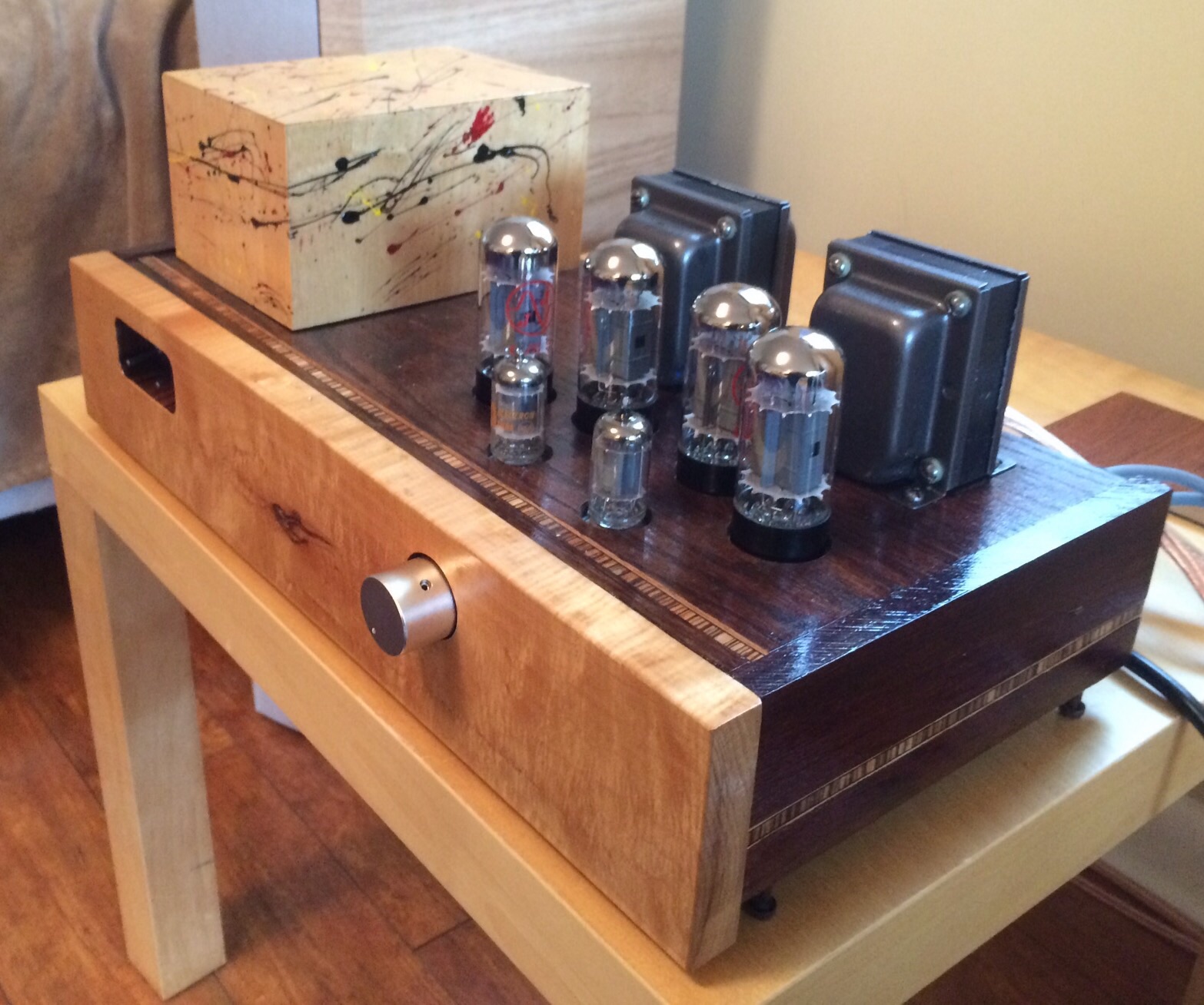

6EM7 SE Triode Stereo
Here's this week's build.
You've gotta' hear this flea watt 2 watts/channel setup. www.youtube.com/watch?v=QHZtVtAzYvw

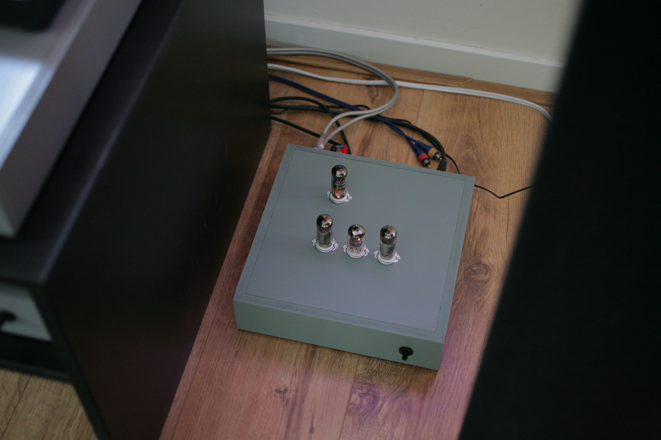

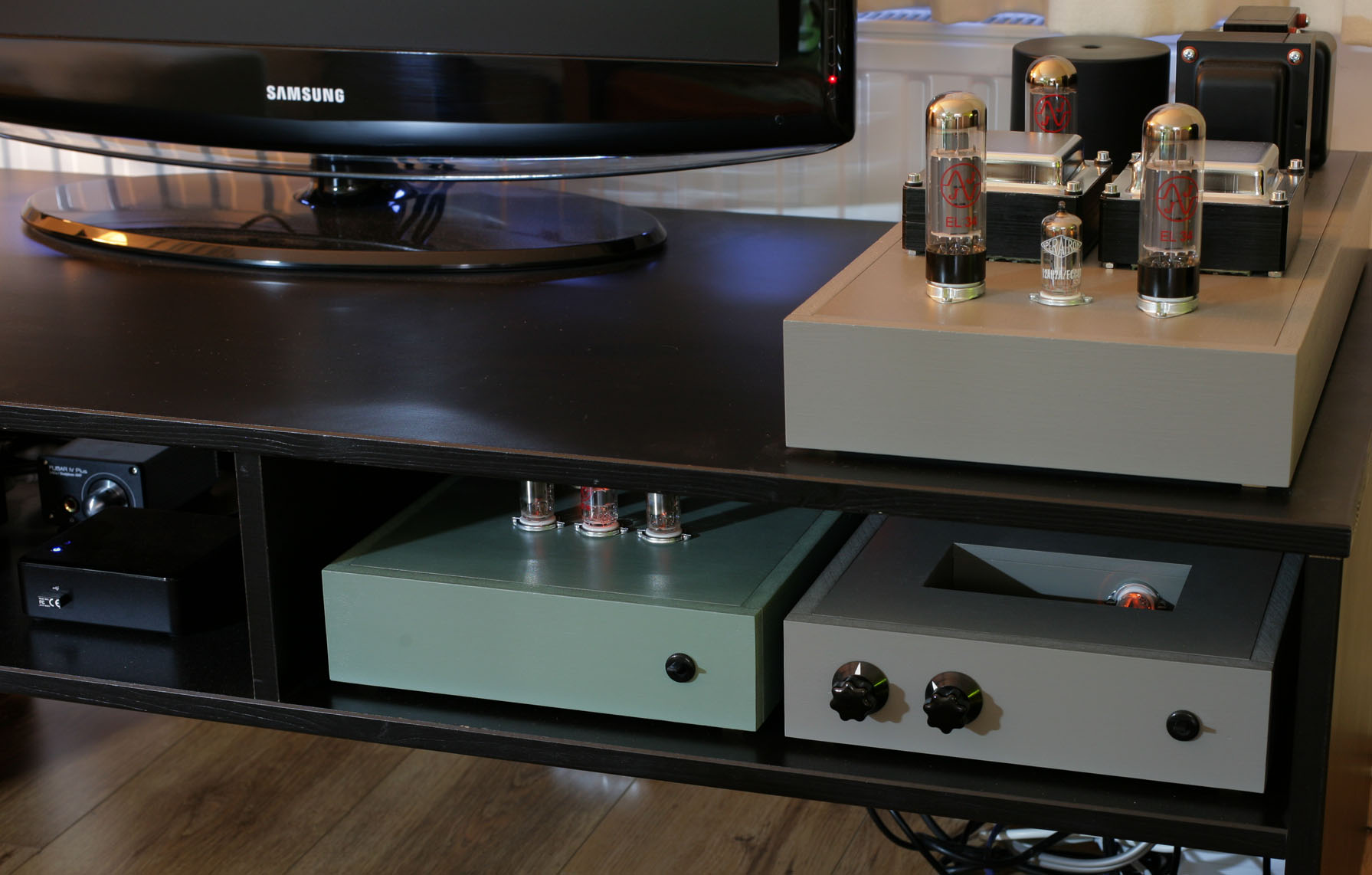

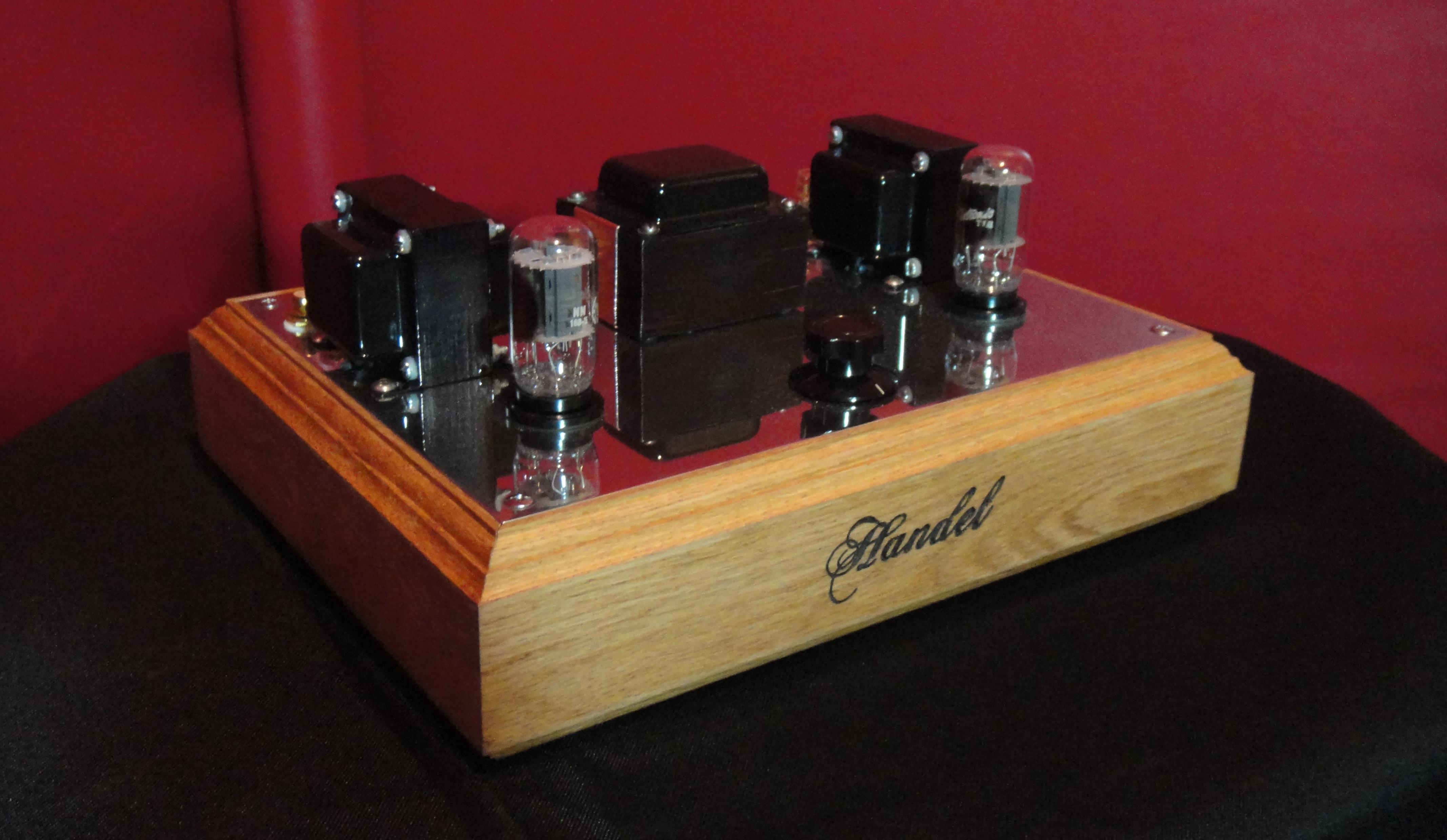

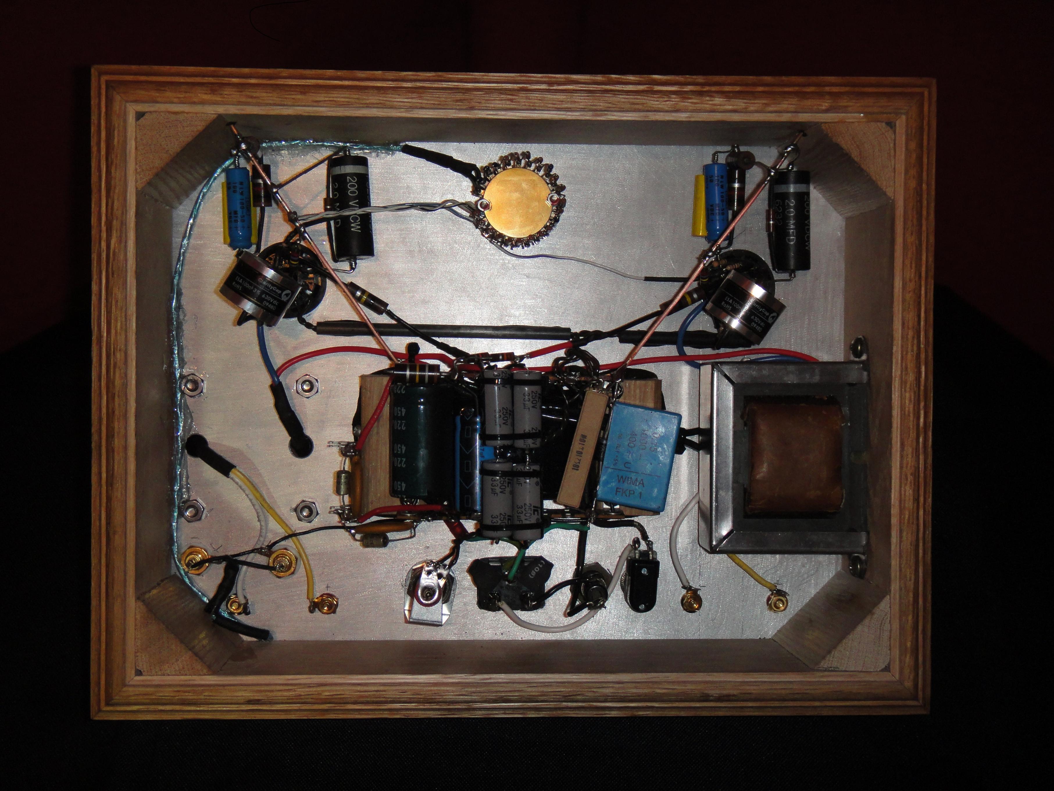

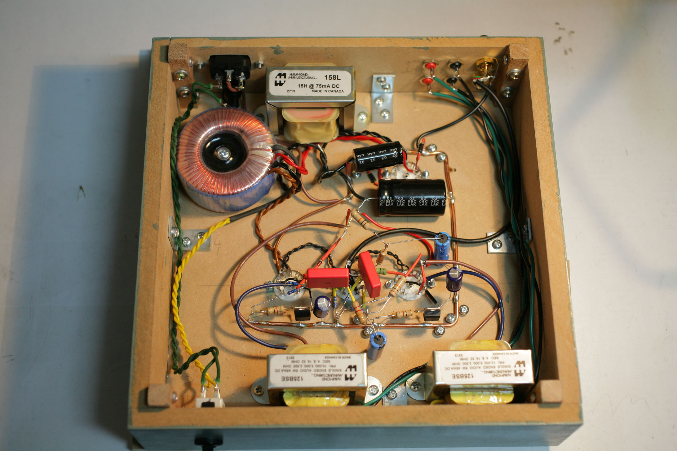

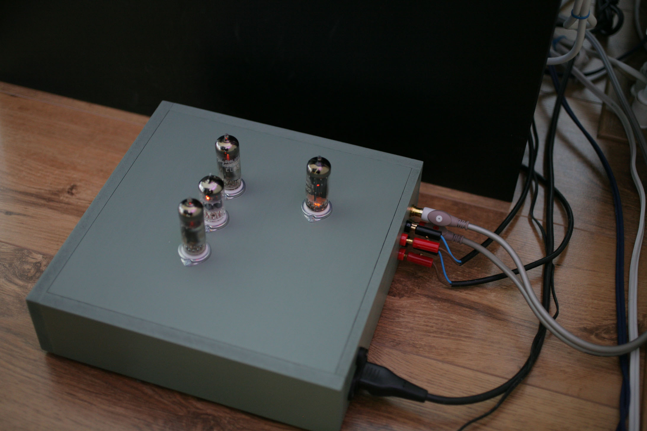

Single ended EL85 amplifier
This is what I build last week 😀
2 watts per channel EL85 single ended 'power' amplifier, based on the RH84 rev.2 (with auto bias) schematics by A. Kitic.
ECC81 driver, with an EZ80 for rectification.
Featuring 5 watt Hammond output transformers, power transformer is custom made at HB amp design in Germany.
Uses 33 watts in total which isn't much considering it's a class A tube amplifier!
Sound quality is really neat.

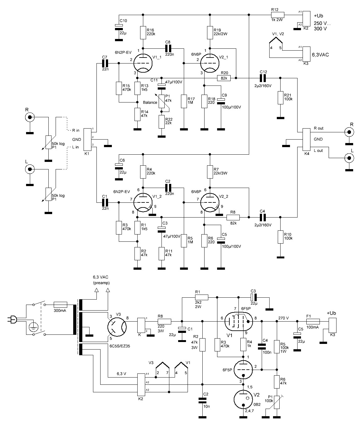

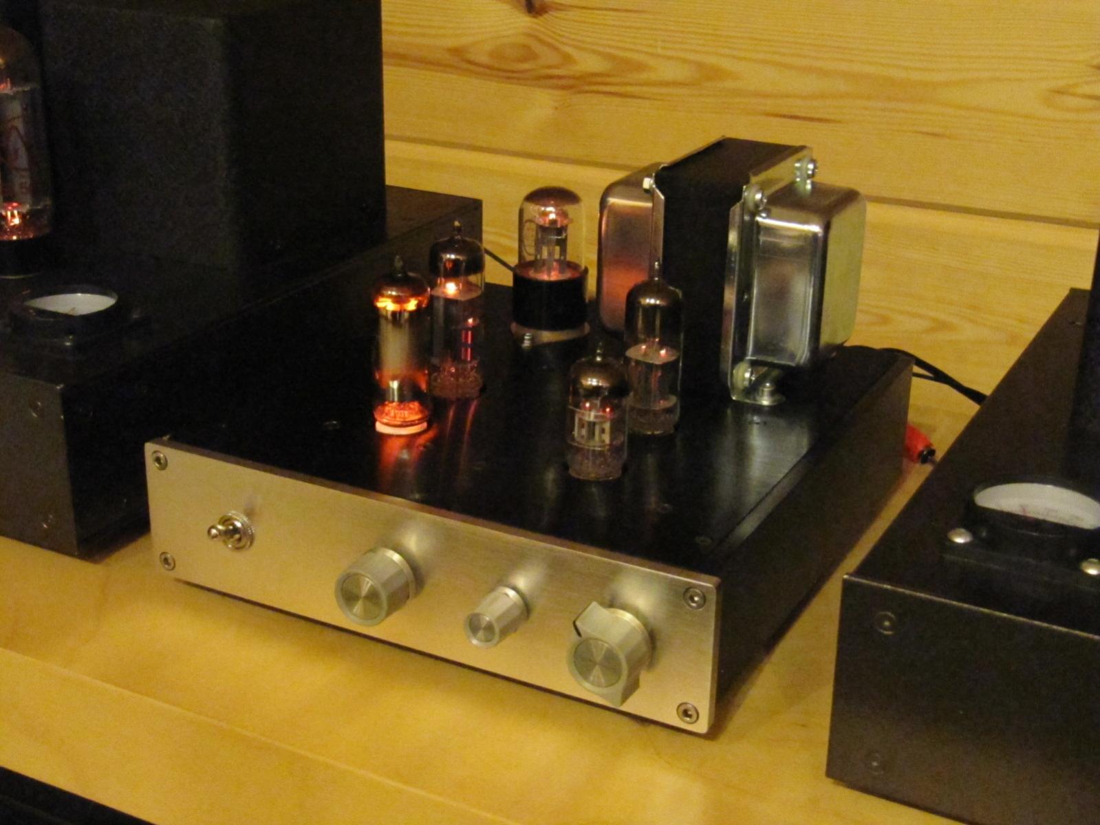

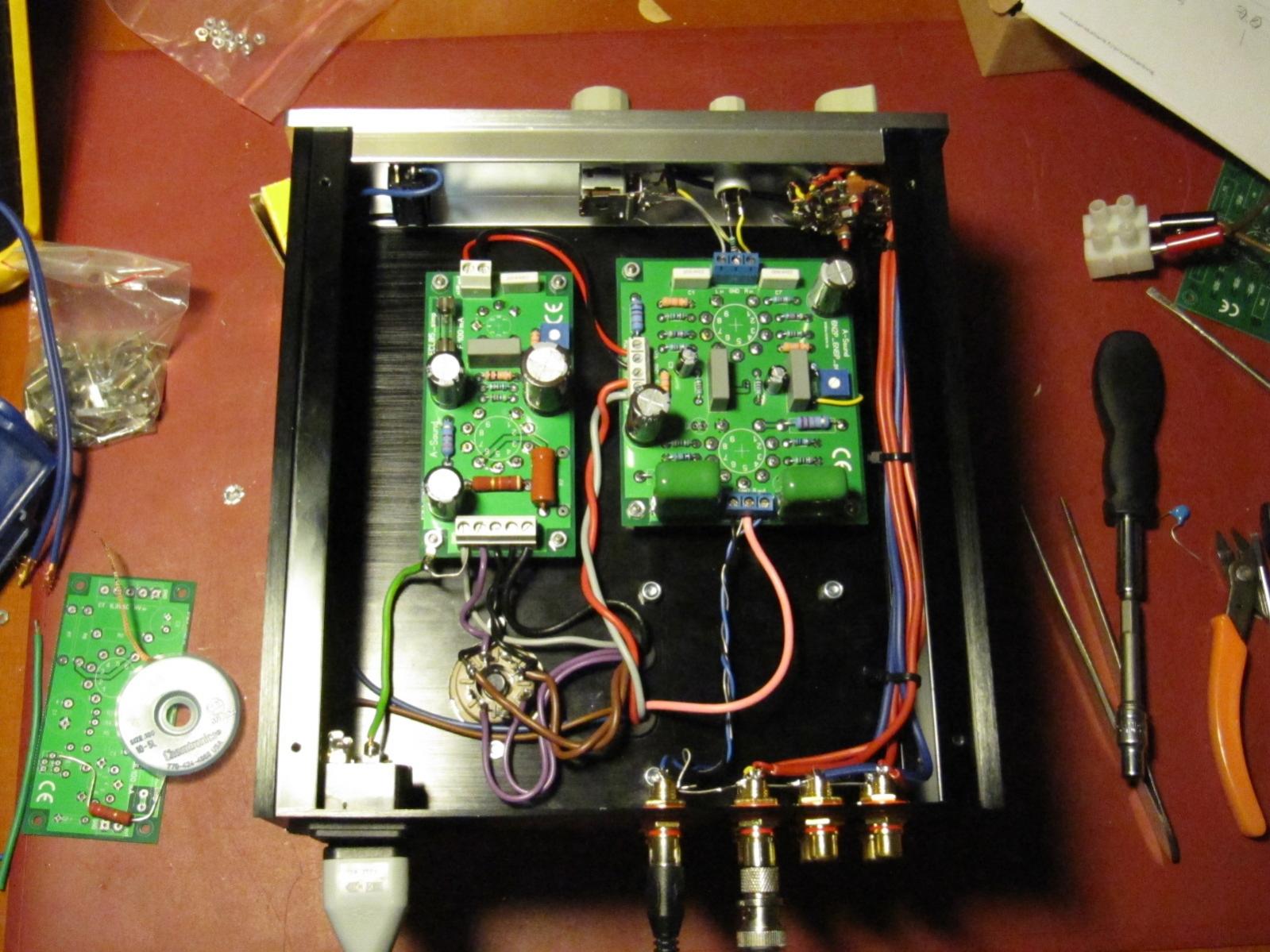

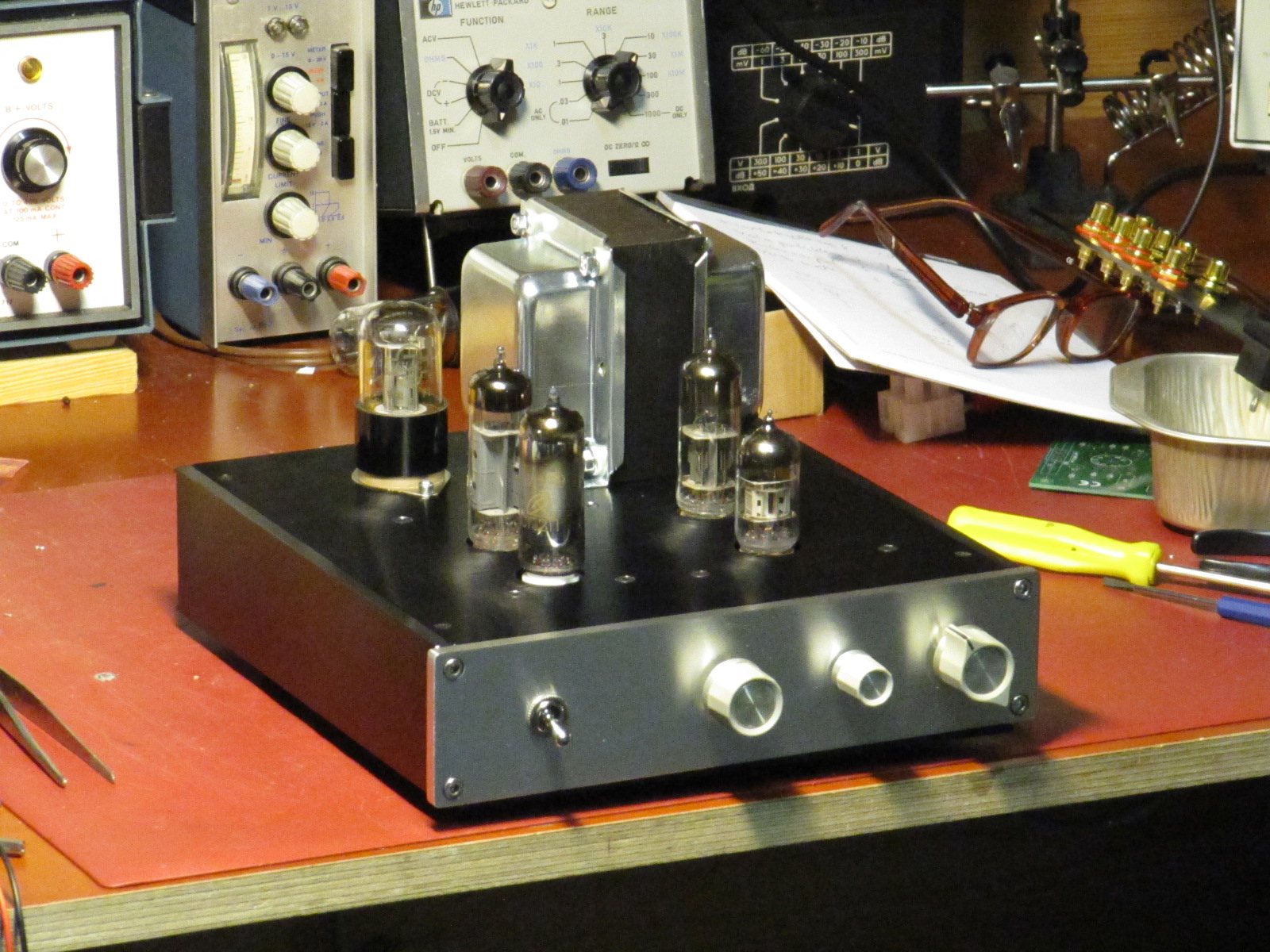

I built a preamp
Full tube consruction. 6C5S rectifier, ECL85 / 0B2 voltage regulator and line level amplifier with 6N2P-EV and 6N6P.
I see Russian knobs =)Full tube consruction. 6C5S rectifier, ECL85 / 0B2 voltage regulator and line level amplifier with 6N2P-EV and 6N6P.
All tubes, knobs and some capacitors are NOS Soviet.

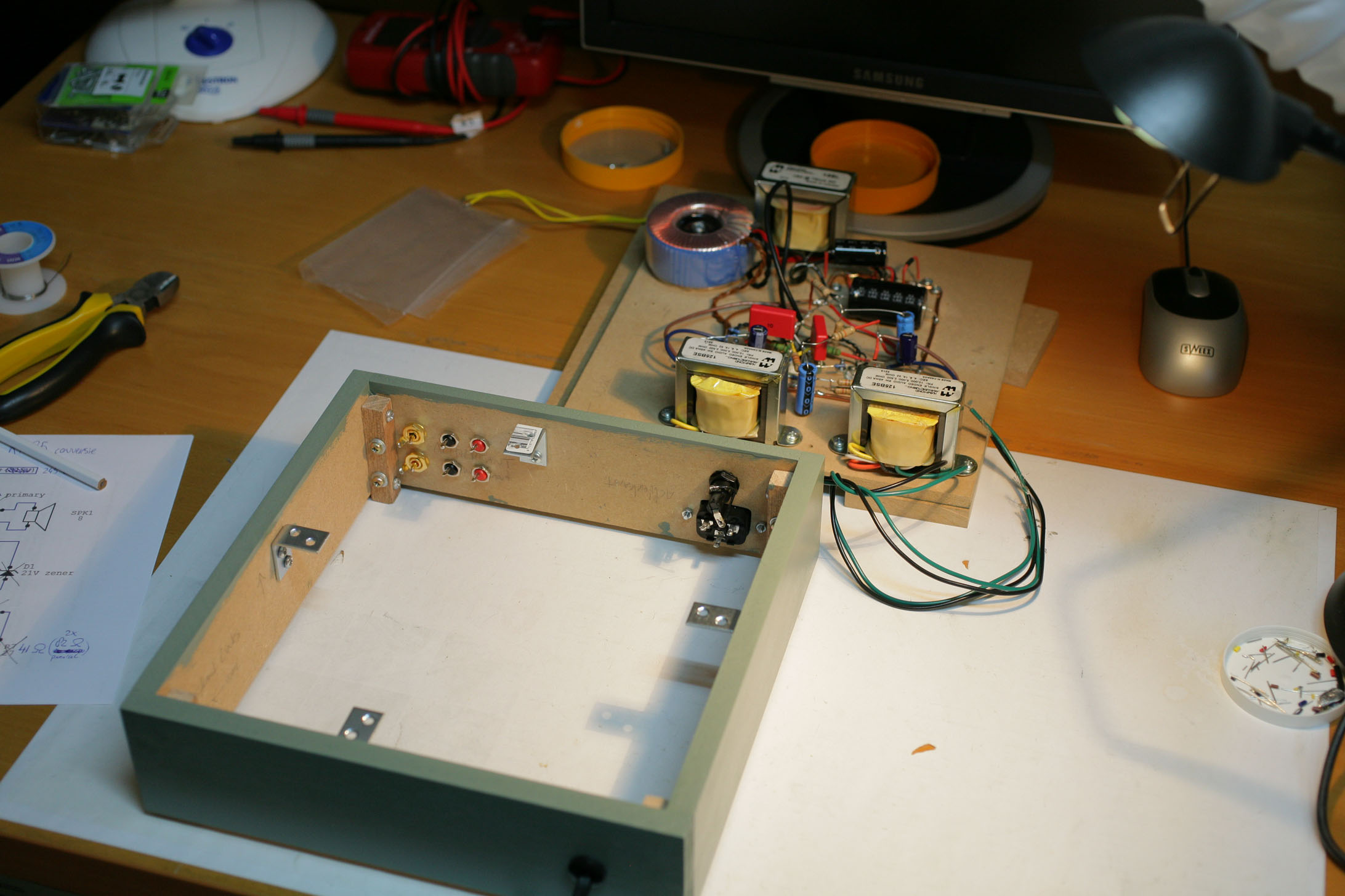

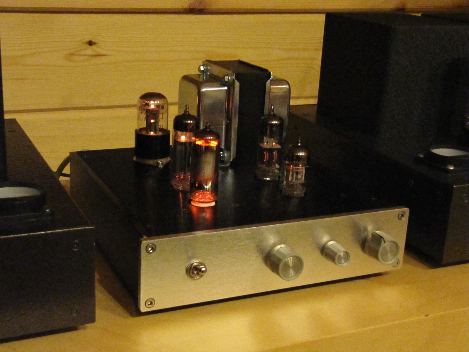

My first preamp project.
ECC83/E88CCtubes at this point in time.
I have russian 6n2p-EV/6n6p too.
separate tone adjust, balance, bass output level adjust, program selector and mastervolume pot.
Yes. amplifier has two sets of outputs. Full frequency and the other is 40hz 18db/octave low-bass filter,with level adjust.
back row is the operating voltage rectifier and regulator.
5U4S/ECL85/0B2 from artosalo.
And my third power amp.
6F12P cathodyne driver/KT77 pentode connected PP powerstage. And GZ34 rectifiers.
Bad english. Google translator 😀
