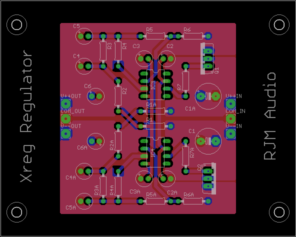

Xreg Evaluation Board
I've made a standalone version of the Xreg, intended for evaluation in the circuit of your choice. It can be added to the VSPS, previous Phonoclone versions, or any op amp powered phono stage or headphone amp. Just replace the existing LM7812/7912 etc. regulator section with the Xreg.
Wrote up the Xreg project on my homepage: (still a bit of a work in progress though.)
http://www.geocities.com/rjm003.geo/rjmaudio/diy_xreg.html
