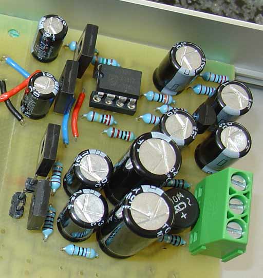

BTW, here's mine, including the rectifier and emitter-follower pre-regs. There are also SMD parts on the other side of the board.
I like the idea of crosscoupling the Vrefs, although it gets a bit costly once you employ really low noise (expensive!) references.

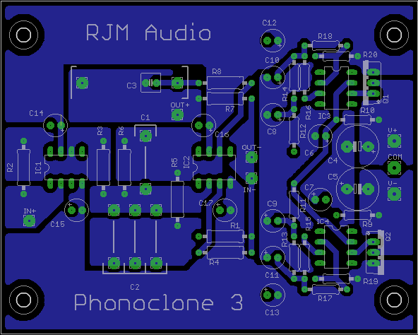

Time to put what I have so far up for public comment. You can click on the image to see a larger version.
I've shown the circuit in a slightly odd way: please note that the non-inverting terminals of both op amps are grounded. The numbers by the ground symbol indicate the order in which the grounds should be connected to each other. For non-Eagle users: the "X" symbol indicates a physical connection to the outside, an input or an output. The -> arrows are internal : "-> V-" connects to all the other sections of the schematic marked with the same label. The inverted "T" GND is an internal ground indicator in the same manner.
See if I'm on the ball with the maths:
The gain of the op amp stage is R2 / (R1+R3) = 68/2 = 34
The reference voltage (voltage between C4 and R4) is (approximately, ignoring R6) Vin * (R1||R2) / (R4+R5+R1||R2) = Vin * 500 / 20500 = Vin 1/41
The output voltage is Gain * Reference = Vin 34/41 or 83% of the input. e.g. input 18 V output 14.9 V.
* Re. your schematic, the odd feedback loop and the unsymmetrical circuit really threw me at first. I see it now: single, highly filtered reference, noninverting for the positive output, inverting for the negative output, both configured for a gain of 2. Earlier, I missed the fact that the second op amp was inverting... your "Looking more and more like mine now" comment makes more sense now... 🙂
* Was there any particular reason to choose the BD137 series of transistors? I'm wide open to suggestions.
* Comments, suggestions, and error-reporting welcome.
The gain is -R2/R1. The opamp is not aware of R3.
Rather (R1//R3) / [(R1//R3)+R4+R5+R6]
Yes. It's the most widely-available medium power transistor over here.
You can buy them at the grocery store.
My mistake, I double dipped: Counting R1 as part of the voltage divider network, I should not have then counted the network impedance towards the op amp gain.
Fix: change R2 to 33k.
Most recent update of the Phonoclone 3 files attached. (capacitors C1 and C2 replaced with pads only as my CD silver mica caps have thick leads that don't fit in any of the standard Eagle caps in the build in libraries, and I'm too lazy to make a new part.)
I wondered at the time if I had miss-interpreted your post...
I don't think reading schematics comes naturally to anyone. Like reading sheet music, it takes practice. Plus there are some shorthand notation being used in the Eagle files here that are probably not intuitively obvious.
I'll take a stab at running though the Xreg circuit:
The raw voltage comes in at V-IN and V+IN. There is a filter capacitor C1/C1A that together with the total current draw of the load+regulator circuit elements, defines the initial ripple voltage.
The filtered voltage connects through the V++ and V-- "wormholes" to the collectors of the pass transistors Q1 and Q2.
The op amps are connected through the V+ and V- "wormholes" back to the main voltage filtered by the RC stage R6/6A and C2/2A. The op-amp power pins see about 10 times less ripple, and much less high freqency noise than the pass transistor.
The voltage powering the op amp is filtered and reduced by a two stage RCRC filter, R5/5A,R6/6A and C3/3A,C4/4A to generate the reference voltage. Its not an absolute reference, but the time constant is less than 1 Hz so it varies very slowly, essentially remaining "quiet" over the audio bandwidth and beyond.
The voltage amplifier is a textbook inverting configuration, but with the pass transistor inserted into the feedback loop. The output voltage is equal to the reference voltage multiplied by the gain, set as -R2/R1 and -R2A/R1A.
There are only a few oddities compared to your typical voltage regulator:
-The op amp is powered from split supply rails.
-The op amp is configured as an inverting amplifier, and takes the reference voltage generated from the opposite voltage rail as the one it regulates.
-The reference voltage is a fraction of the input voltage V+IN V-IN, not an absolute value because a filtered voltage divider provides a reference voltage, rather than a zener diode or precision reference.
The way the circuit "works" is as follows: the output is going to be equal to the reference voltage times the gain. For an 18 V input the op amp input sees about 450 mV at the input, 450 mV which is almost completely free of noise and ripple, and multiples that by -33 (R2/2A is 33k remember) to give -15 V, or 15 V from -450 mV for the positive rail.
The circuit is going to try to hold that 15 V constant no matter what the load does, over the bandwidth the circuit operates - in this case about 250 kHz - within the limit of the max current the transistor+raw voltage input can provide.
