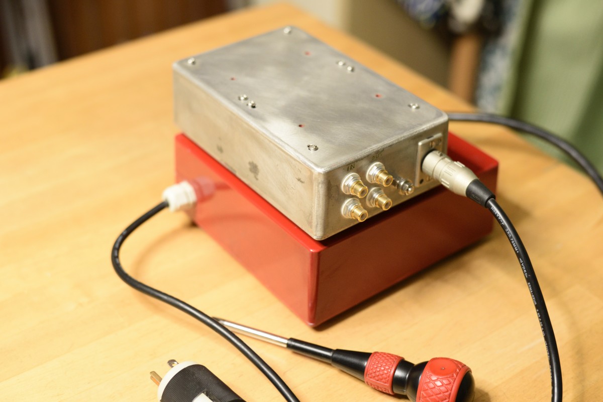

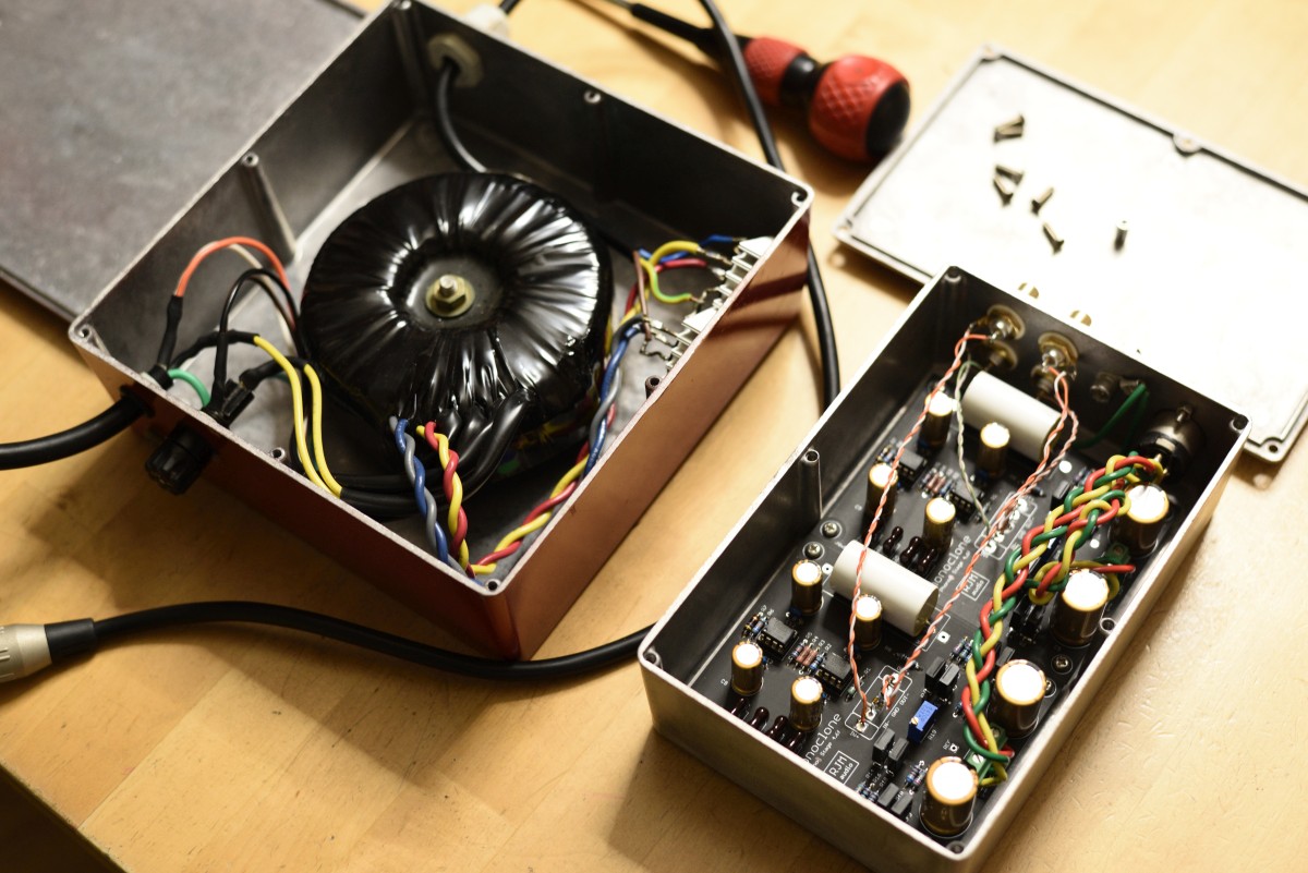

Photos of my Phonoclone 4.6f. Perhaps a fitting way to close out the thread.

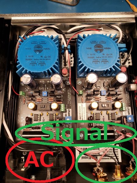

I'm looking at reducing the values of the feedback network in order to reduce noise and hum pickup. I did a SPICE simulation, and if I simply drop a decimal place, the same RIAA response is attained.
However, the gain of the second stage is reduced by 14db, and so the first stage must be run 14db hotter.
Any issues with this?
Thanks! Yeah, I'm trying to avoid loading up the output too much. The OP27 will swing +/-10V into 600 ohms, but I want to be nicer to it than that. The knee of the curve for output swing vs. load is around 1K. Distortion remains low anyway.
So here's a happy medium, 1.21K.
And this is the preamp itself. I built the power supply into the boards themselves, and it's picking up a little hum, which I think will go away with the new feedback values.
Hi Chris,
While it's a compact an efficient layout, the close proximity means there is a risk of noise coupling between the AC wires and the audio signals, as well as from the magnetic fields of the power transformer.
I hope you can manage to get the hum down to manageable levels.
RM
