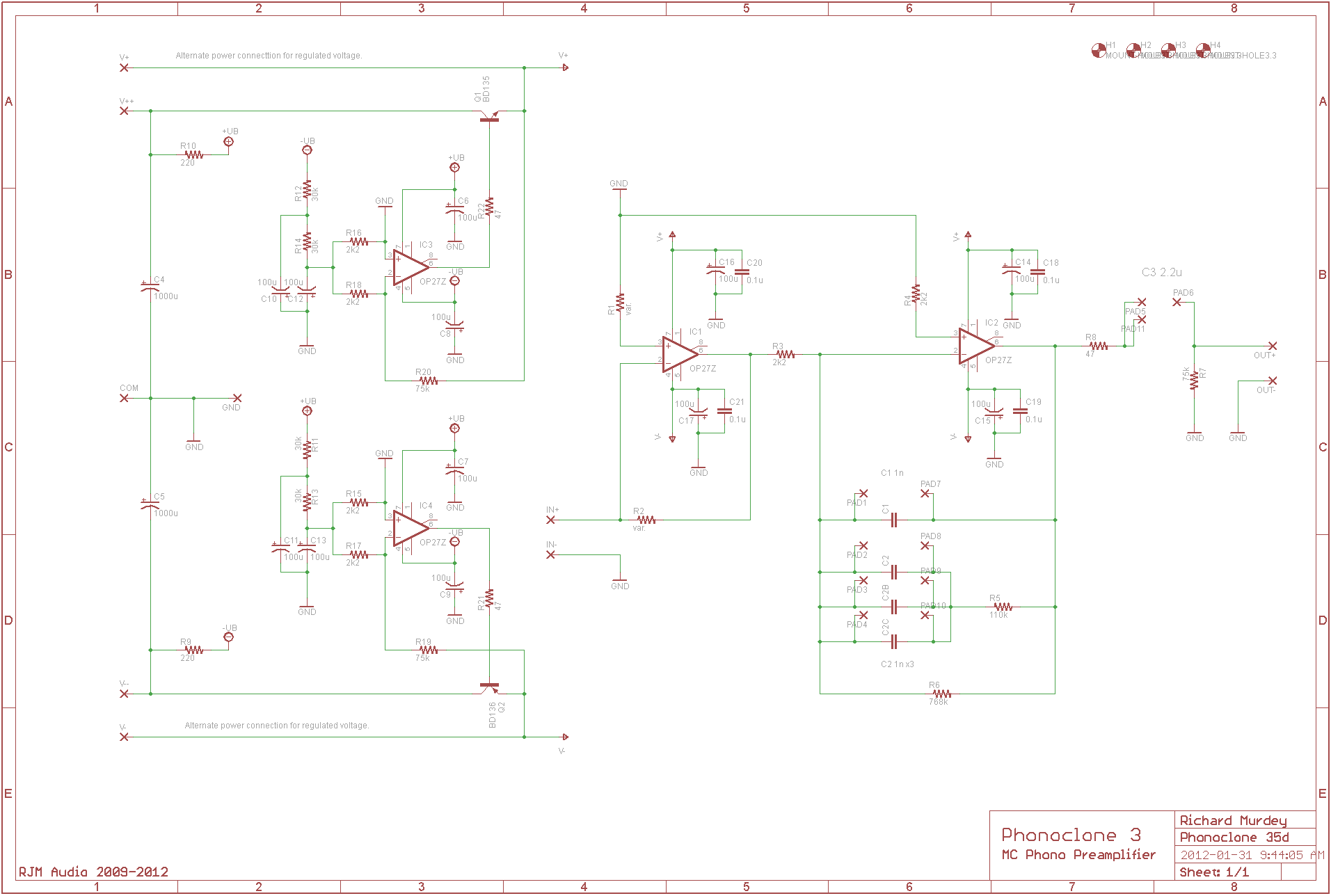

I was asked in an email how close the Phonoclone circuit is to the original. It's something that's come up before, a long time ago, but since I've never been quite satisfied with the answer I gave I will take another stab at it:
The Phonoclone is based on what is publicly known about the Phono Cube, plus some information divulged in private communication, and there was, at one point, a web page with details from someone who claimed to have taken it apart.
The basic topology is almost certainly correct, and the op amps OP27, are also very likely correct. Obviously I have no idea about the resistance and capacitance values used, but educated guesses, inter-relationships, and proper practice gets you most of the way there.
The phonoclone circuit as I have it has 13 parts per channel. R1 and, possibly, R4 can be left off and the circuit still function as per the known specifications, everything else is required. There isn't much else that can be added, but perhaps there is a capacitor across R2 for stability. So the range of parts is 11-14 per channel.
Now the Phono Cube has 25 parts per channel, the difference is surely the voltage regulation circuitry, which is duplicated for the two channels, and of course symmetric positive and negative. So the voltage regulation components must be an even number. That means the phonoclone circuit must be odd, either 11 (for 7 parts per voltage rail) or 13 (for 6 parts for voltage rail).
Now we come to the part that bothers me: What is the most likely voltage regulation components used? I has assumed LM317/337 with the bypass cap. With filter caps in and out, bypass cap, and the voltage divider, that's 6 components per voltage rail. Done.
It somehow seems out of character for Mr. Kimura to use these voltage regulators however. In keeping with his "simple is best" design philosophy, LM7815 LM7915 seem more likely, but it hard to come up with a reasonable configuration using fixed voltage regulators that uses 6-7 parts, typically only 3 are needed per voltage rail: the chip and two capacitors. At one point I entertained the idea of a RC filter on the regulator output, one for each op-amp. That ends up at 7 components but seems awkward and unnecessary.
Fast forward to today, and now I'm wondering if the zener-referenced pass transistor regulator was used. The circuit is used in my Sapphire amplifier. 3 caps, 1 transistor, 1 Zener, 2 resistors. 7 parts. Some times it's used without the second resistor.
It's quite possible. The reason I say that is it's unlikely the circuit with regular voltage regulators, be it LM317 or LM7815, would have sound as distinctive / good as the Phono Cube apparently does.
It's water under the bridge now anyway as I have replaced the whole voltage regulation with the custom X-reg circuit in the Phonoclone3, but I do think the simple Zener regulation circuit deserved a second look.

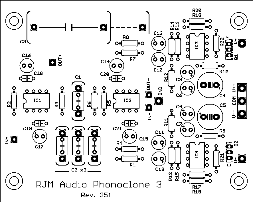

Phonoclone 35d
Several changed for version 35d
1. Redrew the circuit schematic to A3 frame size, it is a lot clearer now.
2. Added optional 0.1uF ceramic caps next to op amps IC1, IC2. This should provide stability when using high bandwidth op amps like OPA37.
3. Added wirepads for the regulated voltage rails V+ and V-. This means eiether A. you can access the X-reg output voltage to use to power a external buffer circuit for example, or B. you can omit the X-reg components and power the board from your own regulated or battery supply.
4. Put back the missing part label "C3"
5. Added a second pad for C3 to make it a little easier connecting larger axial coupling capacitors.
6. Minor edits to the trace layout.
7. Renamed the regulated voltage rails from V+reg, V-reg to V+ and V-, and renamed the filtered rails of the X-reg circuit from V+, V- to UB+, UB-. Unfortunately I used V+ to mean different things in the Xreg and phonoclone web pages, I prefer to be consistent with the usage of the phonoclone description, that is, V+ and V- are the regulated, internal voltage rails to the op amps while V++ and V-- are the unregulated, external supply connections.

Will you update your homepage's parts table and layout for the new 35d version here?
If I miss the forum here, I'll never found the C20 value, too much version make the construction more confusing, sorry I'm no smart guy.
Yes, the kit instructions and (eventually) the BOM will be updated to 35f once the new boards start shipping later this month. The web page and downloadable images and Eagle files have already been updated.
Note that the basic circuit values, kit contents and BOM do not change. The new boards just have space for an optional bypass capacitor which is not normally used or required... I will just make a note of that in the updated BOM.

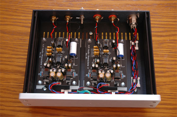

My first attempt at Electronics for years has produced this. Thanks to Richard for all his help.
Very nice cabinet, where did you buy it?
Ronald.
Ronald.
Its a Galaxy with 10mm front from modushop.biz

Completed Build (Almost)
Final verison completed. Differenced from the stock PJM unit and build details are:
1) Power supply boards (CRCRC + Q-Speed diodes)
2) Tantalum resisitors in input section and RIAA filter
3) Audiocap Theta coupling cap + nuded Russion teflon bypass
4) Silver teflon signal wiring
5) Opamps directly soldered
6) Used Nichicon Muse caps for the IC supply bypassing
7) Used RJM's new buffer boards, inserted between the last IC output and the final coupling caps.
8) Measured and matched RIAA caps
After much meddling with AD797's I ended up keeping the OPA27 opamps in all positions. Cases are Modushop Galaxy.
P1050528.jpg by MartinC7, on Flickr
P1050526.jpg by MartinC7, on Flickr
P1050530.jpg by MartinC7, on Flickr
Still burning in (only been running for 30 mins) but very sweet. With the volume full there is slighly less noise than the stock build, I am guessing that this may be due to the tantalum resistors.
Anyway back to listening then some final wiring clean up.
Cheers
