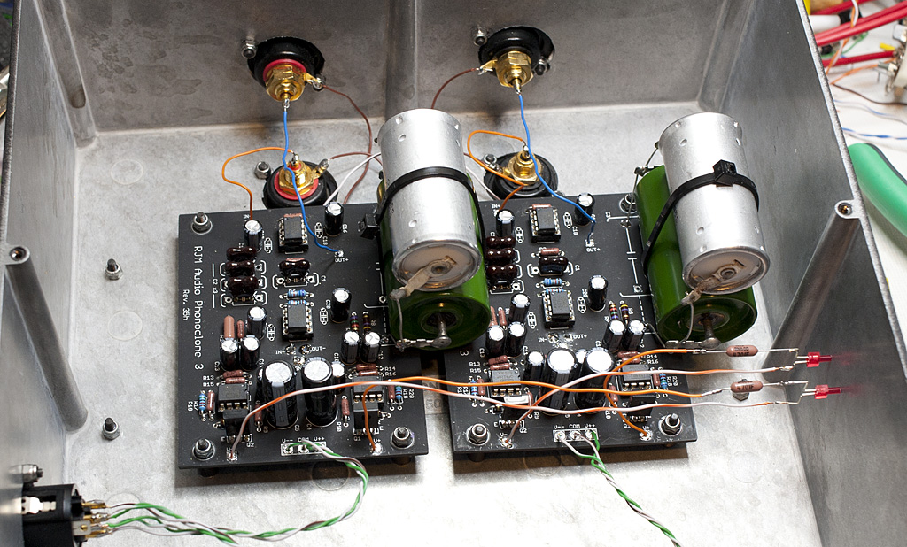

Finally I think I am finished with moding my phono...
Last changes are Russian coupling caps (K75-10 at 2.2uF bypassed with FT3 teflon at 0.1uF) and red leds for the indicators.
The red leds where a bit more silent than the super bright white ones, giving a more clear sound.
On the other hand the russian coupling caps were a complete revelation. The difference when replacing the mundorf supreme ones is almost throughout the frequency spectrum. There is way more clarity, detail and energy.
Only the lower bass seems a bit shy at the moment, but they are still pretty fresh from their box. I can t imagine how will they sound when they are properly broken in after the recommended 200 hours... (ouch...) But they already sound terrific...

Those caps are enormous. They properly belong clamped to the chassis rather than strung off the boards like that.
Bonus points for using the V+, V- I/O pads for LED indicators. I hadn't thought of that. Try to keep the LED currents down below 10 mA though to avoid loading the X-reg unnecessarily.
Yeah I know about the caps... not to mention that the case is with PCB up when playing which means the caps are hanging from the thin wire like tarzan....
This is temporary anyway. I just need to find some time to get some wood to build a proper chassis (going to shield it with M3 tape)
Every component I've ever built has had the boards "upside down"! It's the natural arrangement when using those cast aluminum project boxes.

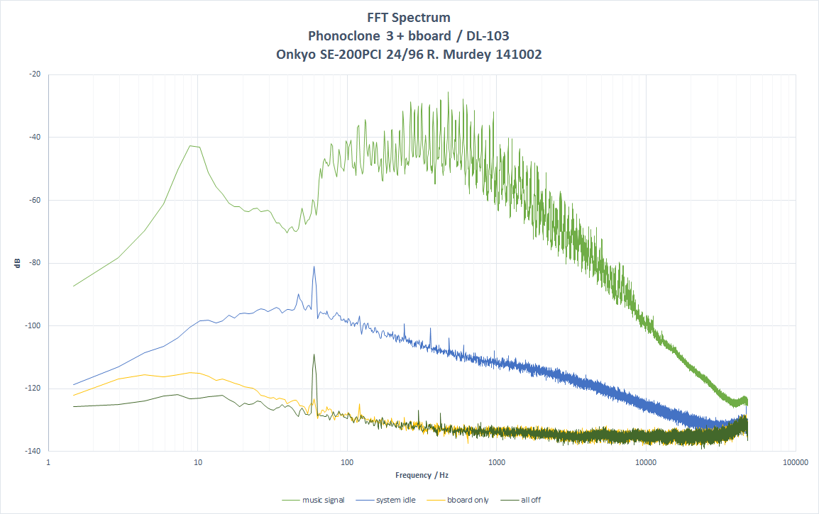

Phonoclone noise measurements
http://www.diyaudio.com/forums/blogs/rjm/1168-phonoclone-noise-measurements.html

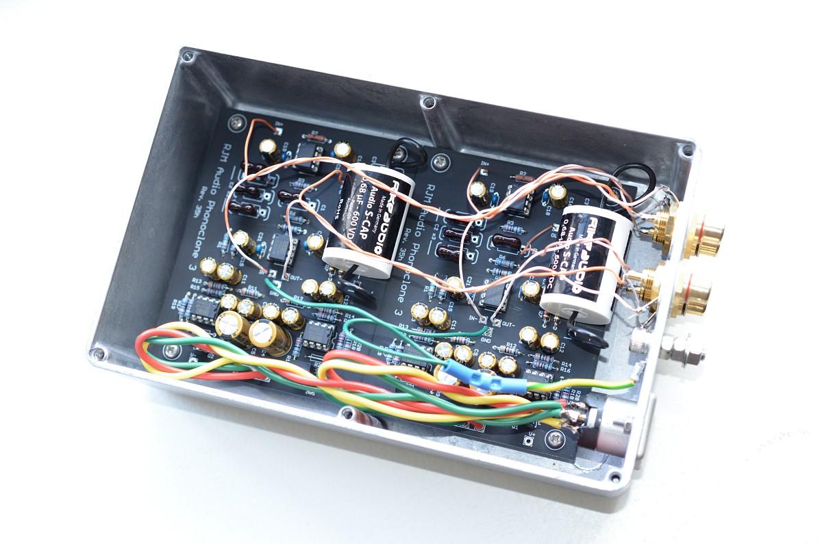

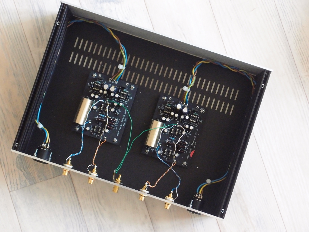

I finished my case for two boards Richard sent me. It's not the final version since I'm waiting for better caps and an R-core transformer, nevertheless, they already sound much better than my Grado. Here are some pics.
Shielded Teflon silver cables throughout. I added two diodes in series with the LEDs, a bit cleaner. The case is made from 1/4in aluminum boards shear-cut and joined by screws, so nice and hefty.
I removed my ancient Phonoclone3 (first version) boards and replaced them with the latest boards, 35h.
The only changes I made is I added the ceramic bypass caps and shorted out R21 and R22. C3 is 0.68uF Rike paper in oil. This value is low but okay if the input impedance of the next stage is 50k or higher.

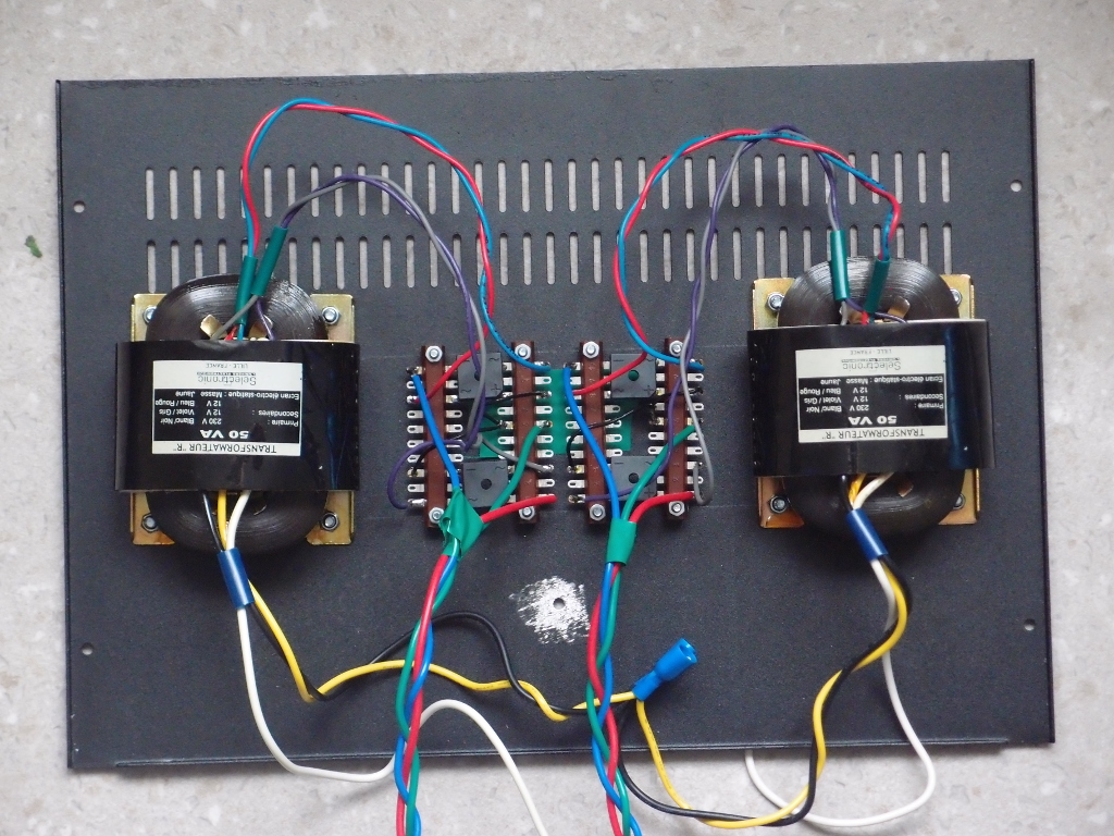

I'm on my way to finish my Phonoclone and I have a stupid question: to test the external PSU, should I use my DMM in AC or DC mode which value sould I find?
(Usually, I measure PSU after filtering, so in DC mode. It's the first time I have to check a PSU just after the rectifiers)
