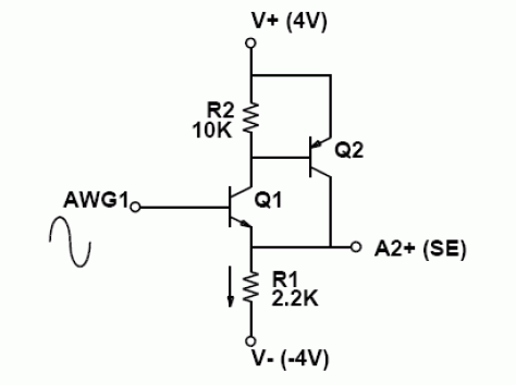

Another variant on the theme, which I dredged up from somewhere or other. It could use the same BD136, BD137 transistors required for the Xreg, so no added complexity to the BOM.
Though frankly the simple emitter follower with resistor loading seems the best option.

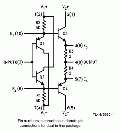

Another buffer, the classic LH0002 from national semi. I read a post someplace where people were complaining about the unavailability of this IC (it is long discontinued) and someone made the correct observation that you could build the discrete circuit with less than a buck of parts.
It's four transistors and four resistors, and the datasheet even goes so far as to supply the resistor values. (its not a simplified schematic, this is really the whole thing)
It'd be overkill for this application, I'm providing it for completion. I've been thinking a lot recently about transistor circuits (as opposed to tubes or op amps) .
