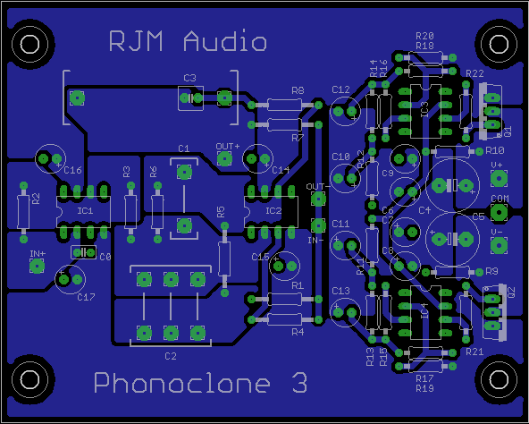

modded my prototype to bring it in line with what I have been suggesting:
R9,10 : 100 ohms (changed from 300)
R11-14 : 10k (changed from 15k)
R15-18 : 1k
R19-20 : 33k
Output voltage is now 11.1 V. That's within 0.5 V of what my worksheet predicted. Sounds the same as before.

I feel happy enough with the phonoclone 3 circuit to include it in the list of options on the web page: RJM Audio PCB page
I've been catching up with the backlog of unread posts at the help desk. I know a number of people have had hum/RFI problems, and several people have offered useful suggestions. I'll try to leverage that into the pcb design as much as possible.
The latest revision of the board includes the option of a small capacitor C0 across the opamp inputs. If your phonoclone is acting as a radio, try adding a capacitor here. A few hundred pF should suffice, but some trial and error may be required.
Other things:
1. Never, ever use unshielded phono cables.
2. Ground the turntable/arm to the phonoclone case.
3. Set R2 to no more than 30x the cartridge impedance. Ignore my earlier comment that R2 should not be less than 500 ohms. For the small signals involved it shouldn't matter.

If what I'm hearing is "real", very minor tweaks to the circuit should not have a great effect. If on the other hand it is the result of some oscillation or other instability it should be easily suppressed or at least drastically altered by the same tweaks.
So, time to do some tweaking!
First thing was to remove C12 and C13, which were always considered optional. This puts a bit of trace length between the pass transistors and the first electrolytics, situated next to the Phonoclone's op amps.
This had a pretty significant effect of "winding down" some of the punchiness. I should say the sound seemed slightly more natural, but less dynamic than before.
The next thing to try was adding a small resistor between the op amp output and the transistor base. I'd played with this earlier on the test bench, but the OP27 was stable without so I left it out of the boards I had made. If you notice at Tangentsoft's excellent review the original Sulzer circuit may not have had them, every later iteration did. A small detail worth noting.
http://tangentsoft.net/elec/opamp-linreg.html
It was a hack - literally - but I went and retrofitted 47 ohm resistors. Quick and dirty method: cut the signal trace and solder the resistor across the pins of the op amp and transistor on the underside of the PCB.
This time, the difference was night and day. In short, the sound became normal: softer, fuller, but less distinct. Although more in line with what I'm used to hearing, it's still a fair bit better than my RC.
Oh well, it was fun while it lasted but I think I prefer it this way.
My guess is that the OP27 is not especially happy having the capacitance of the pass transistor inside its feedback loop. I don't know the exact mechanism for the loss of stability, if indeed that is what it was.

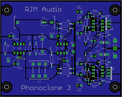

Working eagle files updated to reflect current situation. Sorry, the capacitance numbering was changed in the latest version.

Hopefully this is the last update of the Eagle files I'll need to post for some while, at least until the other beta testers get back to me with suggestions.
Changes in 31i:
- Tidied up the component layout around IC3 and IC4.
Changes in 31h, above:
- Changed R9, 10 back to 220 ohms. It's no big deal, but it just seemed prudent to drop the voltage down to around 15 V.
- Moved some filter capacitors around, removing the two at the transistor output and adding them to the V+ and V- rails so that each op amp IC3,4 will have bypass caps a little nearer to the power pins.
- Added R21,22 47 ohm resistors between the output of IC3,4 and the base of transistors Q1,2.
Changes in 31i:

Yes, definitely tweakable ... and, uh, not necessarily the phonoclone. I've just finished giving my stylus a scrubbing and readjusted the elastomer in my DA-307 tonearm. I'm now grooving to Al Stewart ... oh, at 100% improvement vs. earlier today. A number of things I'd pegged on the phonoclone (lack of body, fullness, skidding out of control on transients) turned out to be in the arm/cart instead!
The take home message though is the Phonoclone 3 is that much better: every change - and error - upstream is clearly visible, where it just wasn't before.
I share your confidence that whatever is left to wring out of the Phonoclone is mostly a matter of layout, value and distribution of the capacitors, with, as a last resort, a cap across the feedback resistors of IC3,4 to kill off the bandwidth.

Yeah, I have hacked my PCB to make it effectively the same as the latest Eagle files, 31i or 31j. There is 47 ohms between the op amp and the pass transistor, and the capacitors directly on the pass transistor output were removed.
