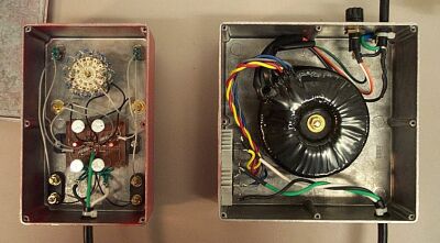

Regarding the power transformer,if I remember correctly when I built the first version of the PhonoClone, if using a 12Vac transformer of 35VA, the transfo light load of the PhonoClone and its own regulation (or lack of) produce a secondary voltage way higher than 12Vac
This higher voltage was causing in the LM317/337 supply version and over heat of the regulators. This is why I settled on lower voltage transformer, but with still high VA. If I remember it used 8Vac, 48VA Hammond model 229D16 split bobbin transformer.
Is it still a good choice for the PhonoClone3 to use such a higher secondary voltage transformer (12V,35VA)? Will it cause a problem with the new regulator (over heat,etc), or is it needed by the new design?

Hi Sylvain,
I am using 2 x 12V transformers as dual mono 50VA each. AC sec voltage is ~12V or so, maybe 13 even. After rectification (no load) I get about 16-17VDC and I don't get any heat at all off either the LM317/337 (phonoclone or VSPS) or the opamps in the phonoclone 3. In fact in my VSPS I used TO92 package LM337 and they never get anymore than barely warm.
Don't know what would be making your regulators get hot.

@Algar-emi: you must have hooked up the transformer incorrectly. 12VAC secondaries will give 12-13, max 14 VAC unloaded. The DC voltage will measure about 16-17 V and the regulator (old or new) will dissipate about ~0.1 W, not enough to even get it remotely warm.

Is there anything wrong with using a overkill power supply for this preamp? It is in a seperate enc anyway so i was thinking i may aswell go for it.
I was thinking about one of these http://www.amb.org/audio/sigma22/
That's a regulator + rectifier, not a power supply. And it's designed to for a power amplifier.
It's a humongous version of the Xreg, - conventional reference and a discrete error amplifier instead of an op-amp - but it serves the same function. You can use one or the other, but no need for both.
The power supply, what is external to the phonoclone 3 board, is just fuse transformer diodes. Or mine is. It's the same one I use with my gainclone, shown in the pic below. 160 VA 2x12VAC Plitron toroid.
Okay, i will go the unregulated option if that works out fine for other people! Cheaper!
I see most people are using 2 cases, but i would really like to use a 2u case and include the power supply. I could use a encapsulated transformer and then build a little box for it out of copper sheeting.
Thanks for the info. It is possible, I did it a long time ago. I'll use a 12V, 48VA transfo then.
@rhysh: Its not the transformer messing around with the phono stage electronics, so much as the transformer messing around with your cartridge. Not as big a deal with MC, but with my old Grados it was awful. You want the phonostage close to the turntable, but you want the transformer as far away as possible. ergo, two chassis solution is sensible.
If a single chassis is more convenient for, there is really no reason not to do so, just keep the toroid at one end, the boards at the opposite end.
You may wish to lift the earth connection, though, it may cause you grief...
