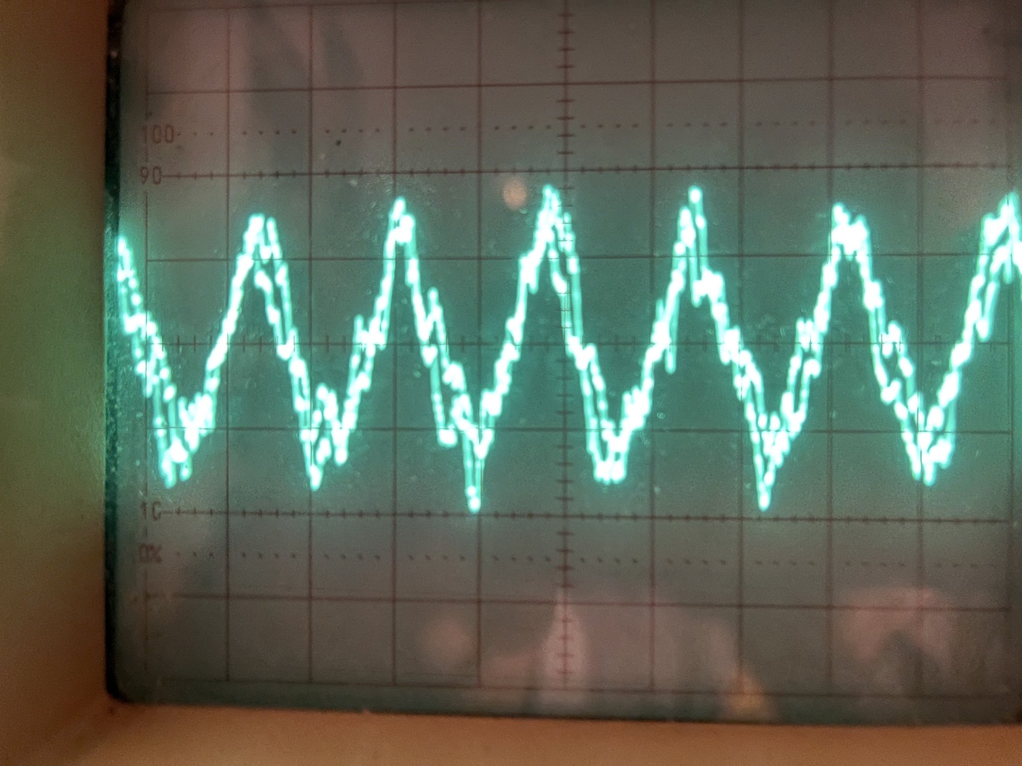

Could you point to where I should hook the scope to when looking at the spikes in pause mode?
You want to monitor radial motor drive at connector A13 (floating ground - do not earth scope on either point) for spikes in output while playing and when paused and trying to nudge the arm manually by tapping with the eraser end of a pencil. If you get any spikes (which you should), they have to go in opposing driver direction. The correction should look like a smooth jump without any noise. If you see noise, proceed to the next step below, otherwise suspect mechanical binding of the arm (suspension and bearing).

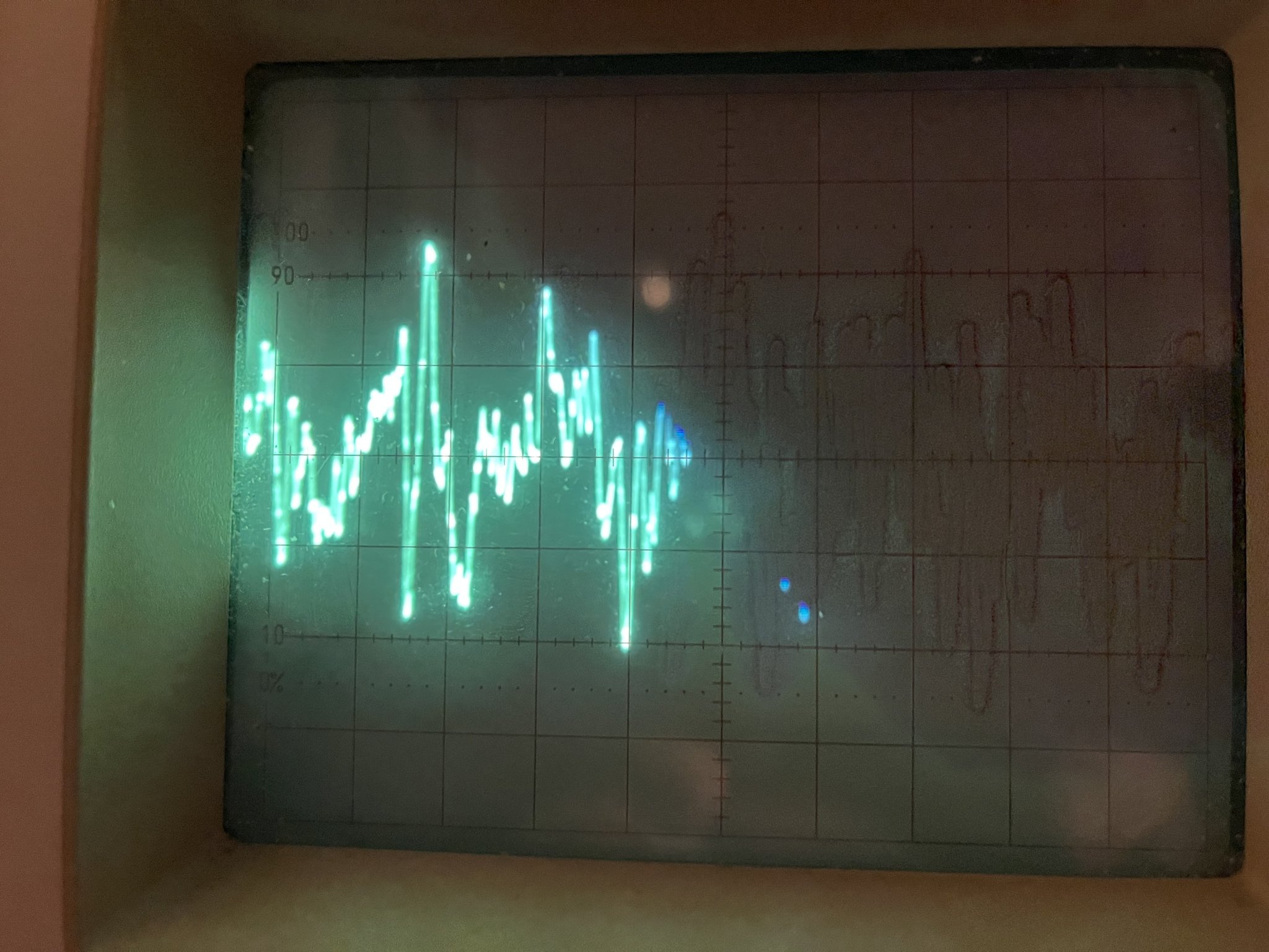

ok so I proceeded a bit. Am not sue if I understood everything you wrote though. At A13 + I get a waveform (see first pic below) which becomes much more choppy and ragged and seems to brake up and away from the fundamental before skipping occurs.
When I nudge the arm away, it corrects without a noise, until a threshold, when it makes a noise and actually skips. If I nudge it gently enough that it does not skip, the wave pattern goes up or down on the scrren, according to the direction of pushing the arm.

Deep in work today but not ignoring you. The tracking error waveform is showing a suspect bad component in the swing arm drive (likely a bad op amp or drive transistor) with drifting output and noise over top of the error correcting signal. Suspect one of the TO92 drive transistors or the op amp itself..The error correction signal should be low passed at around 1000hz to only let correction occur in the confines of the 500 - 200 rpm disc speed. Same holds true for the focus error correction. Any more high frequency noise will be coming from the output stage. It shouldn't be that rough looking as you state after the laser is parked when the player is paused and show equal corredtion im both directions as mentioned before. You will usually be able to hear the tracking correction noise coming from the swing arm drive coil. When making an extreme out of parameter adjustment of the focus offset, you will hear noise only when turning the adjustment all the way over to one direction. - this can be normal, but not the spikes showing up after the laser is parked in paused play mode. The swing arm suspension can still be binding though, despite the symptoms pointing to the error amp and outout drive.

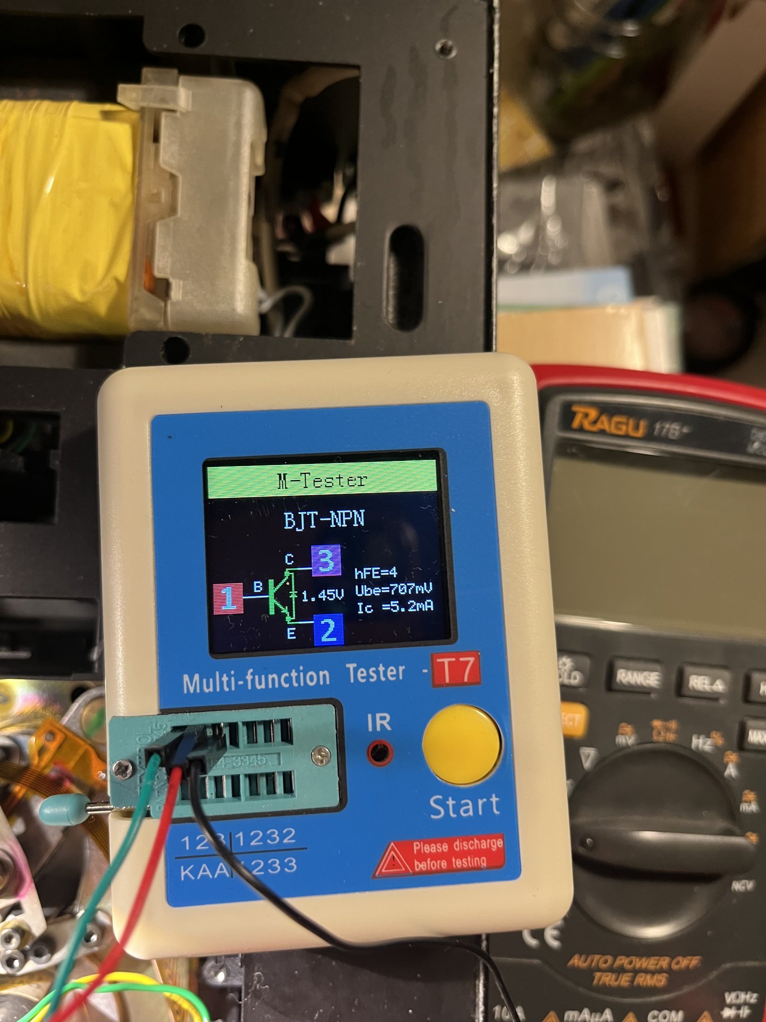

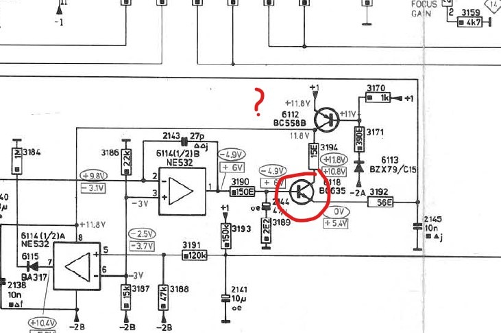

There are three op-amps on the motor board (6101, 6107, 6114). I looked at the TO-92 transistors (seven altogether) again yesterday night. Stared at them, actually, from both sides.
I found that 6118 had a bad solder joint. I cleaned it, re-soldered it – moment of hope! –, but no change. It had probably still made enough contact. Could not detect more cold joints in the board. Before resoldering the lead with the cold joint I checked 6118 in place with a component tester and it showed ok.
See pic attached. hFE is VERY low at 4. Alltransistors gives a minimum of 40 for the type used, BC635. I only really realize this discrepancy this morning.
As the tester showed me a functional transistor, I left it. But maybe the low hFE is a track to follow? Or can it be an artefact due to testing in-circuit?
It seems that the next step would be to test the remaining six TO-92's and measure voltages at the pins of the op-amps. Is there somewhere to look for on the decoder board as well?
As the skipping is irregular (and only ever forward) and I don't have a total breakdown of the player, I still think in the direction of an intermittent contact somewhere. But maybe a leaky silicon device can give that picture, too. I can also get freeze-spray for diagnosis, btw, only will need some time.

I had already stared at that motor PCB many times without finding any cracked joints. This time I had to bend the TO-92 slightly in order to get the measuring tips to its leads, and then one of the leads broke through its solder joint on the underside of the board. This is how I discovered the spot.
hFE of 4 instead of more than 40 seems pretty suspicious too me now.
Of the transistors you measured, am I hearing you correctly that 6118 measured only 4 for gain? Thats suspect, but if measured in circuit can generate strange results. Best way would be to desolder and check out of circuit. You also want to see a slight climb in gain when warming the transistor. Being the problem is intermittent in nature, warming and cooling specific components will potentially reveal the issie. You can also try swapping the low hfe transistor for another one. Bottom line is if the tracking error drifts while the player is paused, there's a problem and its not normal. The servo can compensate up to a point but once out of bounds it will keep going. Again, you want to see equal corrections being made under correct operation. If you could post the rest of the servo block schematic for tracking, I can tell you which components to look at. These single beam pickups use rf amplitude delta to adjust tracking. If you have a CD with a radial track error, you'll see the swing arm move exactly with the disc's eccentricity. Single beam CDMs are known for their ability to track very well when working correctly, far better than most 3 beam pickups, mainly due to the swing arm's fast response time.

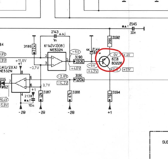

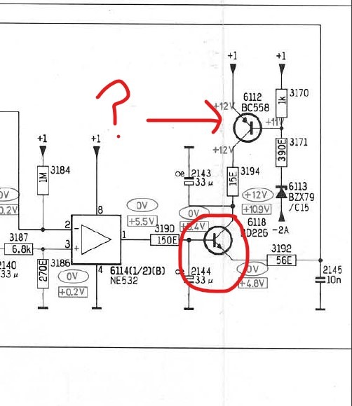

Yes. 6118 measured only 4 for gain in circuit. If I swap it, would a BC649 do? That's what I have here at the moment, but maybe also some other ok substitutes. BC649 has lower voltage etc ratings, but the position in circuit seems not too demanding. see the two pages from the SM which show the circuit attached. unfortunately the scan put it on two pages. 6118 is at H8 on the upper image.
I don't completely understand your statement "Bottom line is if the tracking error drifts while the player is paused". It does not skip while paused, continues exactly where I paused it, and the wave pattern in pause looks very much like in play, only with those intermittent high spikes. Is that what you are referring to?
Just mentioning this because......
The only transistor I have had fail intermittently on these is the one supplying the laser diode. Trying to think back.... its like 30 to 35 years ago now... and I'm sure I've had this more than once. As I say, just mentioning it because... I'm trying to think of the fault and it was something weird.
Typically Philips and there are lots of variations. All have the laser driver but others also switch the rail and one even switches the supply to the opamp.
