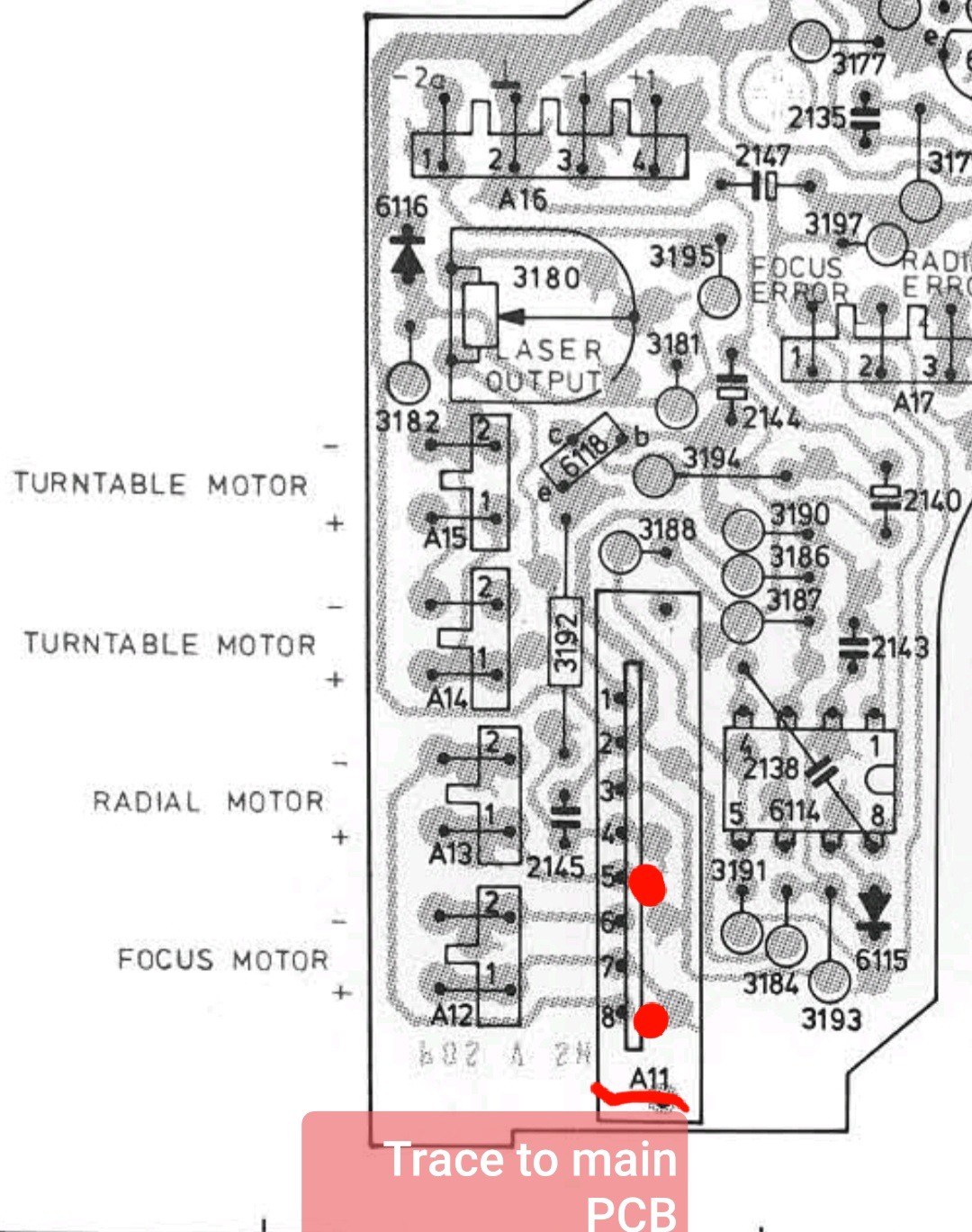

Well that seems all to point back to 6118 (circled in your images) which I just tested ok but that does not mean that it is not failing intermittently. Thanks!
With that knowledge I might just swap it – BC549 is what I think will work, agreed?

I suspected 6118 was going to measure correct once out of curcuit.

A sub for the BC548B isn't critical. Almost any common To92 will work in a pinch. I dont think 6118.is suspect from what I'm getting here. The source of those spikes are what you're looking for and tracing the waveform back from the radial arm drive signal is what you're needing to do. Have you gotten any pictures of the spikes in the control signal? How high are they incomparison to the overall amplitude of the waveform?

6118 is very important to the safety of the laser. I think I would be inclined to swap it rather than poke and prod it with heat. Just make sure you get the pinouts correct as would think the BD's will be of the standard ECB (looking left to right from the front) and the BC you mentioned is CBE. There is no room for error on this one.

This indicates non linear behavior from the radial arm and points towards a drive error after the control IC output. IOW something in the drive servo is injecting voltage and noise glitches, commanding the sporadic movement. You'll have to trace pins 5 and 8 of the A11 ribbon cable back to the main PCB and see where the noise is being added. Could be power supply related or any component in between from the control IC forward (not discounting the IC itself). If you could post the mech control block circuit, that would help.

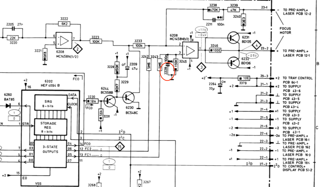

Tracing pin 5 an 8 from the A13 connector on the motor board in the servo board schematics.
The radial motor + (pin 5) goes here on the servo PCB:
The focus motor + (pin 8) goes here below
(circled in red is the cap that was an orange tantalum as I remember and wich I first forgot to swap in 2020. It caused skipping then, actually. I replaced it some days later after I discovered it with a 1uF film, which after looking at the schematic I again swapped with a 100nF film two days ago, hoping that would lead somewhere. I think there must have been something bigger than 100nF in 2020. But all this might not lead on the right track..):
While testing some transistors today I found that 6231 tested only "diode" in circuit (pin 1 not connected). Its complement, 6231, tested as two diodes. I pulled 6231, but out of circuit it measured ok, so I put it back. Can this be a track?

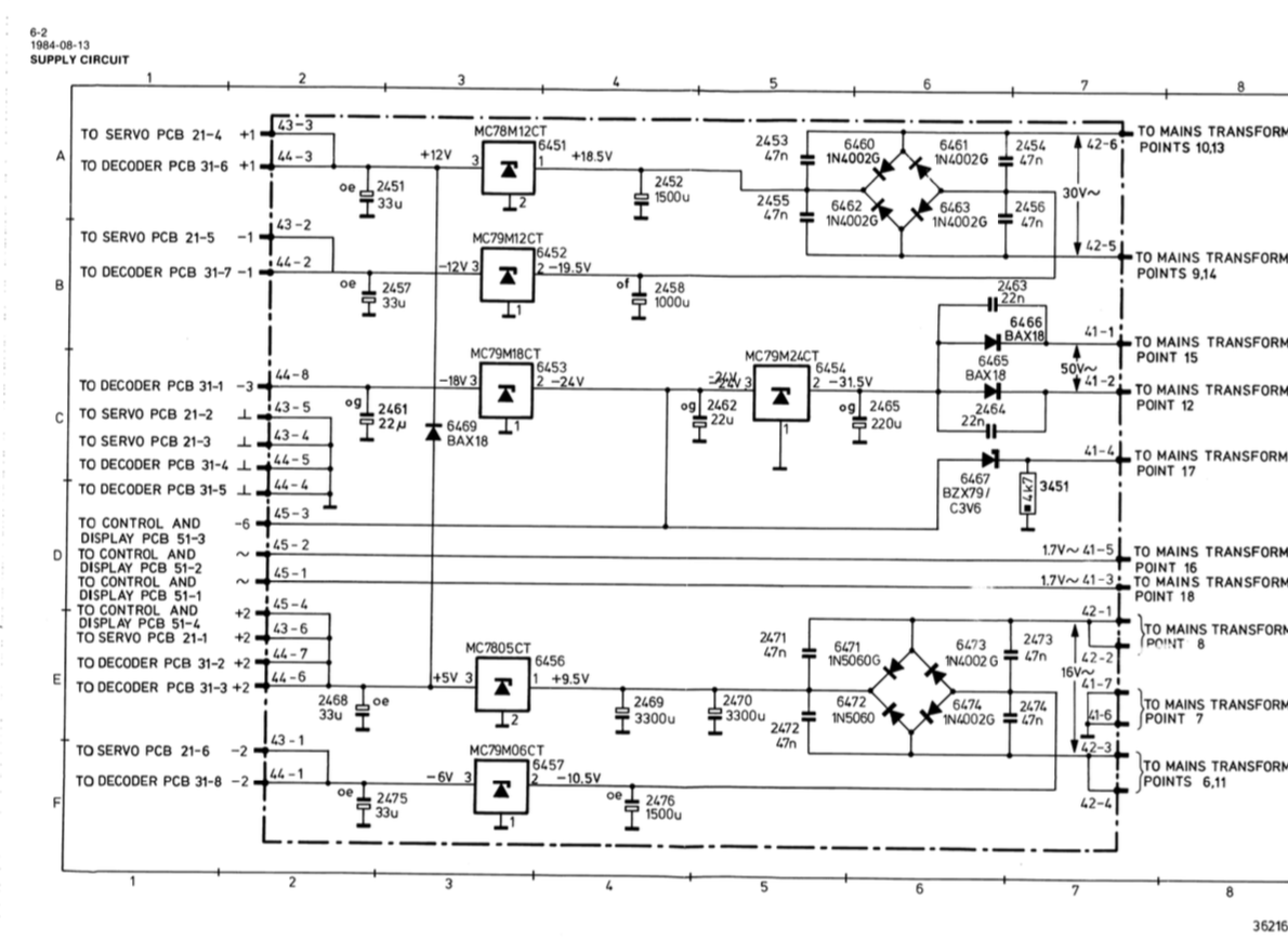

the +1 rail is involved in the RM+ and FM+ processing.
Ah, and btw, the headphone circuit stopped working in the last days while I was listening for skipping while I had the machine on the bench through headphones. It first started distorting, then went dead. It is now disconnected. Also +1 / -1 rail. The player skips also with the headphone amp disconnected.
I'd monitor pin 2 and 3 on 6211 and compare with op amp output to servo amp. 4053 ICs are known to have weird issues. The cmos type device can behave intermittent in very strange ways. The way its being utilized in this circuit makes it susceptible to supply noise. Keep an eye on the drive waveform to the radial motor and try to catch the behavior when it skips. If it jumps when the player skips, then its being commanded to do so by the servo input, which means you have to find out if there's a power supply noise issue or the clock oscillator to the u-con is cutting out or drifting. You have to be patient here with this issue. I still believe the issue has to do with a servo input error induced by intermittent noise. These old CDPs are sensitive to power supply issues, so its wise to monitor the supply rails first to see if there's any weirdness and rule it out.
