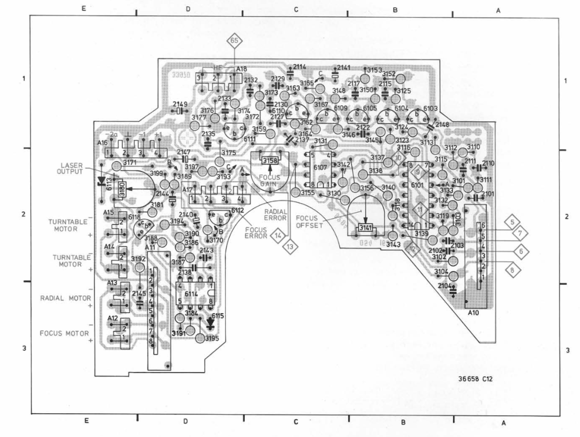

if you have a copy of the SM pertaining to the transport control block, I can point to those measurement points.
Here we go!
You want to monitor radial motor drive at connector A13 (floating ground - do not earth scope on either point) for spikes in output while playing and when paused and trying to nudge the arm manually by tapping with the eraser end of a pencil. If you get any spikes (which you should), they have to go in opposing driver direction. The correction should look like a smooth jump without any noise. If you see noise, proceed to the next step below, otherwise suspect mechanical binding of the arm (suspension and bearing). When the player is powered is off, you should see a smooth floating of the arm that reacts to the slightest change in tipping the player like a higher end turntable arm. Reference the preload adjustment procedure in the SM. This can be a very fussy adjustment and take a lot of time to get right.
If the tracking correction response is incorrect or sporadically shows up without provocation of the swing arm, first check the ribbon cable next to the arm motor output at A13. These tend to fail on these older units causing all sorts of weird symptoms. One scenario is the intermittent connection causing back EMF of the motor freaking out the error feedback amp.
If that checks ok, look at the error amp output and follow it back until you find the area where weirdness originates from. Thats at A17 pin 3+4 on back to IC6107 and IC6101. You'll need to reference the schematic to pinpoint the exact path from back to front of the arm servo. I recommend trying some freeze spray on the 6 x TO92 transistors to see if theres a reaction. Its going to be tricky playing a CD while trying to measure these hard to reach locations so you'll need to solder some extension cables for this in some cases.

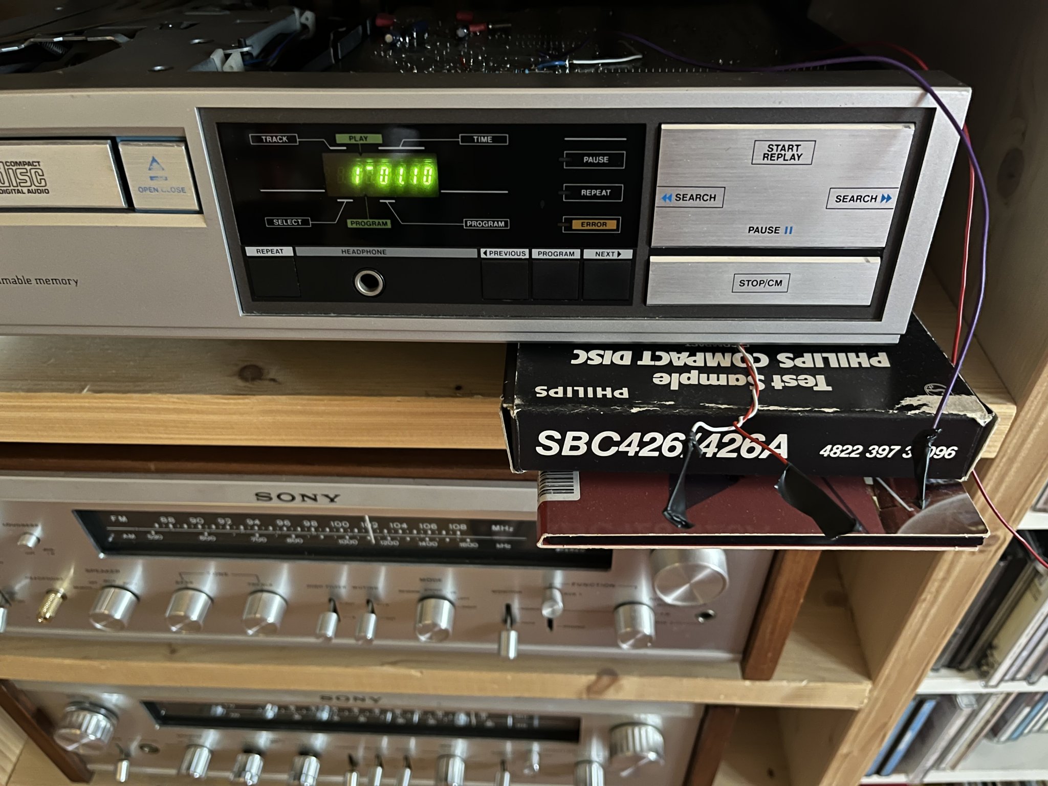

I'm still looking for non invasive ways of trying to get a handle on where the problem might be. If you get it playing correctly and then lift one end up on say a book or two so the player is at an angle (which will alter the weight distribution on the arm bearing) does it continue to play normally or not?
To me, an intermittent electrical fault in the servo for example would just instantly cause it to go nuts and its not doing that. Its all a little bit like a traditional sled system that sticks except here there is no sled of course, the lens is moved by the radial motor (the arm).
Thanks so much @profiguy and @Mooly . These are great tracks to follow. I'll manage to do the "lift one side" trick now, but then will have to seriously dive into today's (paid) work. So results for the procedures @profiguy suggests a bit later. Thanks again for that deep "Old Philips" expertise. Just what I had hoped for.
I can say right now that the swing arm moves pretty lightly and returns immediately. I did not touch it directly with my finger but would say that I can perceive some sort of light friction. The tonearm on my turntable moves definitely more lightly, you just need to look at it and it moves.

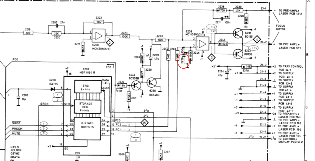

I found something – but not the fault.
Three years ago I had swapped the orange cap 2228 on the servo PCB with a 1uF WIMA film. In the SM it is marked as 0.1uF. It seems to be part of a filtering circuit. No idea why I put the wrong value – or was there one of the infamous tantalums with that deviating value and I substituted it 1:1? See shot from the schematics.
In any case behaviour went unchanged. I was already hoping. I remember that after the recap in 2020 I had some skipping and then found that I had left one tantalum on the servo board (they are as orange as the MKTs there). But maybe it was 2217.
Now I'll do the lift trick and will report back. Below the shot of the area of the Servo board where I changed the cap back to 100nF. I can swap back the 1uF in order to keep conditions for fault finding stable if you think that's better.
Ok I was already afraid you meant that. Need to find a space where to do this without getting electrocuted while raising the open machine 🙂
It needs to be on the speakers as I can't hear every little skip only by the noises the RAFOC makes.
Will report back in a minute (and further neglect my work...)
