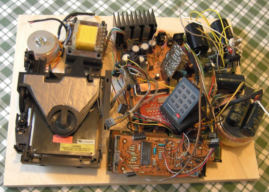

I decided to take my CD650 apart today. I've totally stripped it down and cast aside the plastic chassis in favour of a 24mm plywood board. I've removed the draw from the CDM2/10 and trimmed some of the plastic off to save space. This is going to be a biiiig rebuilding job, but the player's totally outgrown the standard box.
Plywood build
This is the start of a long road! 😱
Simon

I only just started reading this thread, but I'll post a pic of what I've done so far:
Mounted everything on a sturdy sand-filled plywood base. Added a tube output (SRPP using a 6211 with a 28 ohm I/V-resistor).
Recently I got rid of the loading mechanism and turned it into a toploader. It sounds much better than stock, I was surprised about the last mod!

Thank you Matthieu, this is only an experimental set-up 😉
The top-mod is very straight forward, turn the tray mechanism upside down, undo the 2 screws holding the metal clips, bend aside the piece of plastic holding the cdm in place (the plastic has become brittle over the years, watch out, mine broke off..) and you can take it out. I took out the screws holding the small pcb under the cdm, got some longer screws to mount it on a piece of wood and screwed that to the base. (with rubber rings in between to protect the pcb)
Here's another pic:
