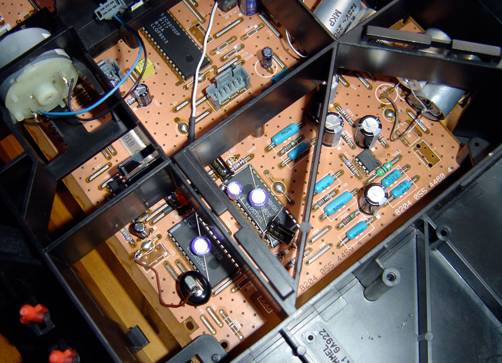

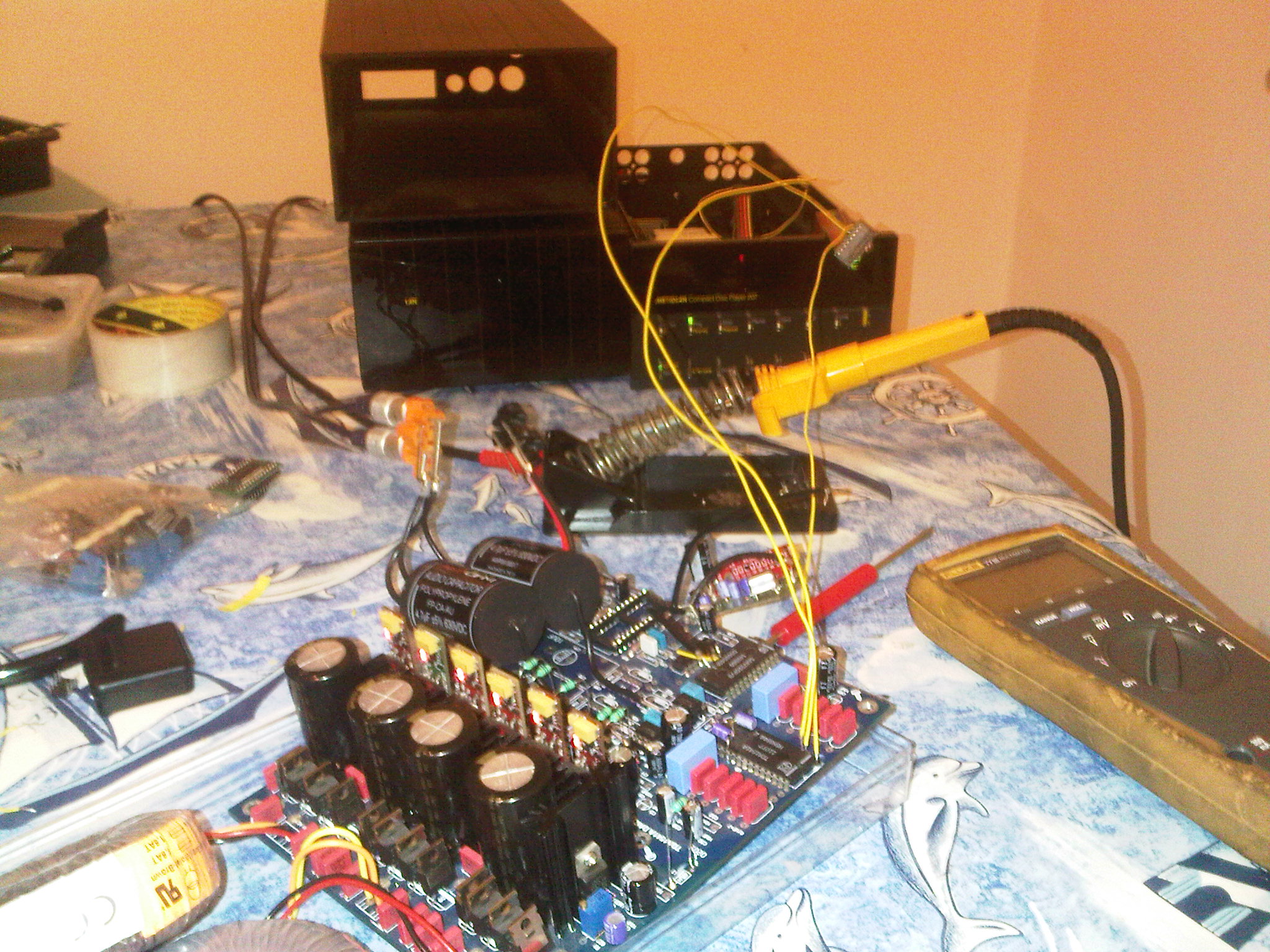

I've now got a meridian 207 CDP which uses the same chipset (SAA7210, SAA7220 and TDA1541).
This evening, I've removed all the preamp and TDA section (top board) from player leaving it effectively as a CDM4 transport with both SAA chips. I've hooked out the 3 I2S feeds from the SAA7220 and wired them into my green DAC!
It works! Not much else to report for now, but this opens up a whole area for me in respect of playing with different DACs.

And my update:
Recapped the whole thing. Took a day or two to burn in, but it sounds like the player is feeling a lot better and enjoys playing music.
What else? Two of the power cables going to the filter board broke, they can't stand all that handling
Result: when powered up the disc spins like crazy, since it's a top loader now this meant frisbee-effects.. And the display was dead too.. Soldered the cables directly to the board.
Lubricated the hinges of the swingarm. This made me nervous, but it turned out to be very easy. I also glued the flexprint back to the swingarm, it had come loose a bit and touched parts on the servo board. It swings freely now, big difference.
What did you use to lubricate it? And when you say big difference.... quicker to find tracks? quieter? Less noise on the PSU rails? Or does it just swing properly for a change?

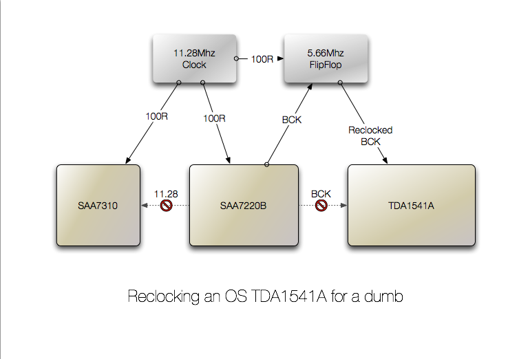

Hi Ian,
that's not clear to me and may be out of topic as it's a 7310 in my case.
As far as I have understood,
A clock at 11.28, a single 100R, a single wire going to feed the SAA7220,(or 2 of both?) then from this pin (like a bus) to the 7310, then a /2 cicuit to the TDA only pin4 the BCK on pin2 beeing left to SAA7220 duty?
Or BCK need to go from SAA7220 to flipflop as for the XO f, then Q feed pin4 only?
I'm lost!
The difference I meant was mechanical, the laser arm was swinging back and forth a lot better than before, I used some sort of thin silicone grease.
But a strange problem has come up 😕
Normal CD playback is no problem, but CDR's is a different story -sometimes. It doesn't just click slightly when it skips, the clicking is very loud, and the music is distorted like you wouldn't believe😱 Really horrible, like an overloaded amplifier.
And it's not the CDM, I've swapped that and the servo board with the same result.
Now the funny part: a few days later it plays even the crappiest CRD with only a few hardly audible clicks 😕 I'm lost here, don't know where to find the problem. Thought about resoldering all the joints.
Hi matthieu, I will check in my CD50 and make a diagram of the player clocking!!!
A picture will be much easier to follow than my description! I'll try and sort it tomorrow!

Here is what I understand right now...
LOL, Matthieu, that is really funny and also a cool diagram. You'll help a few of us by asking these questions.

Try this guys. It explains how I implemented the C2 in my player but it covers the SAA7310 decoder chip too. Most of the information is discussed in EC's Ultimate NOS thread. I would love to claim all this as my own but if I'm honest its just a collection of information i've found and collated. If you really want to understand the internals of the bit decoupling and DEM etc read EC's thread! It's very very informative! Like the 63 thread, its long and not all the info is of interest but well worth dredging through IMHO!
Whatever you do, make sure you clock the oversampler and decoder (e.g. 7220 and 7210 respectively - we're talking about several CDPs now) with the same clock - they have to be in sync. Or, you may well have serious problems (tons of noise!).
there is a slight error in the document.
Indeed the bck which is half of the sys clock is not 4.6448MHz!
Bit Clock is 5.6448MHz!!!😱
Thanks for the private heads up!!!
lol
lol
Indeed, you cannot use multiple clocks. 1 single clock instance is required.
