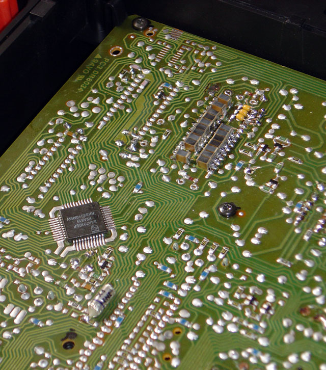

If anyone is interested while we're on clocking, here's the link to the post the day I fitted the awesome C2.
http://www.diyaudio.com/forums/digital-source/133780-philips-cd650-mods-73.html#post1851461
Been some changes since the photo too. All the regs on the TDA are SPower + some silvered mica in the HF area.
Also, today I hooked up my green DAC and Meridian via the main system. It is very good but then its already using a lot of what I've learned on this thread and others. However, it is apparent that the use of intermediate upgrade parts will not yeald the gains I have experienced in the CD960!
12 months ago, i'd have been over the moon with the dac, but the 960 is so so much better! 😎

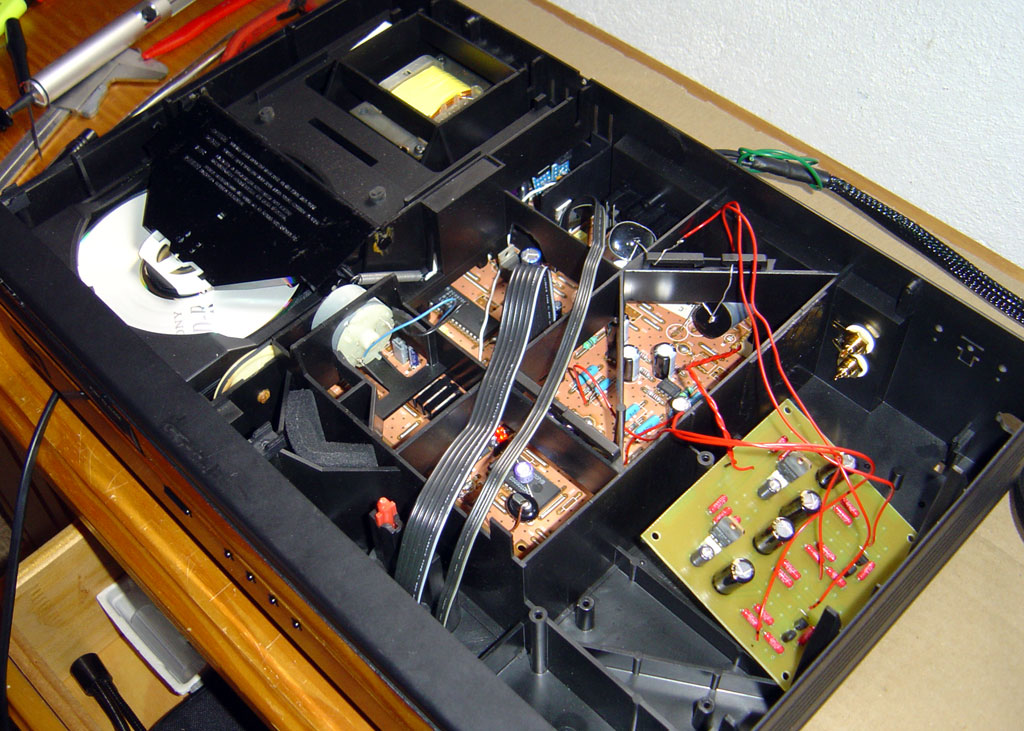

Got some 10,000uF / 40V F&T caps from Lee today so they'll be used for my output stage power supply when I rebuild my CD650 🙂

Are you suggesting to leave the original output stage connected on the board and connect a different stage in parallel? I'd say not.
What output stage are you thinking about trying Matthieu?
Not fully // Ian,
the TDA's pins only connected to one OS, then to the output caps. (wich are on the PCB...) All is still powered... and I just mind that my external PSU is feeding my OS with no ground to the player (+/GND to OS, that's all, no GND from OS to player).
I've built this one : http://www.lampizator.eu/LAMPIZATOR/FETISHIZATOR/JFET_CDout.pdf maybe a mistake here but it's so simple (more than the CD63 DOS!) I don't think so.
I'm still not fully sure I understand what you are asking Matthieu.
If it was me, i'd remove the opamps from the pcb if they are not in use. I'd also remove anything on the board not used if its going to be attached to the signal path. I'd also link the gnd's together. If you have floating gnd's you'll have all sorts of problems. It will at best hum!
I'd expect that circuit to be ace too!
Have you got a decent reg on the filter chip yet? I'd say its the biggest single gain you'll make (but it must be a low noise reg, LM317 won't give you the gains you need here).
Ian
To be honest I'm surprised it works at all without connecting all the grounds together! But then I'm also not 100% clear about what's going on here.
Bad grounds usually cause 'white noise' issues with these dacs. Often the noise will get worse the longer the player is switched on.

I was just trying the output before fitting it without removing the factory's one and using an external PSU. No way, only real settings work. BB's ICs are gone as their caps, output burnin' in time...
No more white noise but music!
