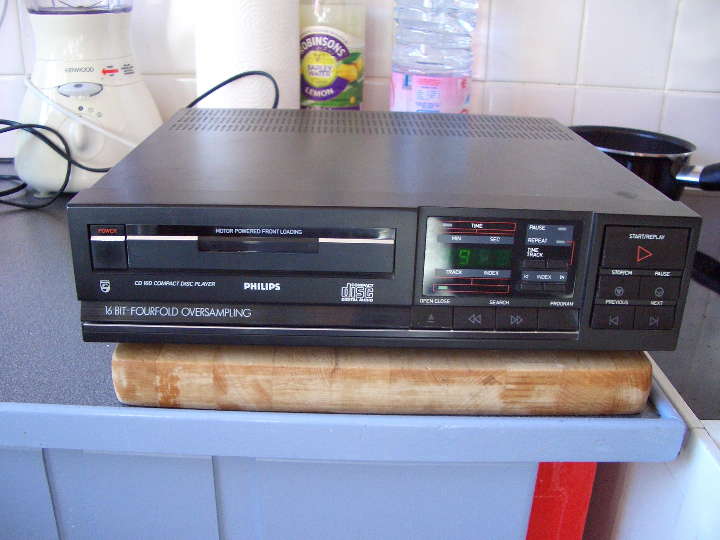

My ugly duckling
for relaxation i love those plastic duckling like CD 150 too Seems there is all in for the best construction time to good sound relation. And the costs for a handfull pana fc one can pay. You use lytics for dc-cap? Very pleasantly. Wich cap it is, and wich OPA in TO-5 you use?

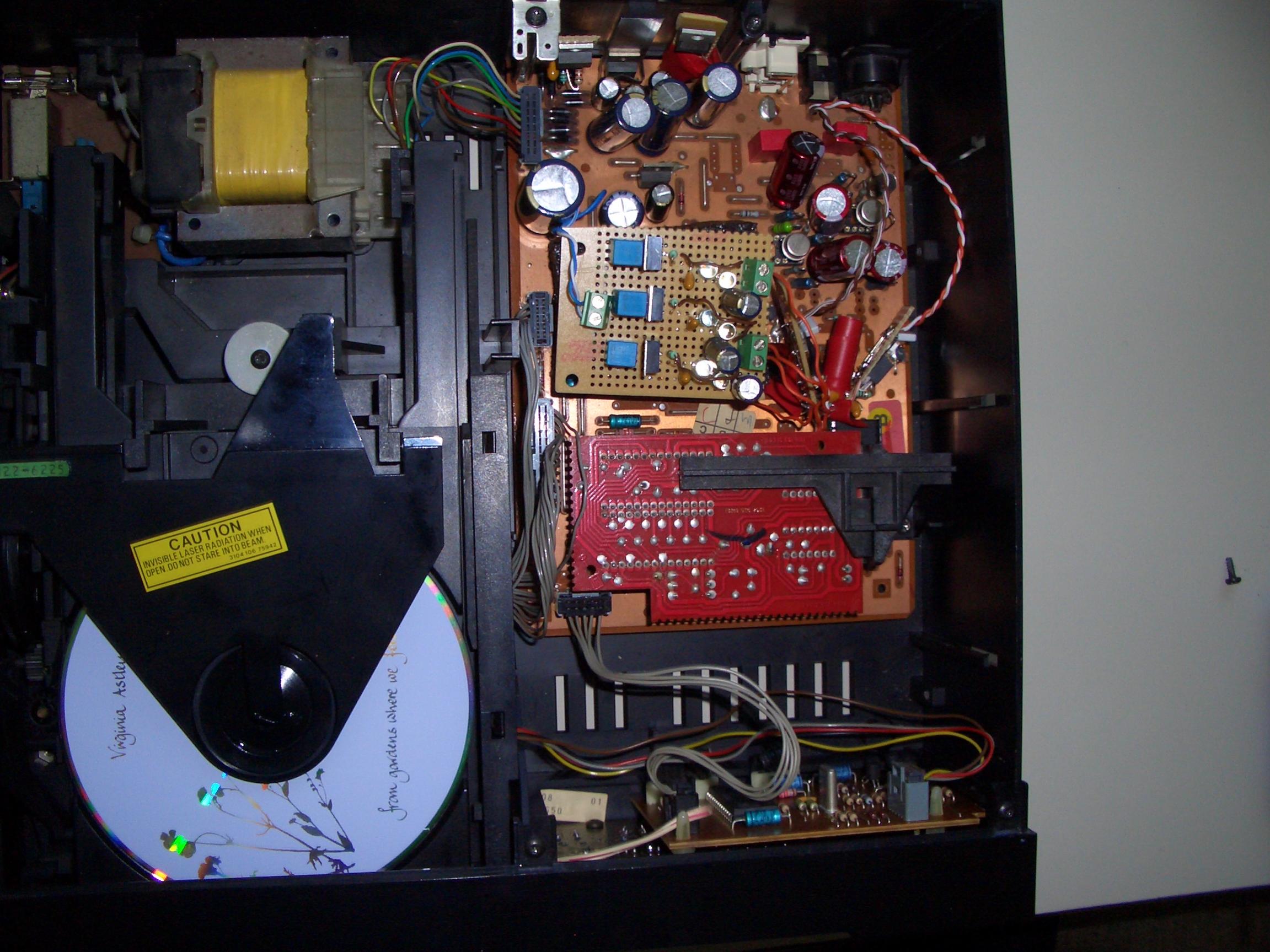

My ugly duckling 2
Swapped in an A dac.
Added new LM317/337 regs for DAC +5, -5, -15; 7210 +5; clock +5 and opamps +15,-15.
Replaced the dac decoupling with 470,220n film caps.
Sound is very much more detailed now, lot's of seperation on instruments, vocals etc and a much better soundfield.
On the downside it's getting very messy and very fragile inside the case. Don't think there's much more I'm going to do to this one.
On the upside I've got a mission 7000 which seems a very similar build but in a wider case (so more room to do things like place regulators) and one of the nicest (and biggest) displays that I've ever seen.
