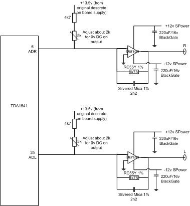

How to get 0v DC on the output!
Attached diagram of my output stage. The 5k variable resistors replaced fixed 2k7's. I used 20 turn pots for accuraccy. With the player fully warmed up and the disk stopped, I tuned the pots to give me as close as poss to 0v. Once warm I can get it stable at about 3mV.
No output caps has dropped freq response through the floor. The sound is fuller and defiantely more dynamic. The sound is punchy and tight and silky smooth at the top. Anyone with output caps due to DC on the output should look at tying into +v rail into the DAC out and I can definately say simple is better here!😀:cloud9:

Try adding a small cap (1-10uF or more) from the junction of your two resistors to ground, it'll filter off PSU noise.
Or replace the trimpot with a small trimmable current-source instead and you'll get more of the same again.
So long as your raw supply is quiet,the simple resistor approach does indeed work quite well to inject 2mA and do away with the DC offset - much better than it does for biasing an opamp output stage for example, because the output of this dac is 0v by definition. IOW there is no voltage swing across the resistor and therefore, no current swing through it. But it appears in parallel with the dacs output as a load on the I/V stage signal current. A small error term.
The CCS has *much* higher dynamic impedance and therefore freedom from PSU interference and the loading effect 🙂
Hi Martin, there was 10uF to gnd between the 2 r's in the original circuit. These were removed months ago although I cannot remember why!?!?!😕 Would you use there? elco's came out!
Can you confirm what you mean by trimmable current source? and also CCS!

Edit: yep def blonde! Constant current supply??
Simple adjustable CCS for experimental purposes - remove the fixed and adjustable resistors, replace with a jfet with a trimpot between Gate and source. Say BF245C with a 2k trimpot, connect the Drain to your +ve rail, and the jfet gate to the Dac current output. Twiddle the trimpot to set current (start with it mid-span). It'll probably drift a little from switch-on / be a bit sensitive to adjustment, but that doesn't matter much so long as DC offset stays under 10-20mV. It will have a dynamic impedance rather higher than the resistor array - up around 100Kohm.
Amongst other things, yes. A bit more elaborate in this case.
Note that jfet -based CCS are by no means perfect, or even particularly high impedance compared with simple BJT-based ideas, but this is at least and order of magnitude better than the resistor method. Do be aware this simple CCS needs at least 9-10v across it for best performance - not a problem in this case.
