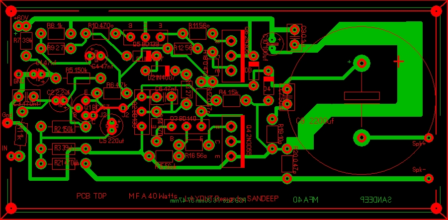

Motional feed back amp with some chenges

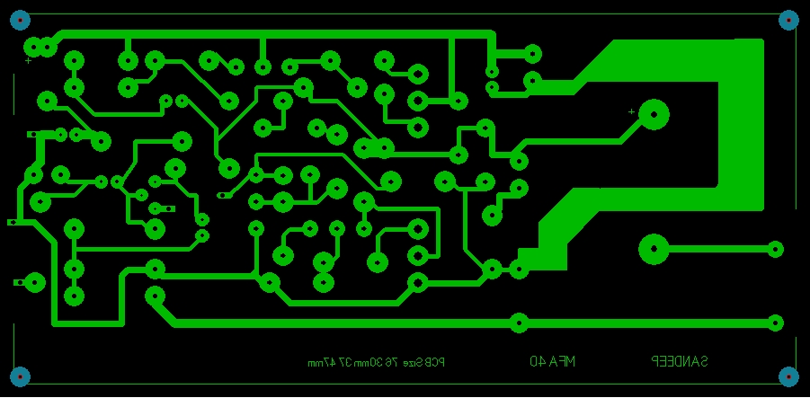

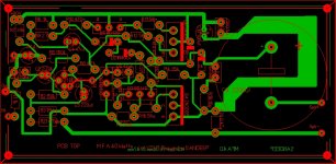

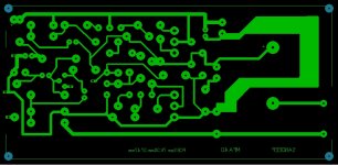

Hello friends
I try to create my first Layout in sprint layout. I attach files with this post. give yours thought on following PCB layout for MFA 40w.
Hello friends

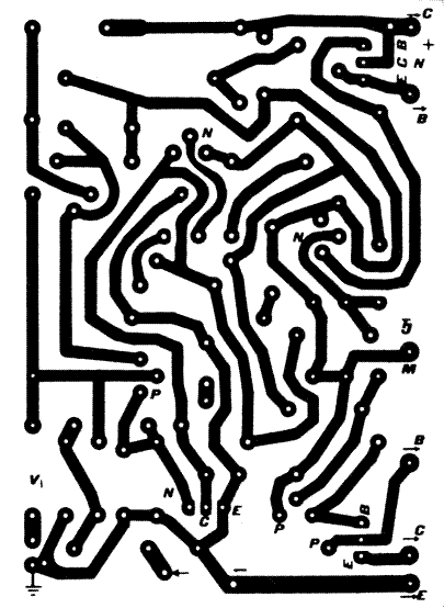

PCB layout
Hi All,
I want to try to build this amplifier. Anyone who have a PDF file?
Thank you in advance.
Boyet
Hi All,
Boyet

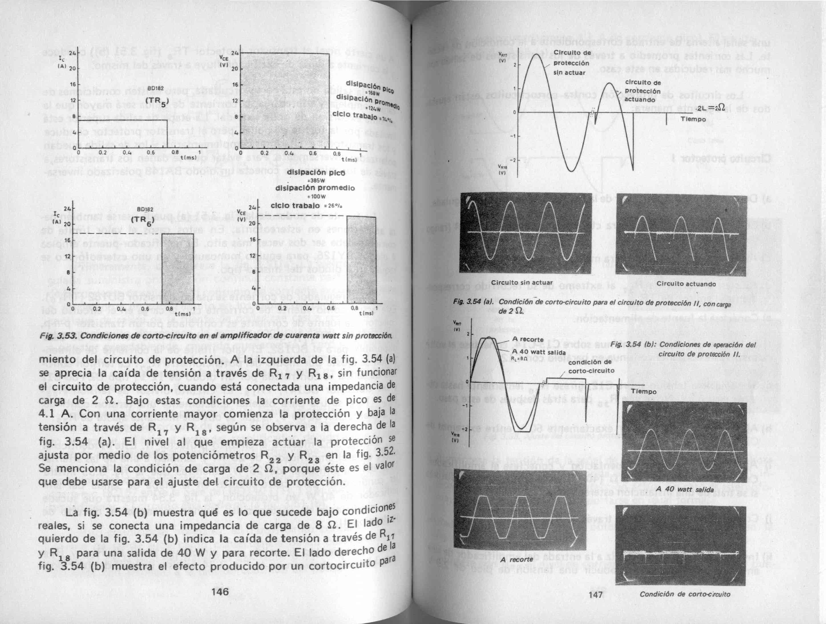

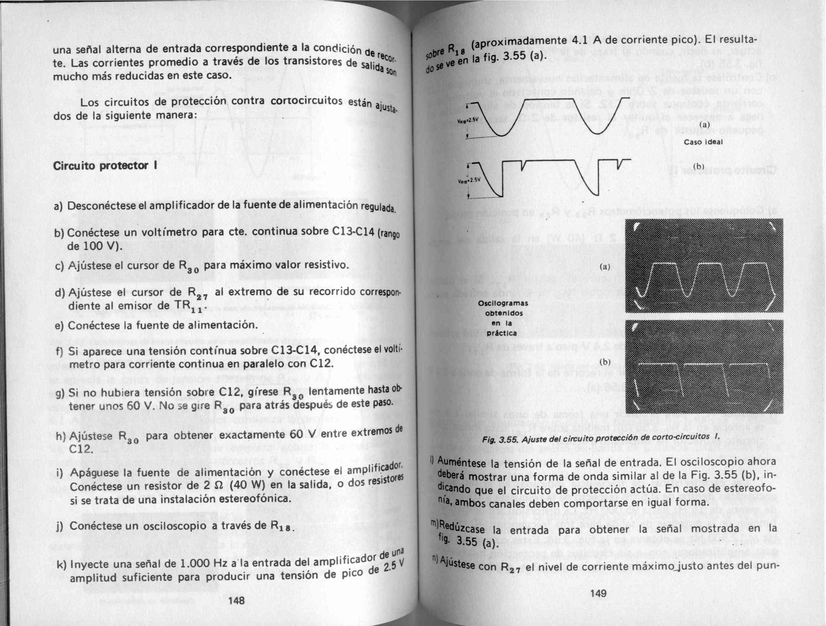

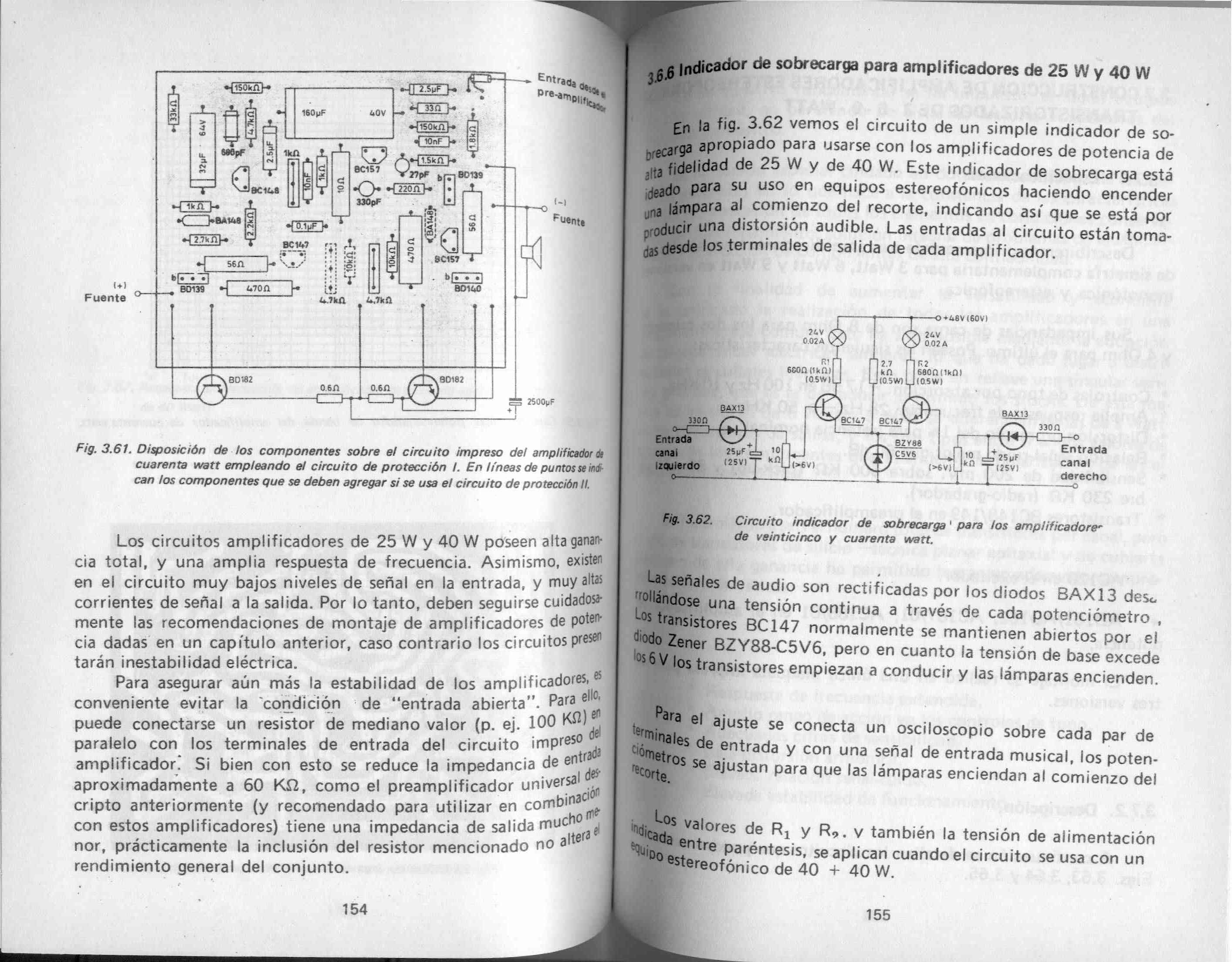

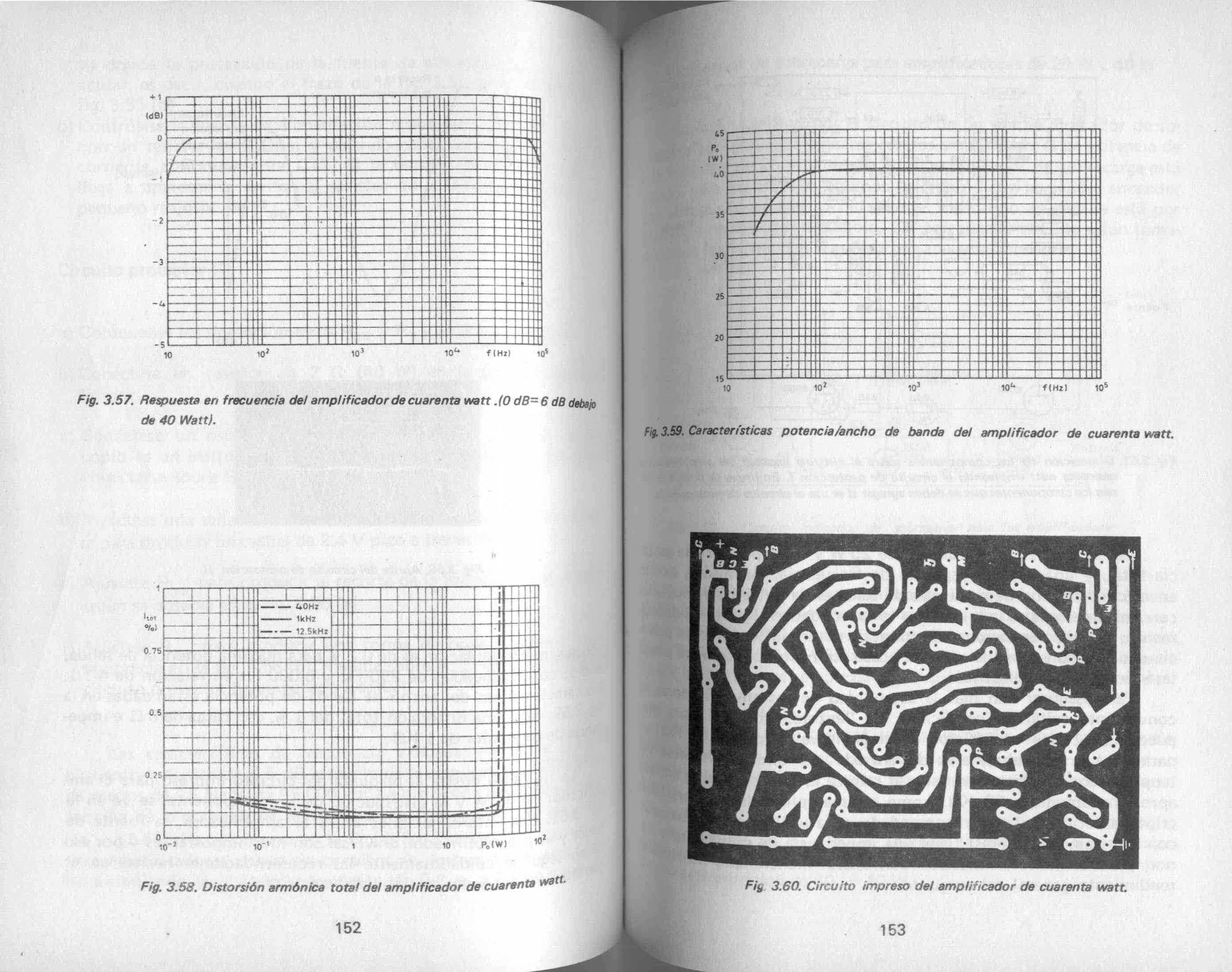

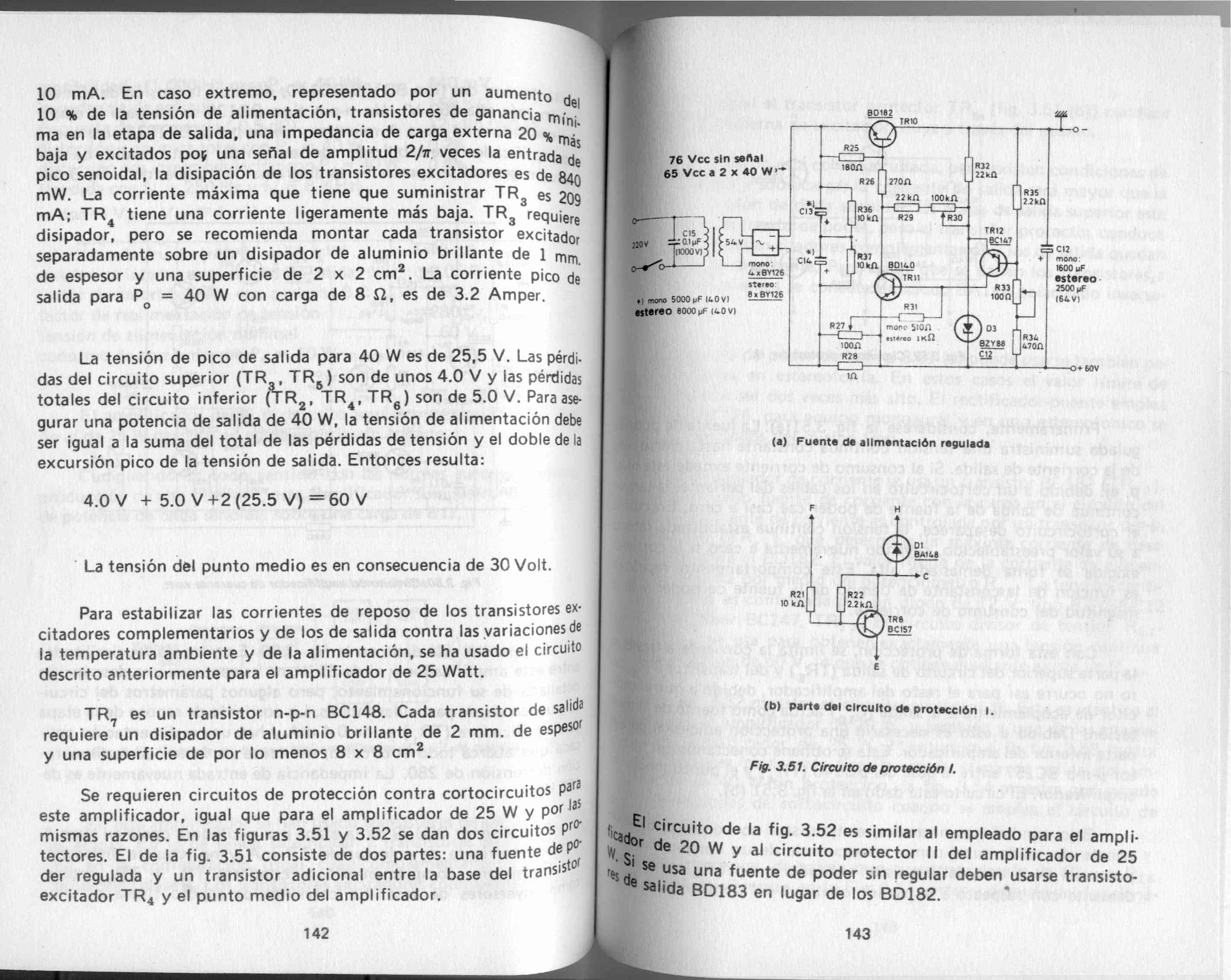

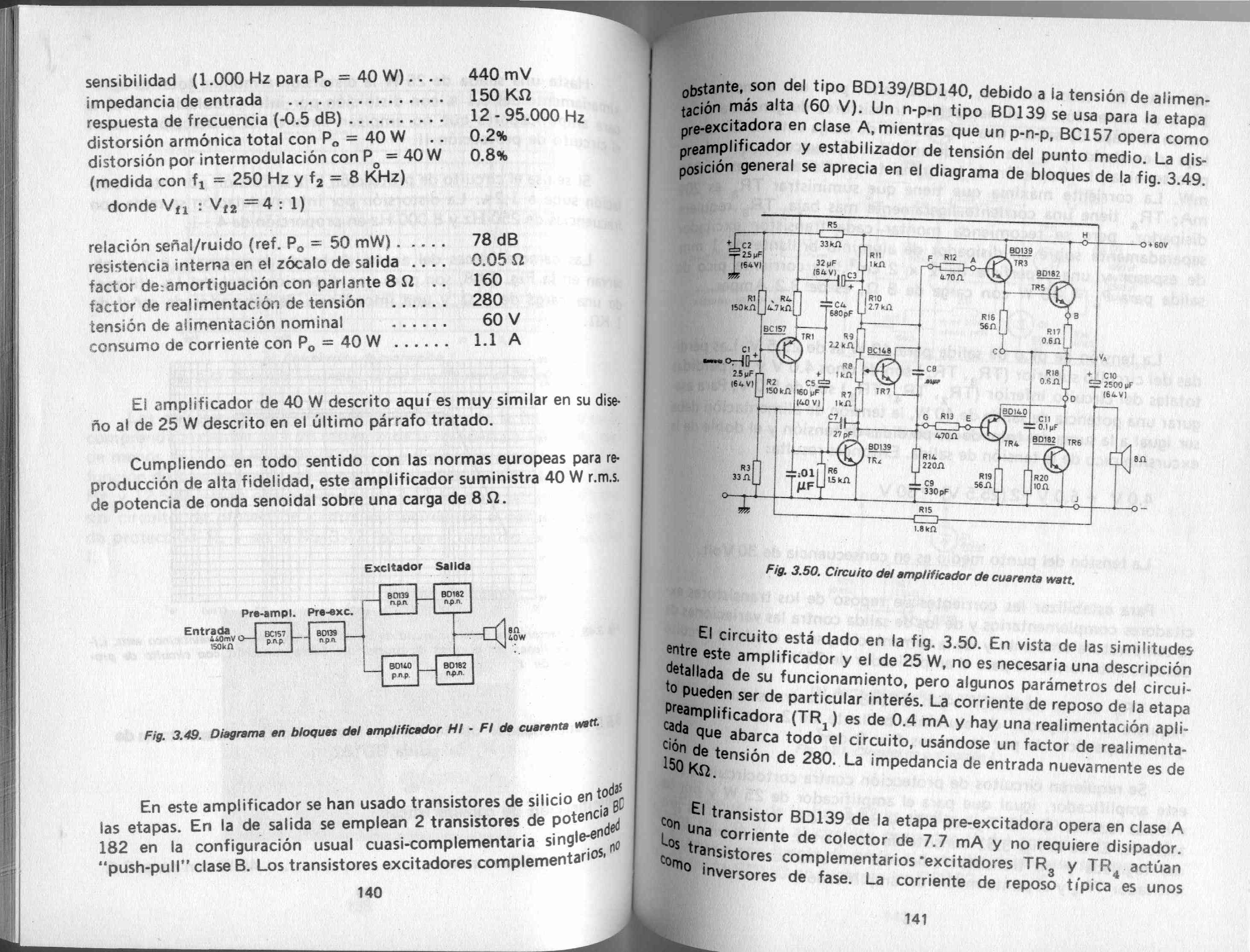

I try to attach here the full article, scanning the Spanish translation of the book "Audio amplifier systems".
great job pabloso, thank you in the name of all who were interested in this old old amplifier.

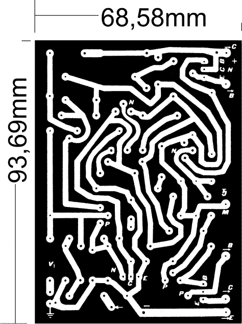

Hi pabloso, great work.
Just *one* extra demand, can you scan the PCB page with a couple rulers drawn on the page, vertical an horizontal, so an accurate 1:1 PCB can be made?
Or give us the exact PCB size.
Thanks.
Thanks.
